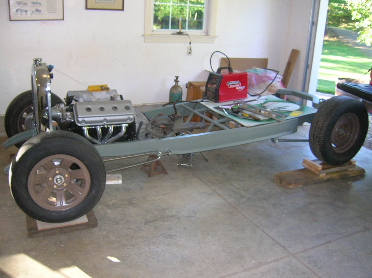

    I believe I mounted mine about 3 or 4 degrees back as checked on the valve cover. Mostly it was a function of where I could clear the lower firewall with the bellhousing. DSCN1714.JPG as checked on the valve cover.
    LOU WELLS likes this.
  6. Ok that's what I thought however your transmission looks level.. when my 270 is at 3 degrees my transmission (TH350) with adapter plate is pointed up..

    The trans output shaft/housing is on the same plane as the crankshaft. In my 70 years I have never seen an angle drive transmission on a standard rear drive car. I suggest you check your shop floor for level. In my photo you can see spacers under the rear tires. These are to level the floor and to compensate for the smaller temp "roller" tires and wheels. I set the chassis at projected level ride height prior to engine and mount install.
