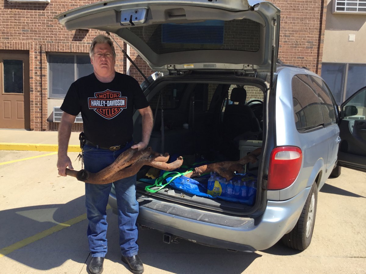

    COG, my experiences with headers is a little dated, like from the seventies.!lol But those experiences left me with a poor opinion of headers, obviously. And the fact that headers really don’t help till the higher end of the rpm range. I rarely race at the drag strip anymore and I kinda figured Clays T bird will see very limited drag strip time, was the basis for my recommendation. Exhaust leaks , to me, are kinda like scratching your fingernails on a chalkboard, really bugs me. I just figured the stock manifold would be as good, cheaper, easier. If he buys most any header, he will probably have to do some exhaust rerouting. More $.
    But here are the manifolds of choice for an FE, see pic.
    Bones
