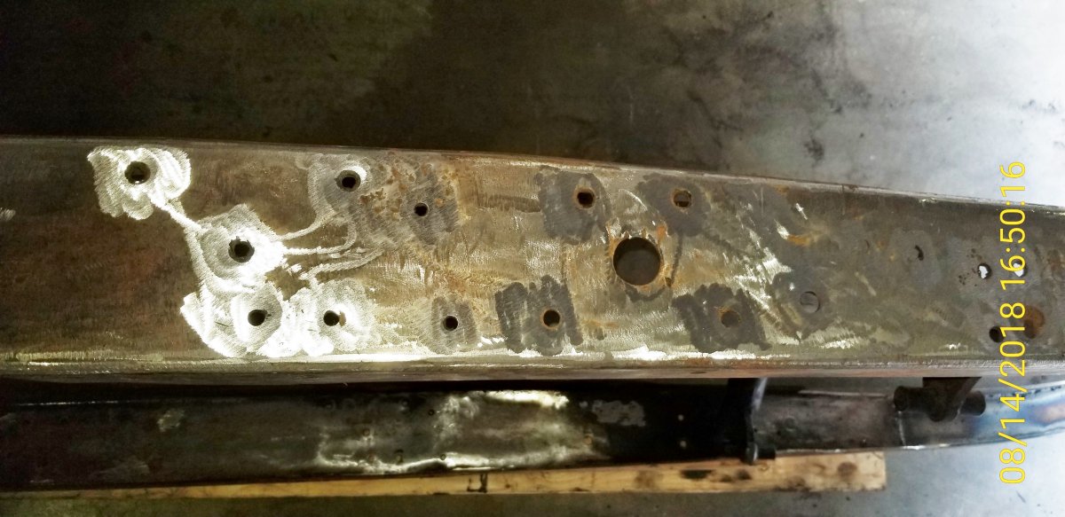

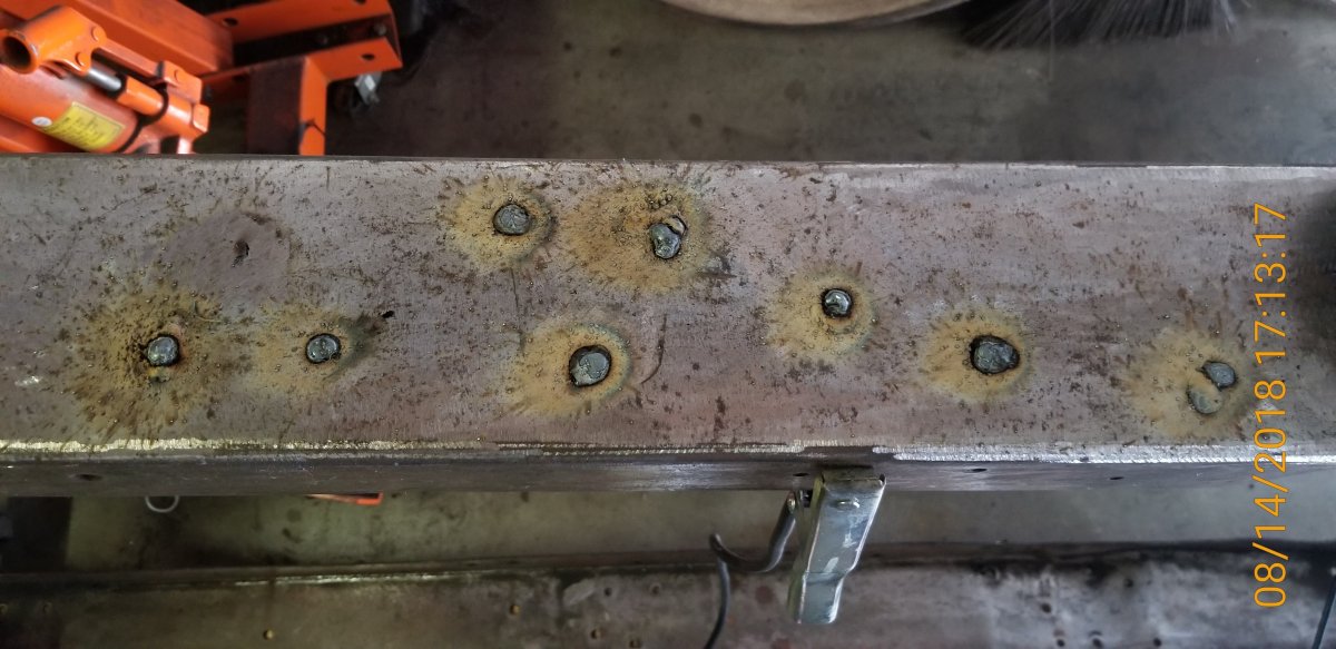

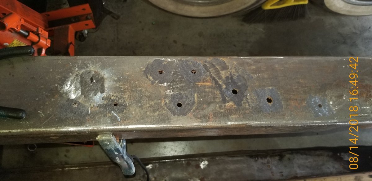

  3. Moving along to my '31... Spent some hours prepping and continued to weld in those infamous number of holes in the frame rails. Just have a few more to go and one side will be finished. Noticed the heat may be too intense, causing some low spots around the holes. No big deal, will come around much later and fill all of these with a good metal filler to smooth out my rails completely.
    I bought a round steel rod with a length of 3ft. to weld across the frame rails - near the frame horns to hopefully keep the frame horns straight and true when I attempt to use my porta power to bend the p***enger side rail back to 90 degrees. I need to cut the small block Chevy frame mount on the p***enger side, so the frame rail can move hopefully. At least that's what I'm thinking...

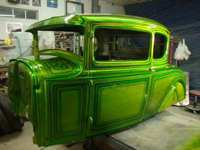

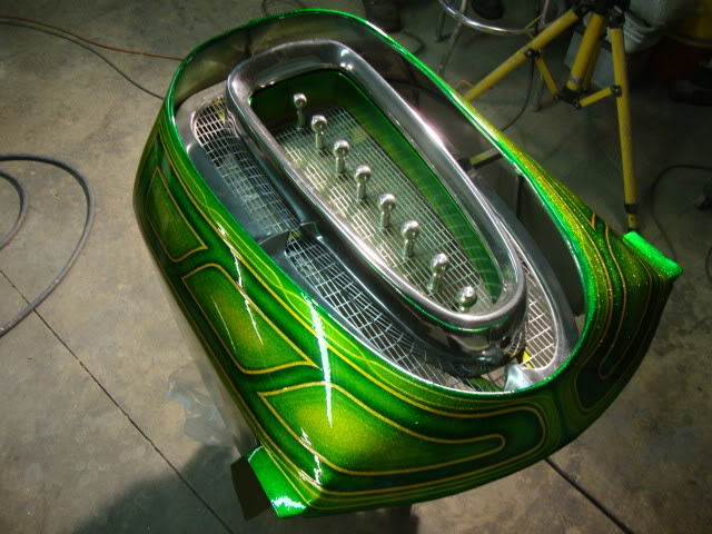

  17. CLEARLY, we are on the same page... Check out this KILLER, Tangerine metal-flaked beauty - this panel styled paint job is what I'm planning for my '31. The Green metal-flaked Model A was featured here on the HAMB many years ago and CLEARLY blew my mind!!! Only issue will be that I will need to take out a mortgage loan from a home I don't have for a paint job like this...

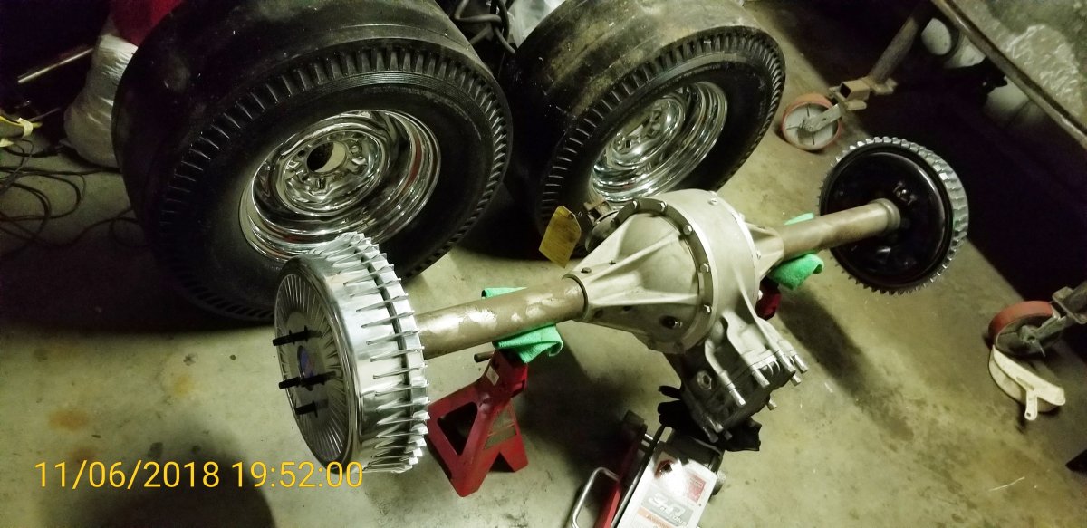

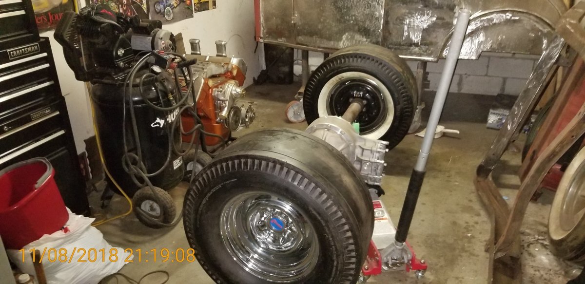

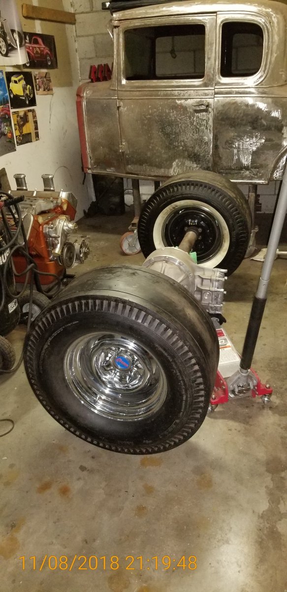

  21. Went back in my garage tonite to see how my 10" pie-cut Radir slicks looks like mounted on my QCR. Been drooling about this for a long time. Tried a few exhausting tries to no avail. Keep in mind these slicks with chrome wheels are HEAVY... I had bought these awesome, authentic chrome reverse wheels (NOT universal lug) from Stockton Wheel ways back. Apparently, the back spacing on my wheels are wrong to mount onto the polished aluminum finned covers for the drums. I'll confirm this tomorrow when I mount the slicks without the finned covers.

    Can you use a different drum? Can you can run those on the front? Plain drums on the back... They will be buried in the deep dish anyways. Can you chrome standard drums?

  25. Not a big deal at all guys... I was just hoping the chrome steelies would work, never planning on using them with the finned covers way back. I have a set of four of those finned aluminum covers, which I plan on using for sure. Why? Because they will look AWESOME on all four corners on an open wheeled hot rod! Just have to figure out what back spacing is ideal for these finned covers. I'll contact So-Cal where they came from.
    Looking at the QCR, I do plan on polishing out the entire center section, painting the tubes Tangerine Pearl like the rest of the frame to set if off VERY nicely within the frame.
  26. For the most part, I have a great set of chrome reverse wheels that fit on the QCR, WITHOUT the finned drum covers. At least I know that I can use them to get her rolling again which needs to happen very soon. You know something... In all of the years that I've seen hot rods at shows and cruise nights, even while publishing a hot rod magazine called Golden Chariots for almost five years, I have never seen ANYONE with a QCR and pie cut drag slicks in person.

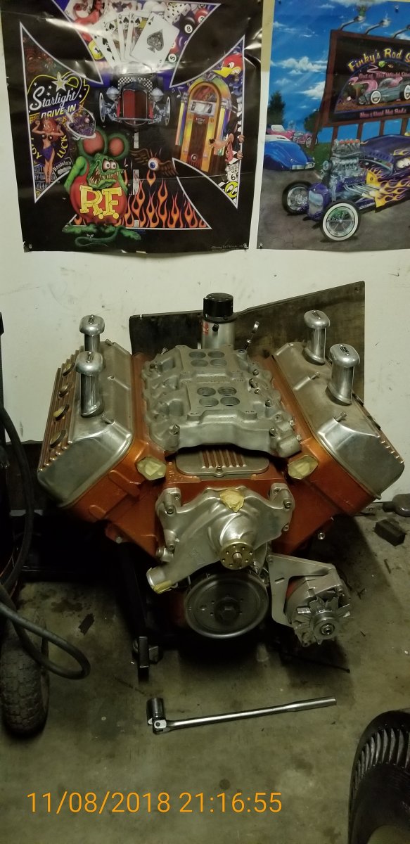

    Threw in my hemi for the hell of it... Supercharger will come eventually down the road...
