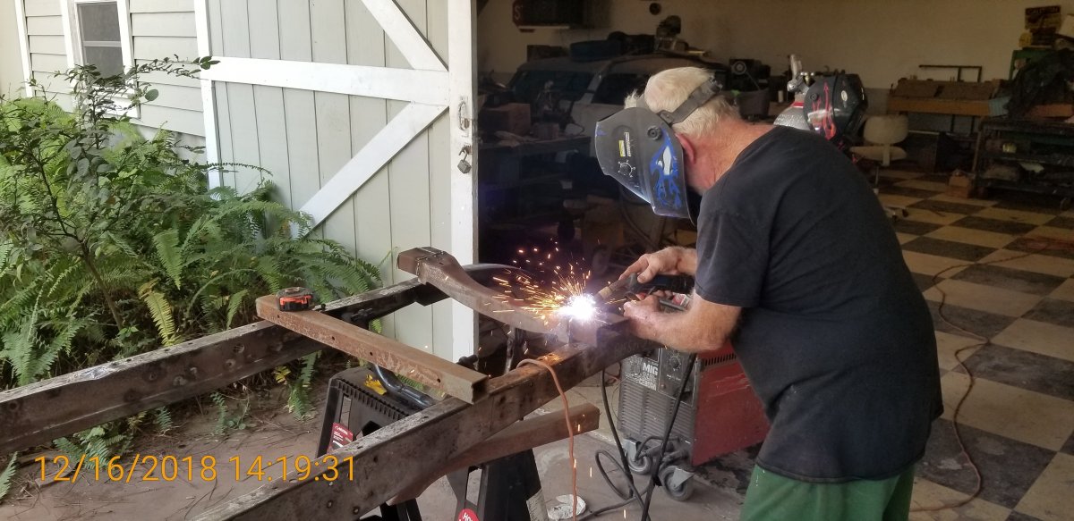

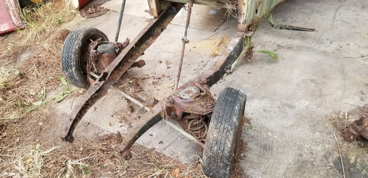

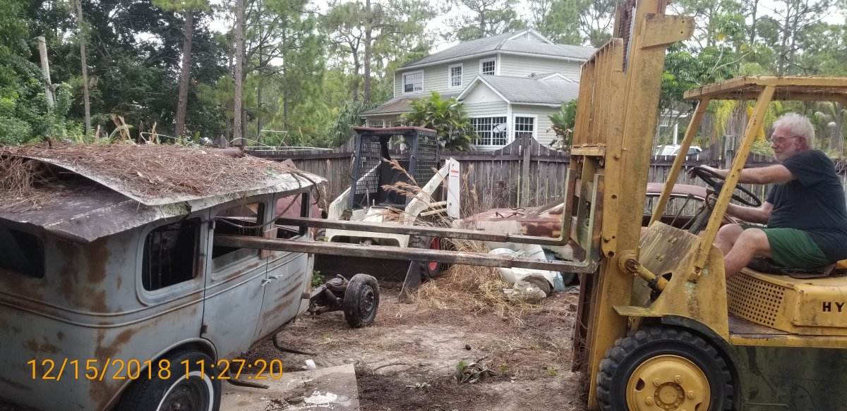

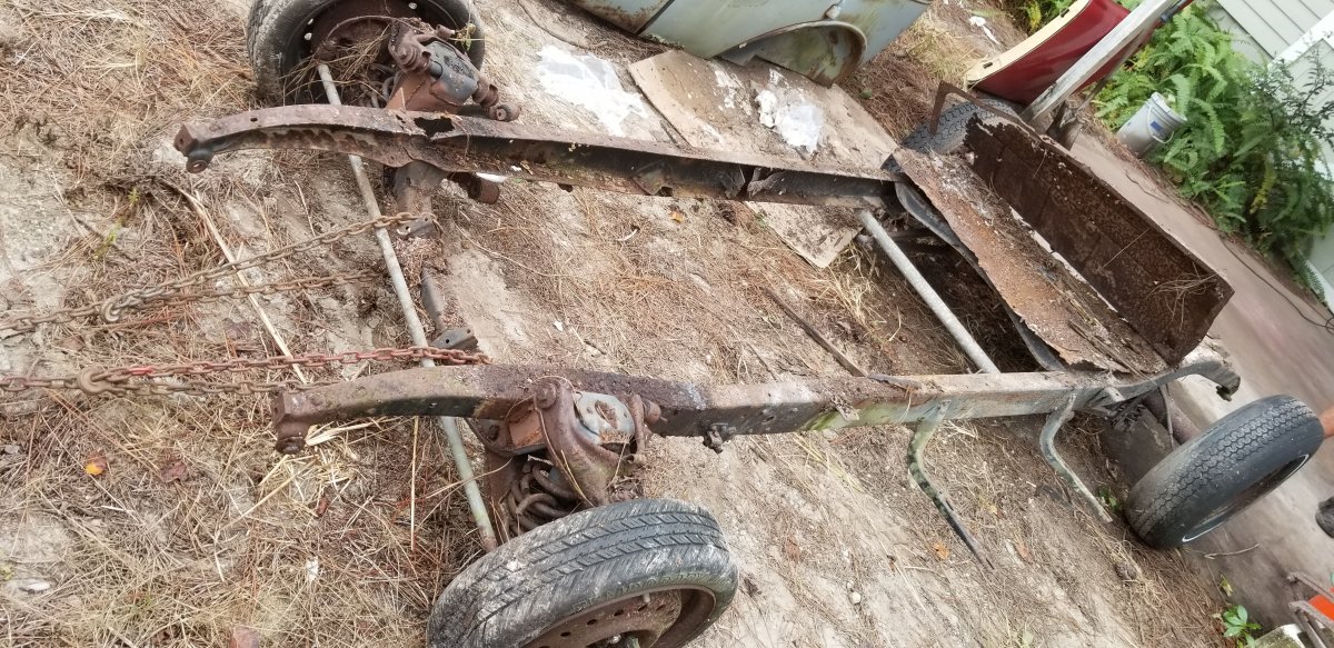

  6. Well HAMBERS... The ch***is that I sought after from a friend/Hot Rod Shop owner's '31 Chevy Sedan turned out to be NO GOOD - see pics. My original frame is MUCH better and decided that it WILL be straightened and modified for my new suspension installation.
    As anyone can imagine, this is very exciting for me, because over a year ago this past November, I started this build with the re***embly of my Winters QCR. Then I started dis***embling the entire car. After a few months of removing all of the paint on both the body and bare frame, this is when I discovered that the p***enger side frame rail just ahead of the firewall to the rear of the front cross member was bent inward. Calling shop after shop, not one could straighten my frame, so the build stalled to a halt.
    Yesterday, I rented a flatbed from Home Depot and delivered my original frame, front suspension and everything between EXCEPT the quick change to my friend Dave at his home/shop. Needed someone else to help lift the QC to no avail - hopefully during this week by another friend I work with at his hot rod shop. Finally, after more than a year, the new suspension installation on the frame has begun. Dave worked on extending the width on my new '32 Ford front cross member so it will fit snug inside the rails from one end to the other. I'm extending the wheelbase another inch to 110 inches - need the room for the hemi engine and the supercharger's belt pulley down the road.
    Talk about pressure, I need this frame rolling on all fours within 2 weeks before my '31 gets towed behind a 16 ft. Penske truck headed hopefully to our new apartment in Mesa, Arizona...

  8. Stogy, after the sedan body was lifted off the ch***is, the floor just fell apart, something we expected. We wrapped both doors with chain to keep the body intact and after all was said and done, the body is fine. As I mentioned before, he will build his '31 into a stout dually hot rod pickup with a custom 9" or 10" boxed frame. Just wished I had the chance to see his ch***is much sooner, being buried in thick brush just eliminated any good viewing of the frame. As anyone can see, this ch***is was a rusted mess. Before he gets rid of it, we can use some frame pieces from parts of the C channel.
    I took some important measurements before I had cut out the original Chevy front cross member, to allow us to weld in the new Ford crossmember where it needs to be, adding another inch forward to make my wheel base just a bit longer than stock. The rear cross member was at first, welded in straight for the rear installation and shocks back in '96. But after my '31 was going under the knife for all of the replacement patch panels on the entire bottom of the coupe, Gary Chopit from Chopit Kustom Cars had tried to bolt down the body and discovered that my frame was not parallel to each other in equal length. Body mounting holes were not lining up. So I hauled the frame out much further east on Long Island (where I grew up) to a frame straightening shop and pulled the frame back in parallel. Body dropped right back on. This straightening procedure caused the rear cross member to be crooked in location on one end.
    Dave told me that he had cut out the rear cross member and will replace with another one to tack in that he has in his shop, adding the tabs for the coil-over shock installation. Next, we will use my porta-power to try and bend the p***enger rail back to 90 degrees, knowing the front cross member tacked in will prevent the front frame rails from bending with it. Or at least this is the idea... This is a great start no???
