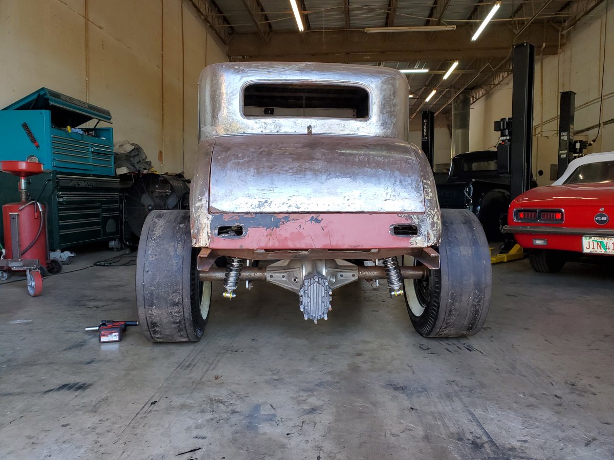

    Finally had our first crack at my hot rod at my work shop - couple guys down from Greg's shop helped us place the body back down on my frame, been just over a year since its been off.
    First and foremost - seeing the new suspension just blew me away! First thing I noticed was the incorrect position of the centering of the rear slicks in the wheel well. It looks like Dave and I pulled the rear too far forward when we spot welded the front bracket that holds the traction bars. We'll snap off this bracket and pull the rear ***embly rearward about an inch and a half or so till the slicks center up in the wheel wells. Right now, the slicks are right at the front edge of the wheel well. An easy fix. Greg suggested to restore those ancient ladder bars and add new heim joints - we'll see...
    Oh my God, when a plan that comes to mind and actually came out perfect - I modified the rear of the frame when I removed most of the gas tank support that houses the gas tank. I first placed the gas tank apron back on the rear frame, saw the dirt shadow of where the body sat. I used a hole for a reference point on the frame and measured the outer edge of the shadow and added 3 - 4" of where I wanted to cut the outer edge of the frame, so only this short area of the frame rail would stick out from the body. Just like a '32 Ford! You can see from my photo how well it turned out! I will box the end of these rails and allow a home made chrome or polished aluminum circular nerf bar to grace the rear of the body in the near future. End result - look at HOW TOUGH the rear of my coupe is with this awesome Winters QCR in FULL view!!!! I'm absolutely stoked!!!!!
    Now comes the mock up of my HEMI... And the tough battles ahead to make everything fit around this m***ive engine. I made the right decision to place the starter on the p***enger side (never thought one can have this option), giving me more room to install the Borgeson joint, steering shafts to my new chromed Vega steering box. What we are concerned about is the header clearance and my 8 - 10 quart performance oil pan, having no rear sump. I need to get some important measurements of the depth of this oil pan, rear of the engine to the tip of the harmonic balancer and hopefully a determination of how far in front of the hemi will the blower pulley ends up. Mike @INVISIBLEKID should give me an idea. I need to move the firewall back as I expected to accomplish the future of a Weiand Supercharger setup that I had when this engine was built, but sadly lost it from the engine builder... Don't really want to talk about this...….
    Oh and of co****, that dazzling front end, completely in chrome... I am in communication with Posie's Super Slide Springs to help me with hemi application (heavier and much more spring weight) leaf springs should the need arise. That front end will slowly pull itself downward when the REAL hemi gets dropped in.

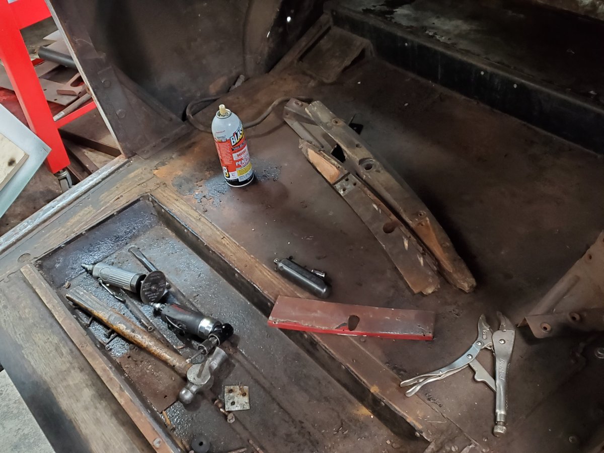

    Next on my to do list is waiting for my supreme wood fabricator (down from the front of my shop) to measure up a new pair of Redwood A pillars which are in DESPERATE need to replace as mine are shot. P***enger side was so bad that a friend helped me replace with a bogus one to keep the door more secure somewhat.
    Hey guys, need some advice: with both doors off the body, is it somewhat dangerous to cut my firewall back and reweld, or is it more stable to wait until the doors are back on with the new pillar wood? The body is secure on the main oak floor which was installed way back in 1996. If I run two steel bars and tack weld them in an x shape, inside the cowl, tacked where they meet in the center, wouldn't this be sufficient enough to perform the firewall cut and placed back a few inches of much needed space for the supercharger pulley to clear the radiator? Any advice would be GREATLY appreciated!!

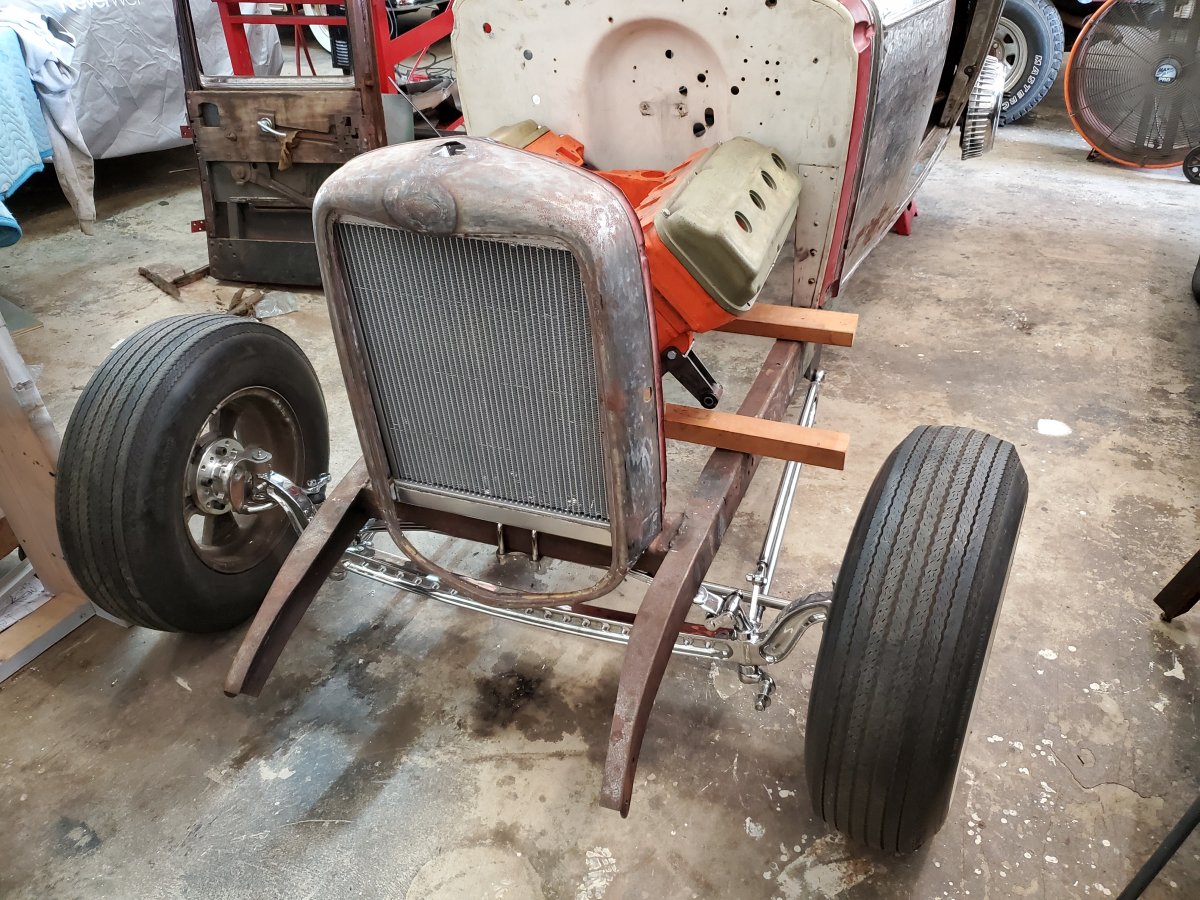

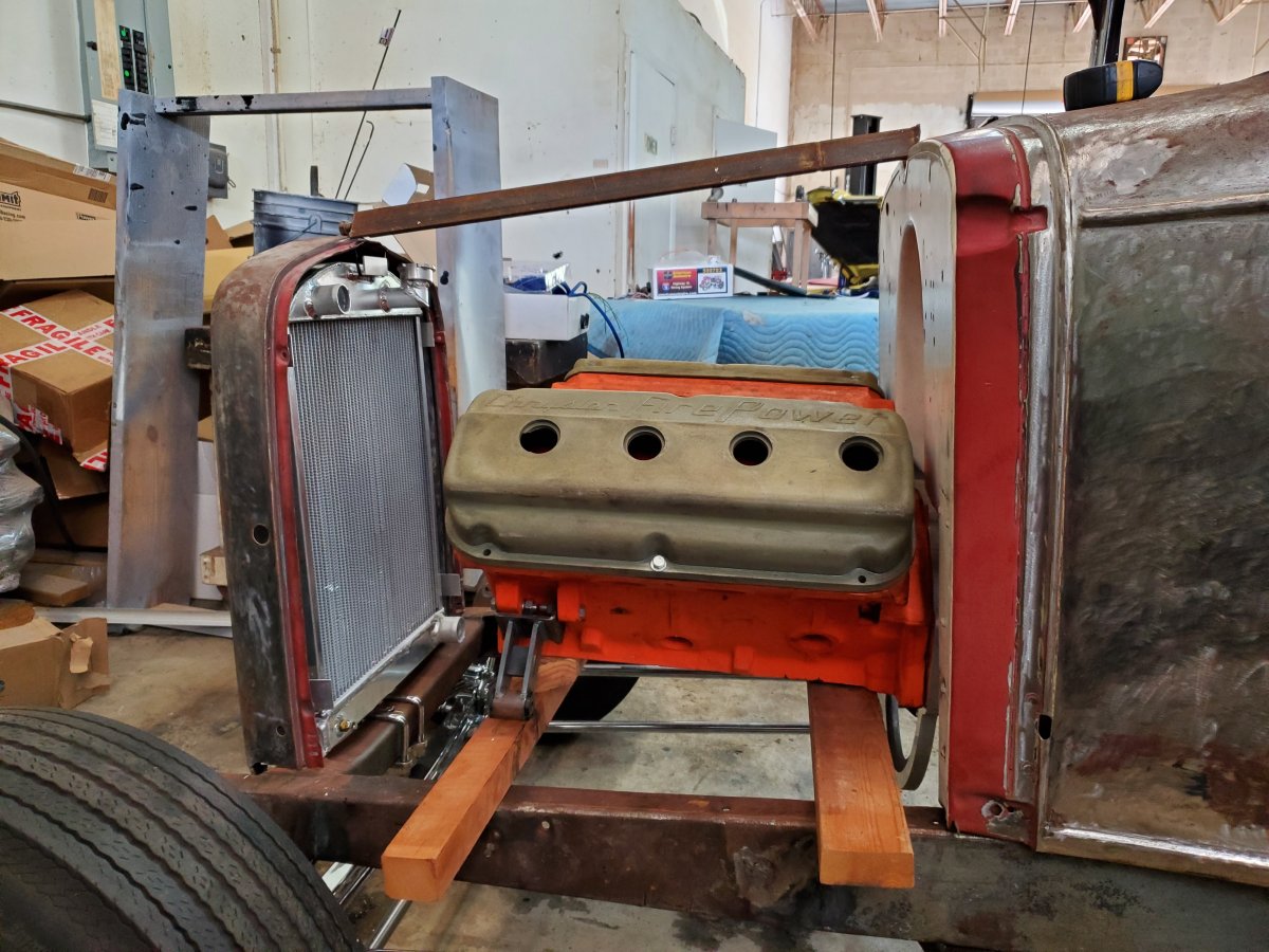

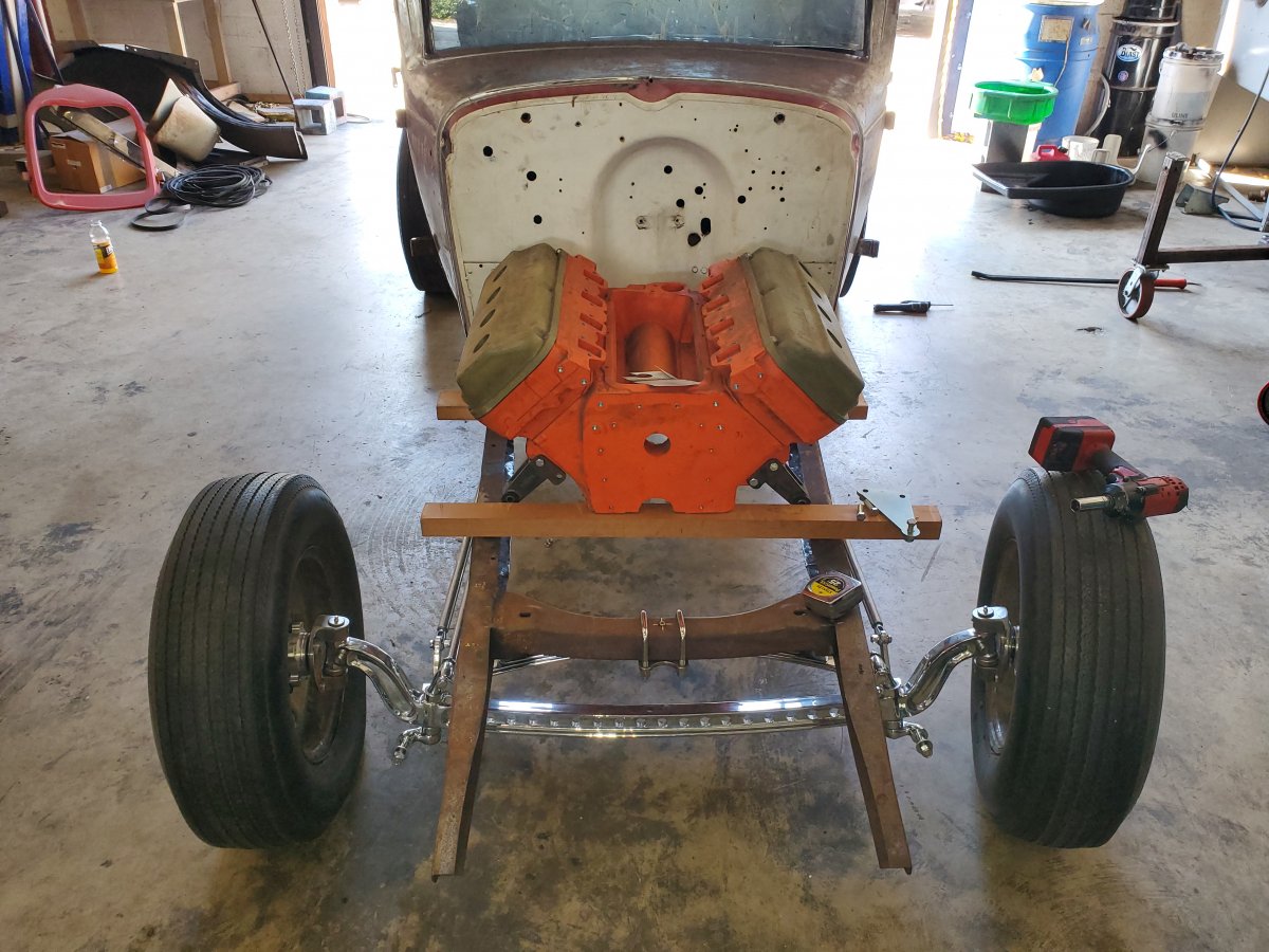

  30. Some more progress... Look at the splintered remains of 88 year old pillar wood, my friend Brent is amazing at his wood working craft once you see the finished pieces! My a-pillars are just about done, the driver side was started first, measuring and fabbing up some templates to make sure they fit snug against the body - more pics to come. I'm hoping by tomorrow sometime, both will be completed and installed. Might have a tough time finding some flat head hardware to mount my doors, but will give this my best shot.
    While this was happening, I mounted my radiator and grill shell to see where I'm at for placing my mock hemi in the correct place so the blower pulleys will have the 10" clearance they need to clear the electric fan ***embly with my radiator. Last photo shows the lowered height of my grille shell than my cowl - never cared for the grille shell higher than the cowl on most hot rods. On Sunday, we plan on cutting the firewall and moving it back 2-1/2" to give me more clearance for an easy engine removal, straight up with no interference whatsoever! Hoping we can accomplish the engine frame mounts to mount the hemi mock up and other tasks before I roll her up the rental trailer and hitch my hot rod behind a 16ft Penske rental truck headed west Miss Tessmacher - DUE WEST! From an early Batman movie... This Tuesday mid morning, my brother Scott and I are leaving Florida for good and will live in the state of Arizona!
