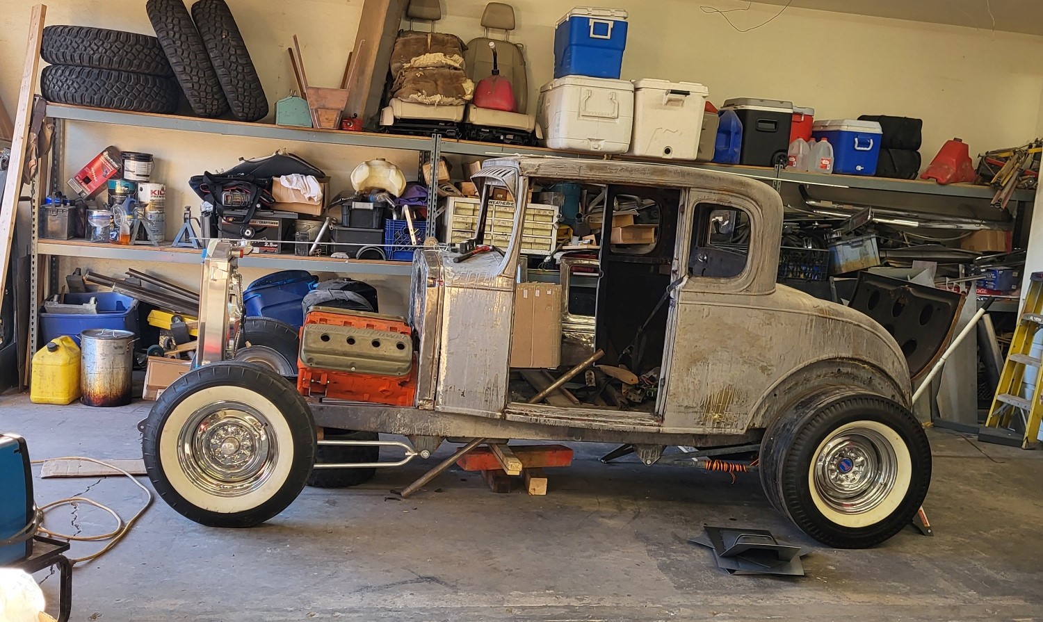

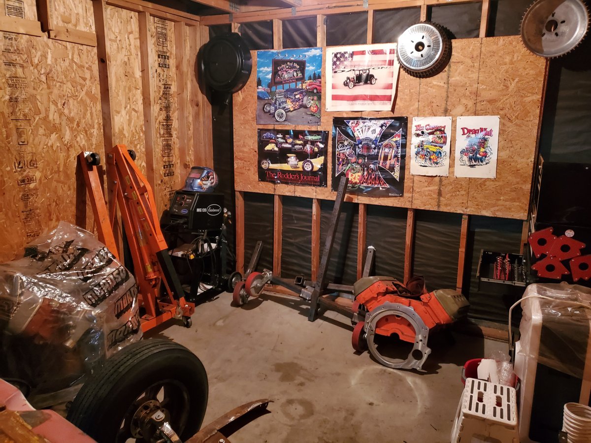

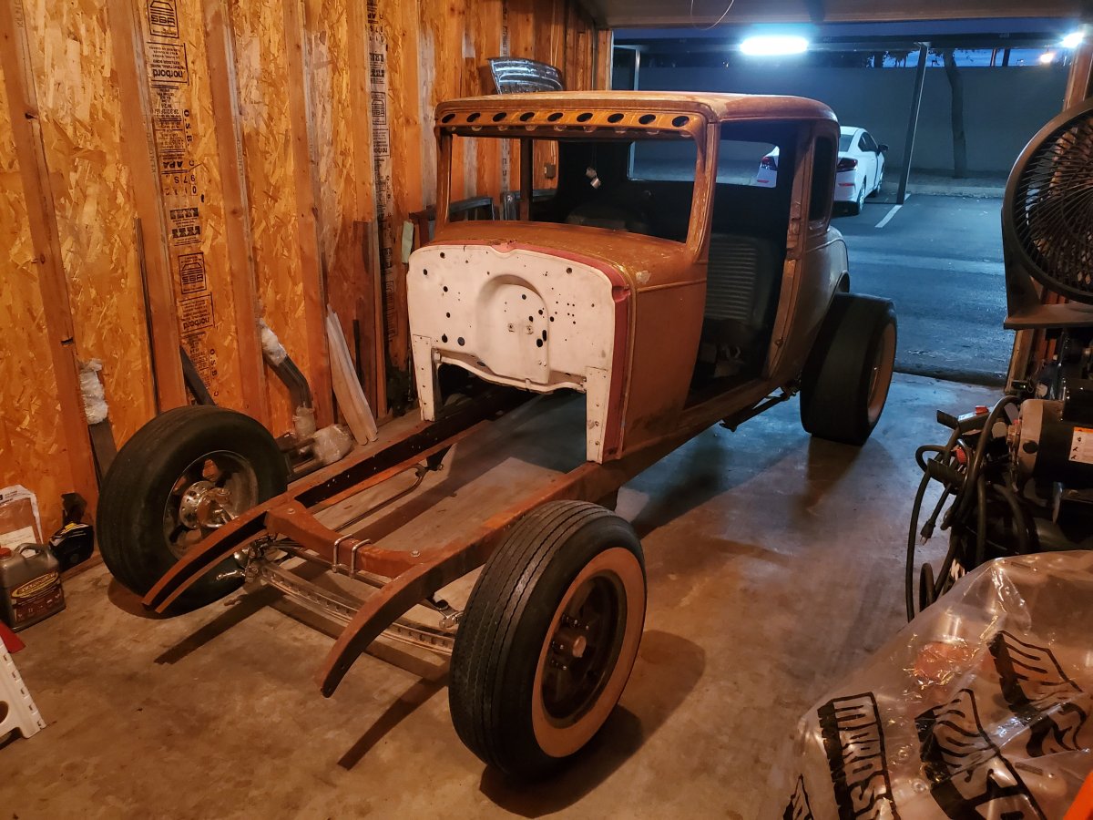

  4. Okay, I finally got the word from my new community that a garage was available to me and moved my '31 and equipment last Sunday morning from Public Storage. There's a set of garages directly to the left of my new apartment and could not be happier... Although my brother and I could not believe some of the bad luck we've experienced with the move to our new home:

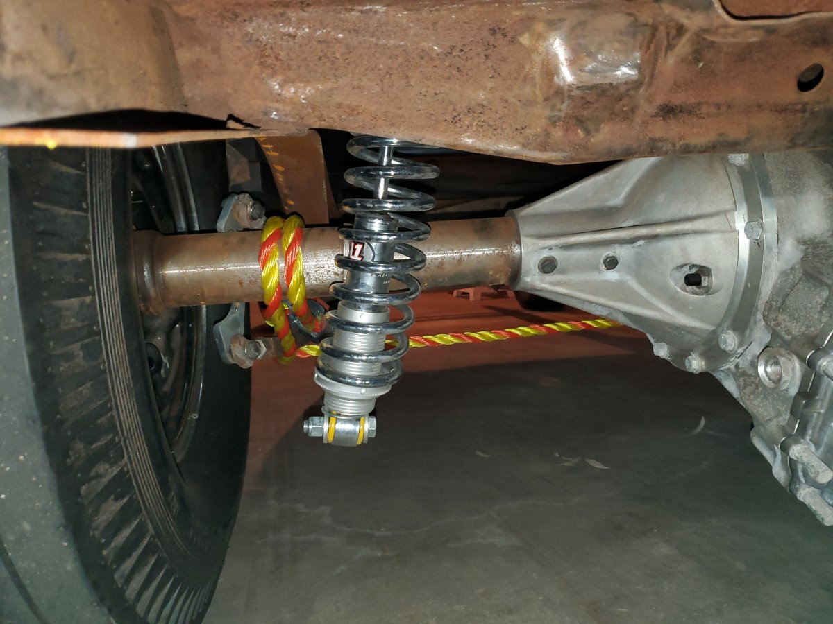

    My rod took a hellish beating on the trailer, making its way here to Mesa - mostly in Louisiana and Texas, trailer was bouncing violently while cursing my head off to boot... Broke the spot welds on the rear and bent the mounting bracket that were on the ladder bar on the driver side - see my photos. Before I moved the rod to its new home, I had to secure the rear with tow rope, wrapped around the axle tube and secured to the ladder bar on both sides. Did not want to take any chances moving the car on a tow dolly.
    Of all things that could happen, the wheels on the engine dolly holding the mighty hemi broke apart in pieces, leaving only one wheel left to roll the engine. Keep in mind that this elephant engine weighs 750 lbs... So I had to keep the hemi lifted in the air on the engine hoist - with my brother Scott's help, rolled her into my garage safely.
    As you can see, I have a lot more space to work with, being 10 x 20 AND having an electrical outlet to power my equipment. All in all, all of the trouble getting here will be WORTH IT!!! Gotta get some of the guys I work with to help me lift the body off again to begin the ch***is needs.

  18. Tell me about it Mr. Stevens, just a re-cap on current events, I bought new hemi mounts, the style my buddy Dale suggested, new parts to re-do my rear upper and lower coil-over mounts and new rear ladder bars to finally secure the Winters QCR. Bought new boxing plates, front to rear cut specifically for my rails and a square tubed center x-member for a '32 Ford that will be trimmed down for my frame. Also purchased a new aluminum radiator with fan shroud and electric fan. With the mock up hemi plastic block with my new radiator, we'll plan to see where the hemi will mount between them. Acquired an empty 700R4 trans case, so the drivetrain should be measured carefully and installed shortly!

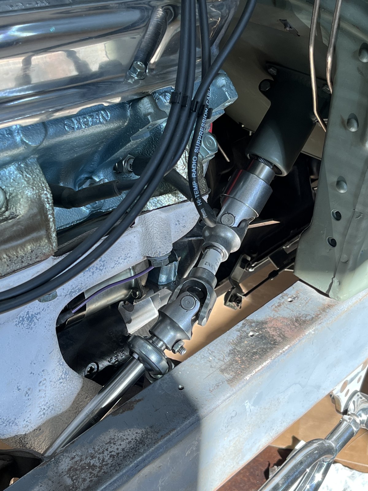

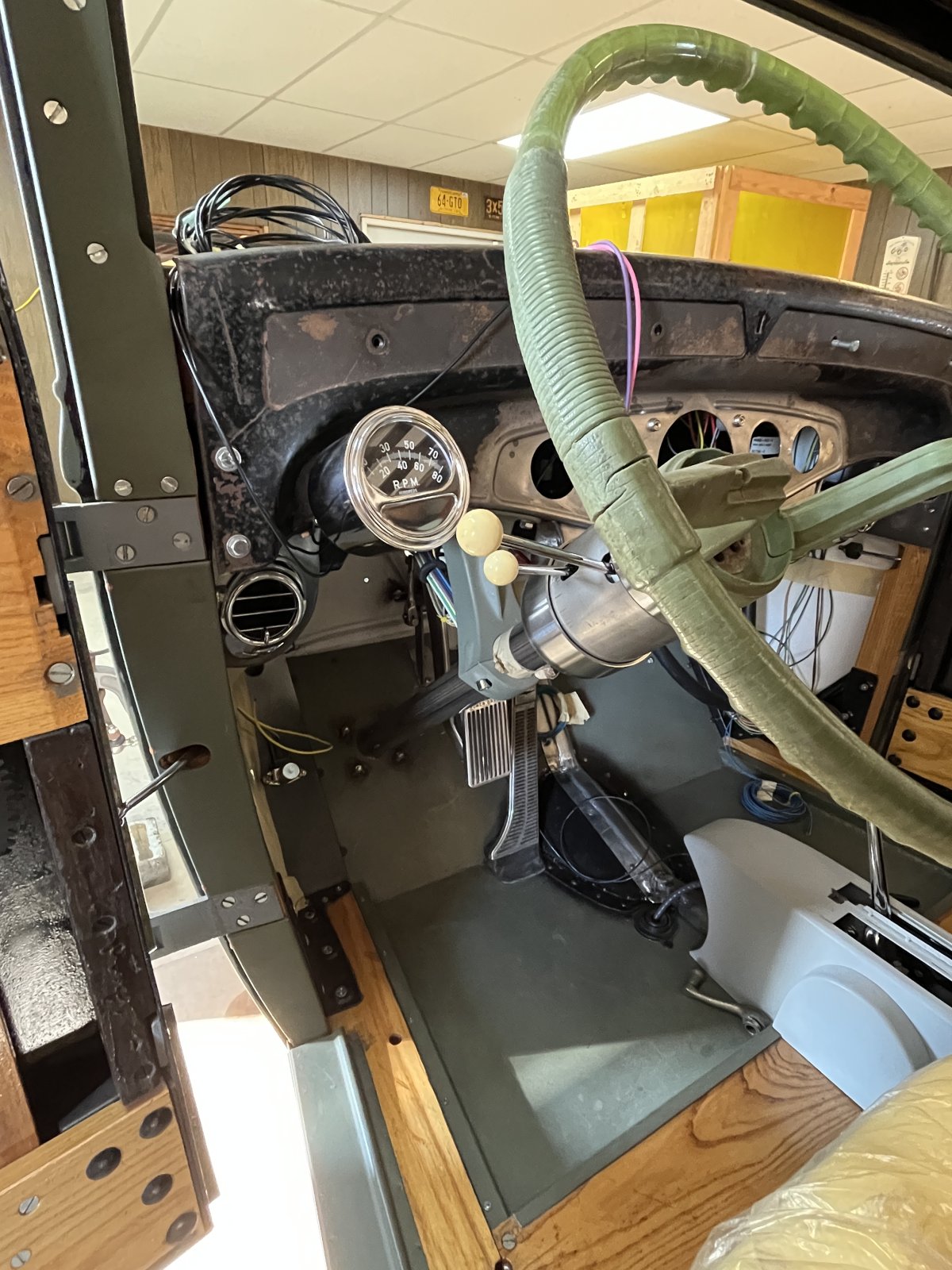

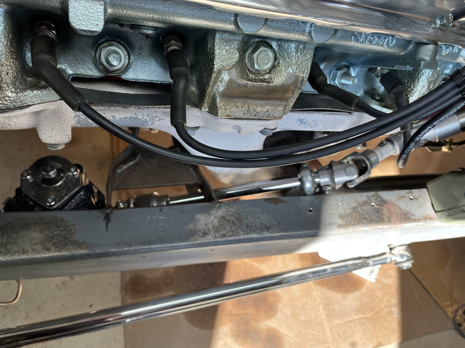

  23. Wow... Here comes the clearance issues installing the m***ive HEMI. Steering column installation - I'm running a polished Limeworks Speed Shop 36" polished column. Bought new steel toe and floor boards. Any members out there who managed to solve this dilemma - let me hear your thinking on this...
    oliver westlund and mad mikey like this.
  24. 31 B'ville
    Joined: Feb 7, 2009
    Posts: 421
    31 B'ville
    from SE Pa
    I had clearance issues also , but probably not as bad as a hemi. I used a 32” Flaming River tilt column through the steel toeboard and a support bearing with several universals to get to a Vega steering box. My steering wheel has a 5” deep dish, but if you use a flat wheel the total length for the column and wheel is very close to the same.
    My manifolds are inside the frame, if you use headers that are outside the frame you may have more room than I do. A0182F1C-558C-469B-A3FC-61FB5A39FBFB.jpeg 1A7D69CB-B0EA-4D8E-AE14-4F09A7C1839A.jpeg 27E61964-07FB-4470-AFB6-254B9D721842.jpeg
  25. Yeah brother, your steering setup is REAL TIGHT, more so with your exhaust manifolds inside of your frame rails... Pat yourself on your shoulders for plan & execution sir! My exhaust thankfully will be the opposite, OVER my rails. My mini starter will be mounted on the p***enger side, freeing up some much needed space. The hemi block is so big, that it will block the steering column almost directly, going over some of the clearance issues with Dale. Call me crazy, but I thought we can move the engine closer to the p***enger rail just a little bit if this can make a difference. Maybe raise the hemi just a bit higher as well if need be. With a mockup block in plastic, these tasks are easily attainable, moving 10 to 15 lbs... Really appreciate your input @31 B'ville!

    Thanks for the kind words. Moving the engine up and/or over could certainly help. The factories also did this sometimes to gain clearance. Here’s another option. http://www.wizardsteerclear.com/store.html
    I explored this idea while sorting out my setup but was able to do without it. Price was a little intimidating.

    You can make your own "steer clear". It is simply two sprocket wheels with DD shafts welded to them and a chain in a metal box with bearings.

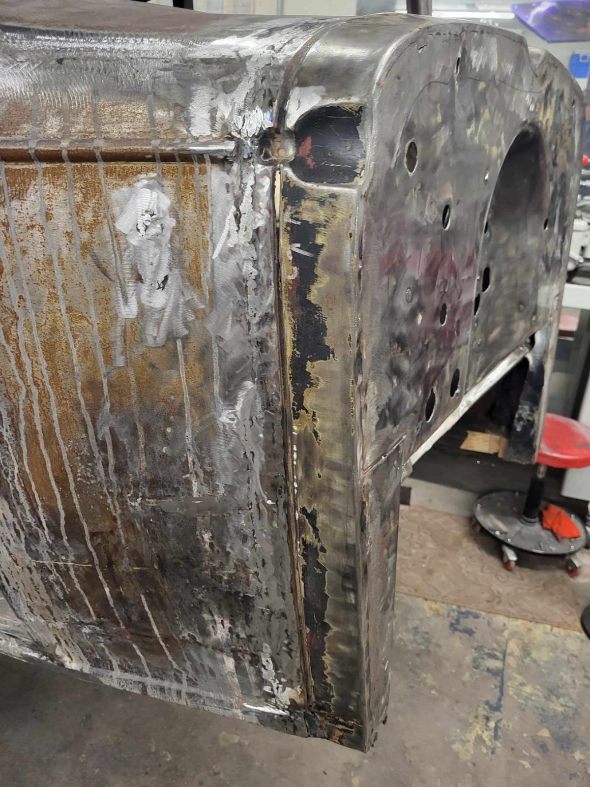

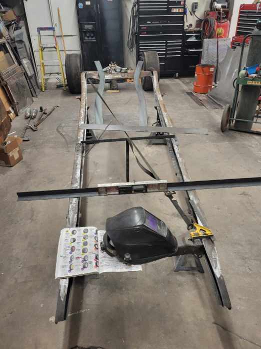

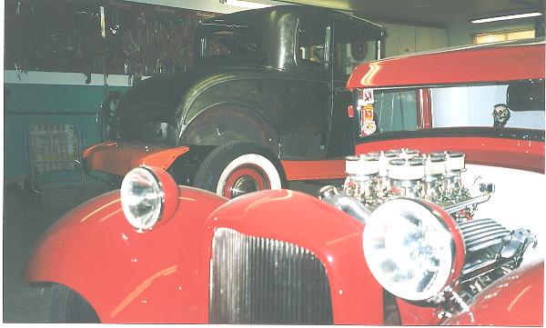

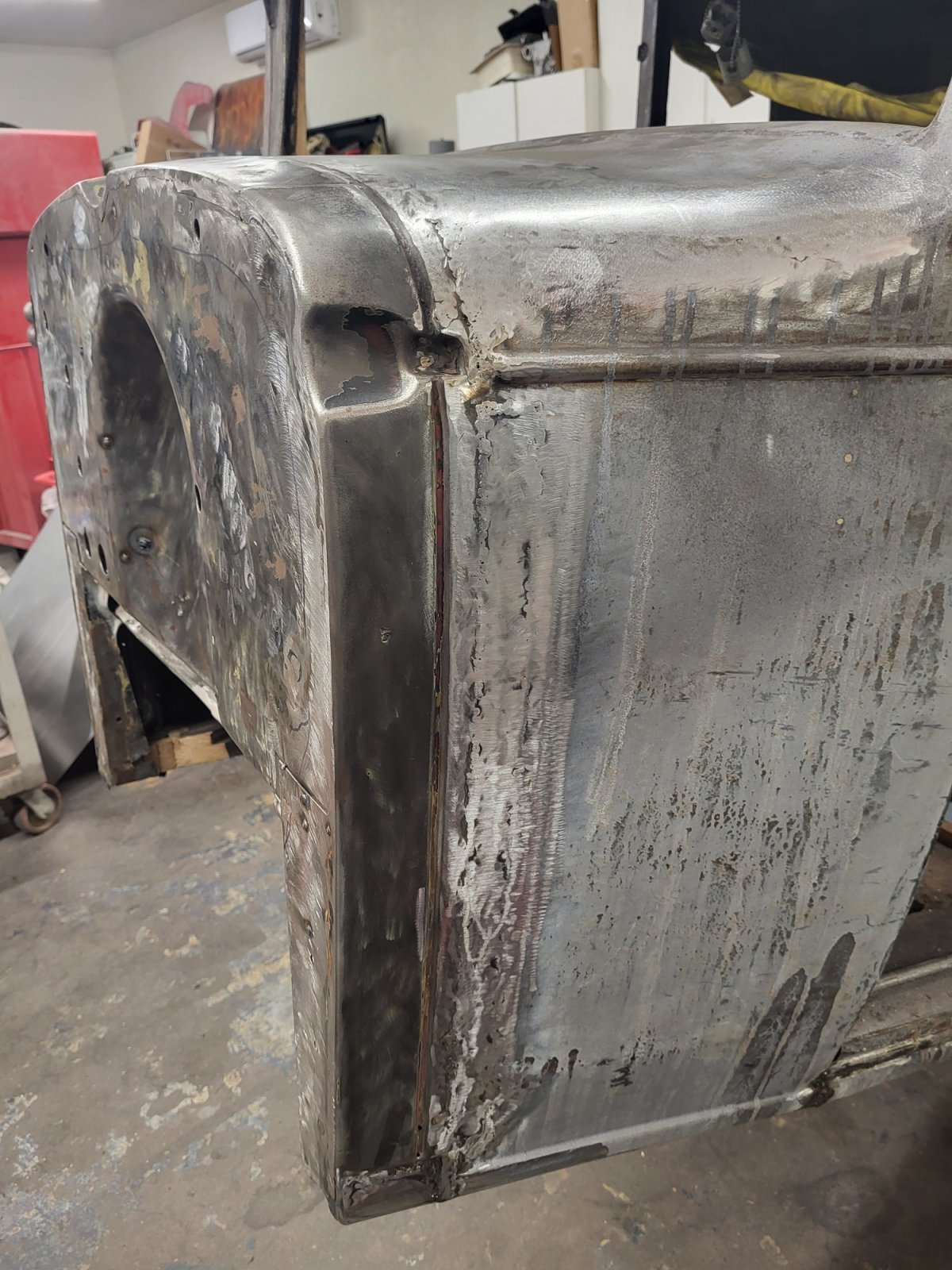

  30. Best Shot of Gary Chopit's Garage.jpg Gary Chopit's Garage II.jpg 1 - Firewall - Cowl Restoration 2023-0211.jpeg 2 - Firewall - Cowl Restoration 2023-0211.jpeg 3 - Frame Straightening 2023-0211.jpeg
    My friend Dale has been really going at it lately, impressing me more and more with each task at hand! The first day that I came over to his home in Phoenix, he showed me his '34 Ford Tudor Sedan that he built from the ground up, even finishing her up with high end body work and paint - I had no doubt in my mind that he's the guy that I wanted to perform my ch***is setup and minor body work needs! Here's the latest photos of where we are at...
    The first two photos were taken way back in 1996, when I had Gary ChopIt install my new patch panels on my '31. He also had to relax the body from a 4" gap on each side from when the body spread apart on me when I forgot 2 bolts to remove out of the original 6 when pulling the body off the car for the very first time in my inexperienced years... My '31 at that time, had to share room with that nationally famous chopped, channeled and sectioned custom Model A in his personal garage until there was room in his shop - Gary ChopIt Kustom Cars in Hicksville, Long Island New York. God I loved that hot rod - You should have seen how funny looking it was to see me fold my body enough to get in his hot rod for a small cruise within a cruise night!!!!
    The third and fourth photos shows a bunch of hours needed to place my firewall back into the cowl after I cut it out a while back, thinking that the firewall could be re-inserted inside the cowl, moving the firewall back 4 inches or so for more hemi clearance with the lower blower pulley. I was wrong. There was a sizeable gap between the firewall and the cowl all around when I had cut out the cowl band entirely. When he began welding the firewall back on, Dale pulled the body back off and placing it on my body cart helped him bring the gap much tighter and nailing the bottom of the cowl patch repair to my wooden floor. Gary ChopIt Kustom Cars (Deceased a few years ago from his shop) forgot to do this when he installed all of my new patch panels. When I saw this gap last weekend, it had to be at least a 1/2" or more, which is a lot. As you can see, filling in this gap is coming along nicely! Also, take notice of all of the damn holes on the face of the firewall are close to disappearing!
    The fifth photo shows that the front and rear suspension was removed to concentrate his best efforts on straightening my frame rails, primarily on the p***enger side where it was hit before my ownership. Dale said he spent a few hours performing this task and much relieved that he was able to do it. As you HAMBERS already know, this issue has plagued me for as long as 28 years of owning this bad *** hot rod! Now he's ready to install the boxing plates, which he mentioned that he would start this weekend.
