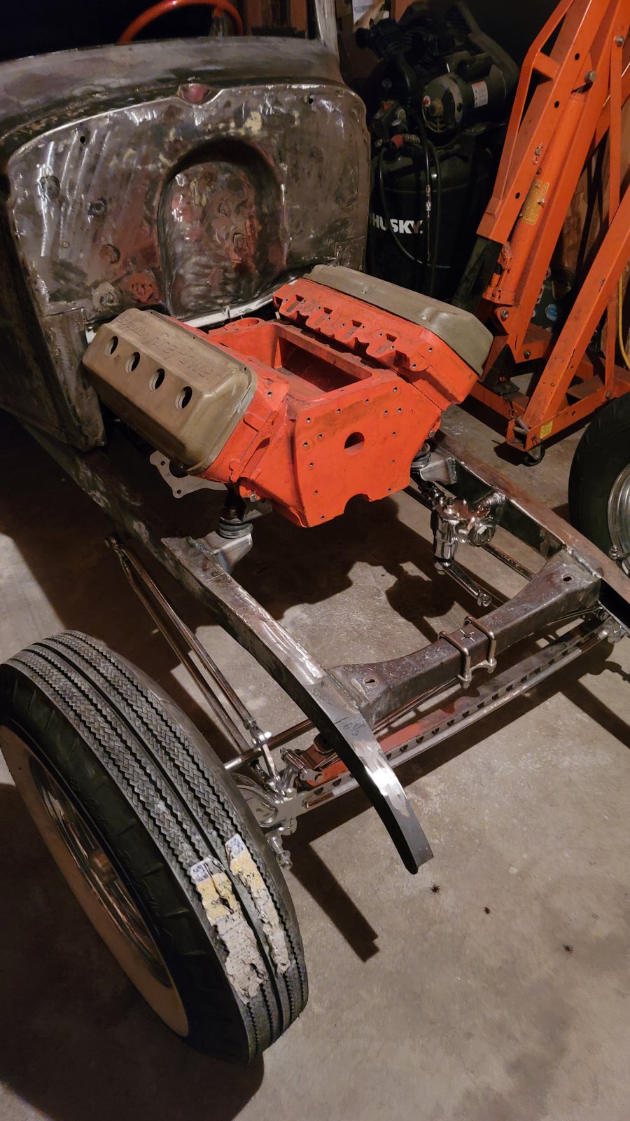

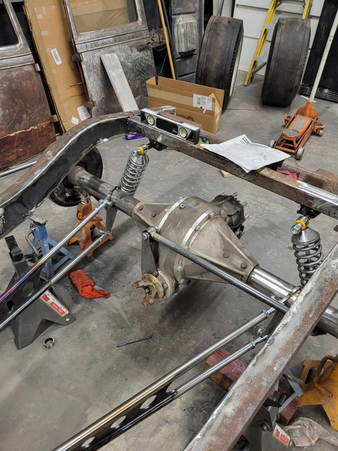

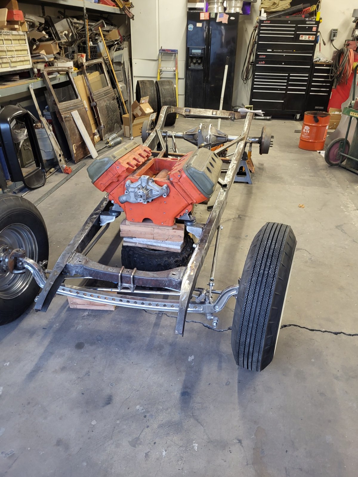

  1. Dale just sent me more photos of his installation of the boxing plates, new hemi mounts, the center x-member with the trans mount, the rear ladder bar kit and course, the front and rear suspension. Every task he did is only spot welded at this time.
    Looks like he will install the rear cross member, coil over shocks/mounts, plus the rear panhard bar to finish up the QCR soon enough. He moved the Ford front crossmember forward a few inches to get the needed 9" or so clearance for the lower blower pulley. At some point, Dale will install the front panhard bar and my chromed Vega cross steer box and disc brake system to finish the front end.
    4 - Center X-Member 2023-0212.jpeg 5 - Center X-Member With Hemi 2023-0212.jpeg 6 - My Frame Boxed and Hemi with new mounts 2023-0212.jpeg

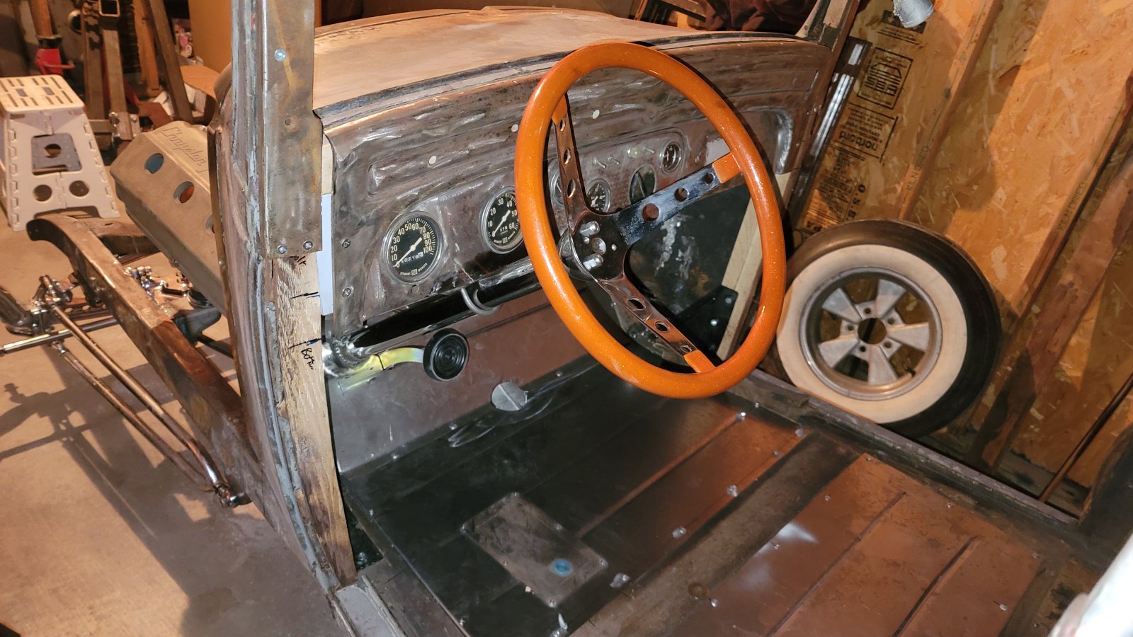

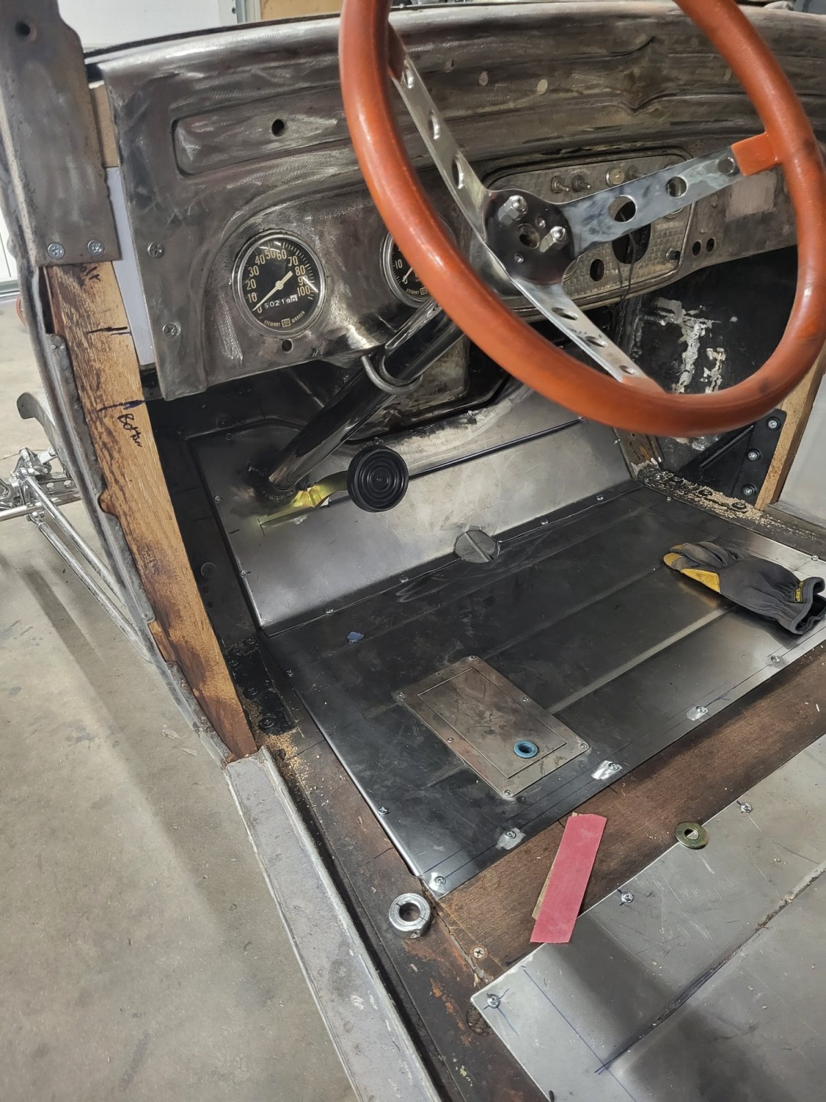

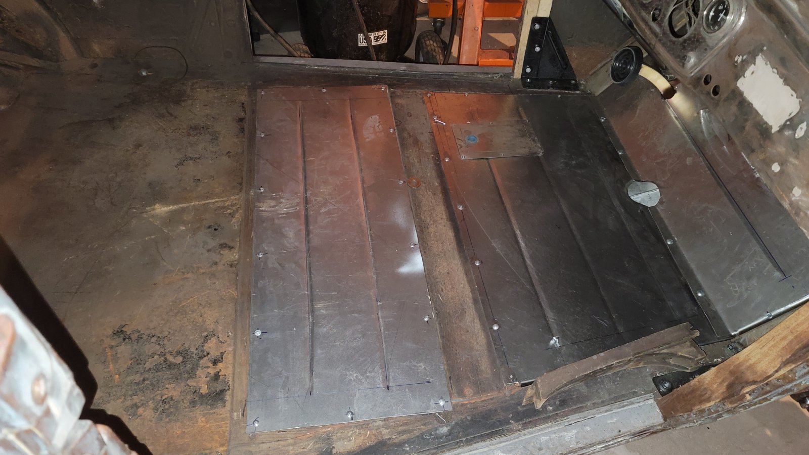

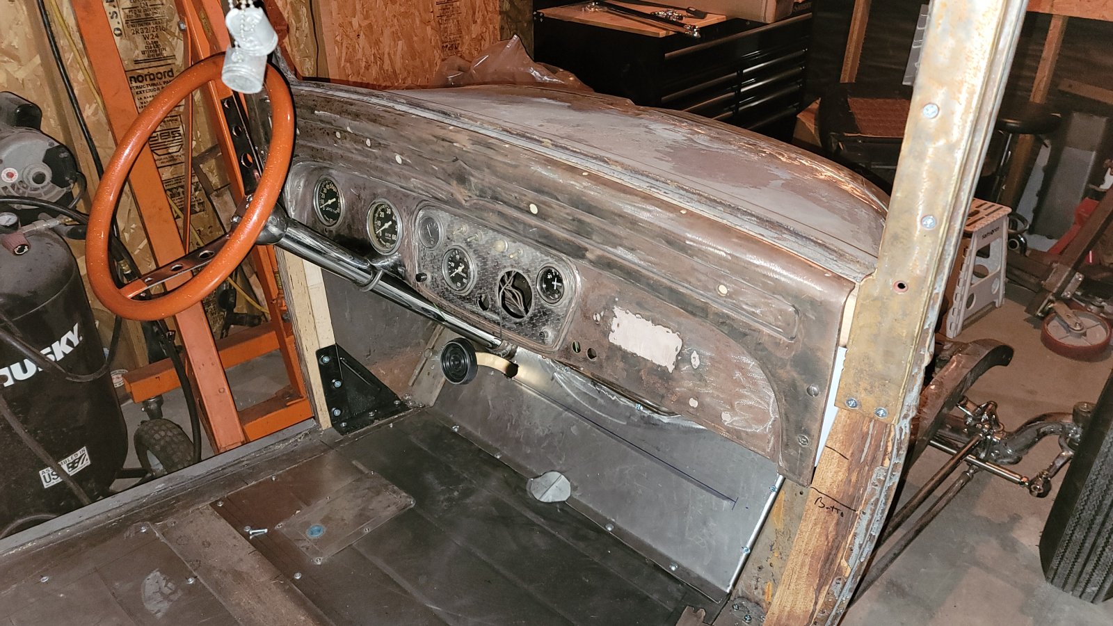

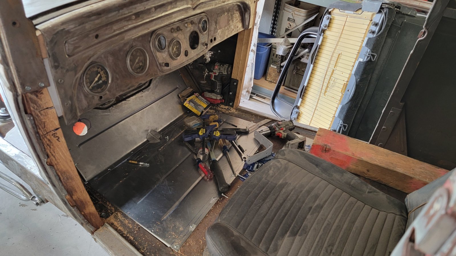

  5. Went over to Dale's Hot Rod Garage last Sunday afternoon and was delighted that he's on the home stretch in finishing up my ch***is setup! He has only one left of the center x-member square tubing to weld in when he has my dual master cylinder to mount in my frame. He needed to take some photos of the ch***is before he placed the body back on recently, but he mentioned that the body will come back off to finish the master cylinder.
    In the meantime, Dale had me sit in the coupe on one of the '59 Thunderbird bucket seats that I brought over to begin setting up the angle of the steering column. Still shaking my head that my column will go through the new steel floor and had more room of clearance of the hemi than we thought. I was missing the bottom bearing of my Limeworks Speed Shop polished hot rod column, so he will go the hardware store to pick it up and begin setting up the steering ***embly with a few steering u-joints to have more clearance around the engine block. We're thinking that we may have to add a small notch to the engine mount for the polished D-bar when it's attached to my chromed Vega cross steering box (his steering box is loosely mounted for mock up). Looks like Dale and I will tow my hot rod back to my garage in early March!
    8 - New steel floorboards 2023-0219.jpeg 9 - Steering column setup with me sitting 2023-0219.jpeg 10 - Dale & Son David looking on for column setup.jpeg

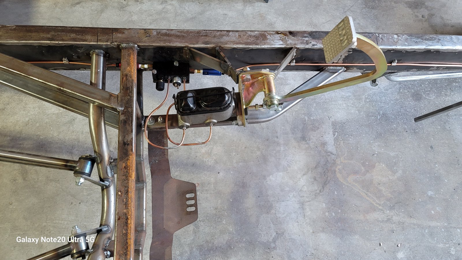

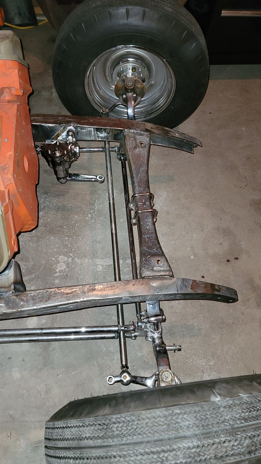

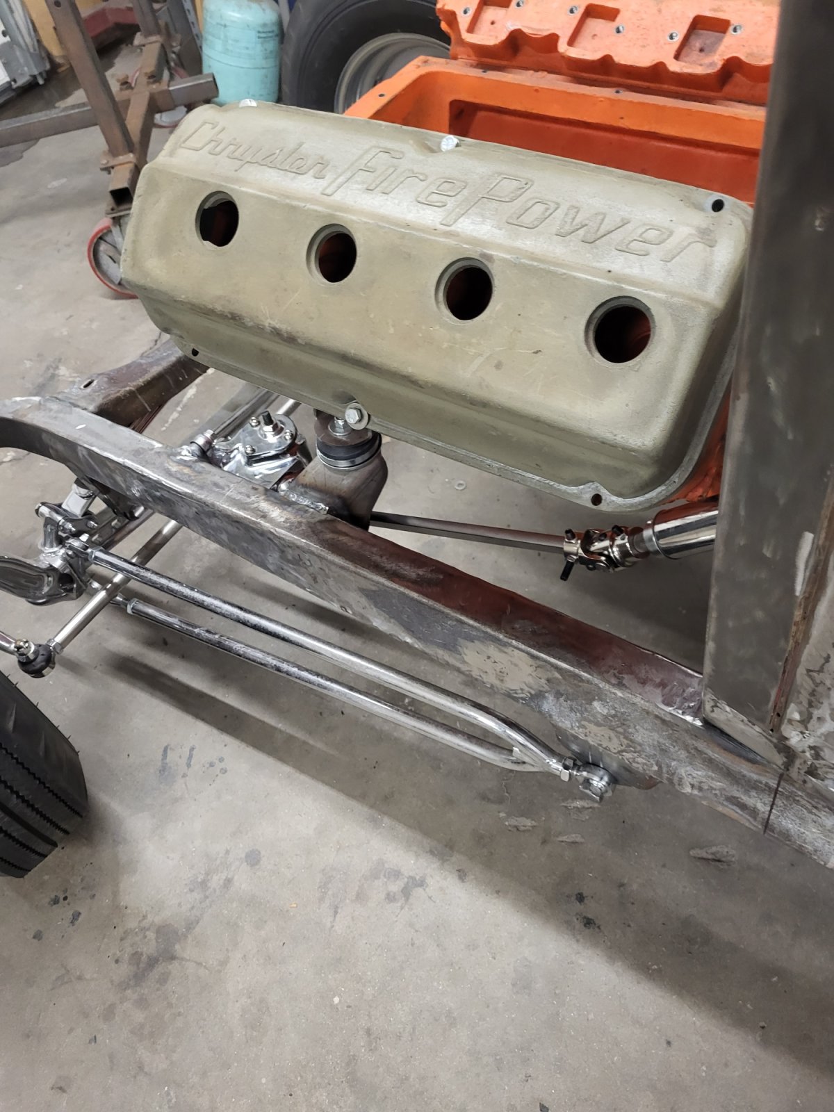

    At this moment, I'm on the home stretch of completing the ch***is setup, sending Dale the last bit of parts that he needs... The brake master cylinder, steering column mounts to lock it down, D-bars, steering u-joints to gain clearance around my hemi and so forth! Dale and I are towing my '31 back to my garage in the first week of March!
  9. Dale will be receiving 2 more parts (the universal joint) that will be attached at my chromed Vega cross steering box and the new chromed drag link with stainless 11/16 inch rod ends to complete the steering ***embly.
    In the meantime, I made arrangements to grab my hot rod and trailer her back home next weekend. I'll have more detailed photos to take once my hot rod is back in my garage. I couldn't thank Dale enough for his welding and fabrication skills!
    12 - Detail on work done finishing the QCR 2023-0226.jpeg 11 - Showing brake master cylinder setup finished 2023-0225.jpeg
  10. Shitbox
    Joined: Oct 23, 2021
    Posts: 108
    Shitbox
    from Nor Cal
    Just out of curiosity, bottom pic(interior shot) did you guys drill something to get that wood pile by the a pillar? If not, looks like you’ve got termites. Ask me how I know…
    Stogy likes this.
  11. Looks like this is a SERIOUS problem with these gosh darn termites (KIDDING)... That wood floor was a new piece of Oak that I bought way back in 1996...

  13. Dale just received the universal joint this afternoon that attaches to my Vega cross steering box, the polished DD bar and one of the two supplied universal joints at the steering column. I did sent him both steering column mounts, but Dale already fabricated them and installed... Better off, personally, the mounts I bought look too "STREET RODDISH" and glad Dale had the opportunity to fabricate these mounts by hand for that "OLD SCHOOL LOOK" that we HAMBERS love way too much!

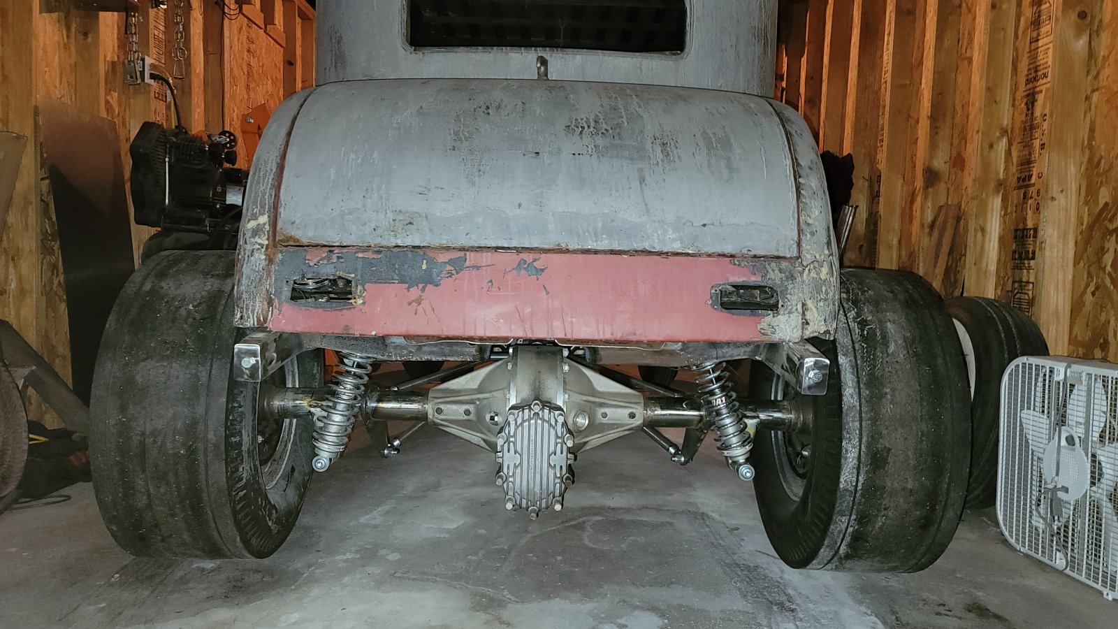

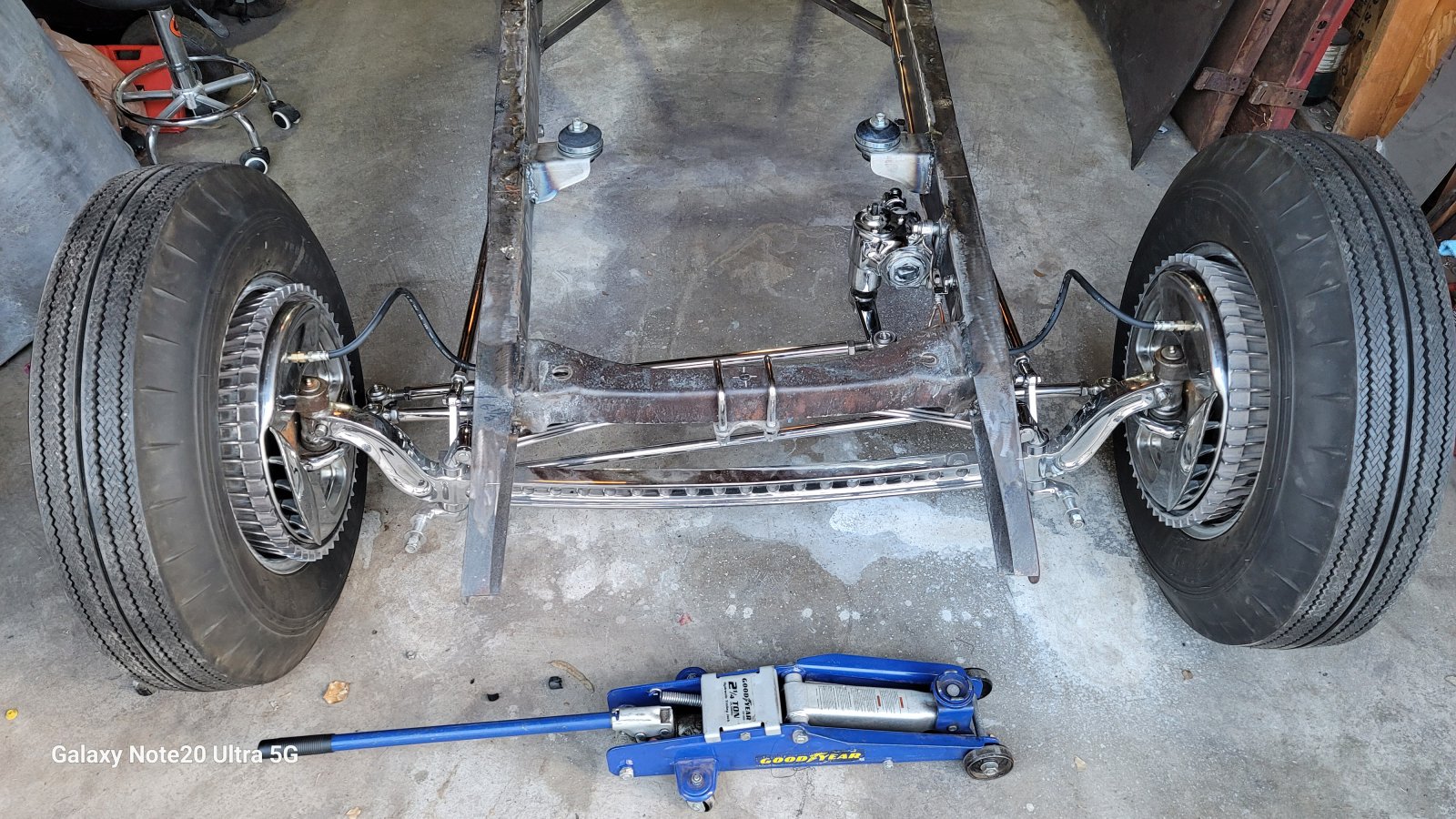

  14. Just got her back from Dale's Hot Rod Garage this morning from Phoenix - feeling so relieved with the huge step of progress in my build - engine, trans and final completion of the Winters Quick Change rear!
    Next, I'll be shooting for the final steering completion with the tie rod (2 inches too long at this moment - for mockup) and drag link purchases with the correct measurements.
    I need to try and remove the chemical residue that I used to remove the rust coverage over the entire body and frame when I got here to Arizona from all of the rain thru 2 states. I'm hoping to use scotch brite pads to do small sections at a time to hopefully have the appearance of a smooth, bare metal body. Any ideas on this would be greatly appreciated!
    Dashboard, steering column and brake master cylinder mounted on frame.jpg Driver's side interior view, also showing new wood for the door installation.jpg Front chassis showing engine mounts.jpg Front end showing Vega box, front panhard bar.jpg New steel floorboards installed.jpg Ladder bars and rear panhard bar.jpg Winters QCR setup complete with new mounts for the coilovers.jpg

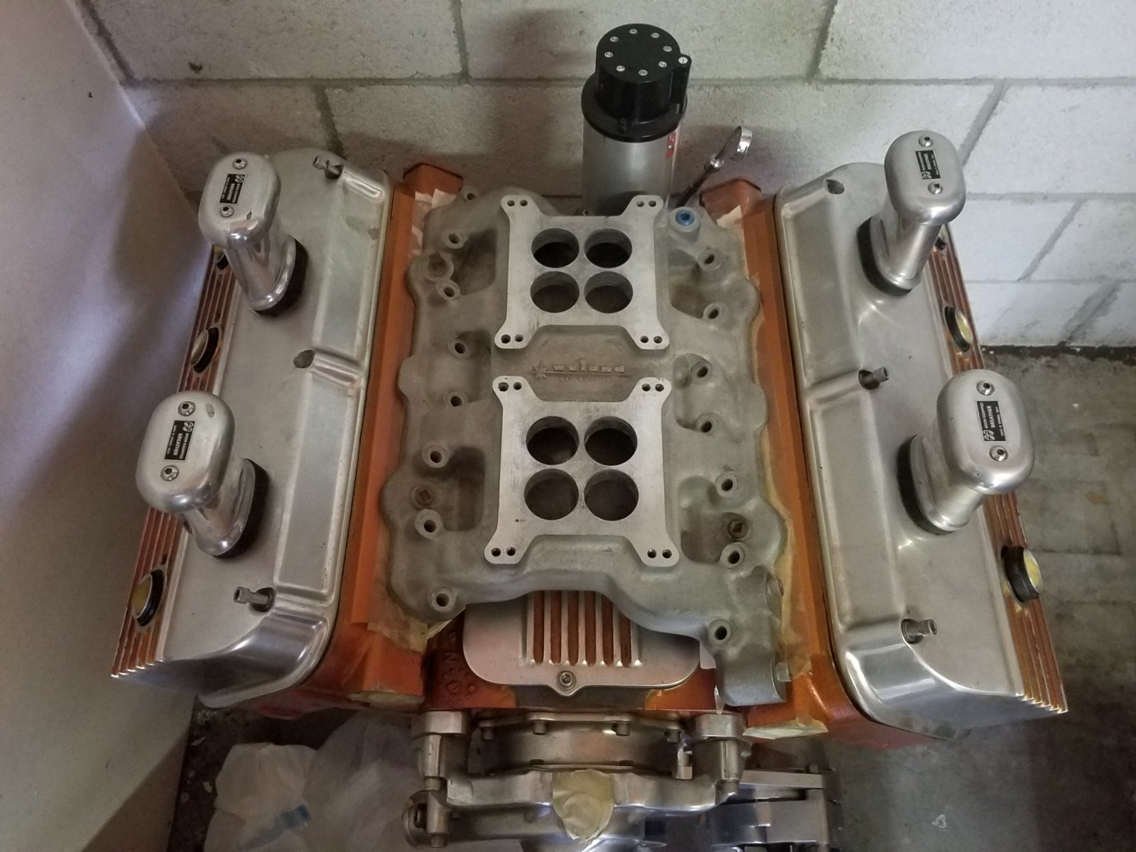

  18. Indeed Stogy, the ch***is would be an Orange metal flaked pearl, while the body color would be similar or exactly the same as my hemi. Last photo shows a typical panel paint job example - nothing concrete, just ideas to think about...
    My Hemi with 2 fours for now.jpg More pictures of pan.JPG More Hemi Pics 005.jpg 20181009_101446.jpg

    Holy ****, look at that engine! Dayuuummmm...

  21. Needs a Hilborn injection. He he.

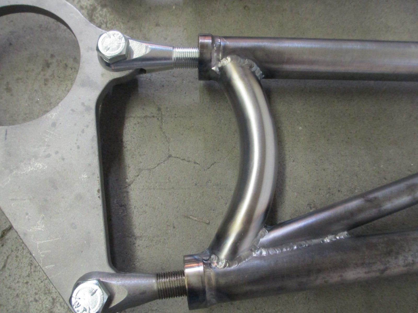

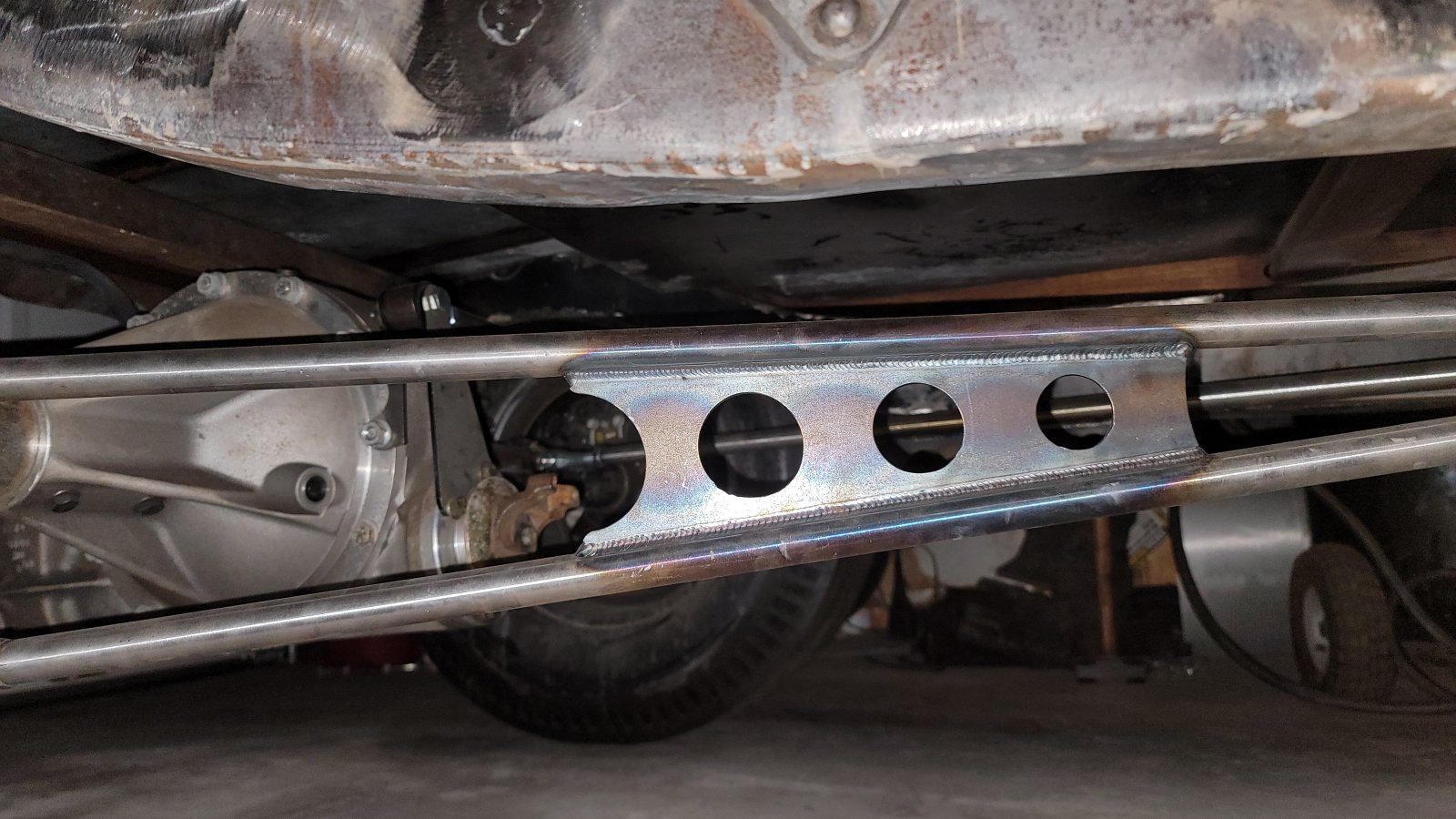

    Mike, your build is coming along great, I would make one suggestion on the ladder bars. With the horsepower and traction you will have with those slicks, the open area at the rear could have some flex, due to the lack of an upright at the rear. Hard launches produce the most force on the area closest to the axle centerline. I install a post to make the upper and lower tubes act as one. Great project ! IMG_4623.JPG
    Kreepea_1, mad mikey, Outback and 7 others like this.
  23. Thanks Tim, trying to get her on the road for my 60th birthday... We'll see.
    Ain't that the truth!!
    This is great advice Marty - consider this task done when the time is right, taking the body off for brake lines/hoses, new trans install and a driveshaft after it's measured and installed.

    Nice looking engine, not sure about that wooden oil pan though, might **** up a quart or two

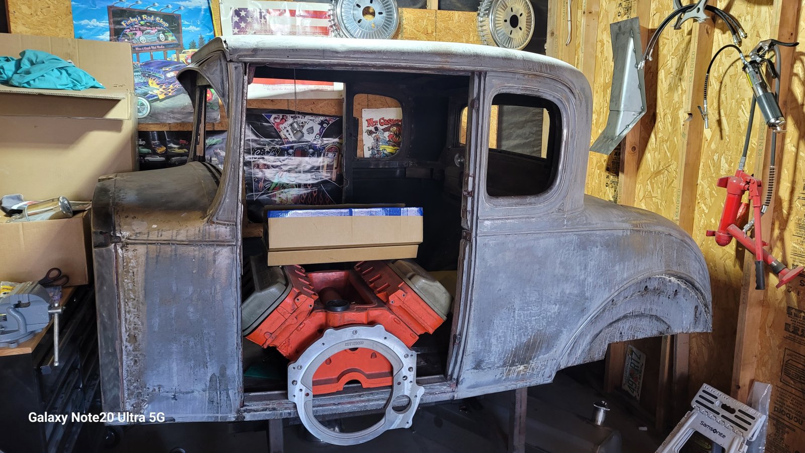

  28. Truthfully, while my hemi was on an engine stand at the machine shop, it proved it was way too heavy and bent his stand... Shortly after, I purchased an engine cradle just before I picked up my hemi. When I moved here to Mesa, all four wheels broke with the pounding the rental truck took over the damn roads across the country. Did you get to see the "REAL" 8 - 10 qt. oil pan - it's a beauty! I'm going to have it striped in white down the road!
