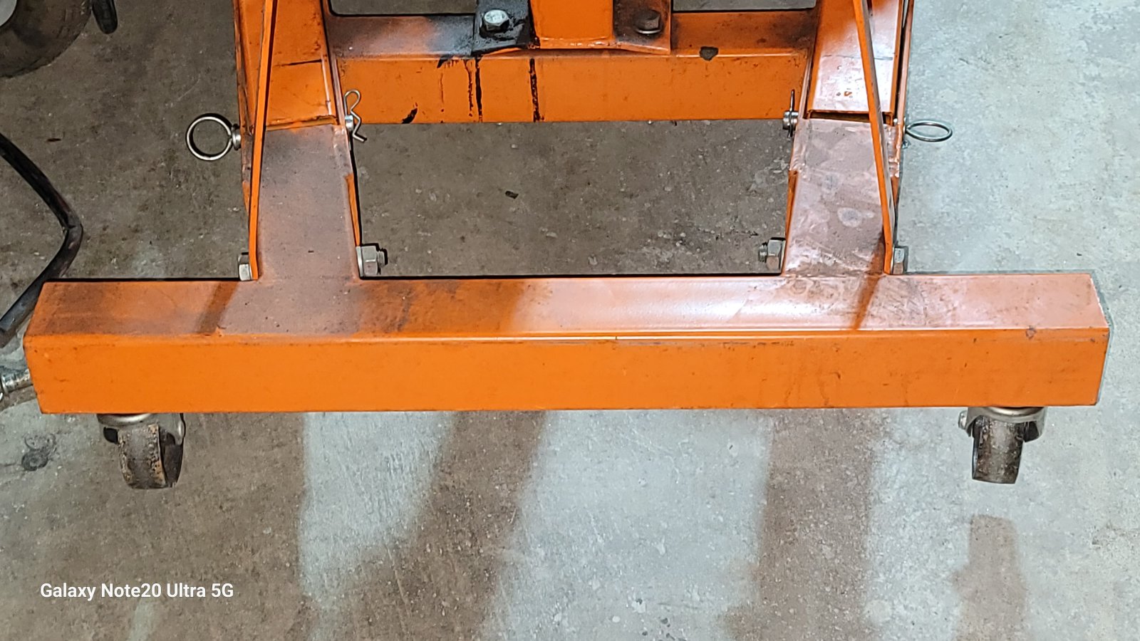

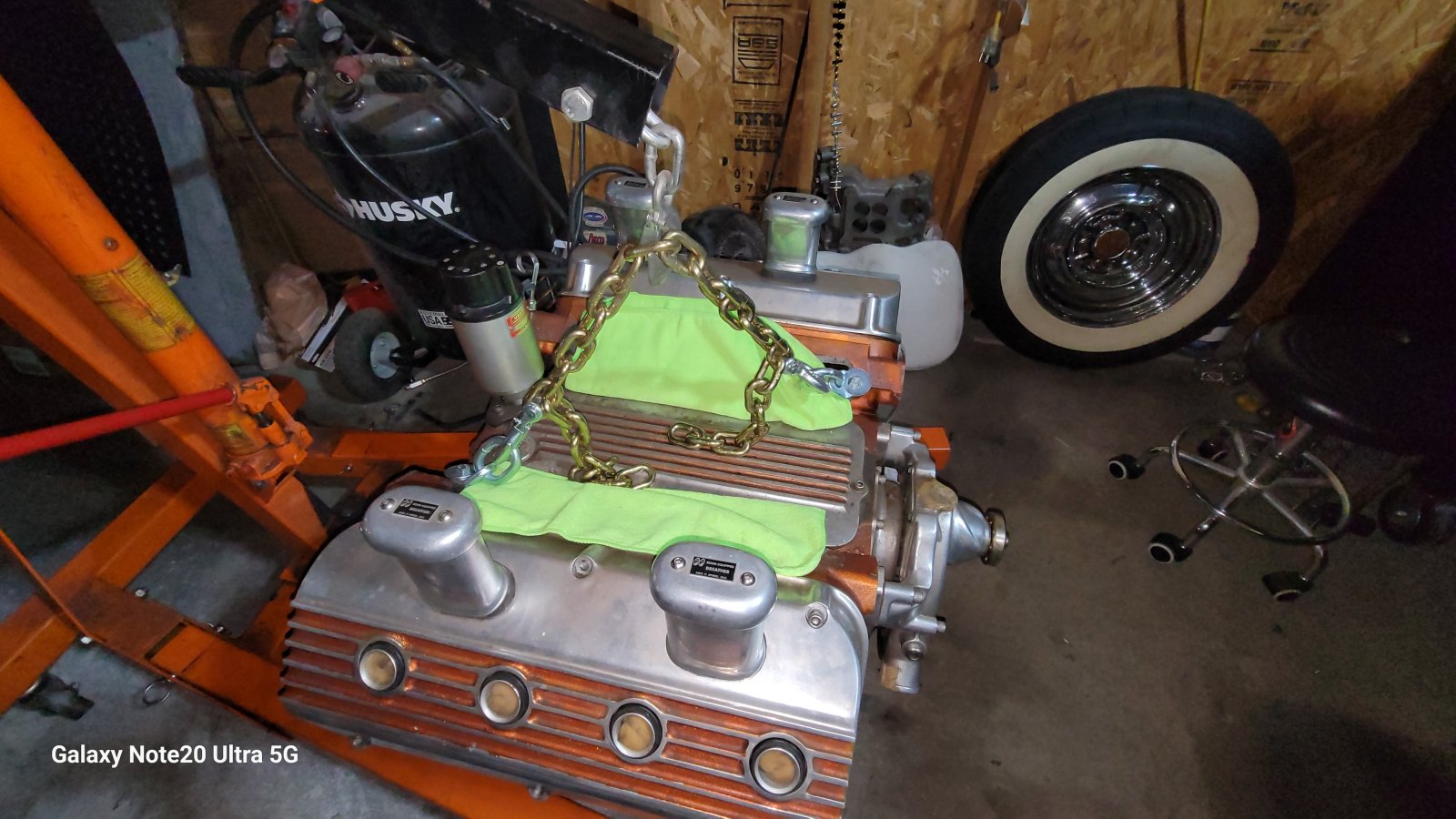

  25. Definitely a setback for the moment... I shortened the chain somewhat that is bolted to the intake (thickest links that I've ever seen for engine hoists) so I can lift the hemi as high as possible, so the oil pan can clear the frame rails. Turned the hemi around that's still in the engine cradle so the cradle is clear of the hoist's legs. The boon is set at 3/4 ton, which is 1,500 lbs, twice the lift weight of the hemi (See my pics).
    Before lifting the hemi, tested the cylinder by allowing it to lift up and down with the handle and seems to be working as it should. Any other tests that can be done, please let me know. The hoist WILL NOT LIFT my hemi. Like I said earlier, the rear of the hoist is raising off the floor as I stand on it as you can see in my pics. WTF??? I'm stumped at this point... Possibly the cylinder went bad somehow? Been over 5 years since I last used it when I moved my hemi into the garage.

    Did you check the fluid in the jack? What does the Hemi weigh? Move the arm out to 1/2 ton. Not only will you get more leverage on the lift (and more height) but it will move the wheels back and help keep them on the floor. If necessary add weight to the back to counter the engine weight. I know some will disagree but the 1/2 ton is a ball park figure.

    Robdski
    Are all 4 pins in the extension legs?
    It appears to me that the two forward pins are not inserted on the extension legs.
