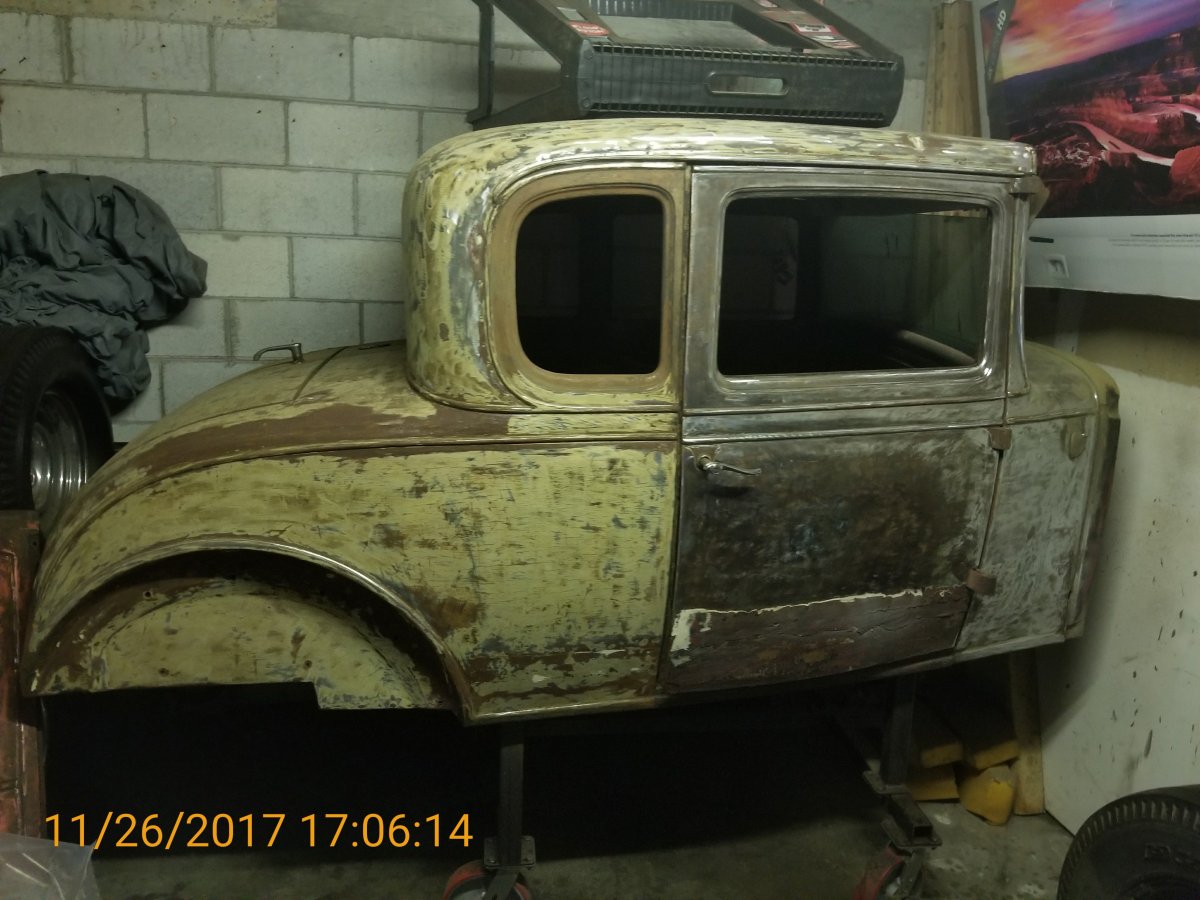

  3. Making a dusty mess using the mini orbital sander to get the rest of the paint down to bare metal on the body. The chemical stripping process is slow as hell with 4 layers to remove. Can anyone recommend a final rust remover in chemical form to remove the rust in the pores of the steel? Appreciate any advice greatly!

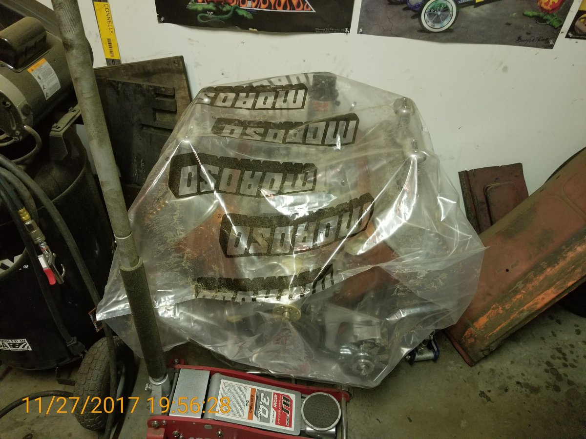

    In the meantime, removed more paint on the body and reminds me when I first performed 20171127_195657_001.jpg 20171127_195628.jpg this task back in 1995, just days after I bought the rod. Covered my hemi with a quality engine cover from all the dust that accumulates from the layers of paint removal.

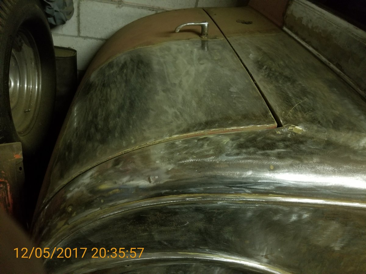

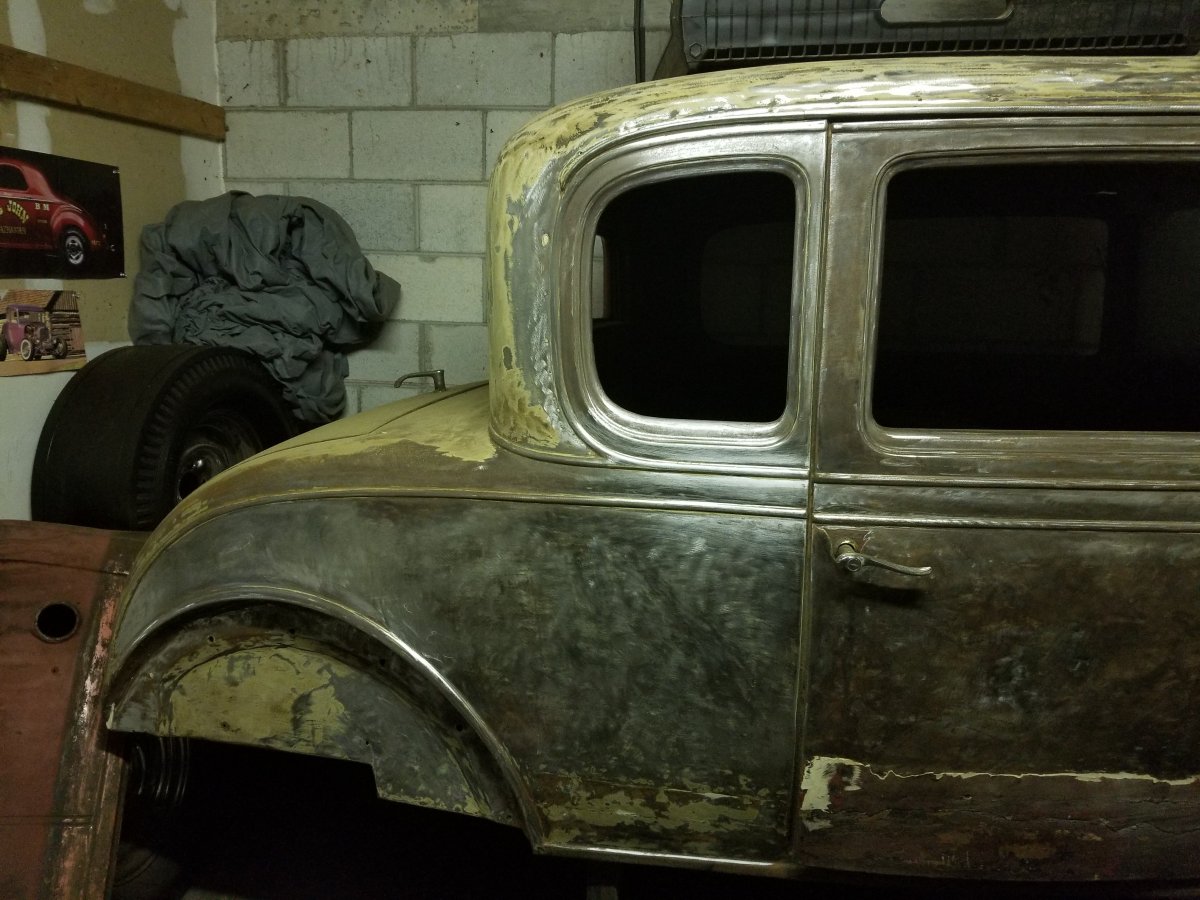

  17. Today I continued removing the paint on the body down to bare steel, almost at the halfway point, still needing to attend to the trunk lid, above it and around the rear window. I still have to do the door jamb and rocker panels too.

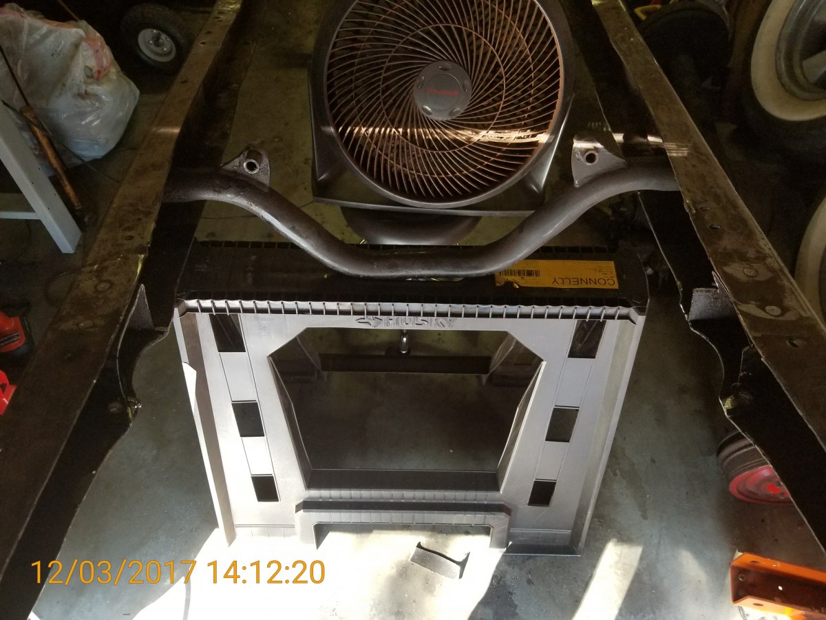

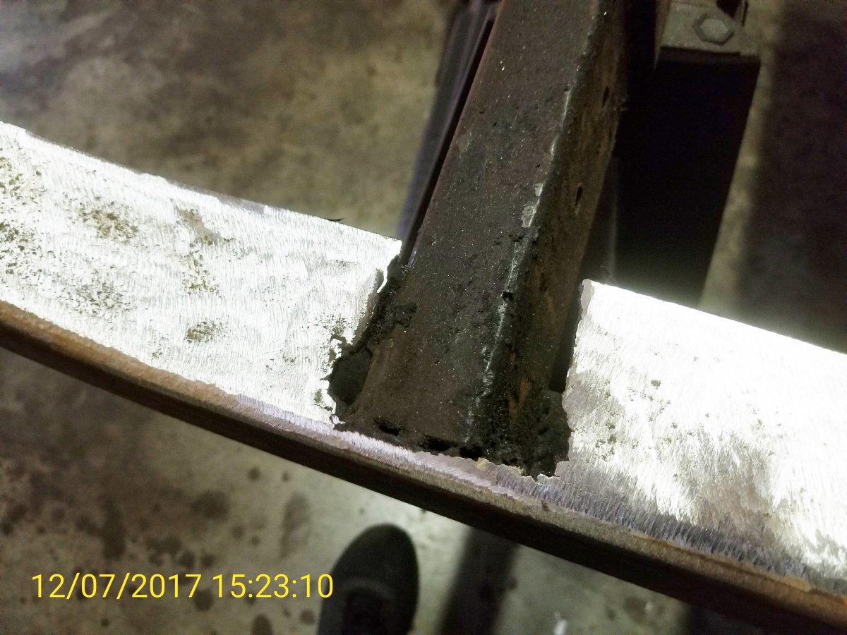

    Well, when the front cross member won't come out easily like I thought - just cut the f"""ker out! I'm boggled why Chevrolet put a half circle in the bottom of the C channel just below the front cross member as shown... Soon to purchase the new '32 Ford front frame horns and going to need to repair that section before the new early '32 Ford cross member goes in for good! I'm dying to reach that point because I can hang that awesome, fully chromed '32 Ford dropped and drilled axle!!!! 20171203_141221.jpg 20170522_225731.jpg 20170522_225808.jpg

    Just a guess, but I would guess those half moon indentations were used to locate the rails during the manufacturing process.

    Just never saw any other frame with these indentations. The '32 Ford frame horns should cut most of this out anyway, just have to repair further to eliminate the rest of it.

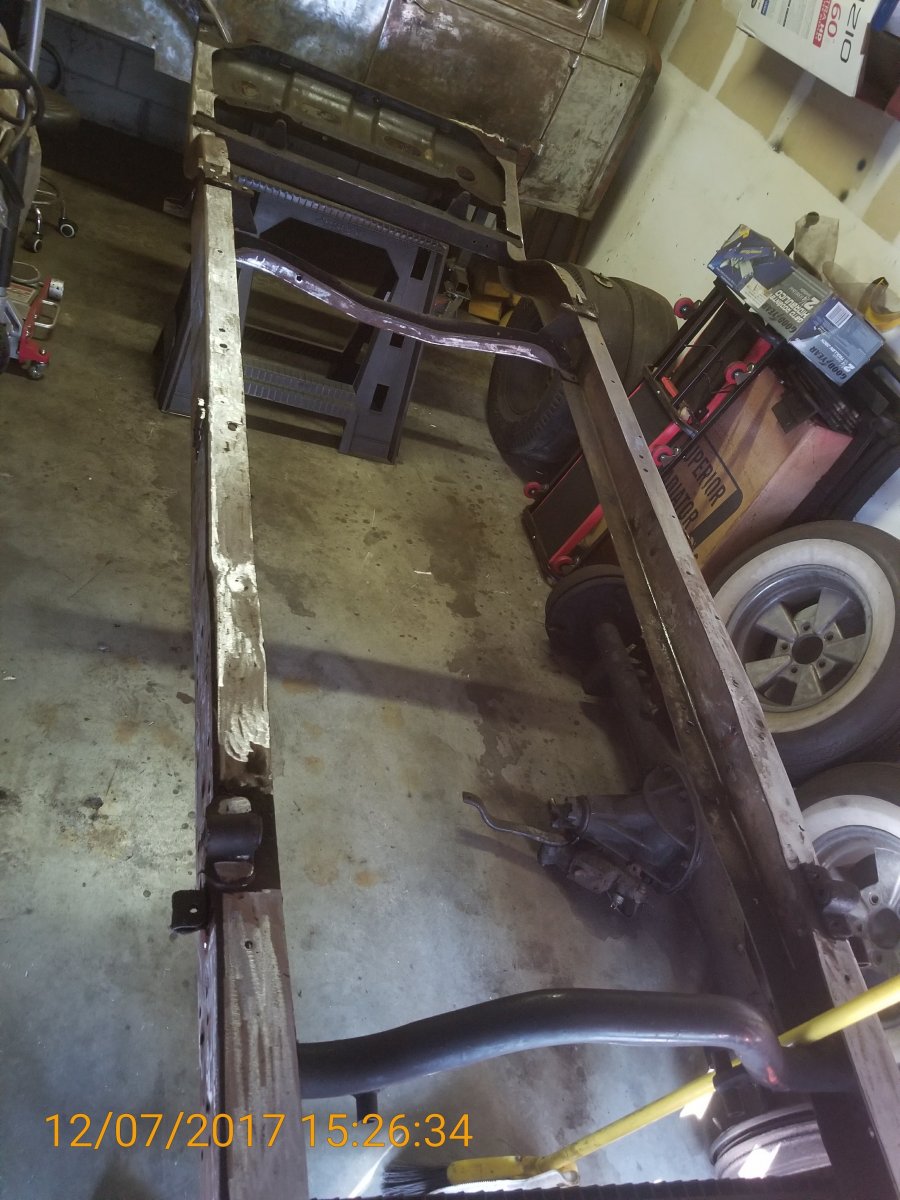

  28. Almost down to bare steel on one side of the coupe body - photos enclosed... grinded down some more rivets on the chassis, removed more paint as well. Tomorrow, I'm planning to flip the chassis over and try and remove the rest of the leaf spring mounts, which will be a big relief. The ones on the very tip on the front and rear will be cut off when I remove part of the frame rails - 20 inches at the front and maybe 3 inches or so on the rear. I want the rear frame rails to just stick out a few inches past the end of the body when its back on to put a spreader bar in between and maybe some classic nerf bars to finish them off. We'll see when I get there... 20171205_203534.jpg 20171205_203557.jpg

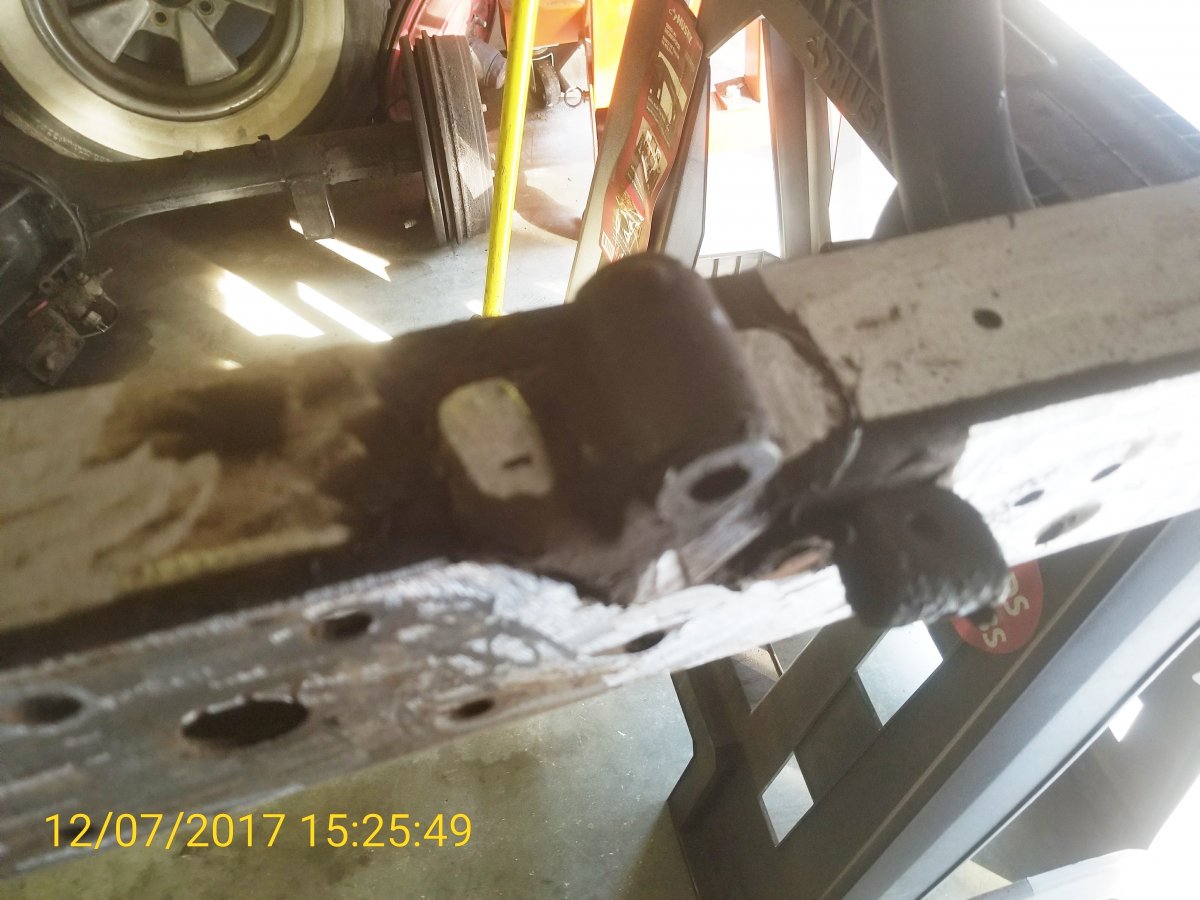

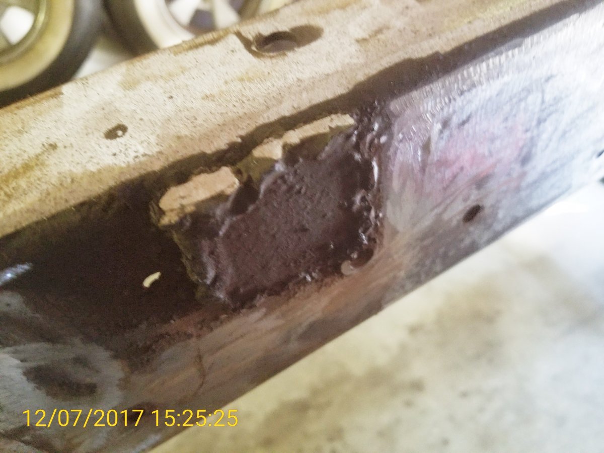

  29. Wanted to show you guys how some hot rodders of the late 60's obviously did not care about the overall looks of their rides... Can someone tell me what this guy was thinking when he welded these god awful 1/4" thick plates on this frame? There's not even a hole on the inside of the frame rails to cover up... The rear shock cross member mess is actually myself to blame, because the guy who welded it in didn't want to take the time to do it cleanly and now I need to repair it properly. Well, these mistakes will be corrected soon enough!
    Also, does anyone feel that drilling out these rivets that hold the leaf spring mounts will finally remove them? They don't seem to budge with my air hammer... 20171207_152239.jpg 20171207_152310.jpg 20171207_152354.jpg 20171207_152442.jpg 20171207_152525.jpg 20171207_152549.jpg 20171207_152634.jpg

  30. greyone
    Joined: Aug 31, 2006
    Posts: 275
    greyone
    Well don't be too hard on the PO, Back then you had to cut stuff out with a hacksaw and if you were lucky a torch. Then you blasted it on your frame with some kind of stick welder or you welded it with a torch. We are so lucky to have access to the tools we do. Your car looks great!
