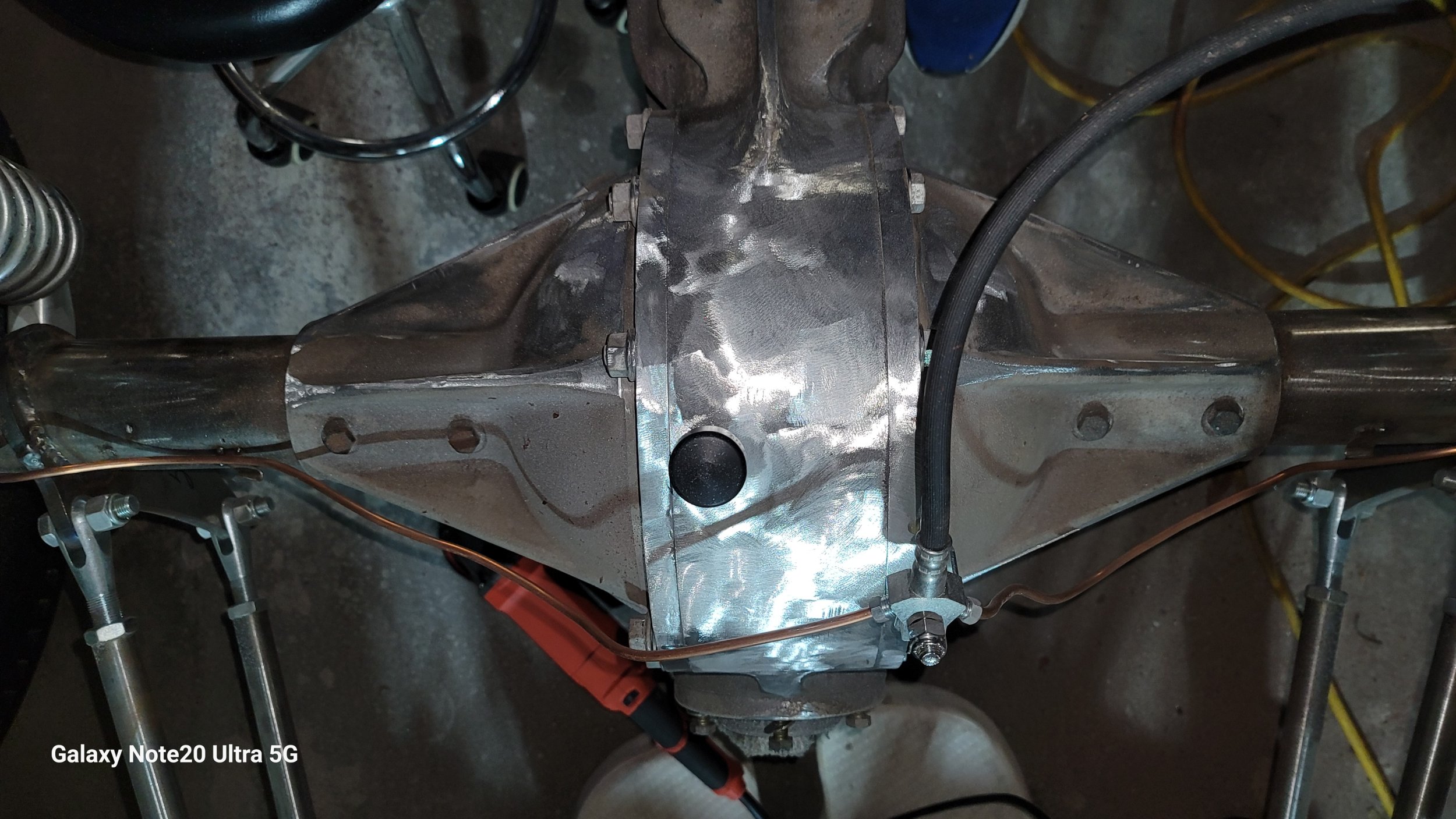

  2. Decided to tackle polishing my center section of my WQC rear, once I learned of polishing, using a variable speed 4-1/2" grinder. This clearly reminds me that I SHOULD have just paid the extra $1,000 to have this show polished... Already had to sand out some "low spots" from not being careful enough. I discovered that I can use foam sanding blocks with 60 grit to take the surface off with some muscle, getting much better results. The toughest areas of this task is the rear section near the QC gears. I started on the rear side and almost done with the surface removal and will come back in with foam blocks with 2000 fine grit to hopefully see exciting results! In the meantime, even much more exciting is that I am getting ready to purchase a brand new 6-71 complete supercharger kit from Dyer's very shortly!!!!

    Polishing cast aluminum is a tough, but, rewarding job when your done.

    I have done a bit of that type of work on my coupe, sanded my finger tips raw many times. Still worth it at the end of the day. Looks great Mike.

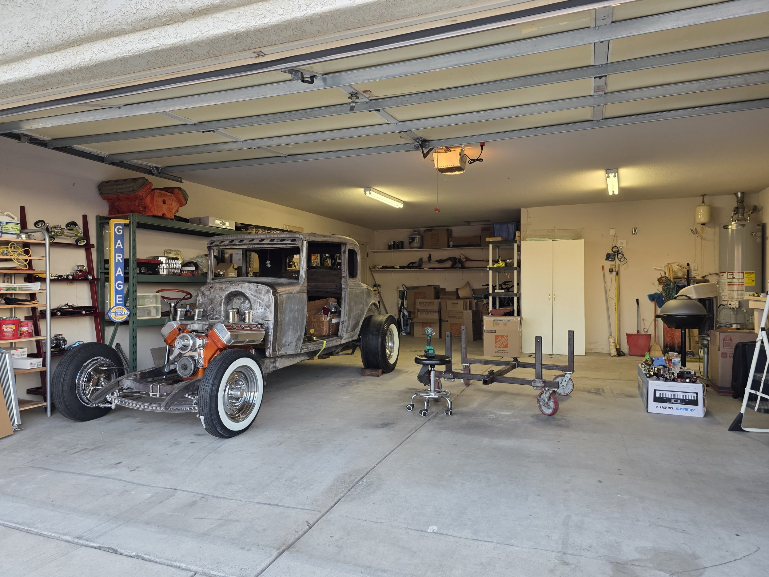

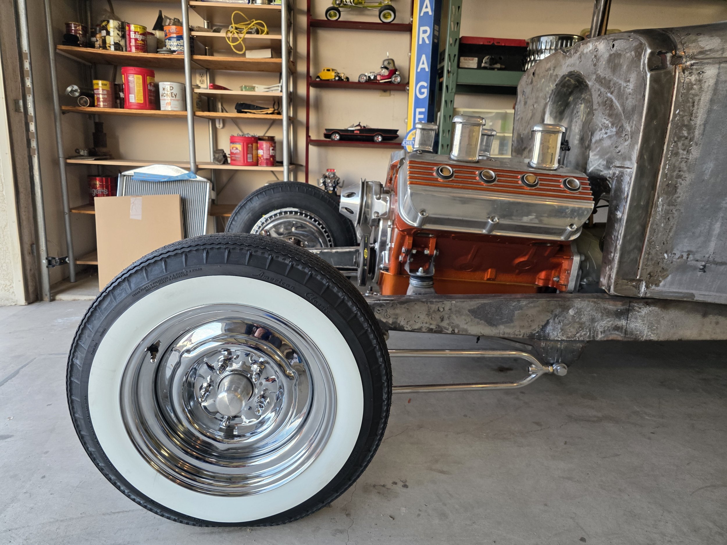

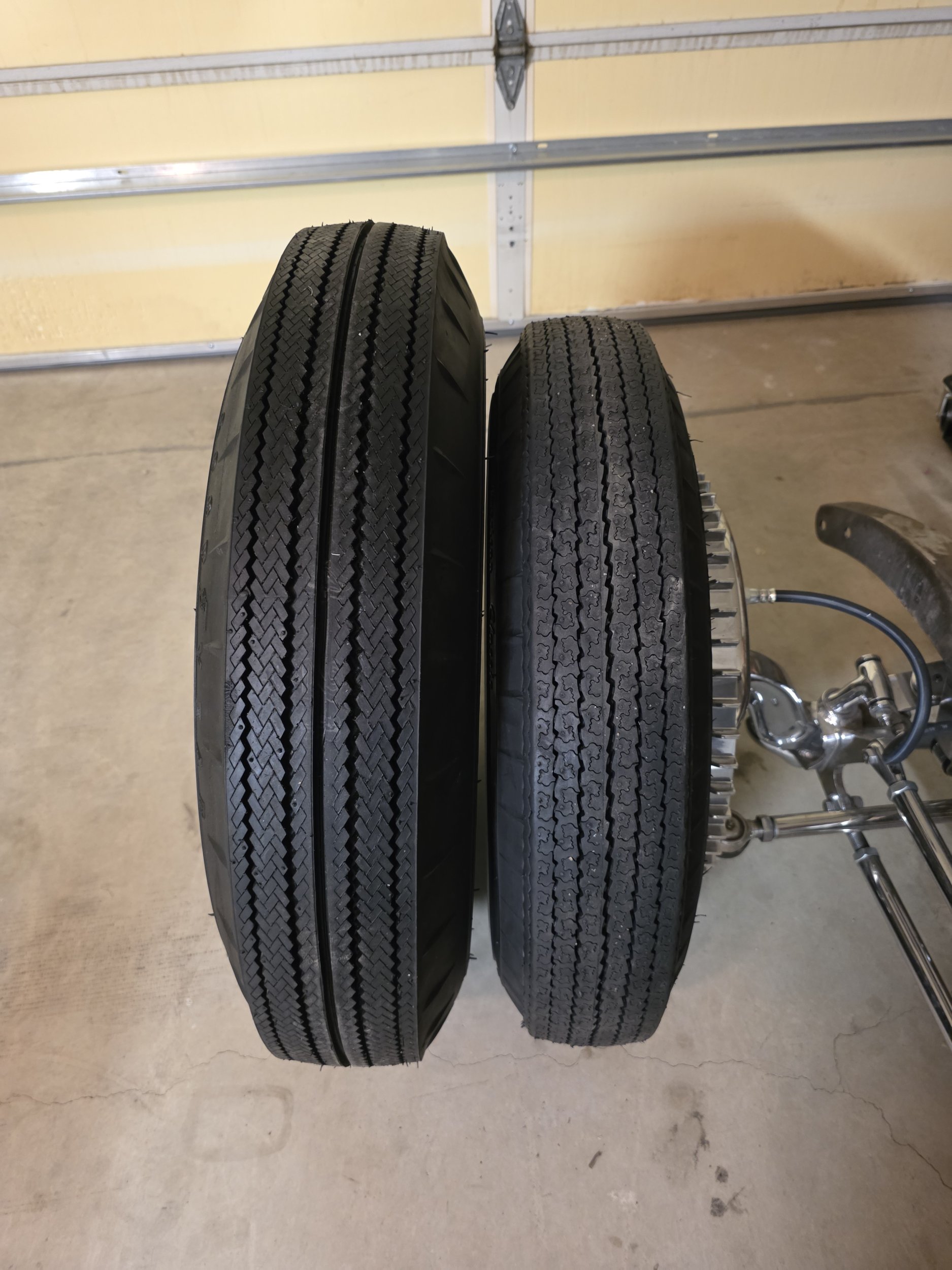

  15. I got a real good glimpse of the car while in her new surroundings and clearly saw that my Goodyear Super Cushions were WAY too tall. Got them for sale if anyone needs them at a very good price. They measure 28" tall, just an inch lower than my Radir Mickey Thompson cheater slicks at 29" tall. Not the "Bigs and Littles" that I'm after...
    So I just bought some new shoes for the front, being only 25" tall and thinner for that so-important rake that hot rods are famous for! Talk about "PIZZA CUTTERS"... These new bias ply look radials are spot on!!!!!
