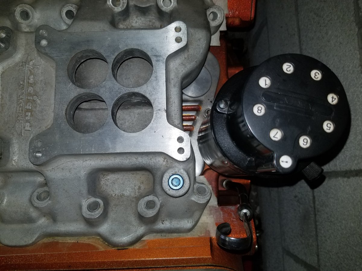

  4. Just a teaser on the current induction photo that most haven't seen yet. I scored this past summer on a vintage Weiand dual quad intake, thinking I had to settle on a new "repro". I just hope the rear four barrel clears my Vertex magneto... 20170505_135457_001.jpg 20170505_135559.jpg

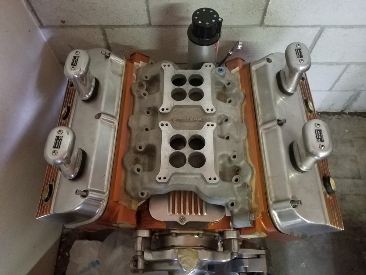

  7. If you notice on the bottom of these Moon breathers, I had my engine guy make up the spacers so the breathers stand at a 90 degree angle straight up. These Moon valve covers at the top surface were angled. I wanted them to stand straight up like the famous "Donovan" hemi valve covers! Now I'll have these spacers made in aluminum so you'll barely notice them.

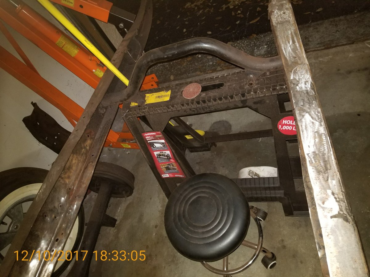

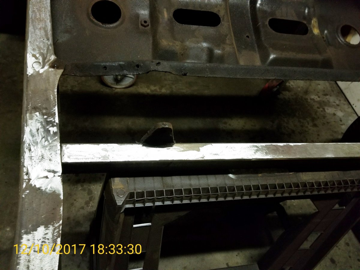

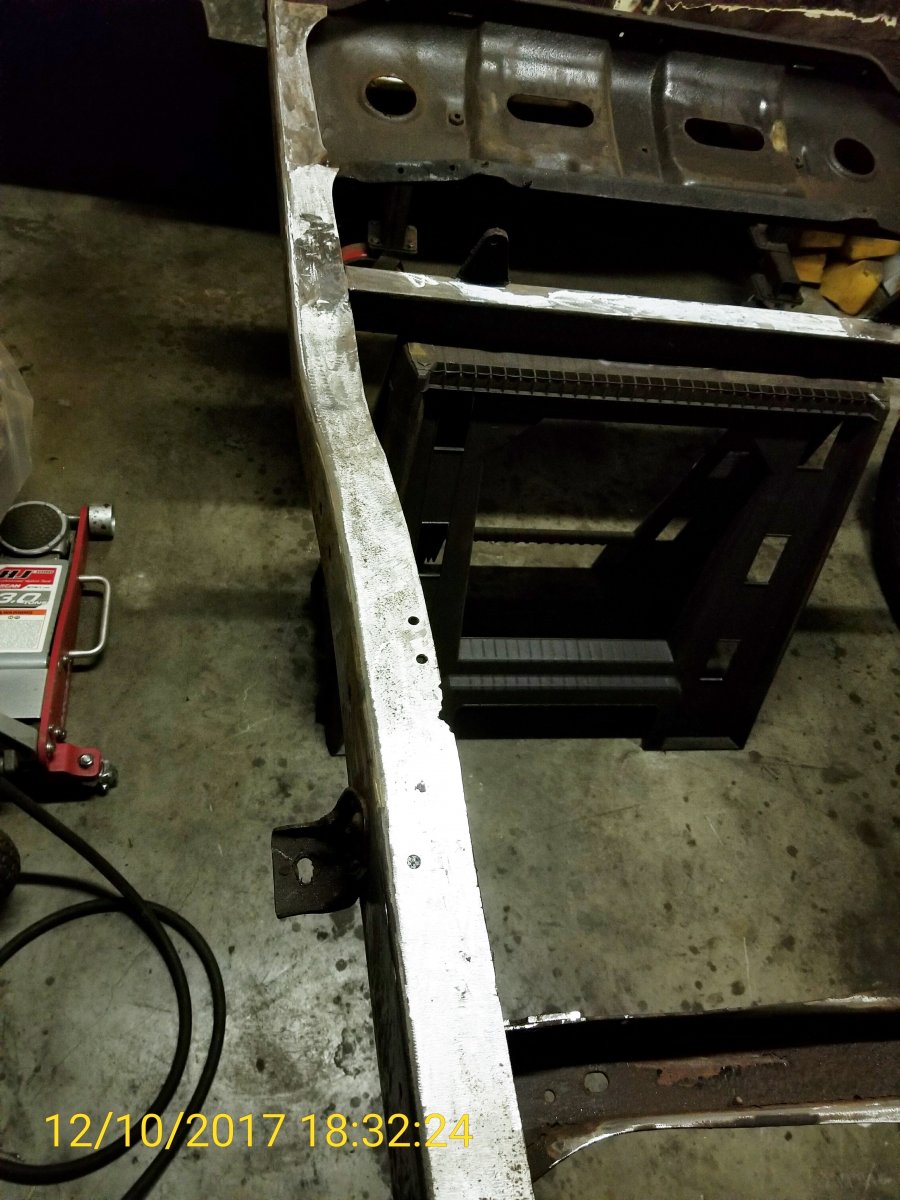

  8. Like I mentioned in an earlier post, removing those stubborn leaf spring mounts with all of the damn rivets challenged my patience - took some time, needing to make some relief cuts to pry the mounts off eventually. The last leaf spring mounts that I still need to remove is the very rear. This will be challenging as well, because the gas tank support runs the whole width from rail to rail. Like I mentioned before, I will place the gas tank apron back on the car to determine where I want the rear frame rails to end, cutting off the rear leaf spring mounts in the process. My sawzall and my arm will get a good workout for sure!
    Need some advice: I need to take out some of the bends in the C channel before I can measure my rails for step boxing plates. For instance, the height of the rail. I may be able to turn the chassis on it's side and hammer out some of the bends - with the help of my brother to hold the chassis up. Any recommendations? 20171210_183225.jpg 20171210_183330.jpg 20171210_183305.jpg

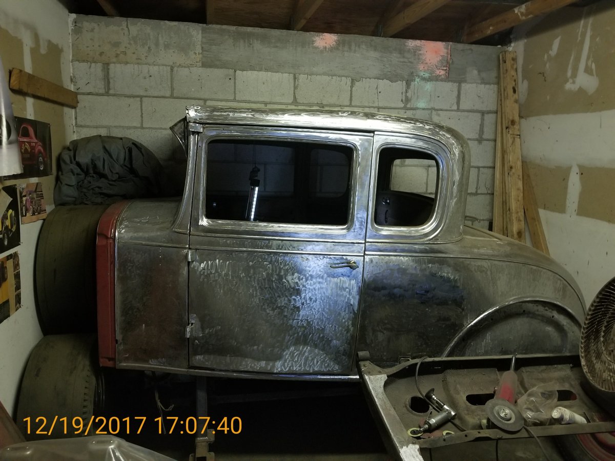

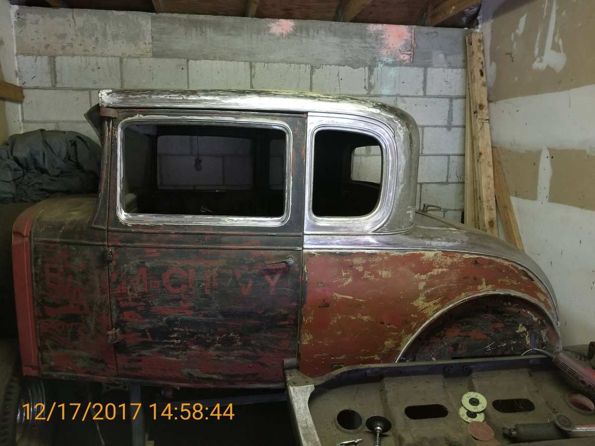

  11. Managed to flip the body around so I can start stripping paint on the rest of it. In the meantime, stripping the last of the POR-15 chassis paint on the rails. When I first used this POR-15 paint, I simply painted right over the primer that turned the rust a white color that made the Black POR-15 adhere to the frame. Now, I'm removing 86 years of paint and rust completely from my frame, which is turning out to be a very tedious task - BUT DIGGIN EVERY MINUTE OF IT!!!! 20171214_142155.jpg 20171214_142243.jpg

    Enjoying the build for sure, and great job! But- would like to throw/bounce this off you...... With the tall VC's- I see you have allen heads, which I have in hand, and was planning to run with my M/T covers. CHRY HEMI by the way, and the same breathers also.....
    So- we've seen the tall stand VC's used forever in fuel cars, and the early days when guy's ran dry=no coolant.
    D0 your top VC holes (mounting) go into water jackets? I had to think about it some, and if I ever had to pull a VC, well....... you should get the rest of what will happen. I had to revert back to studs for the VC's, and it has been a pain, but got it handled. SO- for those reading this regarding such matters= cheap studs equal out of round, and don't play nice with old VC's. Unfortunately, some things cost some coin to make things right.
    One of those sometime's overlooked, not thought of things that can piss a guy off, and have to re-visit again..... Food for thought here, but following along. Carry on Man!

  15. I just googled search on this subject and found an earlier HAMB thread on this subject - here's the quote from a reply: "If memory serves me correctly some are oil and the others are water. So yes it could be water. Wrap them with teflon tape and reinstall should be fine. I installed studs in mine with the teflon tape and never had an issue. Also the top three hole for the valve covers are also water." I am glad you brought this subject up because now, I will look into this BEFORE I fire up the hemi. Appreciate this INVISIBLEKID!

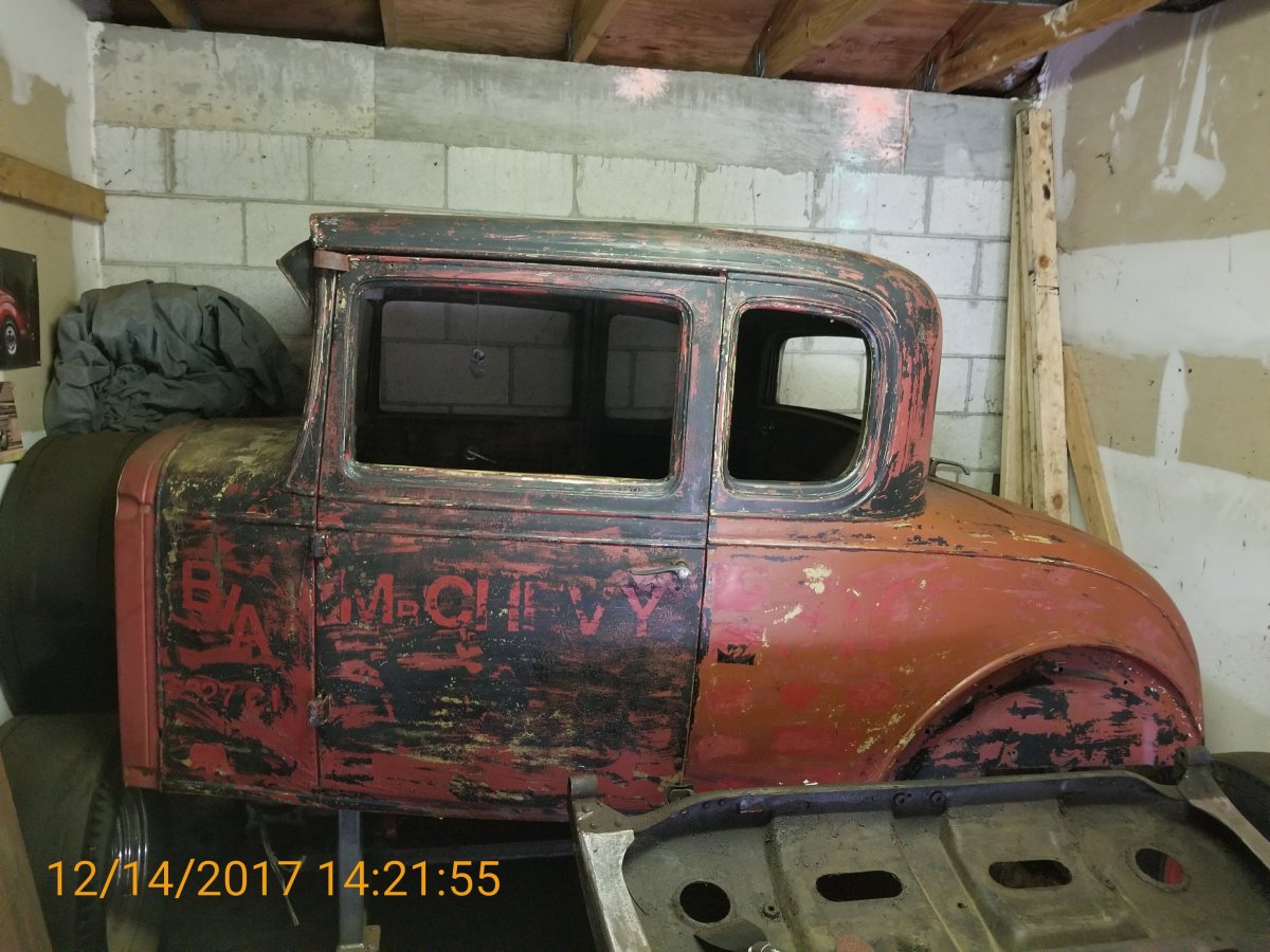

  18. Another big achievement today - managed to strip almost all of the paint on the driver's side in less than a week! All I have left is to finish up the doorjambs (driver's side is almost done already), the visor and the panel it's mounted on and the edge on the trunk lid for the most part.
    Then I can continue on the chassis, preparing to cut off the rear frame rails and most of the gas tank support. This will be the most challenging for me to date. Aren't these bodies awesome to look at in bare steel?

    Top goes into water, bottom into oil.

    You'll need Edelbrock/Carters or maybe spacers to raise the rear one.

  22. What I'm still confused about is will these water and oil jackets leak if I don't use valve cover studs with Permatex? Now that I'm aware of it, I am planning to use the VC studs. Would you happen to know the thread pattern George? As far as the carburetors, I am planning to run dual Carter AFB's and hopefully will clear the mag. Thanks for the great advice!

    5/16 coarse thread into the head, "working" side is fine usually....."head" side is usually 3/8 to 1/2 deep depending on Mfg. to shoulder. Good studs aren't cheap, and cheap studs aren't good.......

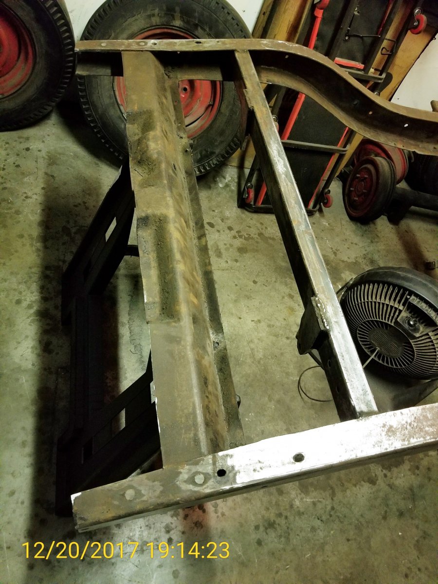

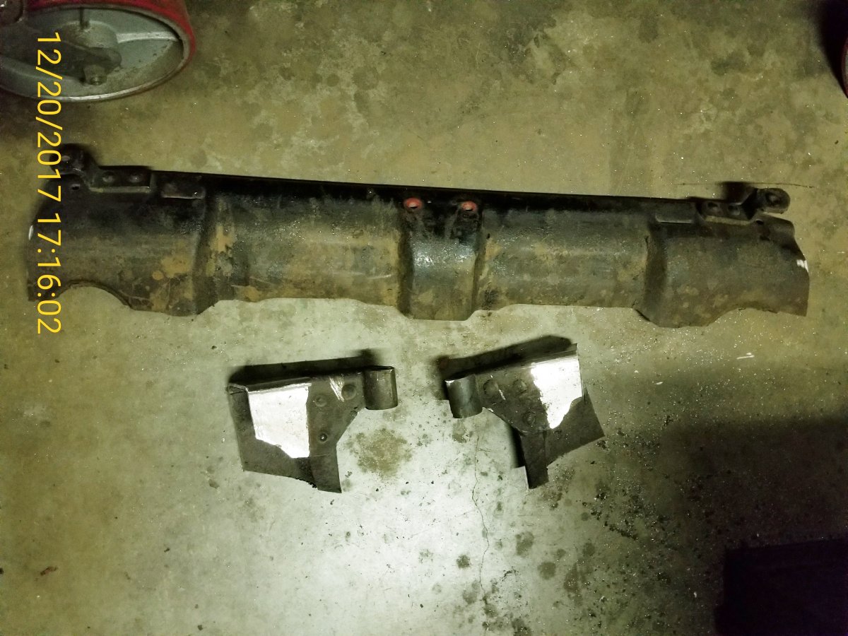

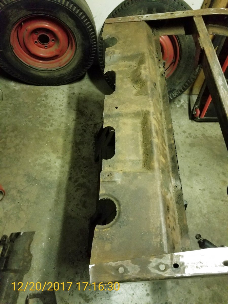

  24. Today I tackled removing the rear leaf spring mounts and modified the gas tank support so that when the body goes back on, the width of the apron will be completely hidden underneath - just showing about 4 inches of the rear frame rails past the edge of the body (Look at the dirty area on the gas tank apron where the edge of the body rested on). I cut the frame rails to end just above the bolt where the rumble seat pad on the apron had mounted (Photo 2). I can shorten or leave the length of the rear frame rails to where it looks the best! The rear frame rails will now resemble a '32 Ford with a spreader bar and nerfs, will plan the outcome later in the build.
    20171220_145140.jpg 20171220_145307.jpg 20171220_145748.jpg 20171220_171602.jpg 20171220_171630.jpg 20171220_191423.jpg
  25. Soon I'll trim off the front of the gas tank apron where the gas tank straps used to bolt to. I thought leaving what's left of the apron will keep the strength for the rear of the rails. Or, I may take it out altogether if I choose when the spreader bar is attached. We'll see...

    factory used bolts on the bottom & most likely didn't use sealer. a number of bolts go to water or unpressured oil. Carters are wide & short shouldn't be a problem, it's the long & narrow Holleys that won't clear.
  29. I do indeed - I bought this valley cover from Hot Heads Research in North Carolina. You have two choices, the front or rear oil fill.
    Thanks again George, I was not ever going to run Holley's on the street anyway.

    hemis don't have the oil under the V/cs like modern engines. If you use sealer on the VC gasket, only use it on the block side, especially if you have adj. rockers or push rods. You don't want to tear up the gaskets when taking the covers off.
