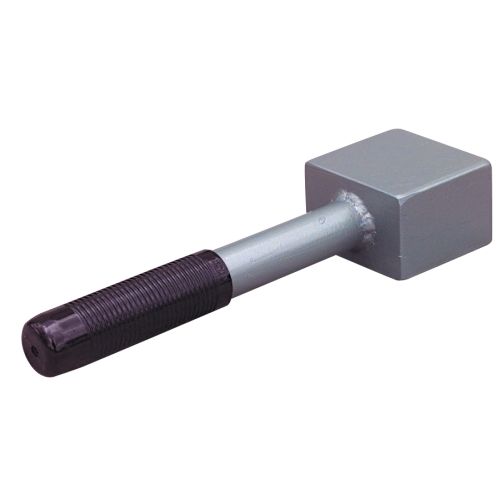

  2. Hey Guys - I'm at the point in my chassis restoration of removing almost all of the surface rust down to bare steel. Most of the rust that does remain is very minor, looking like it's in the pores of the steel, which I'm sure can be completely removed using a chemical rust remover.
    Now, I have a few areas where the frame rails have dents, more so in the upper and lower C channels. Since I have not done any chassis repairs before, I need some advice and guidance. I need a particular frame dolly or other items that can be used for these purposes. Something like this came to mind:

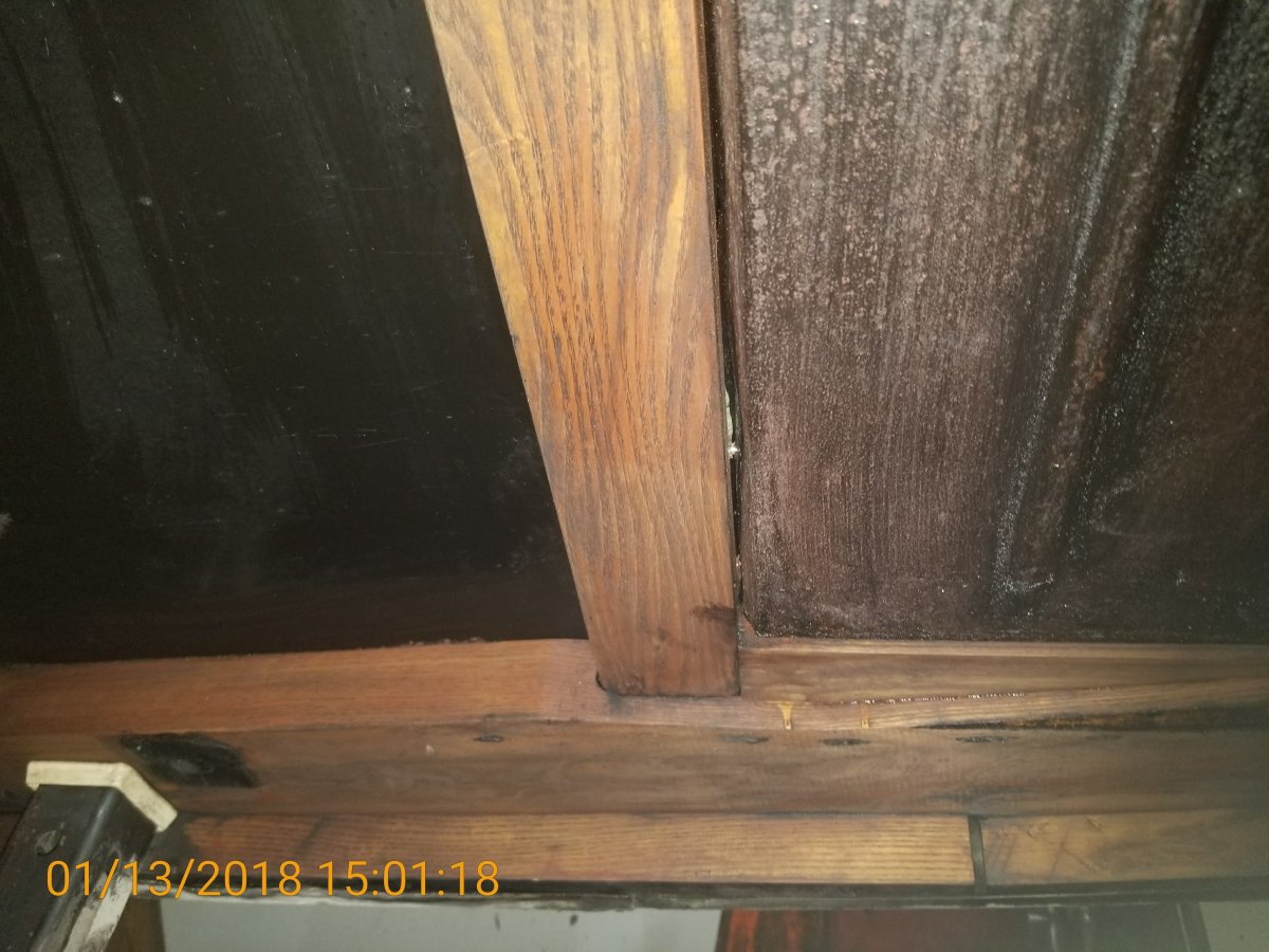

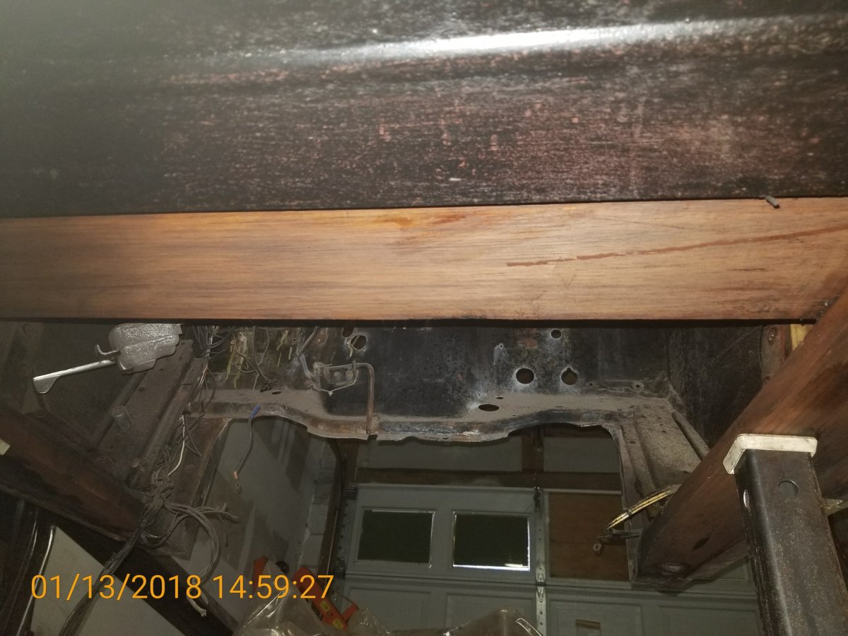

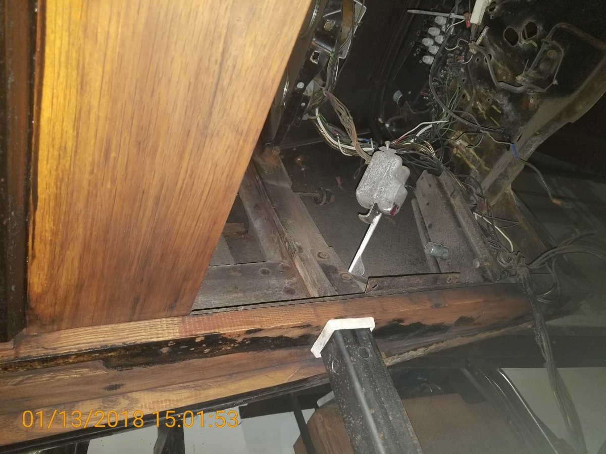

  3. Put a few hours in the garage to tackle another "GREAZY" job - cleaning the bottom of the body, which had 22 years of oil and grime that needed to get done. I purchased a new complete wood floor kit way back in '96, staining it and protecting it with Thompson's Water Seal. Before I started, you couldn't see any grain in the wood, showing black like my POR-15 painted custom floor pans. Gave a guy my originals and he reproduced them in thicker steel. They did not have repro floor pans for early Chevies back then. They do now. The second photo had POR-15 on them and conveniently peeled off to reveal the metal with NO RUST - the paint did it's job after so many years! 20180113_145927.jpg 20180113_150046.jpg 20180113_150118.jpg 20180113_150153.jpg
    The photos aren't my best, being on a creeper to take them. They'll do. The other task I had to do was clean up my air compressor, tool box and work bench that was covered in paint dust from about 3 months of constantly stripping paint in there. Should have thought about covering the rear that's standing by on my work bench, oh well... Stay tuned!

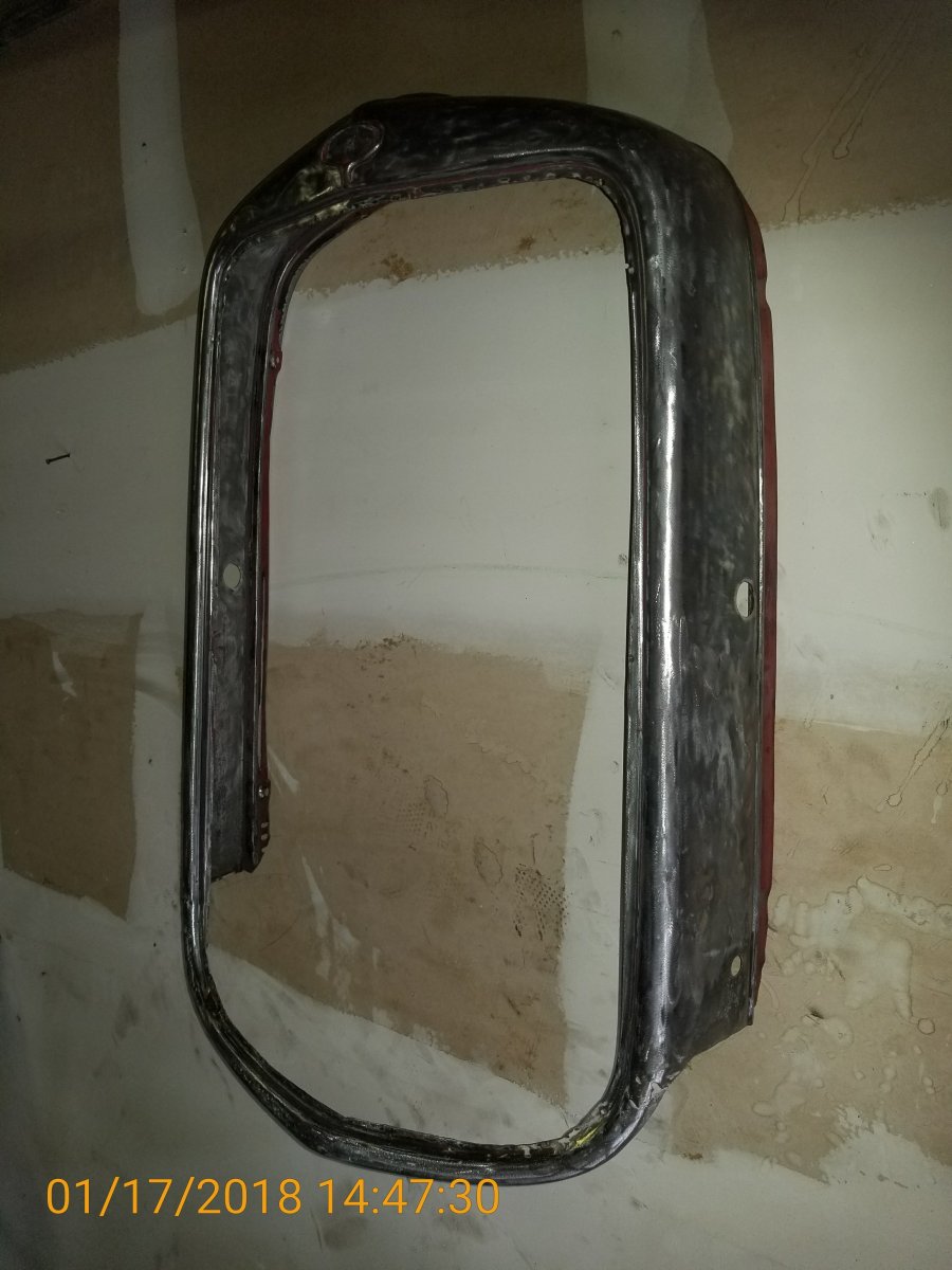

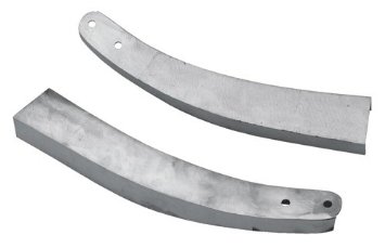

  4. Just recently started to strip the '32 Ford Commercial grille - it's almost down to bare steel. Does anyone know if I can purchase a radiator mounting kit for this grille shell to hold my new (at the time) '32 Ford radiator?
    In the meantime, my brother bought me a new pair of '32 Ford front frame horns that are coming shortly (a GREAT birthday present!). Can't wait to size them up and hoping that the height of them toward the cross member will allow me to cut off my originals with the old cross member remains inside of them. My originals are hurtin', showing a pathetic repair at some point before I owned it... 20180117_144730.jpg 1932-ford-front-frame-horns.jpg

    You can go to Home Depot and get a gallon of phosphoric acid. It's called Etching something now, I'll have to check when I get back to the garage. Anyway, I mix it 50/50 with water and use a heavy duty spray bottle, rubber gloves, and a mask, bought them all there, spray the rusted areas and leave the garage. Next day I wire brush it off and spray it with Rustoleum etching primer. I'll get the name of it and post it later.

  7. Some great info Mike - appreciate this a lot - my original chassis is solid as hell, but very old so the rust in the pores of some areas of the frame has got to be normal. Don't want to keep grinding the pores out and thinning the frame rails. Gotta get rid of every spec of rust when the time comes to prep the frame for Tangerine Pearl paint.

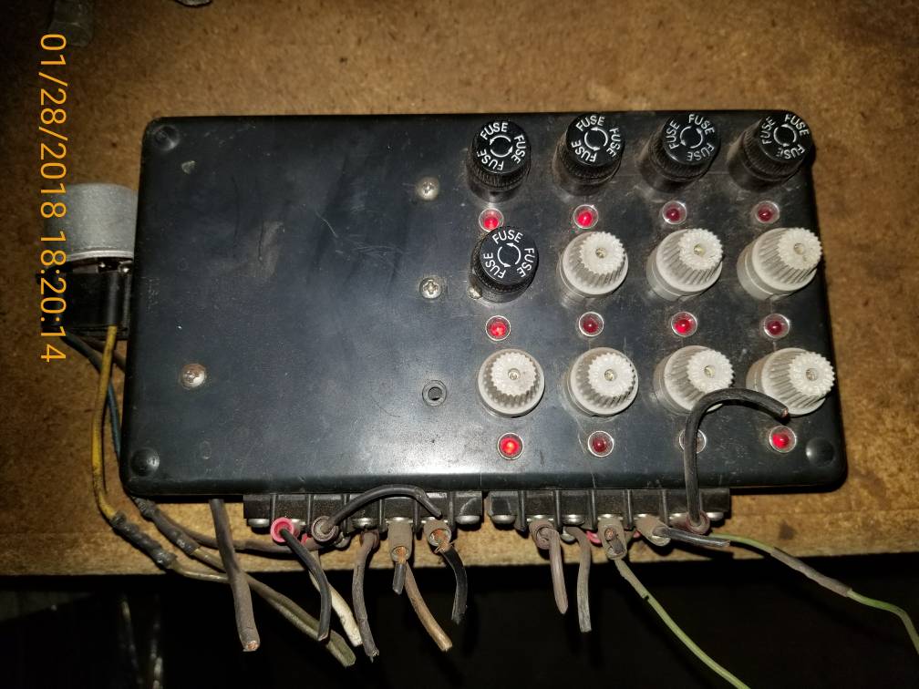

  28. Went in the garage to remove the dashboard and start stripping the existing wiring and my gauges to expose the dashboard to completely strip the paint as well.
    That component box was designed by a buddy, Lou Garcia and featured LED lights under each fuse to light up when I had a blown fuse. Very helpful and the box lasted for years with no trouble.
    Those gauges are original Stewart Warner and have been in my rod since the late 60's. Cannot complain about quality and endurance huh?
