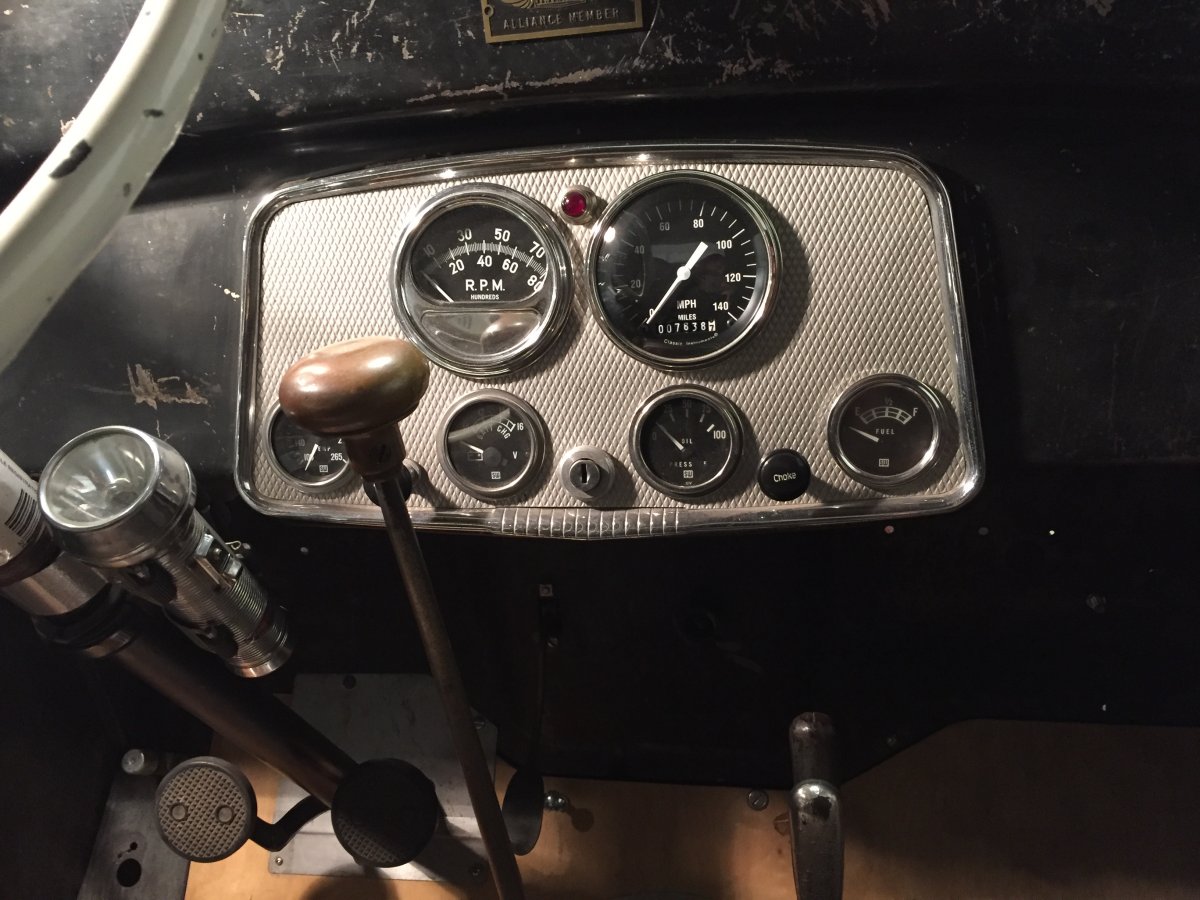

  1. Just finished stripping the rest of the paint from my dash without the gauges in. The last gauge I needed to install had a tough time going in, so I need to file down this hole. I have to clean up the hole also where a radio was installed way back. Who needs a radio anyway? I've got my Winters QCR to listen to eventually and the supercharger as well - noises don't get any better than that no? 20180129_171400.jpg

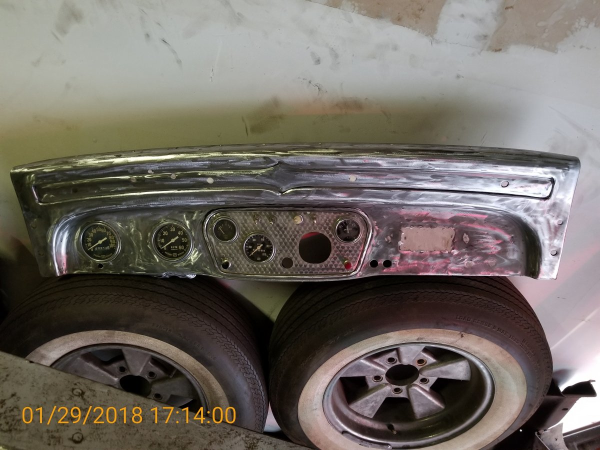

    what are those wheels?
    just love 31-32 chevy dashes, looking good
    31chevymike and loudbang like this.
  3. Yup! I'll take one when I get out to the shop. It has been modified a little however....

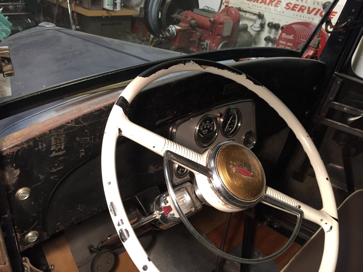

  5. Here you go Mike. I extended the bottom of the dash slightly to match the SW Hollywood panel. Sorry the pics aren’t great. It’s a little cramped in the shop right now, ha! D77FEE5D-EFEA-463A-9AF8-381C70393BC5.jpeg C880F43B-4D51-4441-921D-D182603866C1.jpeg
  6. They're vintage Fentons, which seem to be kind of scarce. They were popular on G***ERS besides the Halibrand "Kidney Beans". In time, I want to let these wheels go, but they're the only tires and wheels to get my ch***is rolling again for the time being.
    Man your dash is way cool! Also had never seen a Stewart Warner gauge panel, let alone a vintage Hollywood! It seems that your stable of hot rods define the true barn find look, rods that were built back then and not restored, just make sure they're safe to drive the **** out of 'em... Doesn't get any better than this, huh Mike?

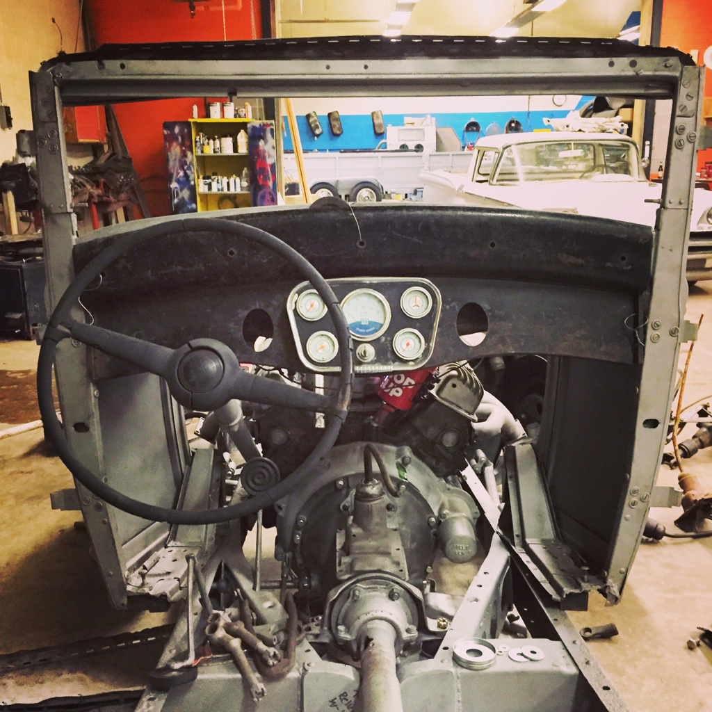

    Stoked for you and the new job @31chevymike ! Dig that dash- I found some chrysler dash for my model a truck at Iola a couple years ago that'll fit my stewart warner dash. Those chevy dashes like yours have a nicer flow to them-
    I like the thickness of the top of the dash on this one- would be cool to make it padded. :)
    Those old doors are hard to find-! I remember there were panels on the Alexander Brothers Adonis clone that came from that material sourced from storm doors I believe- Moriarity could correct me if I'm wrong... love the look of that stuff.
  15. Thanks Tuck! Truth is, I would like to swap out my original dash for a '55 Chevy or sorts, modifying it to fit my interior and have the curved ends continue onto the doors. I saw this done here on the HAMB a while back and really inspired me to pull this off on my hot rod. We'll see...
    That material that Mike used on his dash from old storm doors shows a great look, different from the common "engine turned" method we're all used to seeing.

    I have a mock up picture somewhere where I did that in reverse in my roadster. I used a 55 chev dash and it wrapped around the back the two bumps being the bumps for the seats. I sectioned a big chunk out of the middle. I wanted to run a speaker between the seats a lot like a convertible has-
    I have a 59/60 dash for my roadster... but like you said we'll see.
  17. That's what I'm talking about Tuck! Looks like the one issue to address is the top of the dash, where it looks rounded, knowing our dash's run straight across in 30's rods. Maybe fill in gaps with steel inserts?

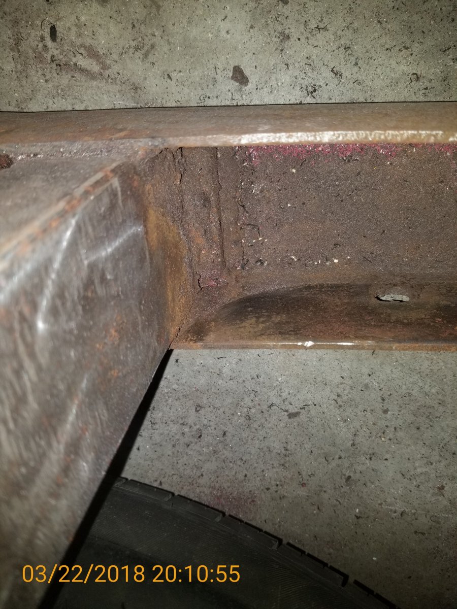

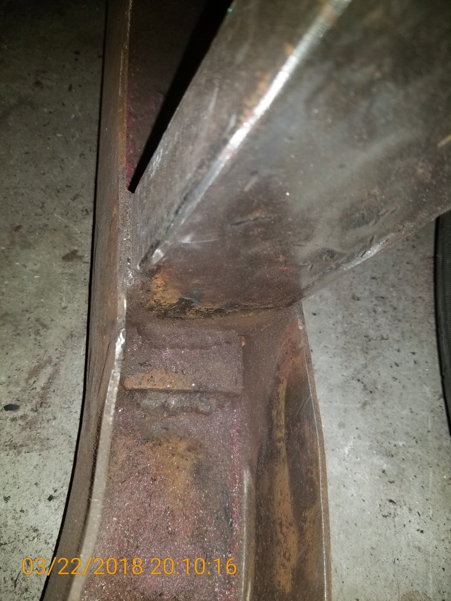

  19. "Houston, we have a problem"... What was I thinking in that I could attempt to grind down some welds holding my rear shock cross member that was welded in crooked... Let alone there is only four inches of space to work with.
    Thought I could grind down these welds with my mini orbital grinder with steel knurled tips. Any suggestions? 20180322_201016.jpg 20180322_201055.jpg

  20. Dick Stevens
    Joined: Aug 7, 2012
    Posts: 4,117
    Dick Stevens
    Sand blaster and a die grinder!

    Now I’m pretty brave when it comes to slicing frame rails, sometimes I think my frames are made up entirely of welding wire
    I would take one of my trusty 4.5” electric cut off wheels and make slices( four up and down cuts total) exactly where the weld meets the crossmember cutting on the outside main frame rail goin inward. Then weld the slices in the main rails back up and finish grind. After that install a crossmember correctly.
    Now since you say you need to learn to weld, maybe practice first or have another HAMBr weld it for ya.

    Cut crossmember off flush where it meets the frame rail. Weld a plate to the frame rail and over the remaining cutoff end, and weld new crossmember to the plate.

  25. Don't have a sandblaster, but I do have a die grinder, just too big to get in there to do the deed completely. I even bought another orbital grinder for small areas, trying to use a knurled steel bit to try and grind down the welds, to no avail.
    That is some good advice Wyatt, I'll look at it again to re-evaluate - thanks!
    Thinking a bit about what you're saying, I'm planning to step box my frame anyway. I'm liking your idea the best.
    Don't take this the wrong way Gman, but I created the last look of the body with decals and lettering I applied myself, giving the impression that the car was an old race warrior from the drags of the day. If I made you thinking that Jack Merkle built my engine, the look was successful. As long as I've lived on Long Island, I never had the opportunity to meet Jack when he was alive. Wish I did.
    Damn right that what she said Mike!!! Greaser's post seems the way to go. This cross member can easily be remade and while at it, adding more holes to the coil over tabs gives me more options to lower the ride height in the rear. But before I do this, I need to weld the rest of the cross members that are originally riveted to prevent any flexing while I handle the frame as I've been doing, suggested by Mike @drifter9 while in my garage last Wednesday. My coupe was a bit too high at the rear for the length of time in my possession.

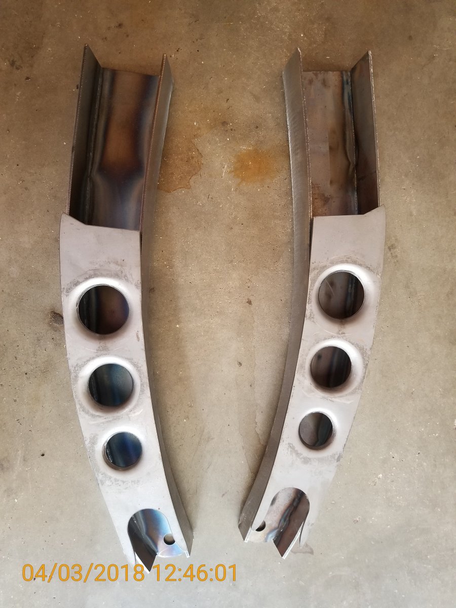

  26. Just received my new '32 Ford front frame horns this morning, needing to know where I need to cut my frame horns to complete the task. They're at 3 - 3-1/8" tall, so I have a pretty good idea where I need to cut mine. You see where I have the tape rule at? The cut will be somewhere between those 4 holes. Is it easier to slip these new frame horns over mine to determine where to cut?
    I placed the new '32 Ford belled hole boxing plates for these new frame horns in place and discovered that they will need to be grinded down to fit inside for step boxing. Still deciding on whether to use these belled hole boxing plates for the rest of my rails or not. Since I will be using square tubing to strengthen my rails with the new boxing plates directly welded on top of them, the belled holes will show the square tubing in the center of the frame. Thinking I will coat the inside rails with POR-15 to prevent rusting and perhaps hide the boxed tubing from view through the belled holes. 20180403_124306.jpg 20180403_124601.jpg 20180403_125435 (2).jpg 20180403_125528.jpg 20180403_125739.jpg

    before cutting, make a template of the new pieces from cardboard, cereal box works good, and use that to determine the cut. can't go wrong.
  28. That's a smart idea, then I can be sure exactly where to cut my frame. Thank you!

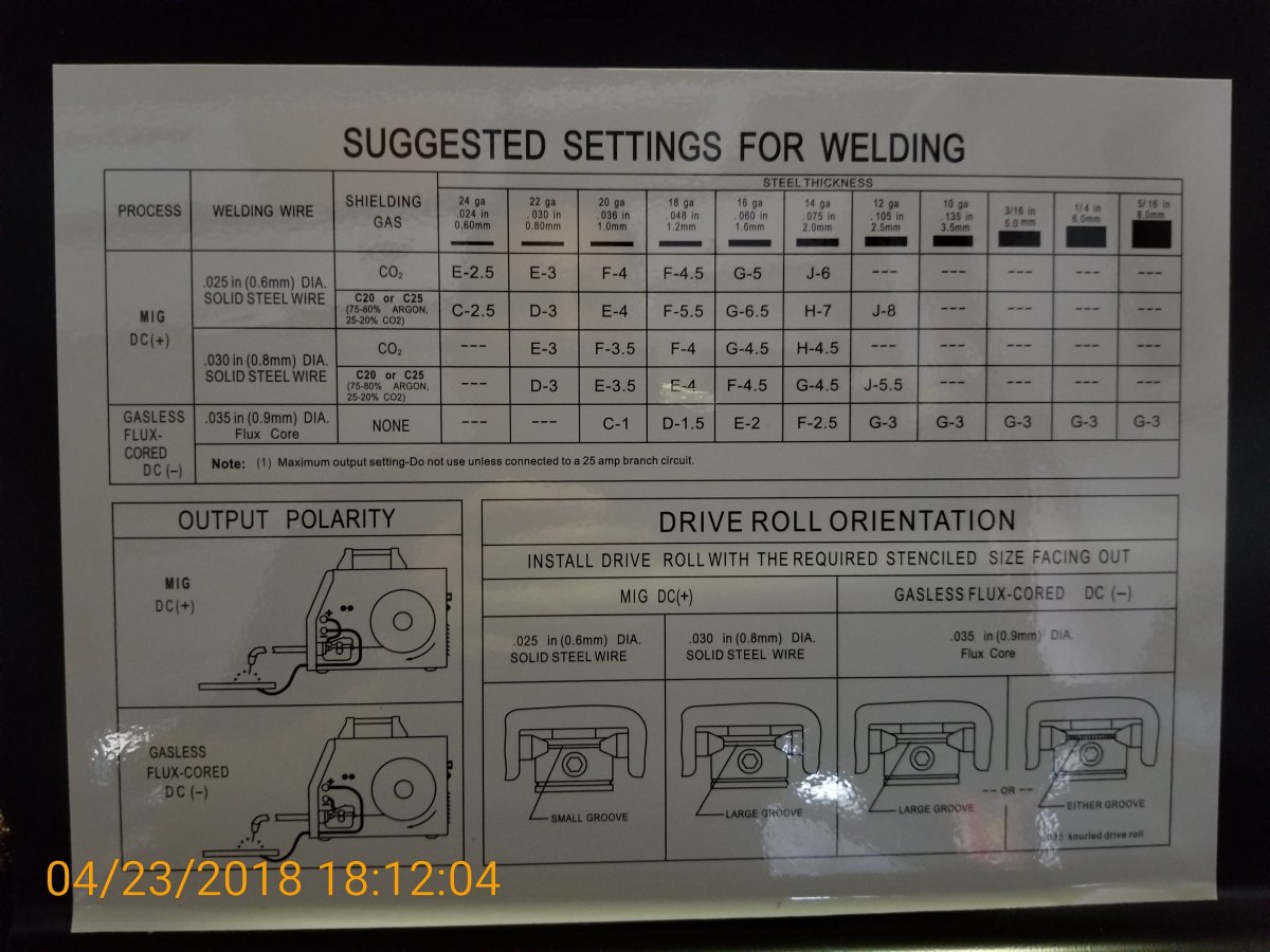

  29. FINALLY!! Got most of the necessary supplies to enter the world of welding! I had trouble with the attached chart to make sure I had the correct settings on the welder. Judging by the look of my first bead, I had the wire speed too slow and voltage was not hot enough - do you agree? I was checking out some videos on YouTube and saw some dude pushing his gun in a straight line, while some other Eastwood videos showed both a "C" pattern and circles. I will try to do these patterns next.
    What are the correct settings for 1/8" steel using Argon CO2 Mix - 75/25? Tried to look up on the net, but to no avail. This will help tremendously as the chart once read properly will give me the correct voltage and wire speed settings for a much cleaner, smoother bead.
    Lastly, with the gas turned off, should the gauges be at zero? Can't wait to get back in there to try again!
