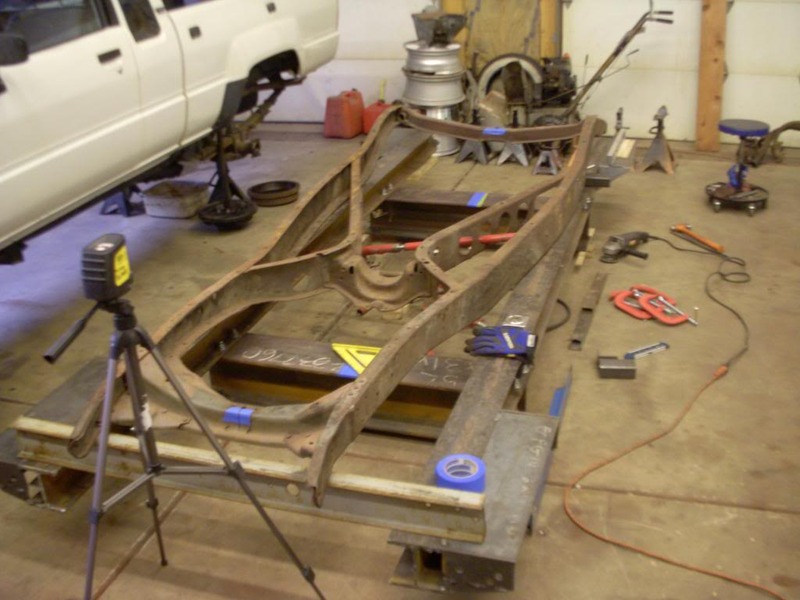

  4. Thanks Enloe, it will, providing I can get by my frame issue and can continue to hang my new suspension...

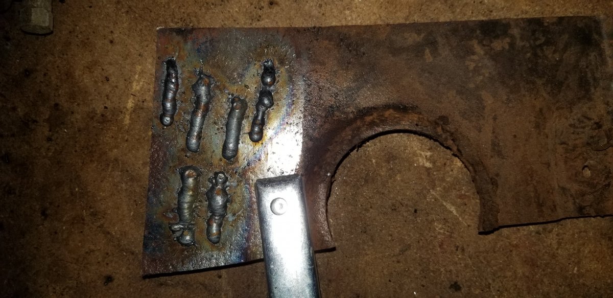

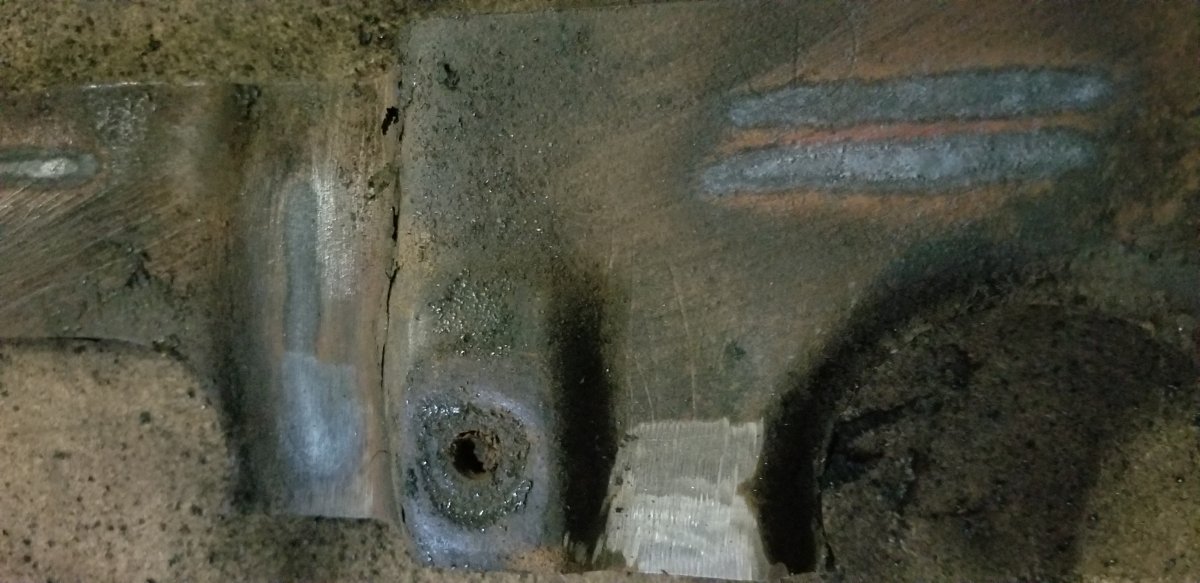

  6. Okay, just came back from my garage and laid down some practice welds on a piece of 87 year old 1/8 inch s**** metal that I cut off off a while ago. Didn't quite clean up the metal thoroughly, but managed anyway for some needed practice.
    I also FINALLY found out some needed info on MIG welding on 1/8th inch steel using .030 steel wire and 75/25% Argon mix of gas - my welder does not show this on the diagram inside the wire spool area. I had the volts turned up all the way at setting J and wire speed at 6.5 on my Eastwood MIG135, suggested by Eastwood on a reply from one of their videos.
    I started from the bottom left to right, laying it flat on my table. Then I took the metal and set it up to be standing up from my table, to practice welding UP vertical from starting at the bottom. The top right was my first attempt (ugly right?) and the top left shows that I was getting the hang of it. My best weld is the one from the top, third one from the left, smooth as a baby's ***. I used the "U" style method, going from left to right, moving the puddle upwards.
    Question: These welds seem a bit tall, is there a method to get the puddle closer to the metal? I'm holding the gun just about 1/4 inch away from the surface.
    Oh, the welds I did on the new frame horns were not sufficient, as they broke off easily. Part of the problem was that my small 9 lb magnets to hold the frame horns were not strong enough to hold them "hands free" as needed. I just received some BIG 5" 75 lb welding magnets that should do the trick when I re-weld the frame horns once again.
  7. Those welds look cold to me Mike. Have you thought about using flux core wire for the frame welds? It's a little messy but bites a little harder/hotter which is nice with a small machine like that.
    Stogy, 31chevymike and loudbang like this.

    To test the welding i would first clean properly.
    Then you need some gapes about the thickness of the plate to get the weld to penetrate.
    Then mess with the wirespeed until it works good.
  9. After finishing each practice weld, my welds seem to be cherry hot. Can I use the same gun with the flux core wire or do I need to change over to a spool gun Mike? I need to look into flux core wire anyway - thanks!
    Eastwood had told me to bevel the edges when welding two pieces together, to help with better penetration which I've done so far to this point to prepare me for welding the frame horns again. I think I will have better results next time around. Appreciate your advice AndersF!

    Cold welds will be "cherry hot" because you've melted the filler material, it just isn't hot enough to penetrate the material you are welding which is necessary to fuse the materials together! With proper heat and penetration the weld will lay down and not just lay a bead on the surface like you have done in your practice welds.

  12. Makes perfect sense; the puddle seems to just lay on top of the metal instead of penetrating deeper and begin the "fusing" process.

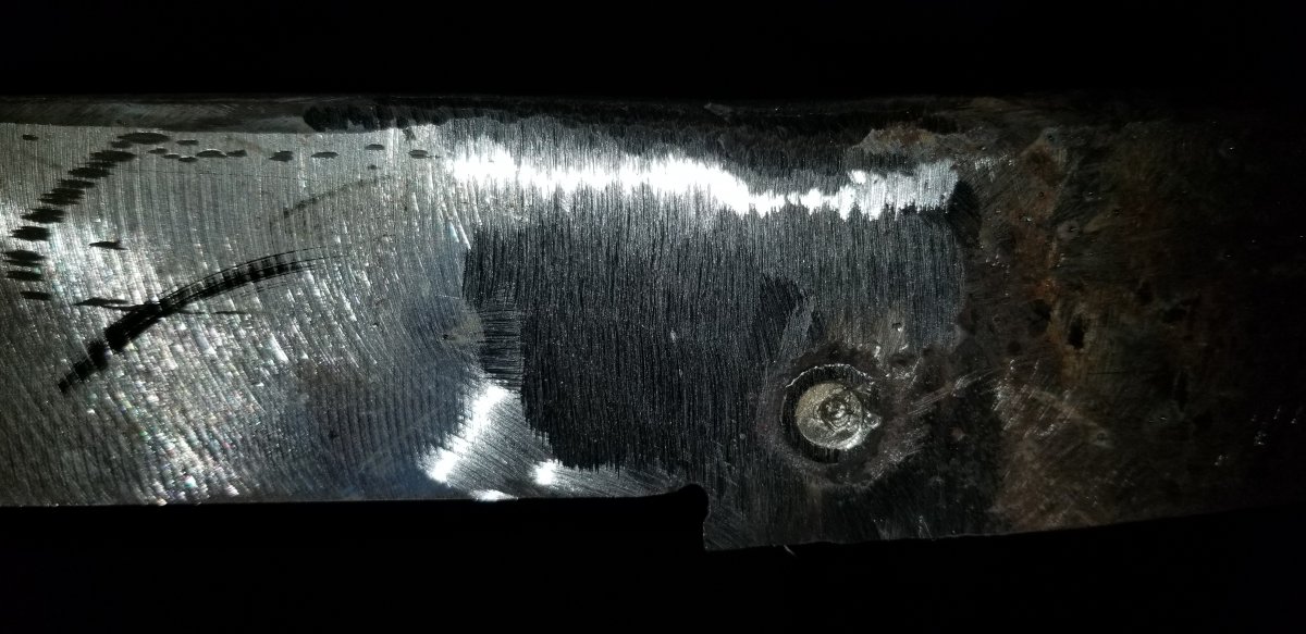

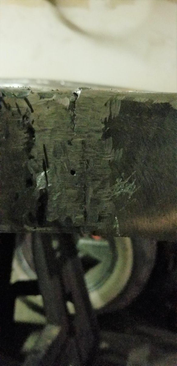

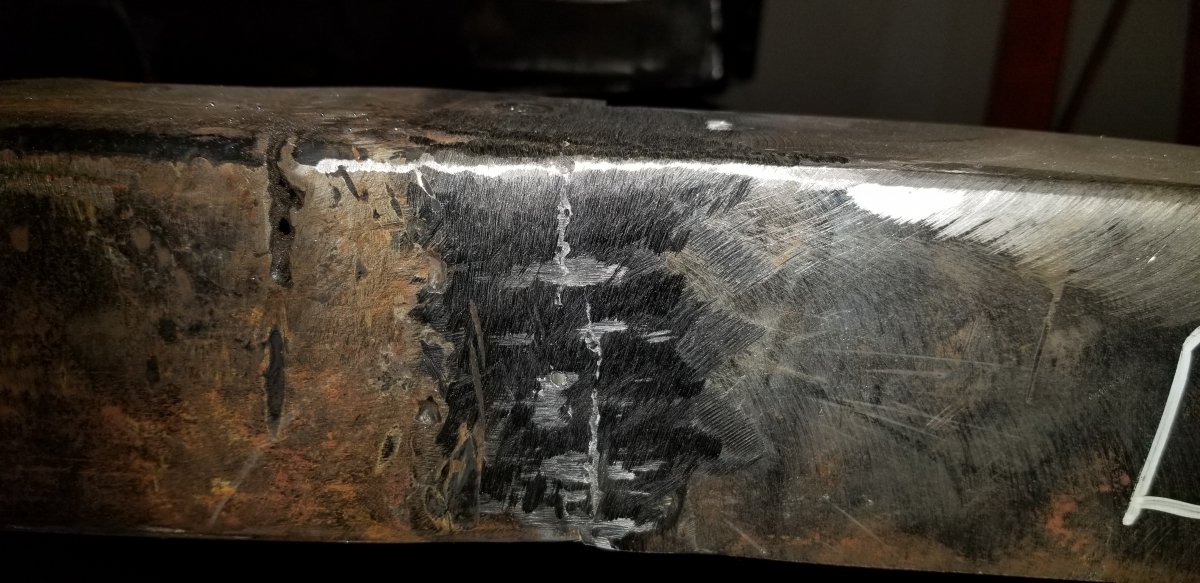

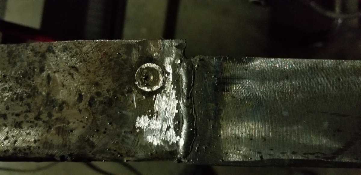

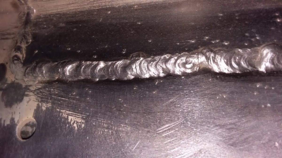

  30. Just came back from my garage and feeling VERY SATISFIED with my new approach, using flux core gasless welds. Clearly noticed how these welds were much flatter, using the recommended settings of G-3 from my own MIG135 welder. Mike @cactus1 knew that my prior welds were too cold, sitting on top of the metal like skys****ers... Photos 4 and 5 shows the height of the welds, 6 and 7 shows the penetration from the back of the metal.
    So I just dove in at this point to re-weld my new front '32 Ford frame horns. Felt very happy with the penetration and fusion process, as you can see with my last photos of grinding the outside of the frame rails smooth. I even attempted to fill in a good size hole where the **** weld took place with my new magnetic plug weld tool and showed successful!
    Another issue I'm having is that I barely can see the area where I'm welding. I bought one of those black contact tips that come to a point so I can see much better as I'm using the weld gun, but they do not fit. I was wondering if I can just leave off the copper tip (not the tip for the proper size wire)? I'll try purchasing one of those small LED lights that attach to the gun and hopefully brighten the weld area somewhat better.
