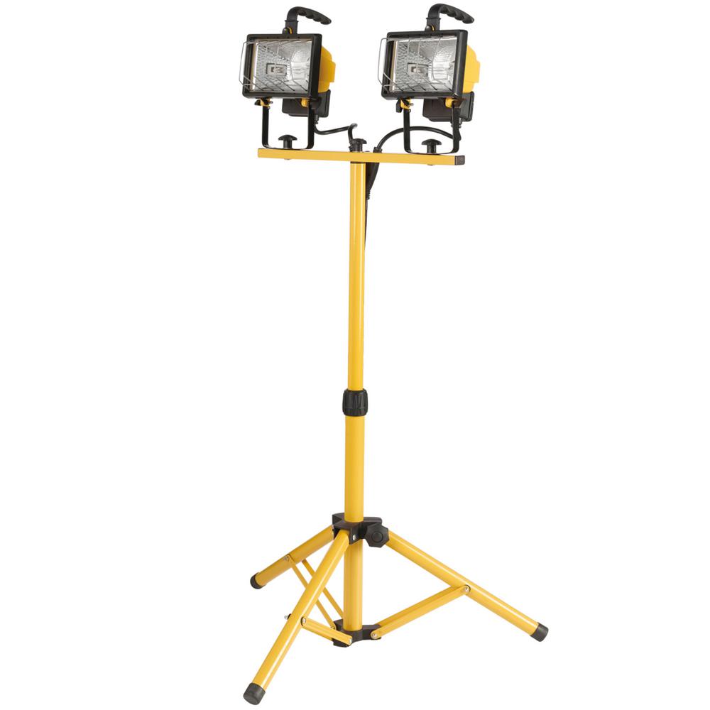

    You have to be able to see what you are welding. I use one of these lights, get it damn close but not in the way and I can see the puddle fine with this one. There portable and adjustable so that it will shine right on the work piece. I think mine cost around $35.00 qwzzx.jpg

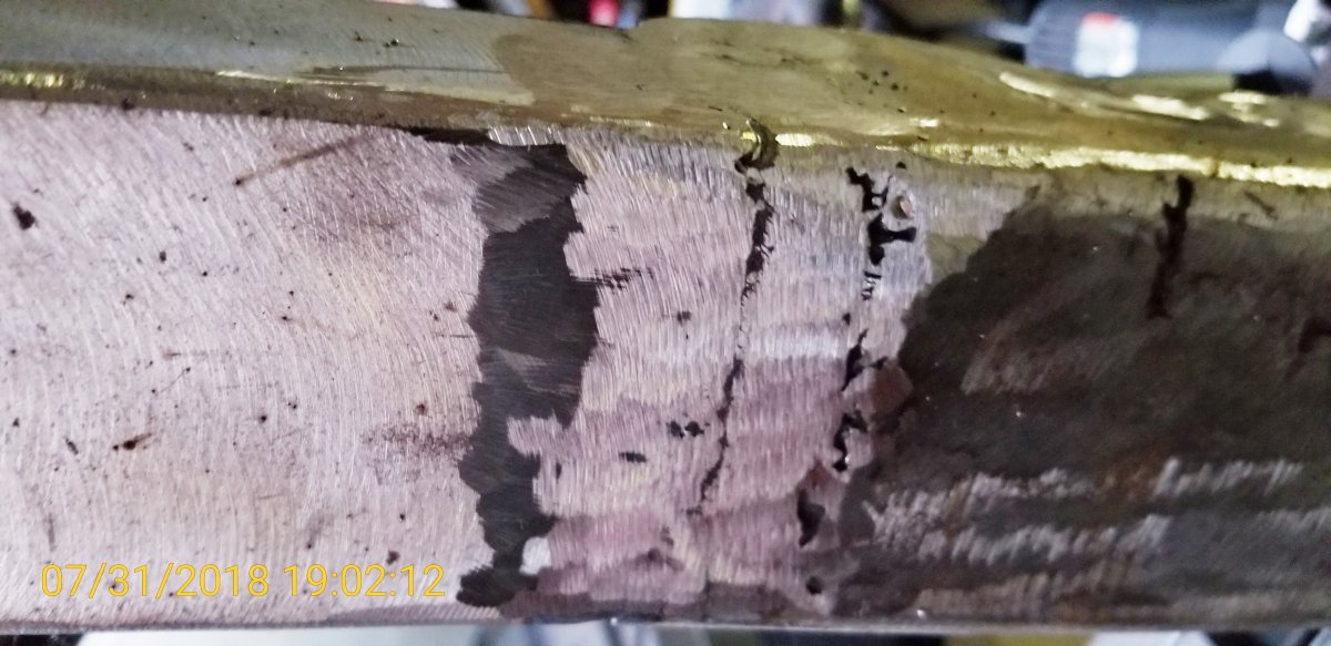

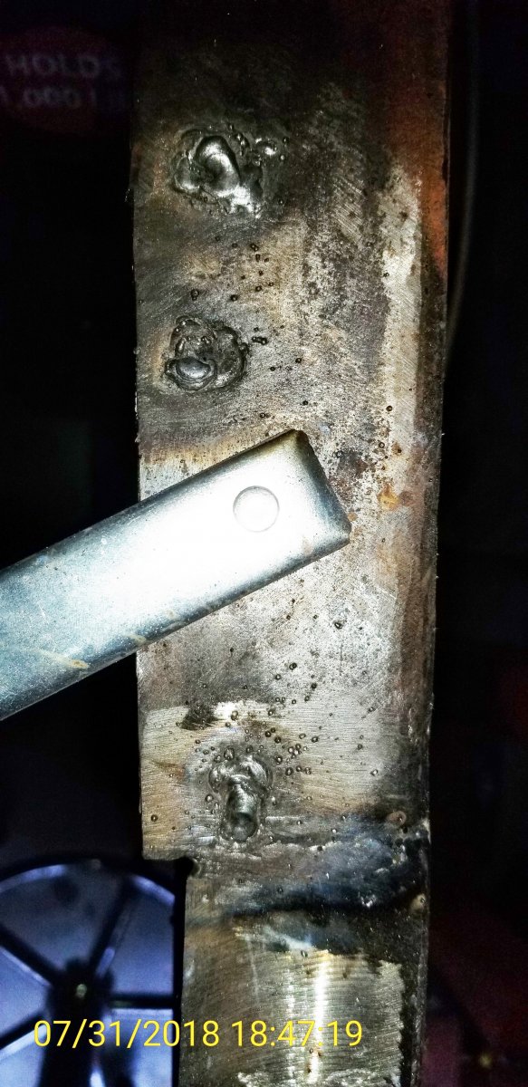

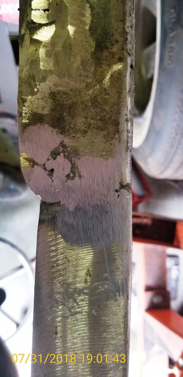

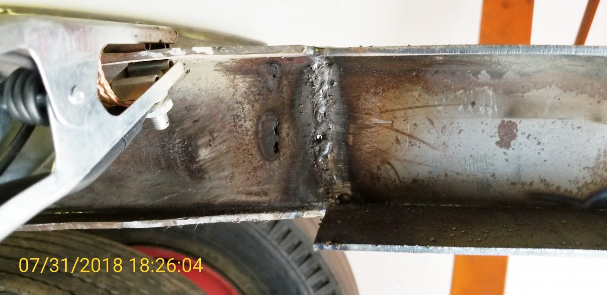

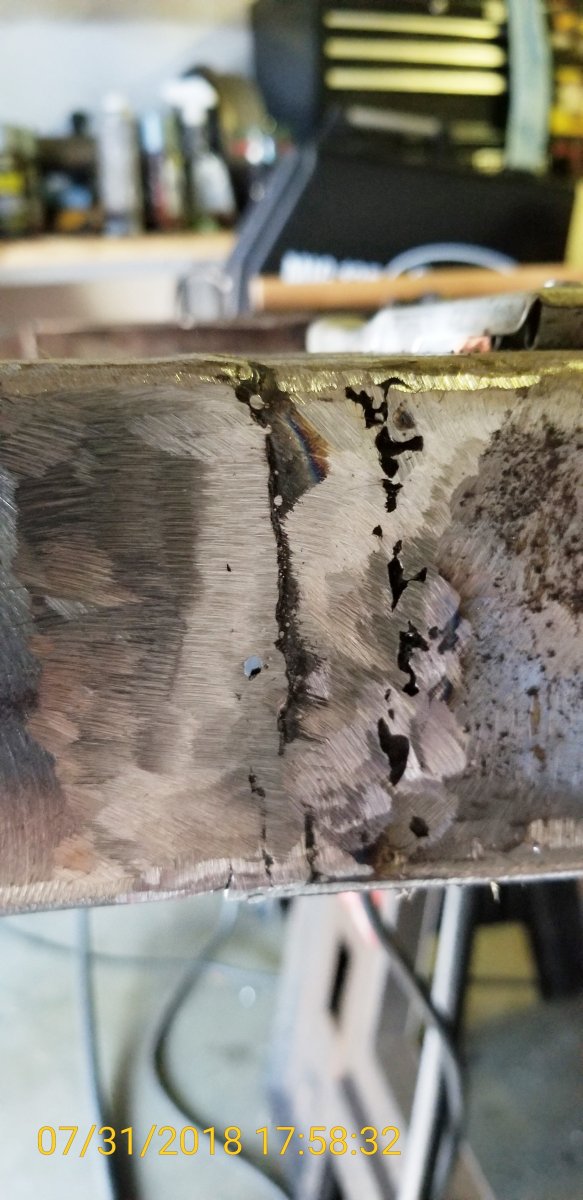

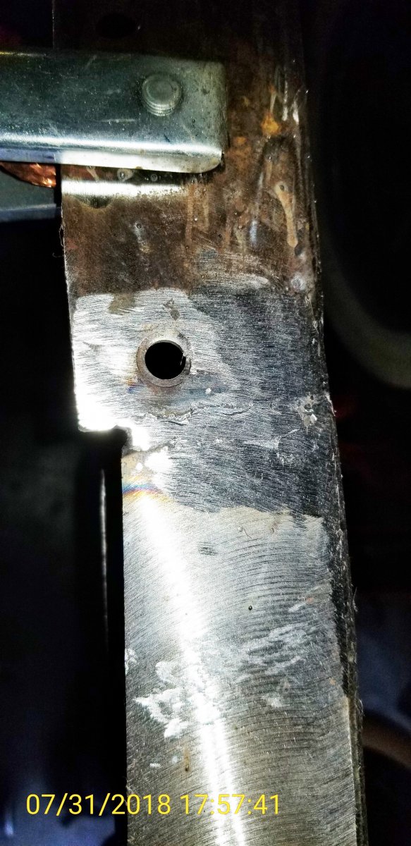

  11. Despite the dreaded heat in my garage, I went in and spent some time completing the flux core welds on the second front frame horn. Now, they are both welded on properly with excellent penetration as you can see in my photos.
    This time, I went a bit further and welded up some of the bigger holes (3/8") in the frame rail as well. Not bad for some needed practice! You can see little peep holes, but will come back and finish them off with ease. You can see some of the low spots in the metal surrounding the **** welds, but will come back much later and fill with a metal filler to smooth up the rails like a baby's ***!
    Next step on the weekend or so will be to use my new 4 ton porta power. My luck, it did NOT come with any instructions on how to use it. Anyone have any knowledge on its use? Just filled it up with some better quality jack oil, set my frame up on its side vertically with some 2 x 4's against the concrete floor and plan to use the porta power in a vertical position to push the p***enger side area of the rail.
    I'm gonna try to bend the rail from the bottom of the c channel from the lip. Question: should I cut the Chevy frame mount only on the p***enger side to allow the frame rail to move easier? As always, the advice I receive from my fellow HAMBERS is extremely appreciated!

    Looks good. Put one more little shot in the middle of the holes you welded up to account for the molten metal shrinkage as it cools. That way when you grind flush, there is enough weld metal. you should do this at the end of a weld also to keep from having a thin spot in the crater that can crack.
    Also, it is good practice to strive to have a good transition along the edge of where the two pieces join. (I am referring to your first picture where the wide flange meets the narrower flange, the weld should go a little further.).
    In the frame horn, it is not highly stressed, so should not be a problem, but good practice.
    Keep up the good work!

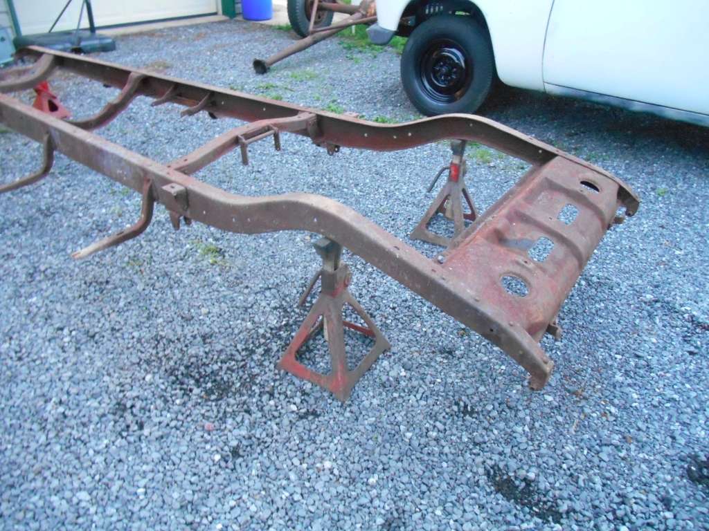

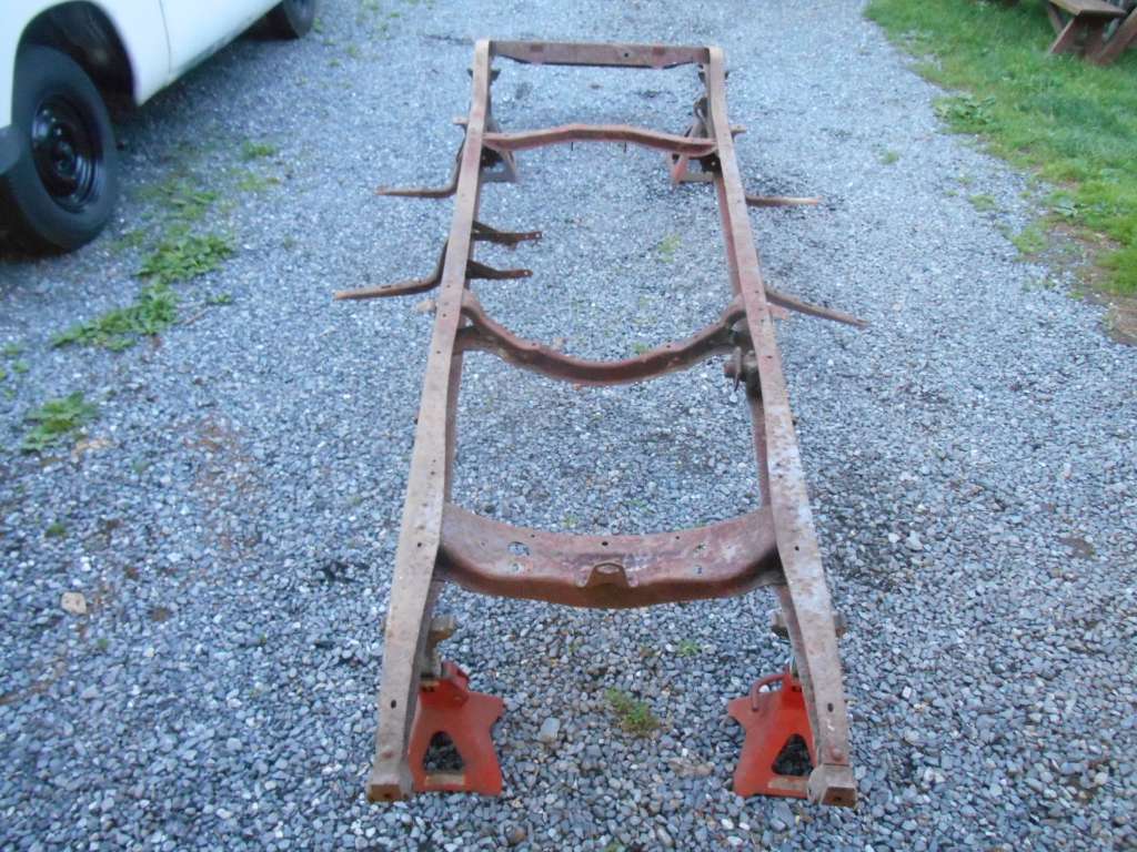

  18. Thinking about my frame situation deeper, I thought about purchasing another stock frame and cutting out a sizeable section of it to repair the bent section in my own frame. Sounds crazy, but it can work out very well as long as my v-**** welds are strong enough. I would come back and as I planned before, weld in the 1-1/2" square tubing in the upper and lower inside corners of the frame and finish off step boxing the engine and center x-member area.
    So I place an ad in the wanted section of the HAMB last week and four days later, a fellow HAMBER responds with an original and STRAIGHT to what I believe is a '31 Chevy frame - finally texting me some photos early this morning!
    He lives in Missouri, so it would be nearly impossible to pick up his frame. I'm hoping he would be willing to help a fellow hot rodder out and cut out the section that I need and send it to me UPS if it's not too long. My thinking is that he must have a '31 Chevy body and decided to go with a NEW ch***is to rebuild his hot rod... Here's some photos that as one can imagine, is making me a bit crazy to possibly solve my frustration...

    This was a great idea for your situation Jeff, but not in my case. Look at the photo I took with my frame on the ground and placed my phone on the floor, aiming at the ch***is rail with my T-square. Good to hear from you again! How is your coupe coming along?
