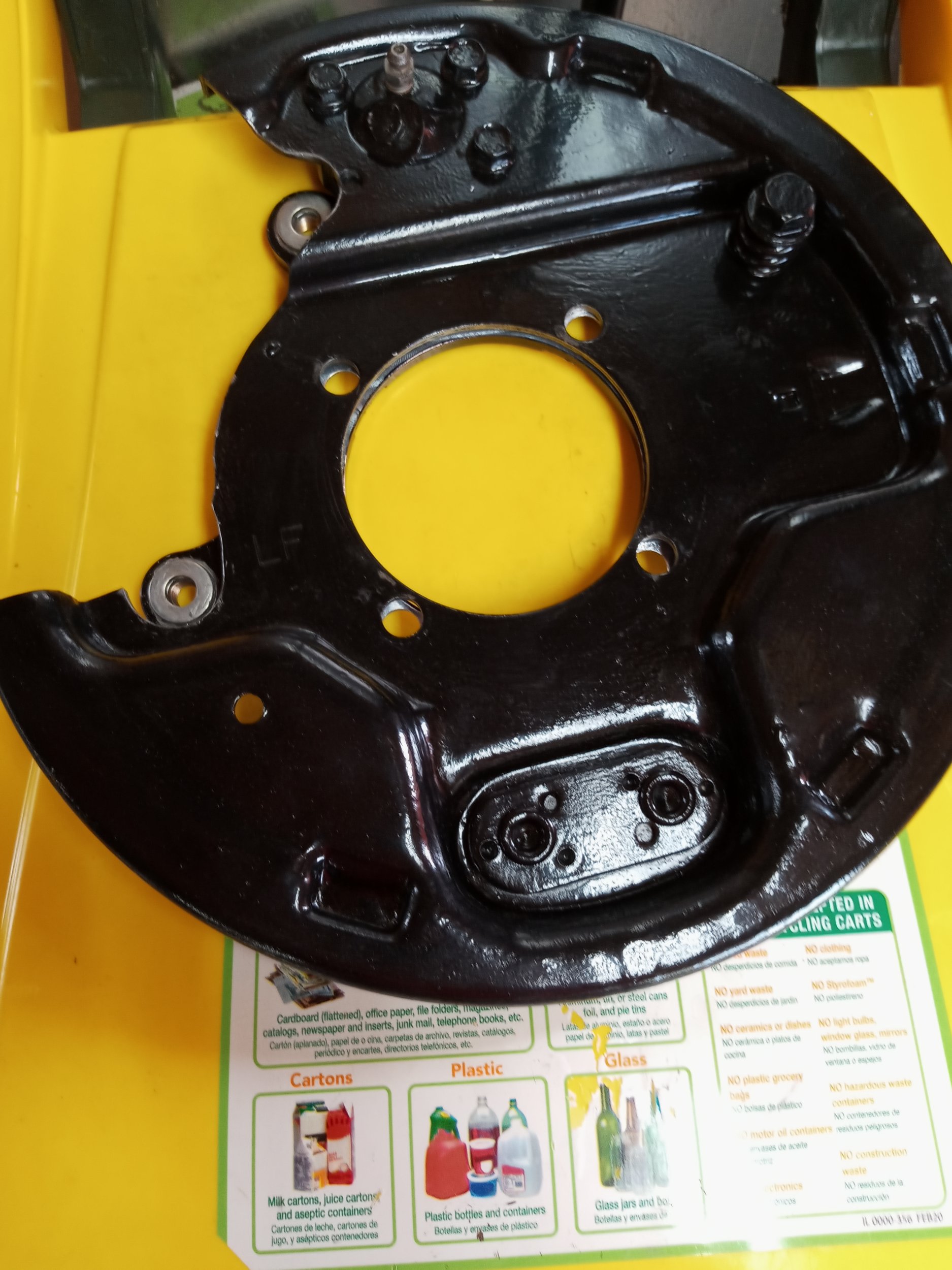

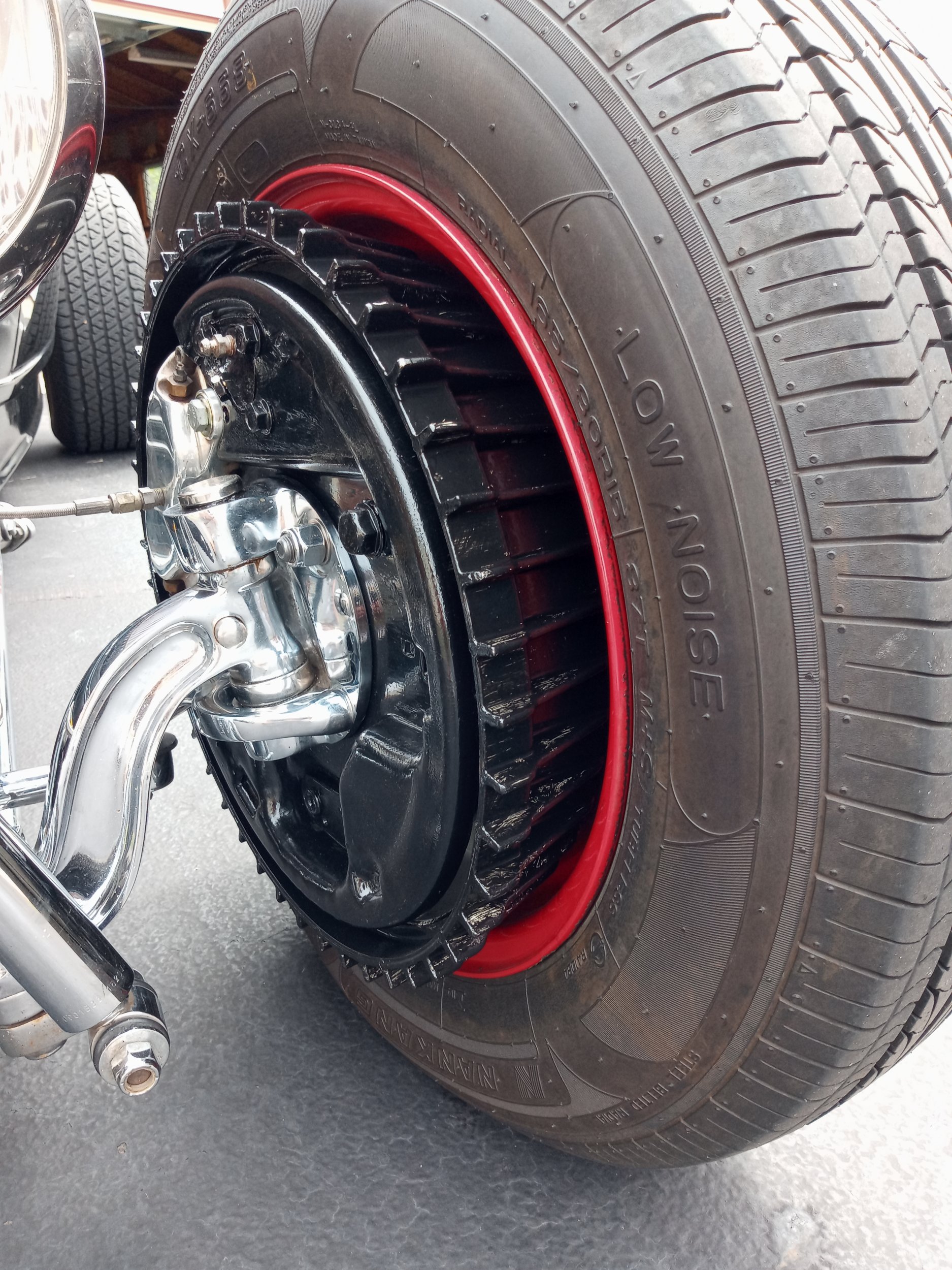

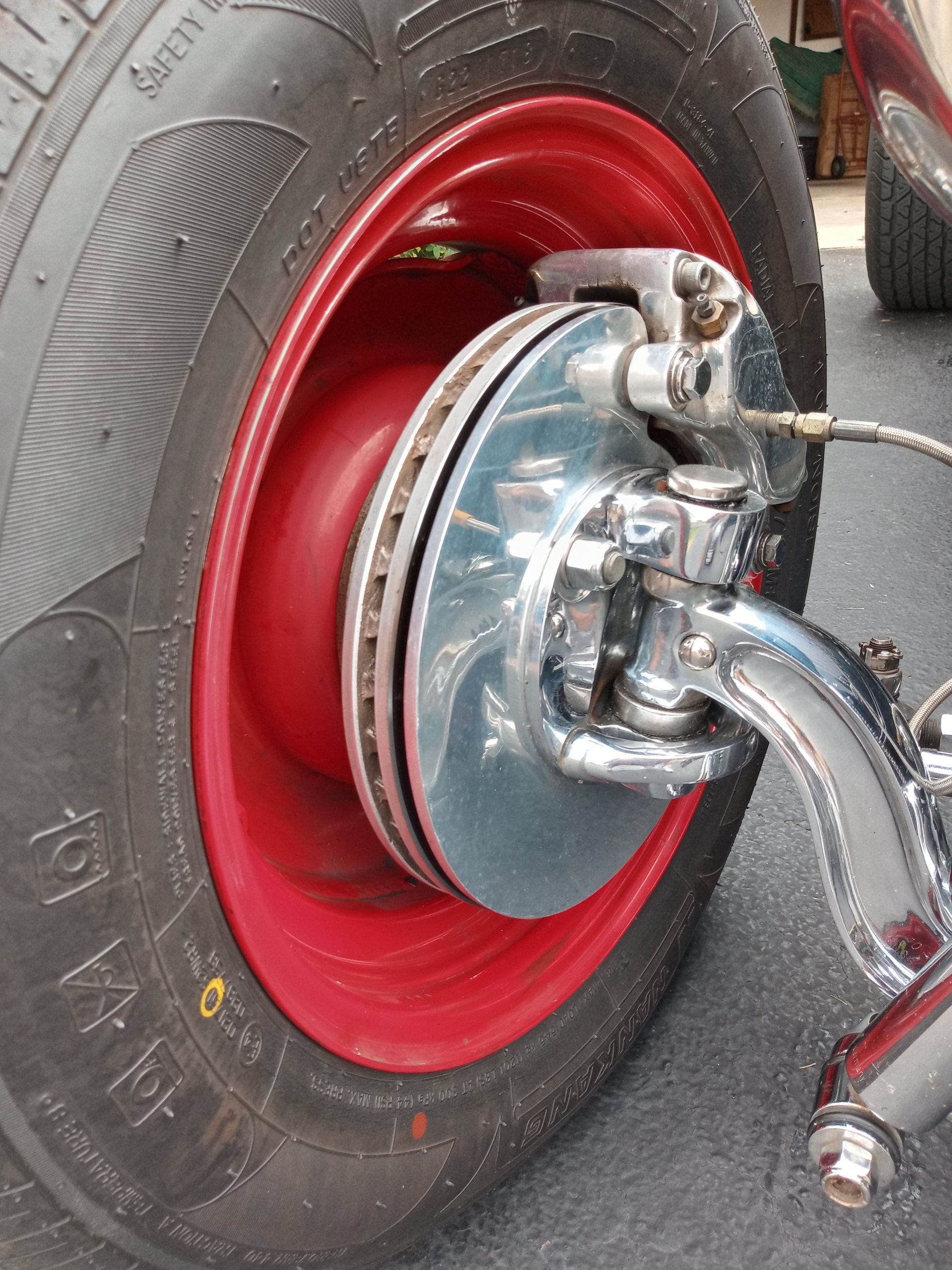

    I have the p&j disk brake kit. I was able to make it look more traditional without giving up braking efficiency .
    From this:
    To this:
    Bought a pair of "40 Ford backing plates and modified them.

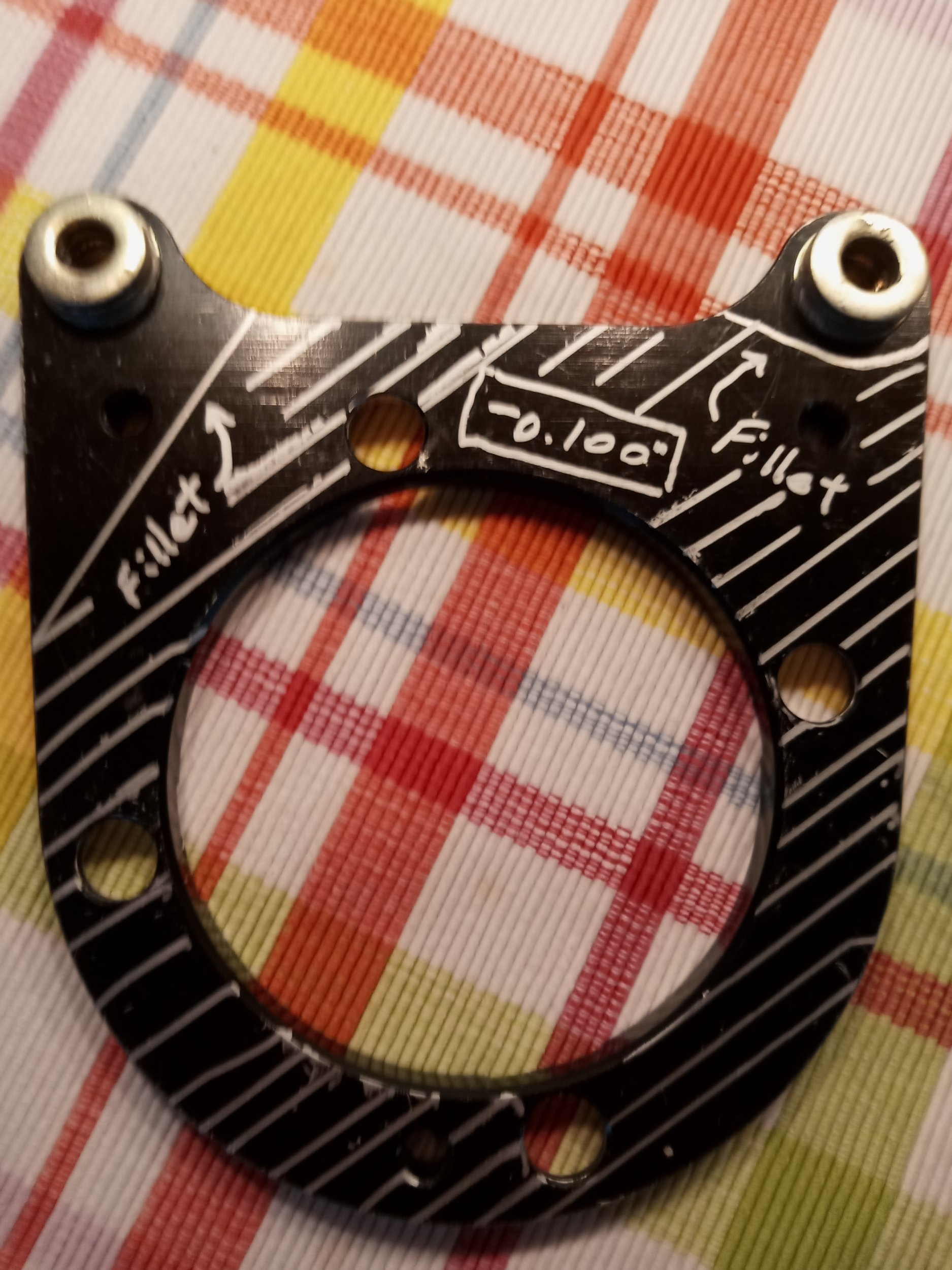

    Then a pair of Wilwood caliper brackets:
    The drums are fake Buick drum from Roadster Supply.
    https://www.roadstersupply.com/Buick-Style-Drum-Covers-Plain-p/soc-62027.htm

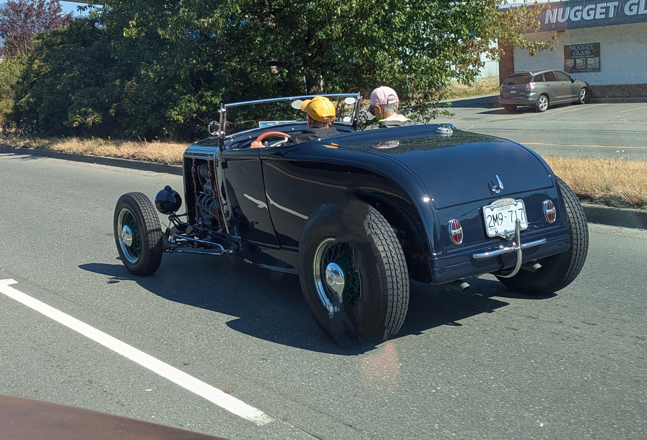

  5. '30/31 on a deuce chassis works for me! This is my buddy's 2025 AMBR Contender cruisin' down the hwy.

    Thanks for the help., Great Pictures by the way.............I have seen some hokey cover-ups using Wal Mart Frying pans, yours looks Great ! In the picture of the caliper bracket, what do you mean with the "Fillet" line ? do they need to have 0.100" milled off to allow for the thickness of the backers? then are the wheel lugs long enough ? I was also planning to rum 1932 Ford Spokes with a Speedway wheel adapter ( #910-28352) to accommodate the Original spokes. Thanks for the help, I'll have to start looking for an extra set of backers !!

    A fillet is a small radius, rather than a very square/sharp line. This helps relieve the possibility of a stress crack along the line.
    Yes, the bracket was too thick. After milling, it is still thicker than the original round caliper bracket, and now the rotor doesn't rub the brake backing plate.
    I'm still using the original wheel studs, but they could be a little longer due to the thickness of the brake drum between the wheel and the axle hub.
