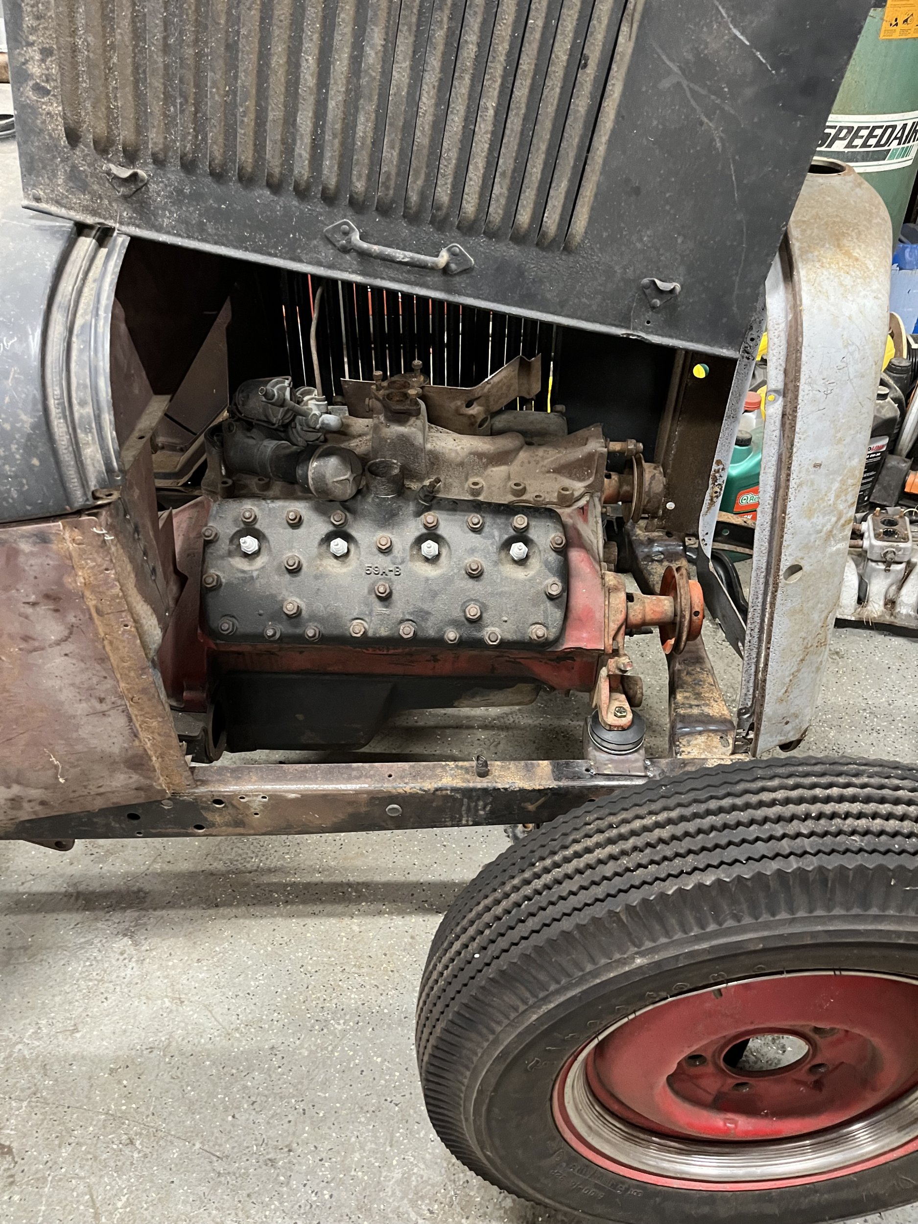

    First item on the chopping block. The Yblock. These engines just aren’t in my wheelhouse and freeing up some funds is going to help me progress this car greatly so I struck a deal with a friend that wants it for one of his projects, and now it sits patiently to the side for its day.
    Instead we are going flathead v8. Im way more comfortable working on these engines and i have abundant flathead junk laying around.

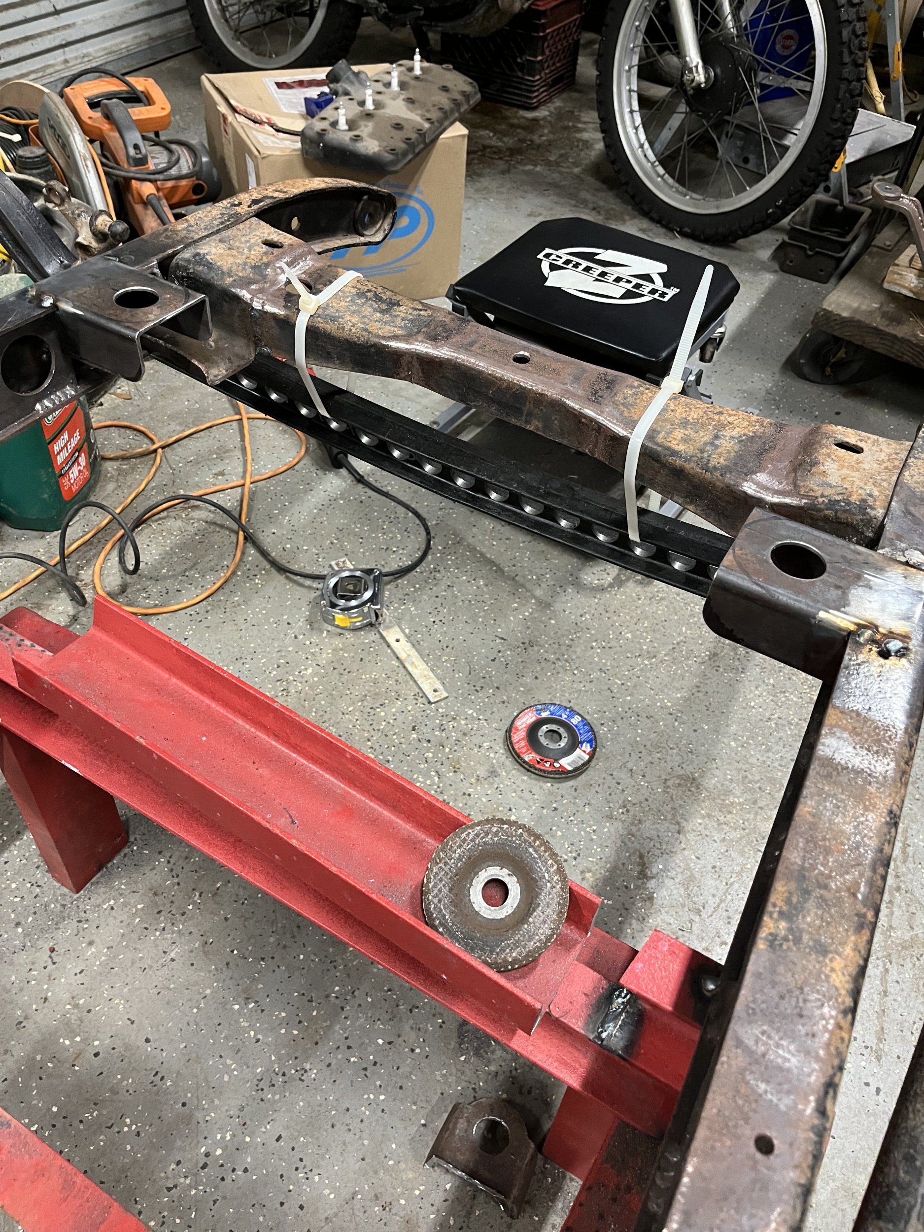

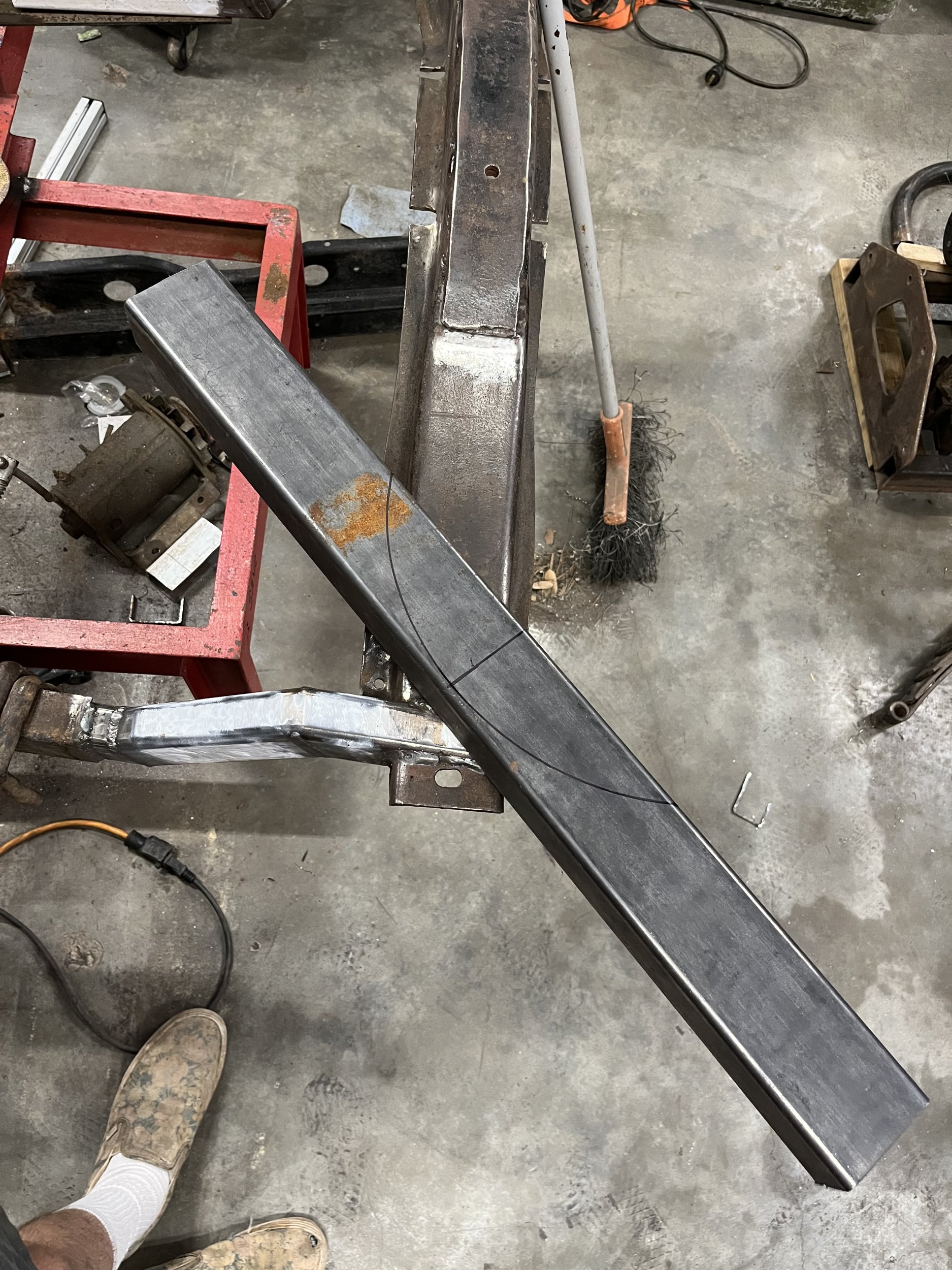

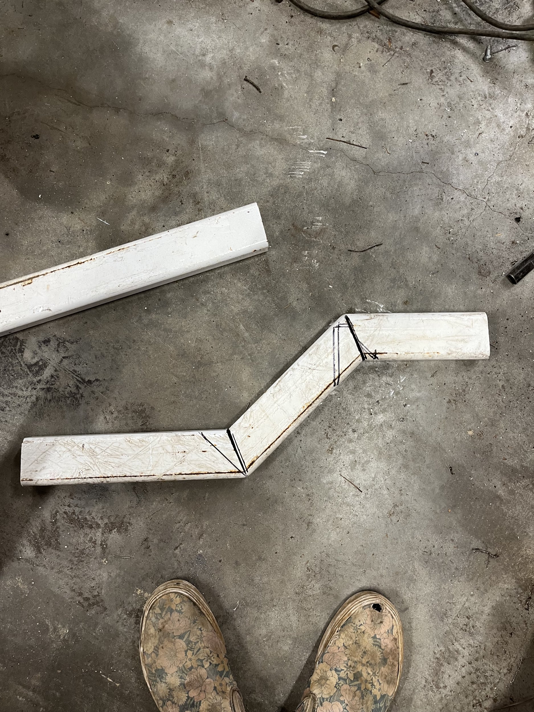

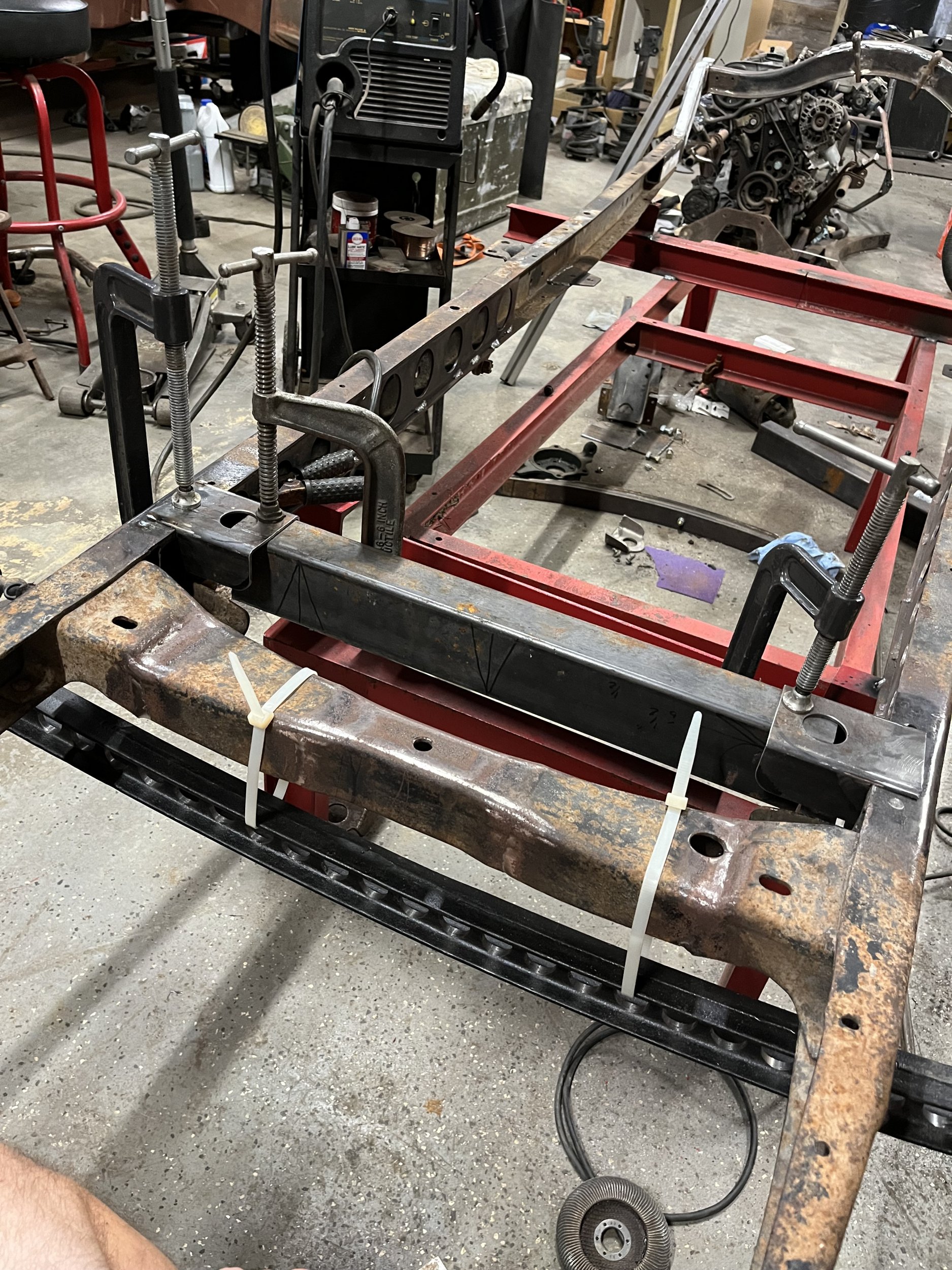

    When I last left off on the car, I had just cut the rear of the frame off to build a bigger Z. The 6” Z is still in the plans so I decided to get that item checked off the list to get this frame closer to being cut out of the jig. Im also going back to a spring-on-top banjo set up and returning to the original wheel base.
    IMG_4253.jpeg IMG_4431.jpeg IMG_4483.jpeg IMG_4514.jpeg The rear crossmember needed lots and lots of love. I spent close to 6 hours straight with a grinder and welder fixing cracks and previous backyard repairs to make it safe and useable. At least the ugly parts will be hidden..

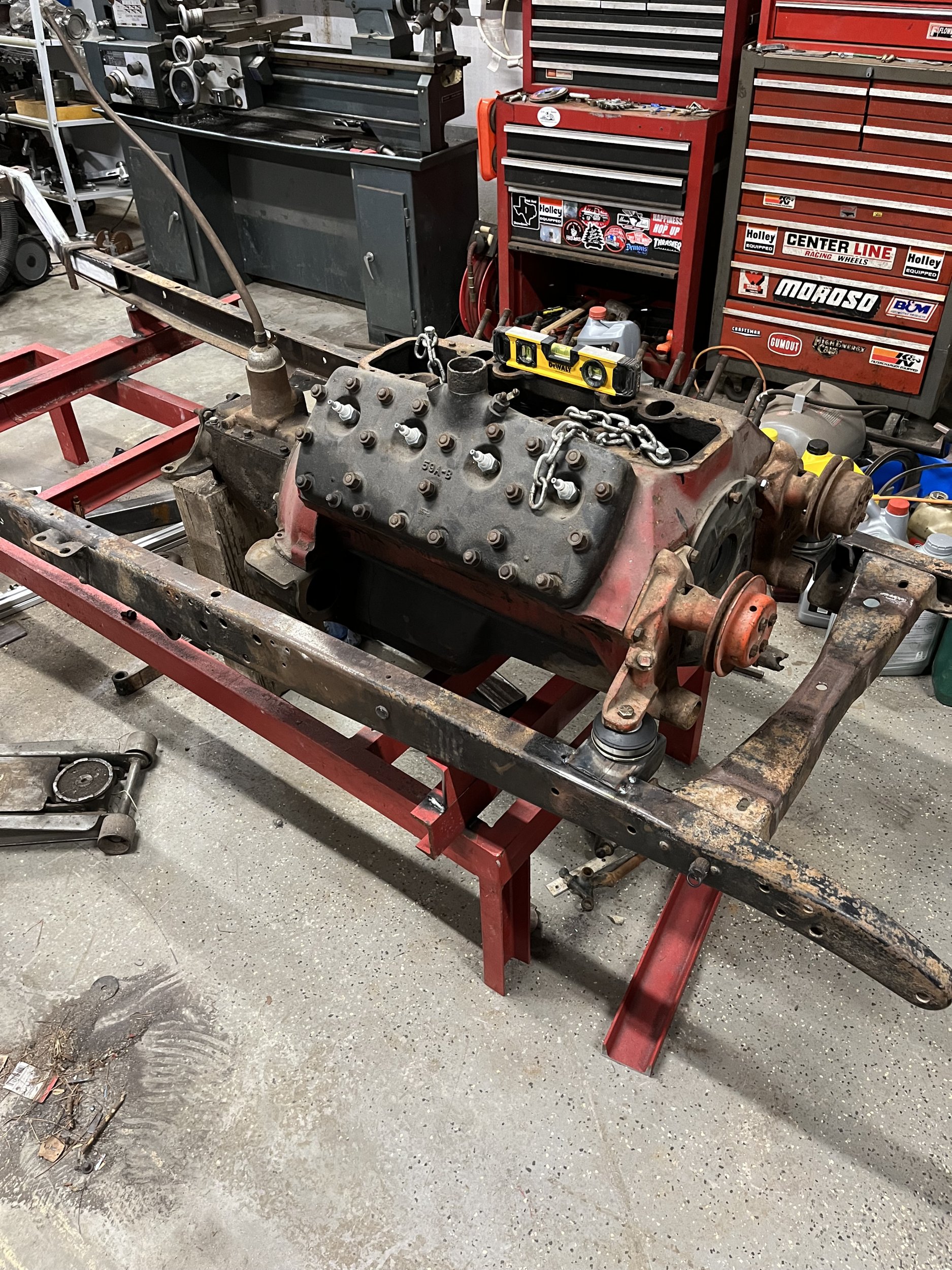

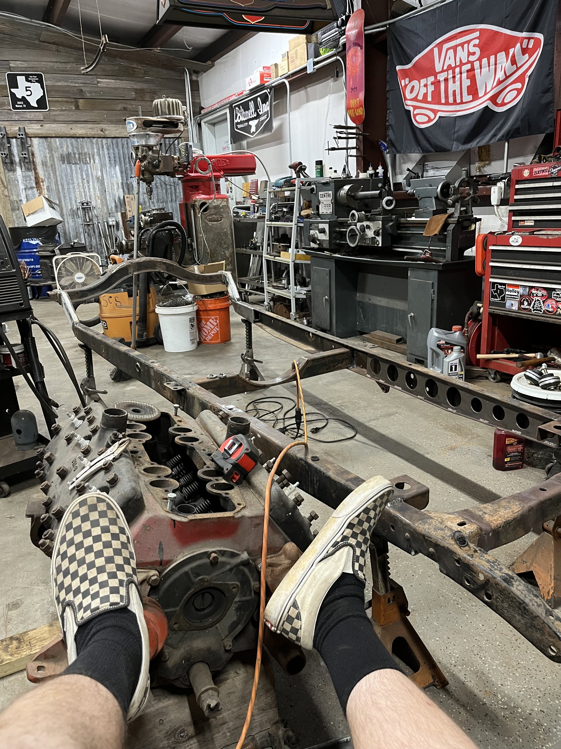

    With the rear crossmember square and tacked in, I decided to drop the engine and transmission in and get my mounts figured out. Sadly the old engine mounts for the Y block were too far off so they needed to be cut out.
    IMG_4551.jpeg IMG_4601.jpeg IMG_4679.jpeg IMG_4680.jpeg IMG_4681.jpeg IMG_4684.jpeg

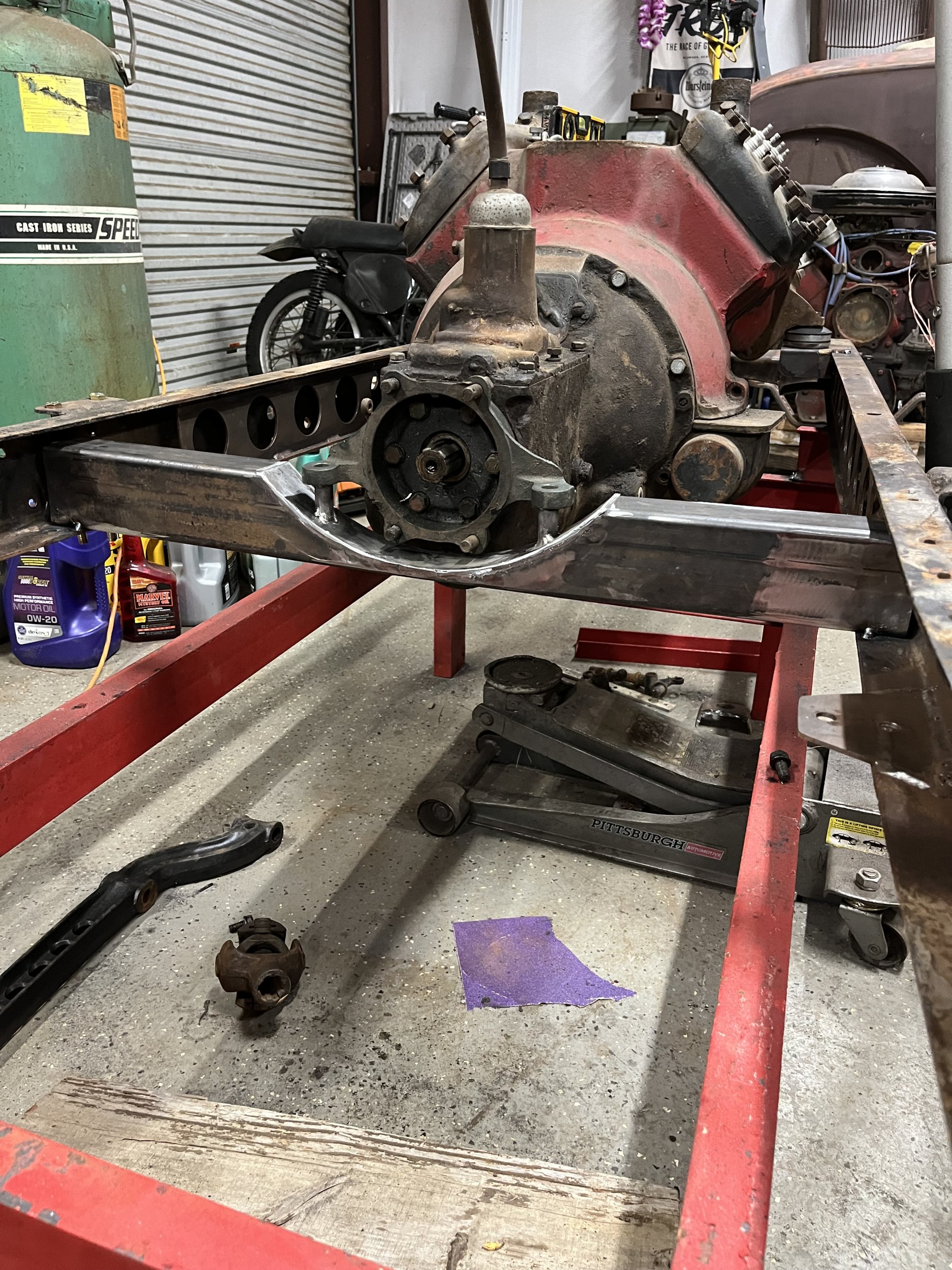

    Transmission mount up next. A little unorthodox but I really like the turnout and it’s pretty darn stout. I still need to machine some steel pads and rubber bushings for the ears of the mount to sit on. IMG_4692.jpeg IMG_4698.jpeg IMG_4699.jpeg IMG_4700.jpeg IMG_4760.jpeg

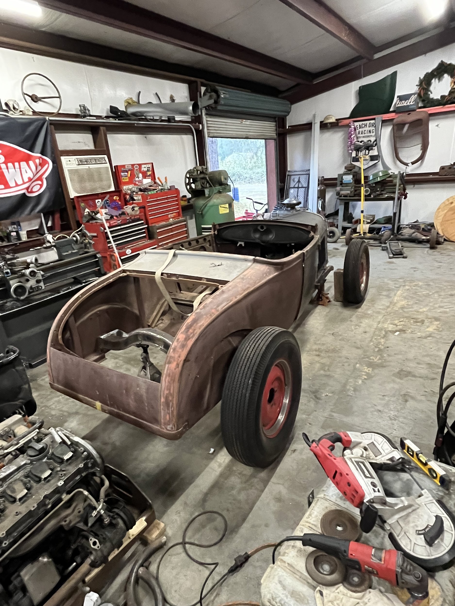

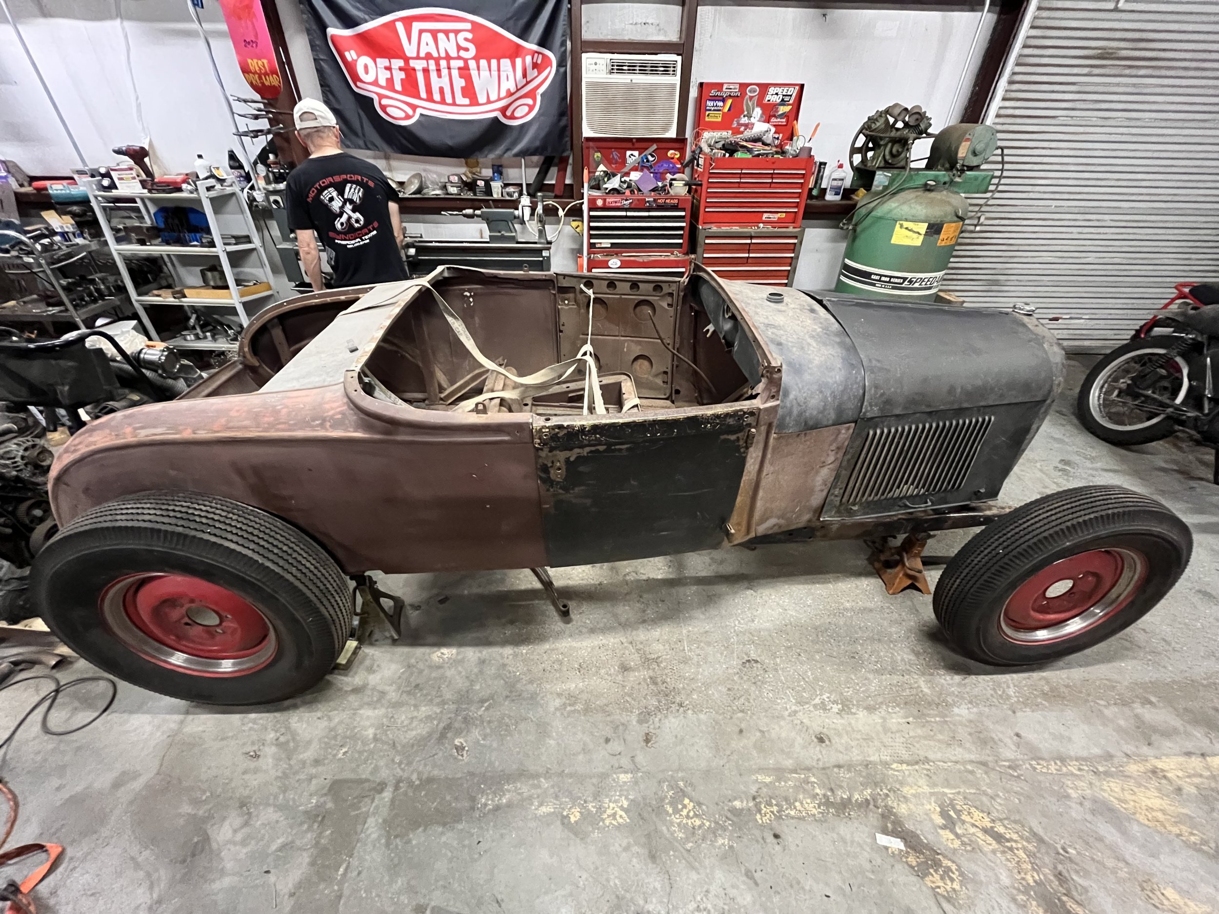

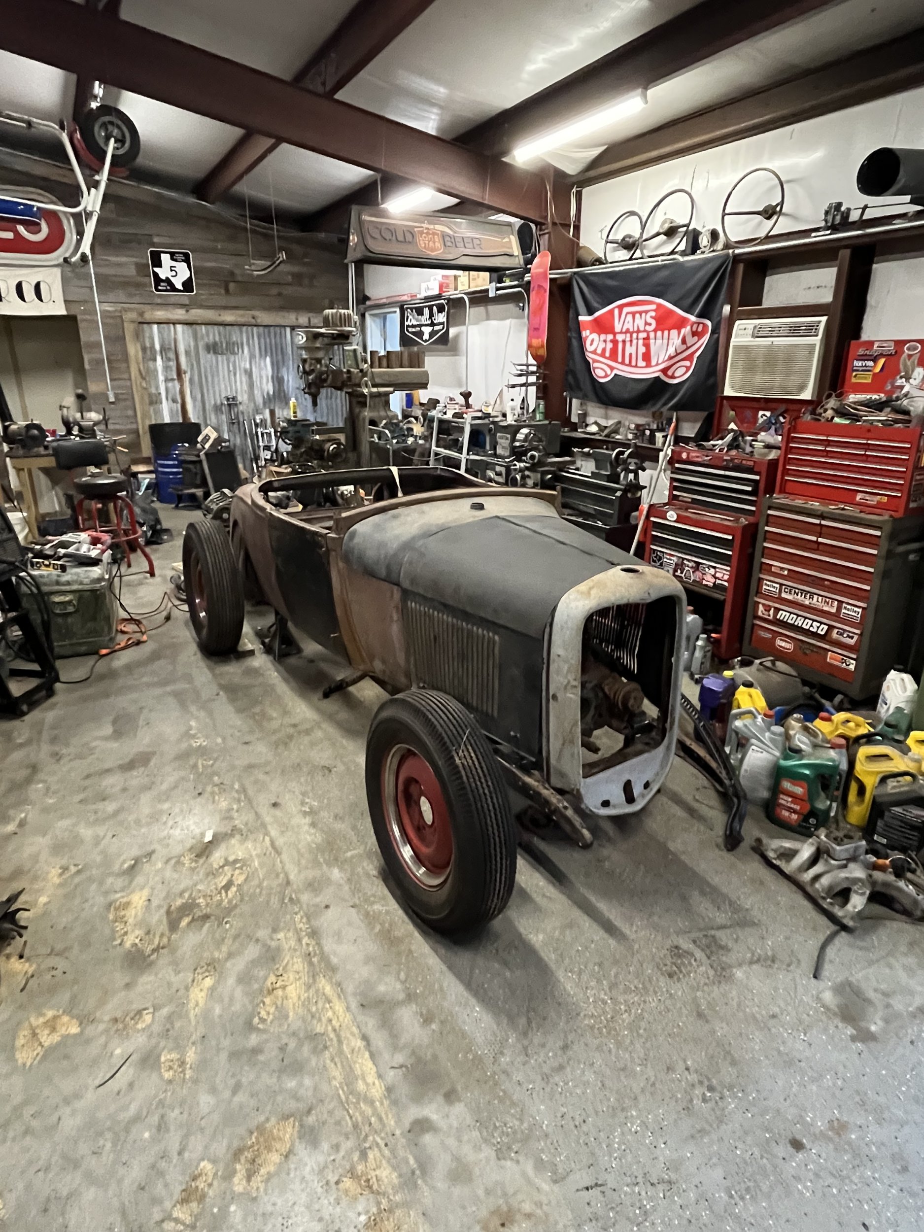

    Doing some math and using my model T for reference, I was able to get a good guess on how the frame will sit and got it blocked up into its “finished” position. I had some extra hands so we decided to set the body back on and put the engine and trans back in so I can start getting my firewall tackled and I just gotta say…. This car is turning out so cool! The stance is killer and I really couldn’t be happier with the way things are working out. IMG_4783.jpeg IMG_4766.jpeg IMG_4767.jpeg IMG_4776.jpeg

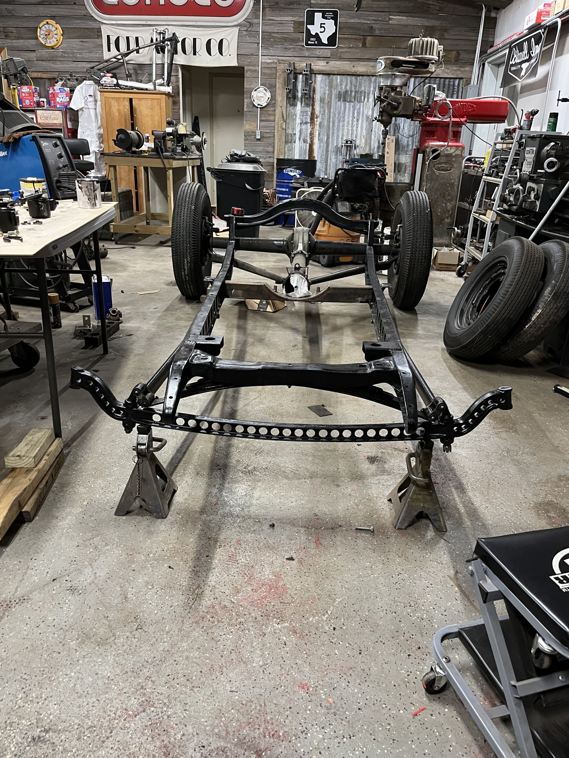

    I realized my axle wasn't holy enough. I fixed that.

    Since I pie-cut my wishbones to get my caster correct, I decided to play it safe and make fishplates for them.
    Next I spun down some shock link balls and welded them to the bones.

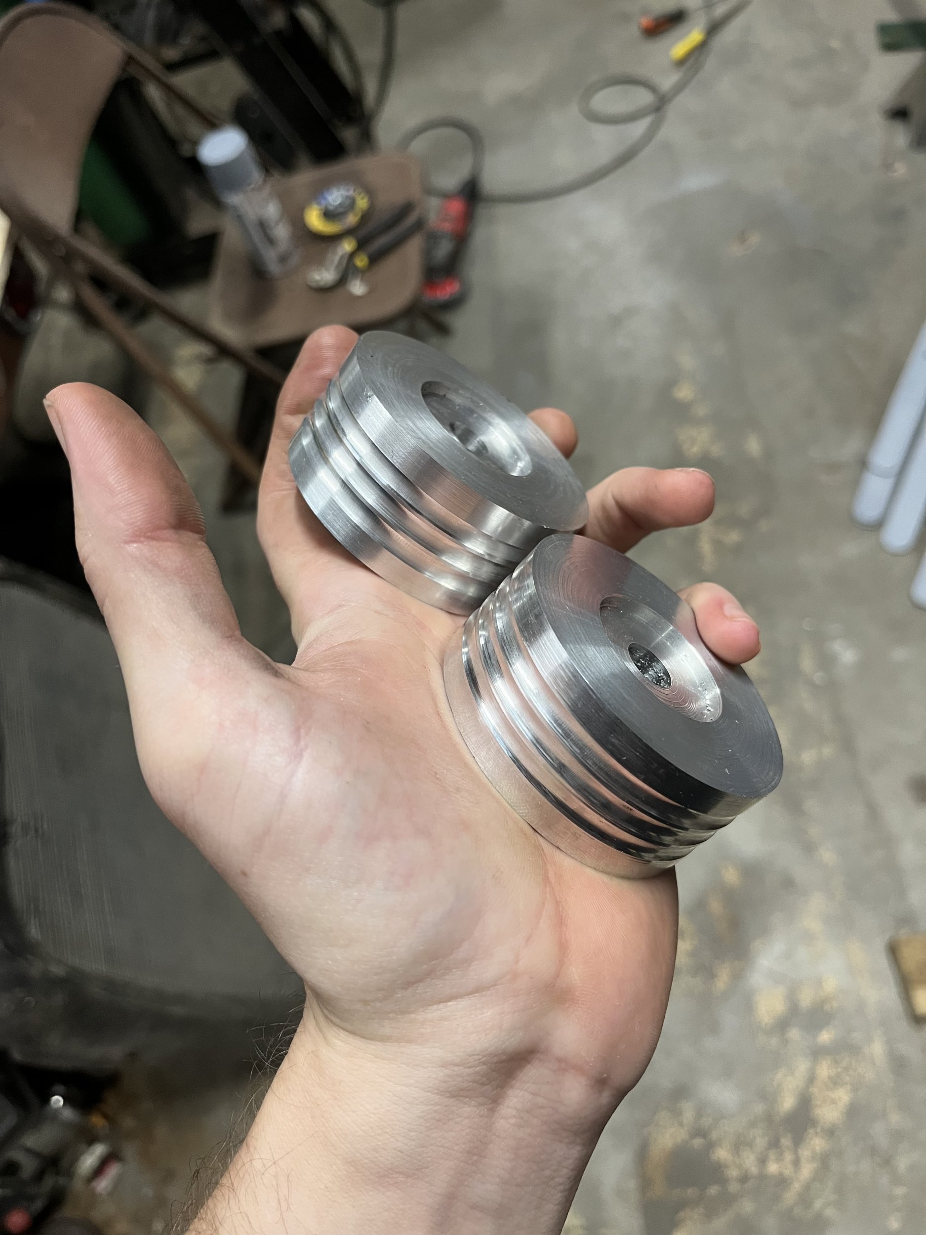

    I bought some 3" diameter aluminum billet to make my engine risers.
    Motor Mount1.jpg Motor Mount2.jpg Motor Mount4.jpg Motor Mount5.jpg Motor Mount3.jpg
    I think it turned out pretty cool for only having basic machining knowledge. I don't claim to be a professional at any of this stuff :D

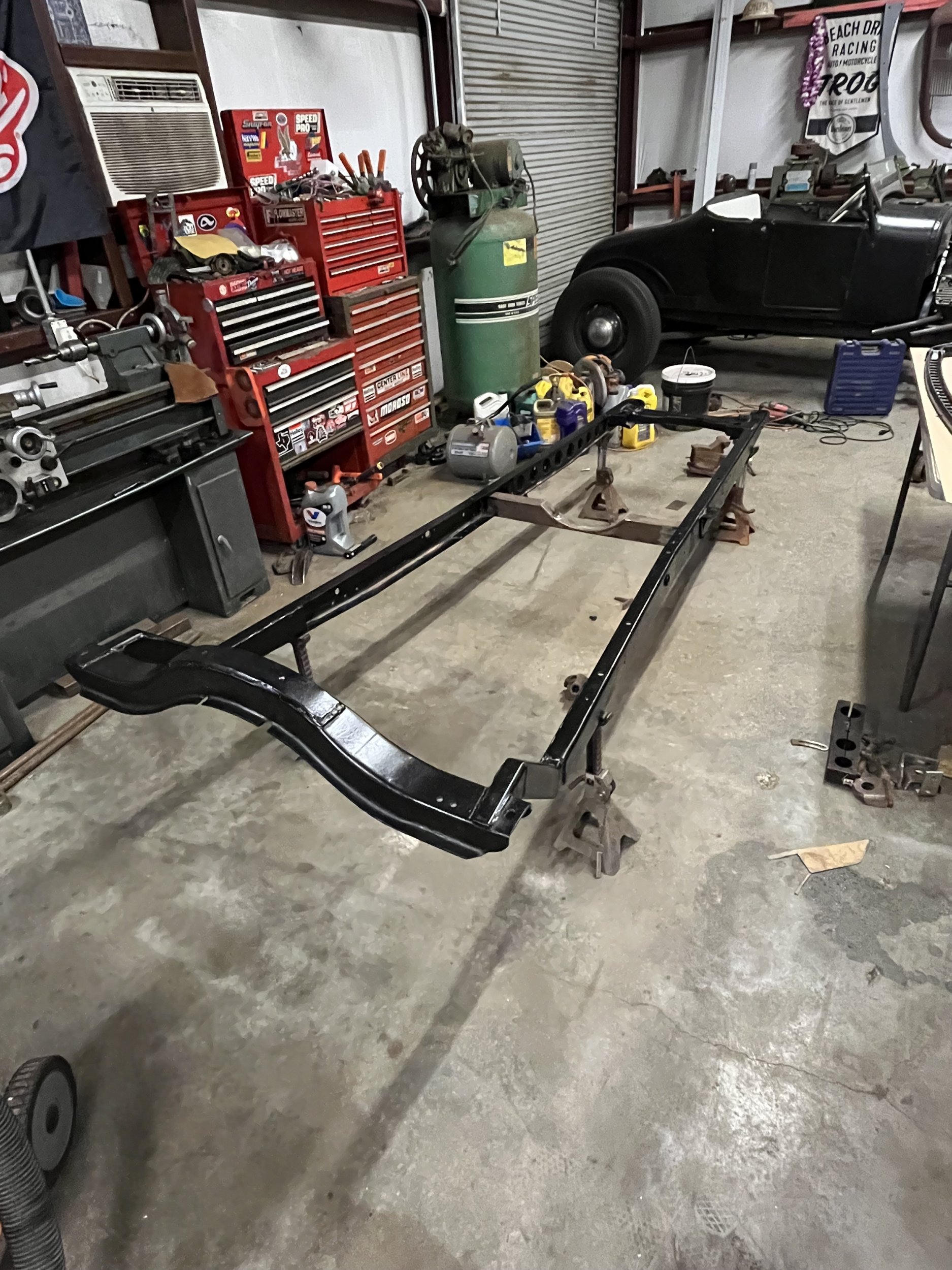

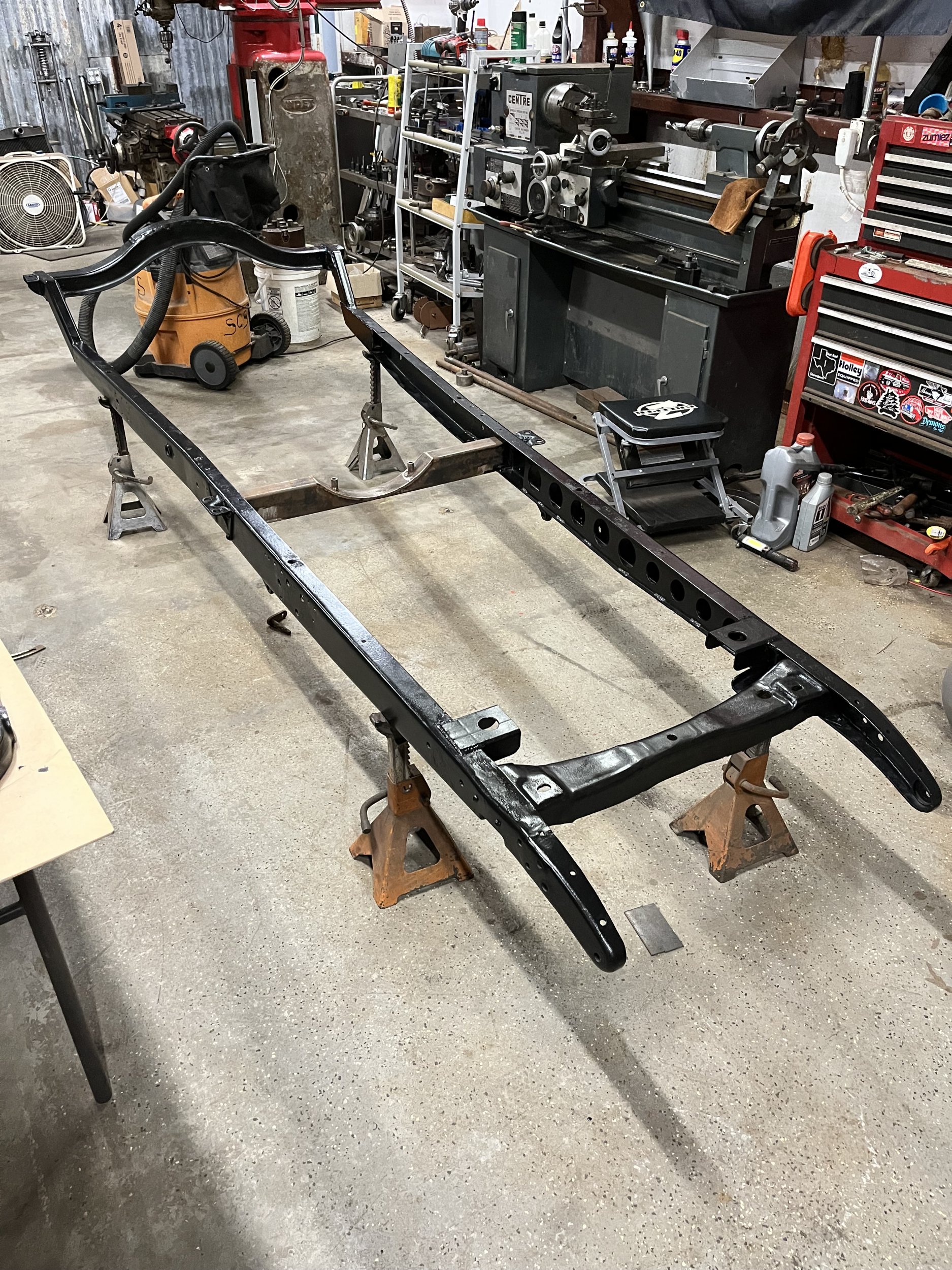

    I cleaned up the frame and put a coat of paint on it. I left out the transmission crossmember for now because I still have to add the mounts for the ‘32 truck pedals to bolt to.
    For those that don’t follow me on instagram, I revealed a couple weeks ago that I’m going to part out my model T and move the drivetrain over to this new frame. I am just about at that point and I’m pretty excited. If everything goes to plan, I should have a roller very soon

    Yesterday’s progress.
    My axle is so Holy it has a slight glow to it with the lights off :p I love it.

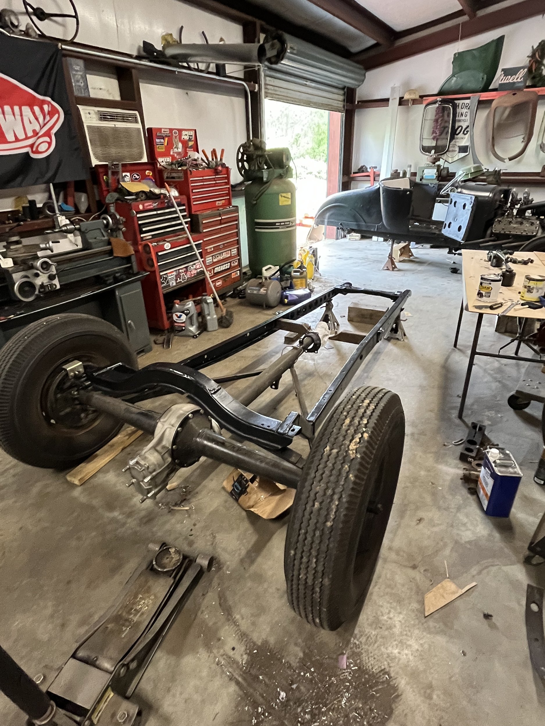

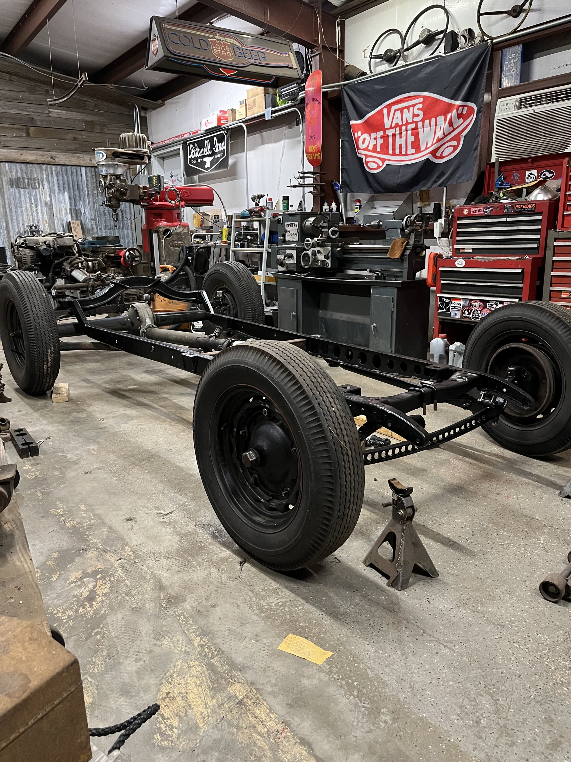

    Spindles mounted so why not throw the hubs on and make it roll! I still need to re-paint my backing plates. IMG_6823.jpeg
    Im loving the way it sits, Im excited to see it with the engine in and sitting even lower.

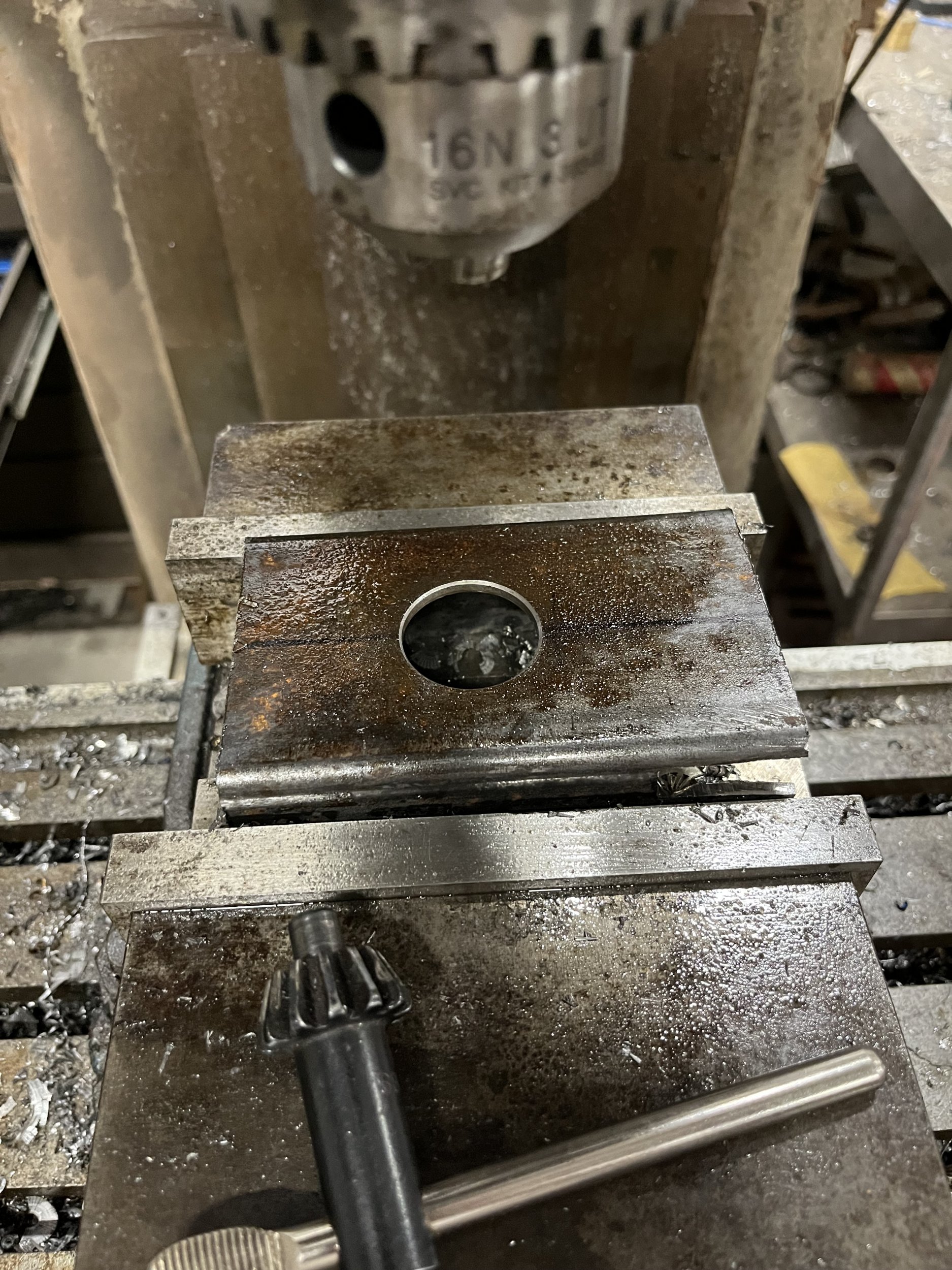

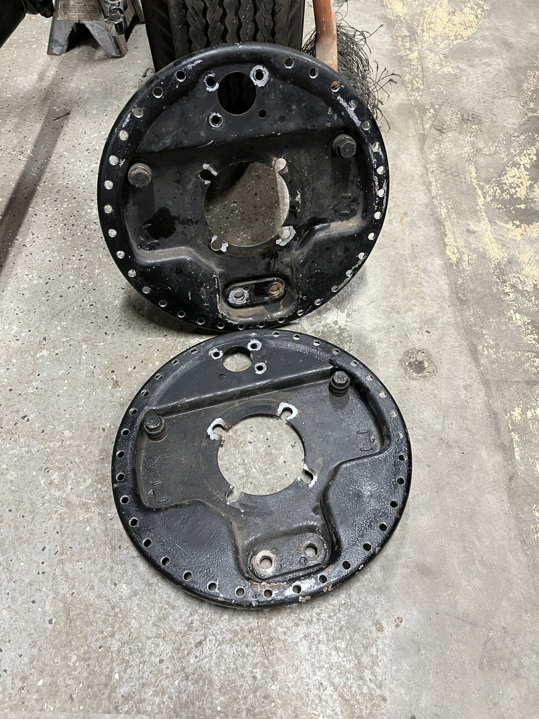

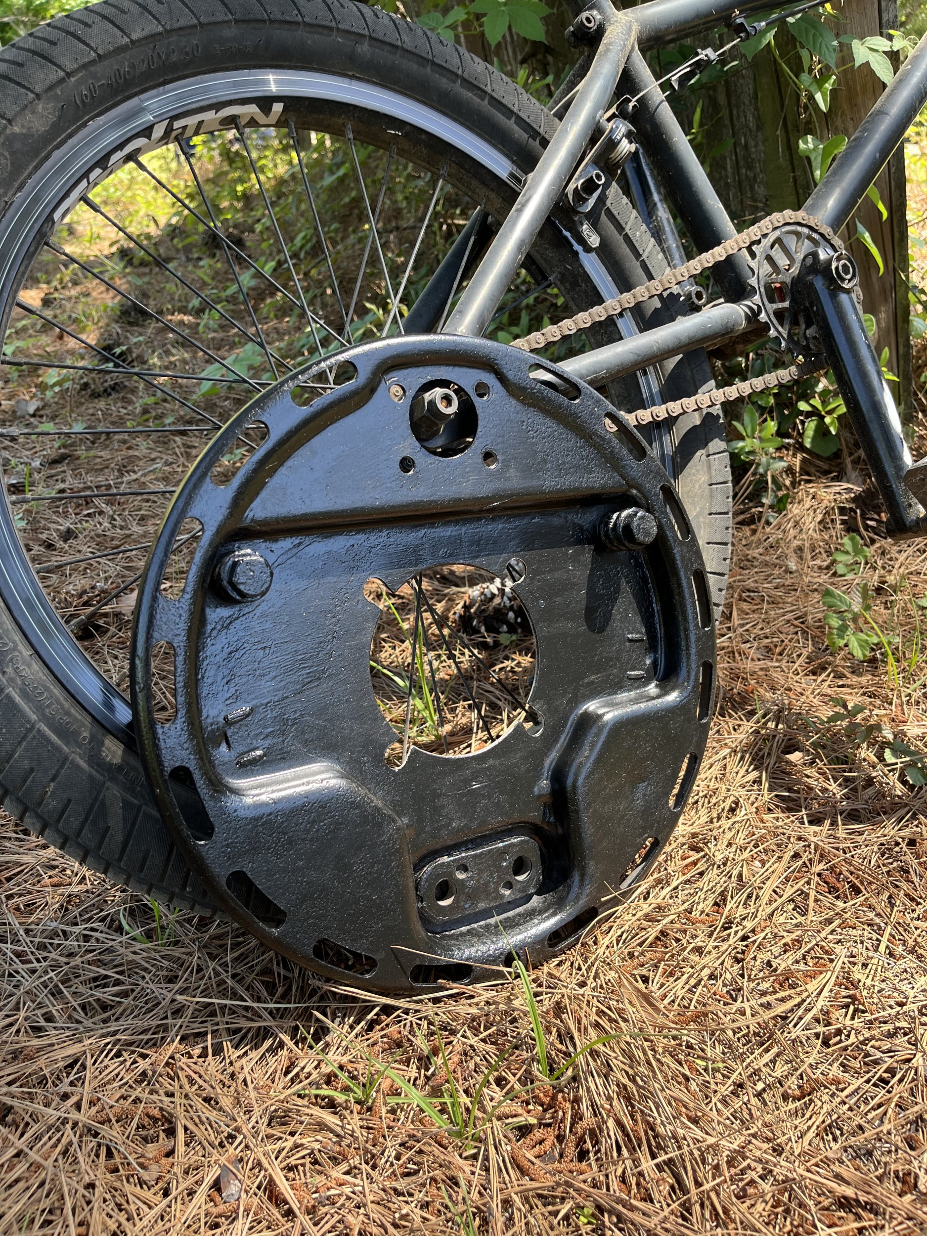

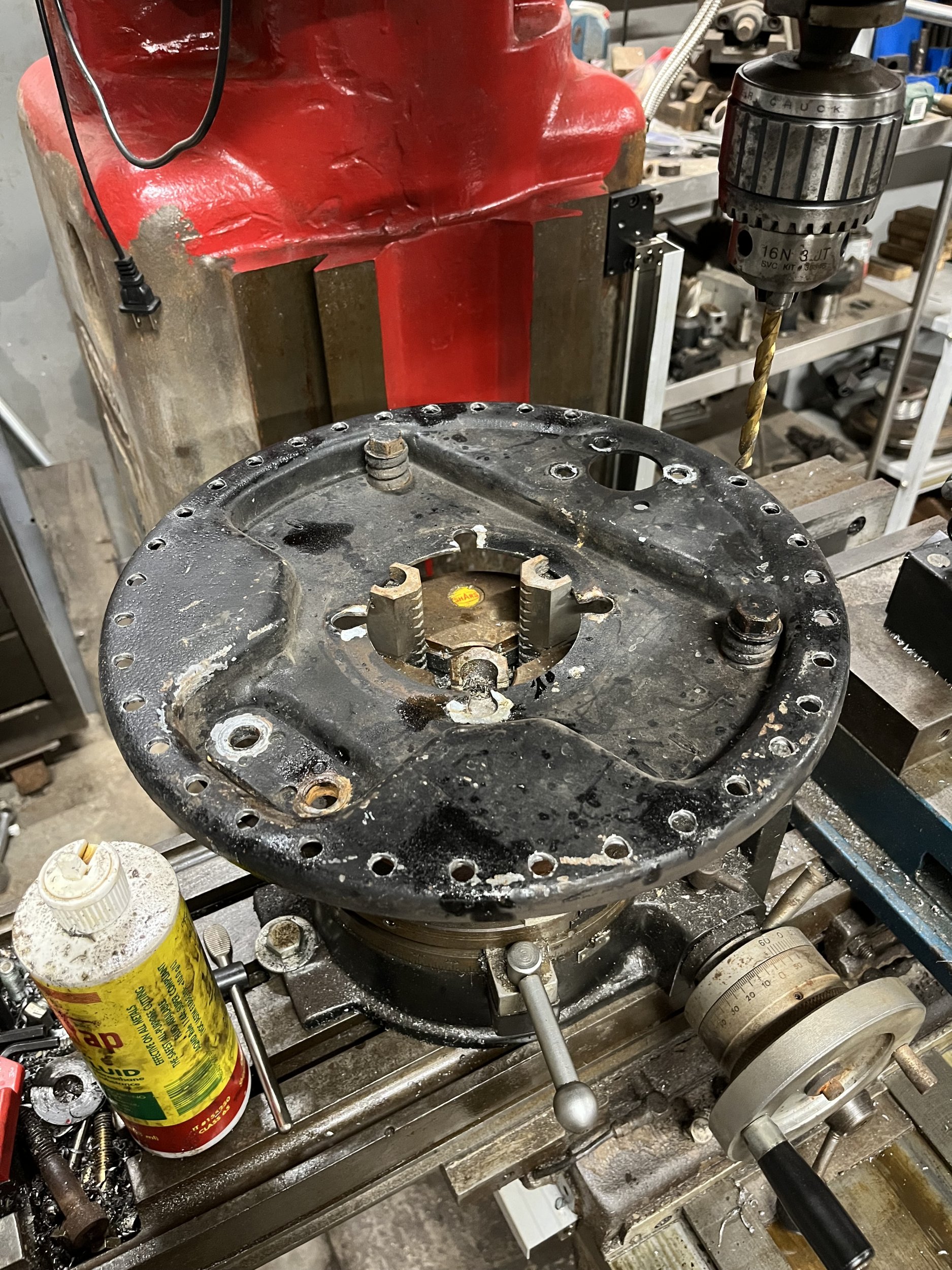

    It took me more time to set up my rotary table and tram in the 3 jaw than it did to drill the holes. Ill use an actual end mill next time for a nicer hole but Im happy. I might not be done with the backing plates just yet, Ive got an idea Im kicking around… IMG_6840.jpeg IMG_6841.jpeg

    I had a better idea this morning. In an effort to clean up some of those wonky holes I decided to re-drill the backing plates, this time with an end-mill like I should have from the start, but I wanted to take full advantage of the rotary table since I had it all set up. Slots it is! IMG_6844.jpeg IMG_6847.jpeg IMG_6848.jpeg

    For those that have owned panheads that sure looks like a linkert carb backing plate lol.

    I had to google it and holy***** youre right. I will never not see it now :D

    Ive been doing a lot of boring non-picture-worthy work on the car this past week, but I did get my backing plates painted.
