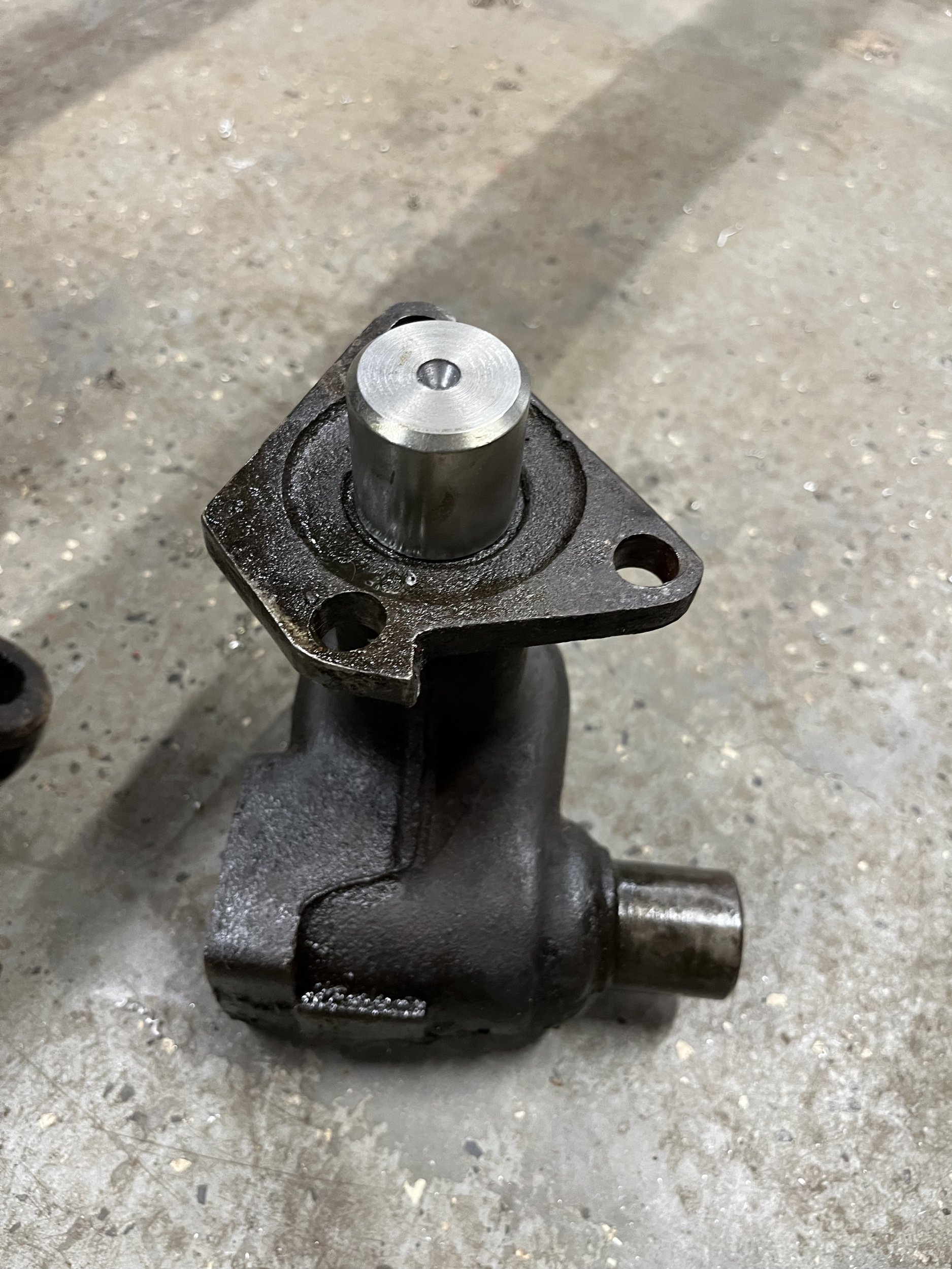

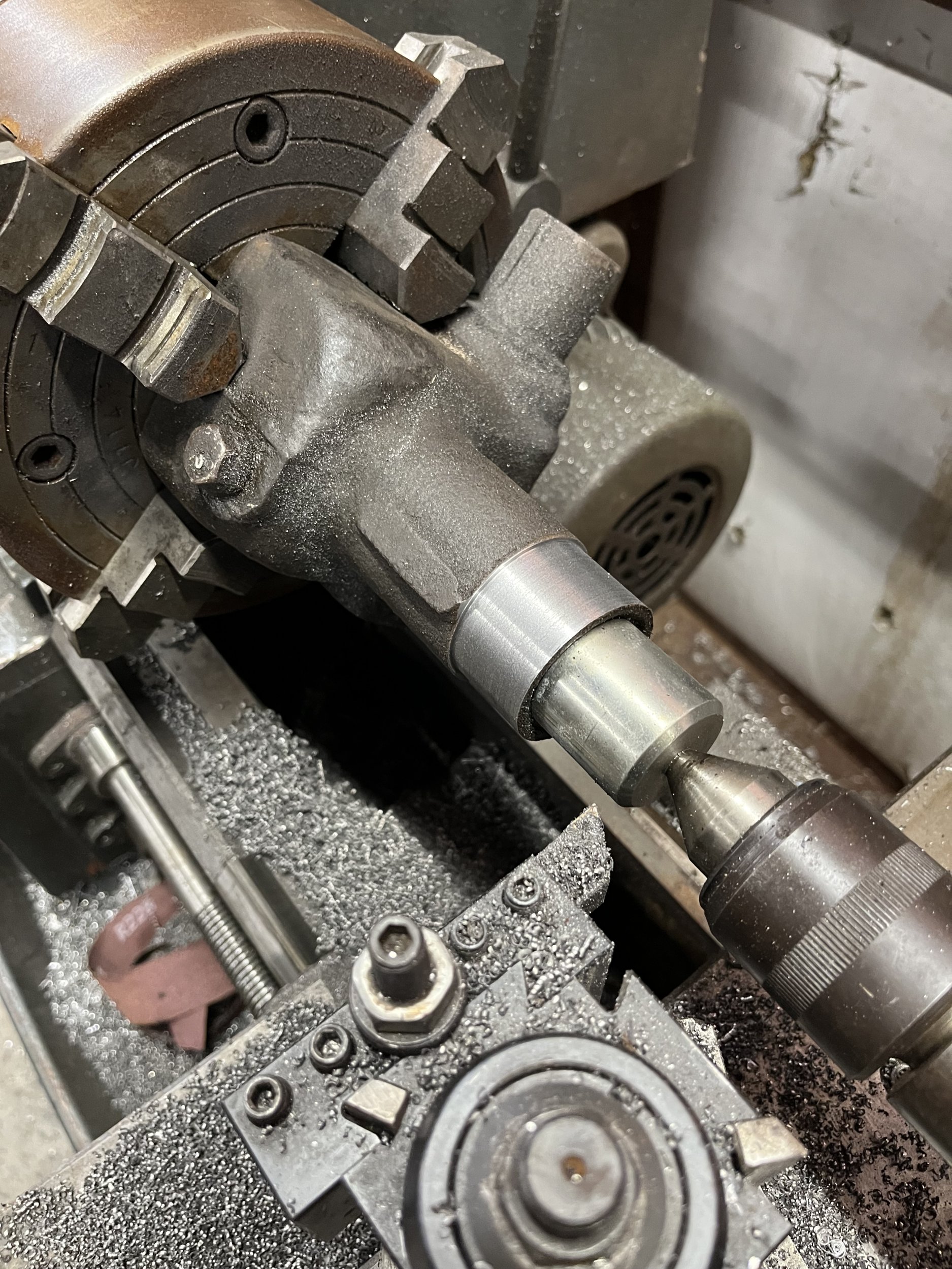

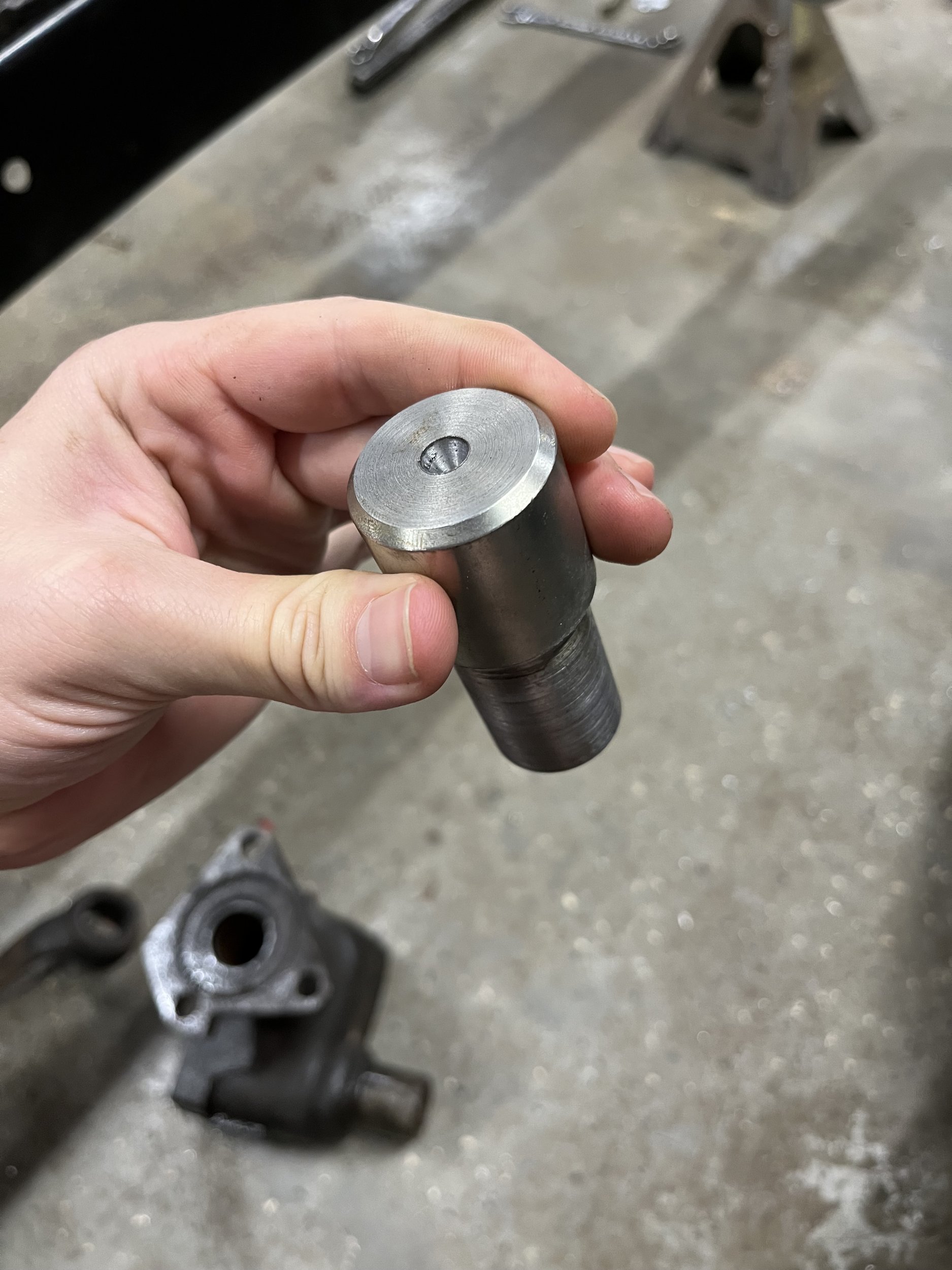

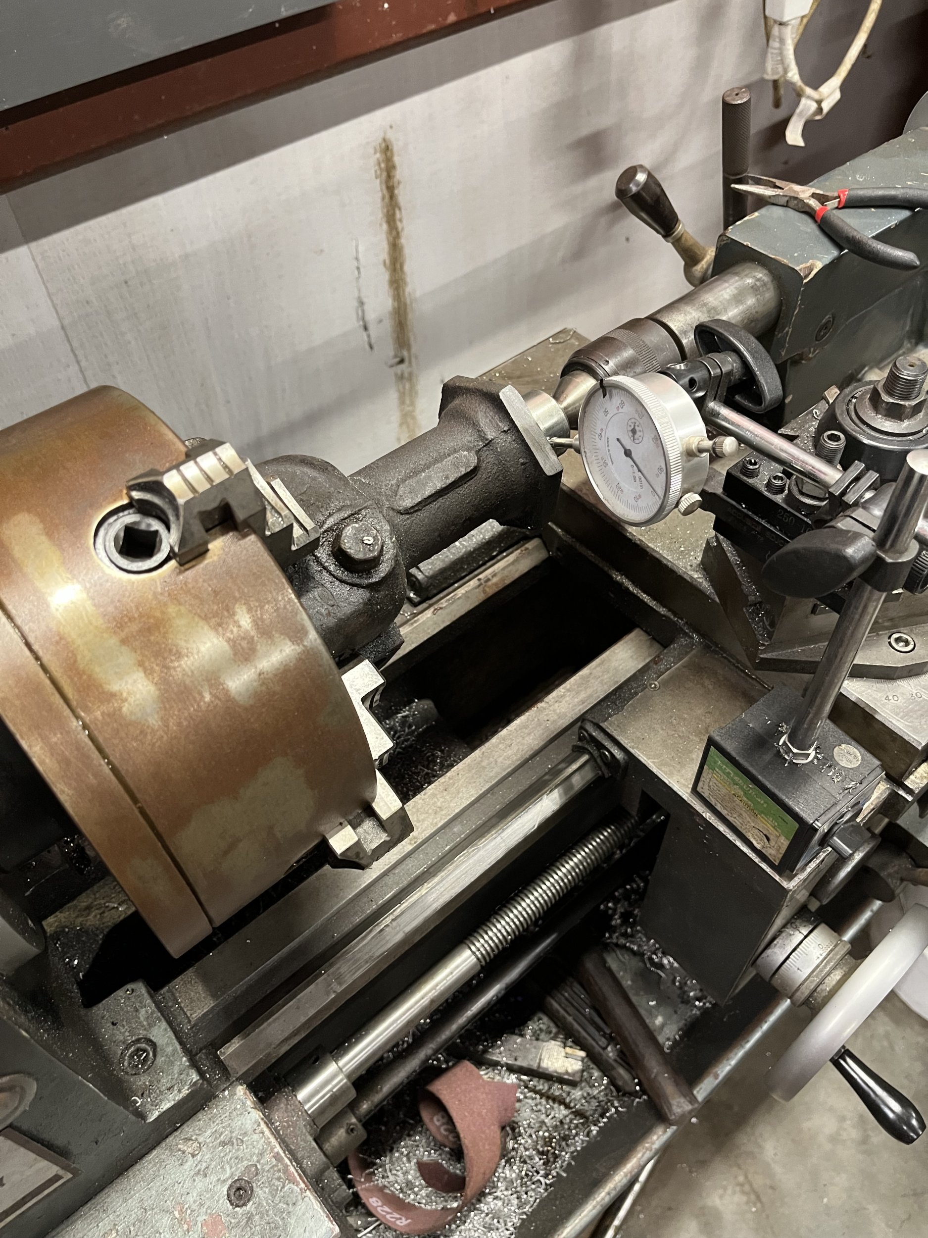

    Finally got some time to spend in the shop tonight. I got started on my steering box. First I made an insert that allows me to use my live center to support the box.
    Swapped over to the 4-jaw chuck and got everything indicated and tight. You can tell we dont use the 4-jaw much by all the surface rust…
    Progress has been slow because I only get a couple hours a week to work on this car anymore but Im slowly chipping away. My goal is to have it ready for the 2026 Hotrod Showdown in 8-ish months

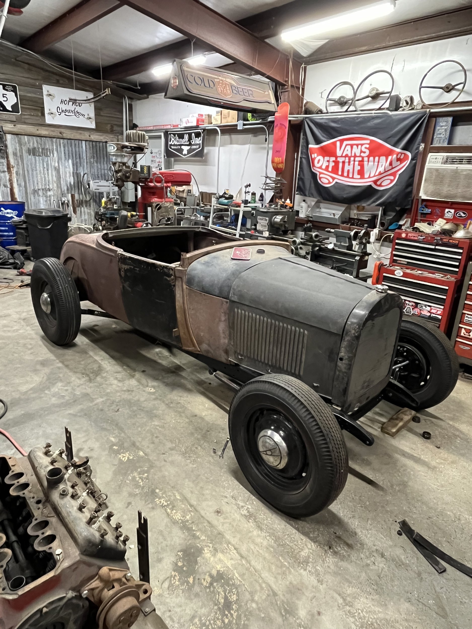

    With some help from a few friends, the body is now back on the frame! MAN this thing is looking so good. The more I look, the more my to-do list grows but I am beyond stoked to see the car in (mostly) one piece.

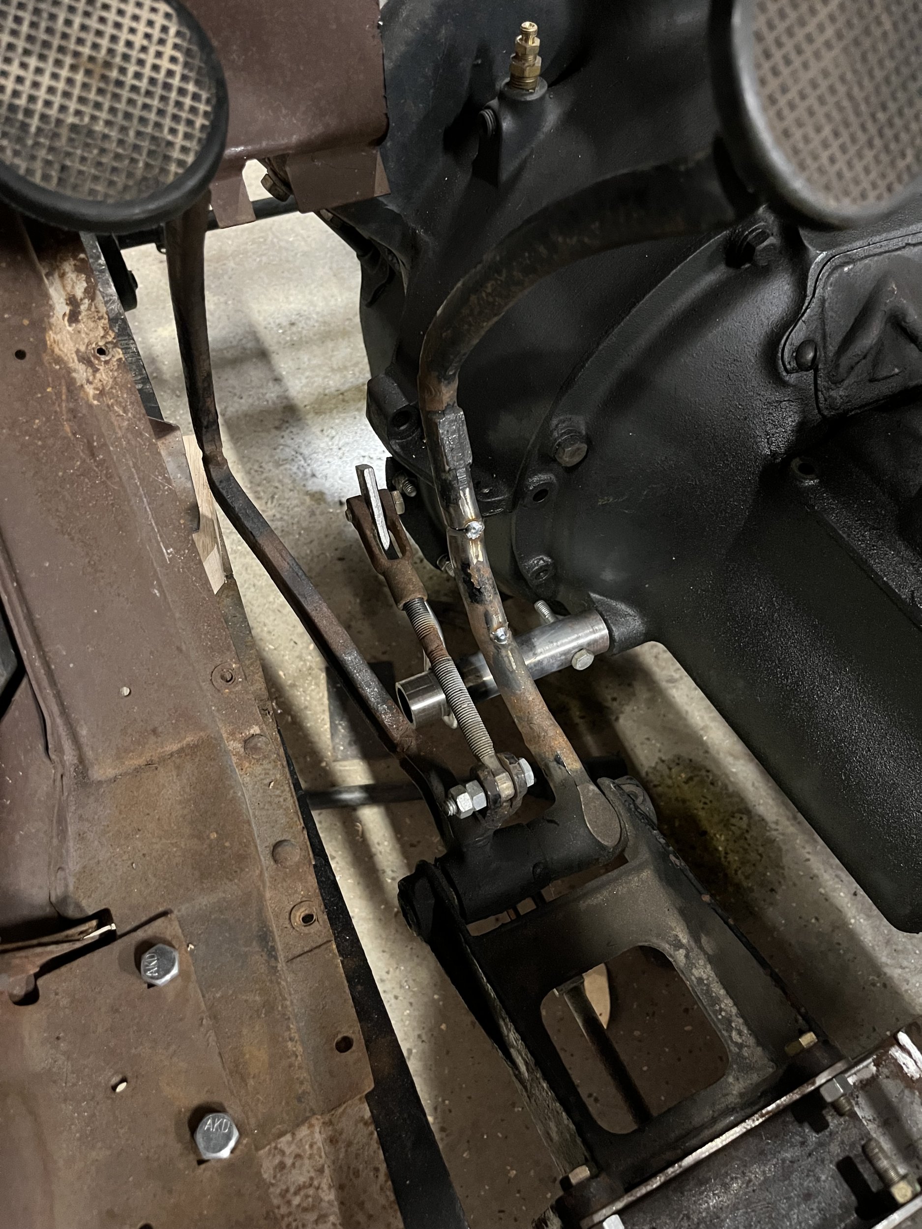

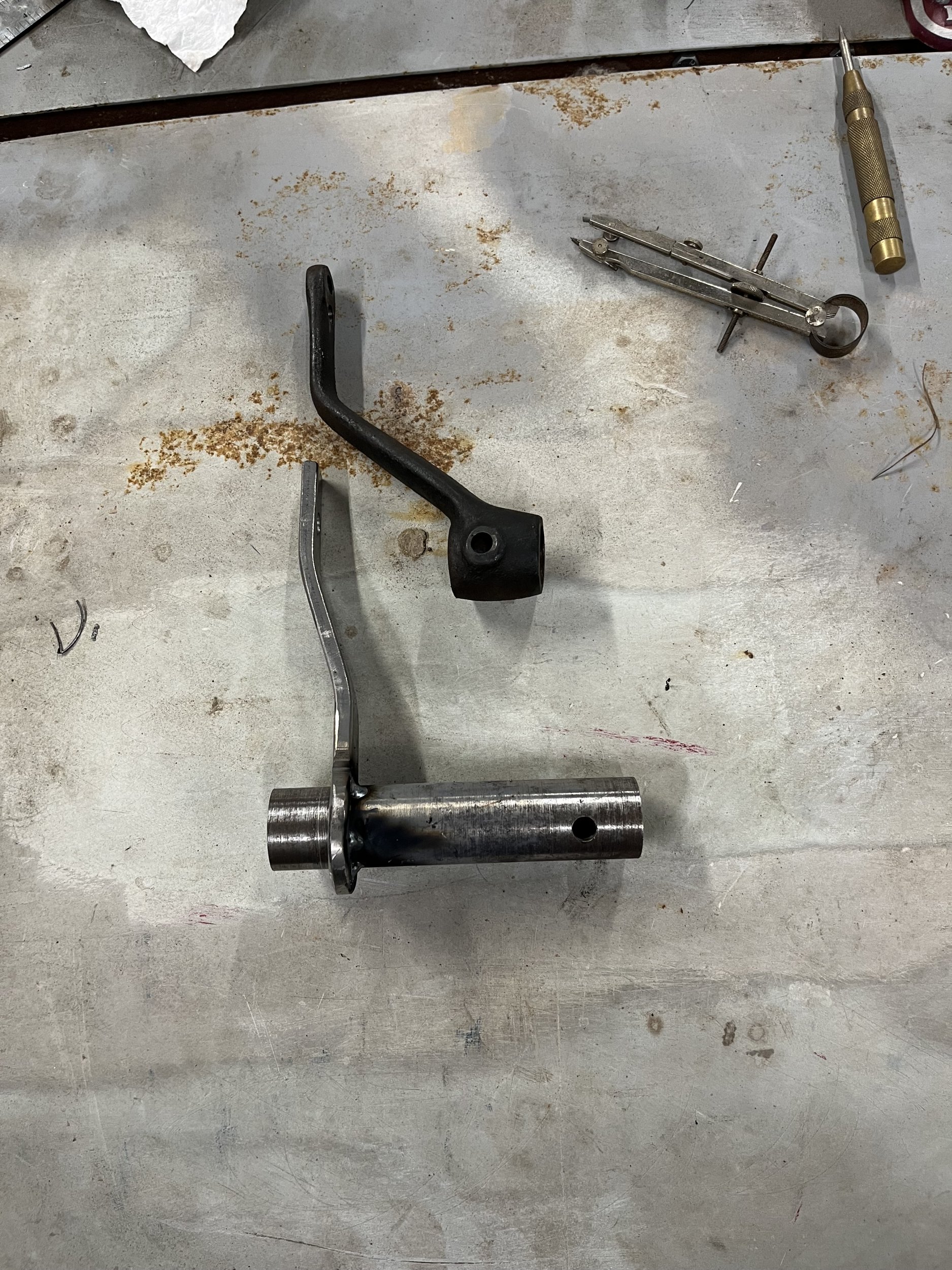

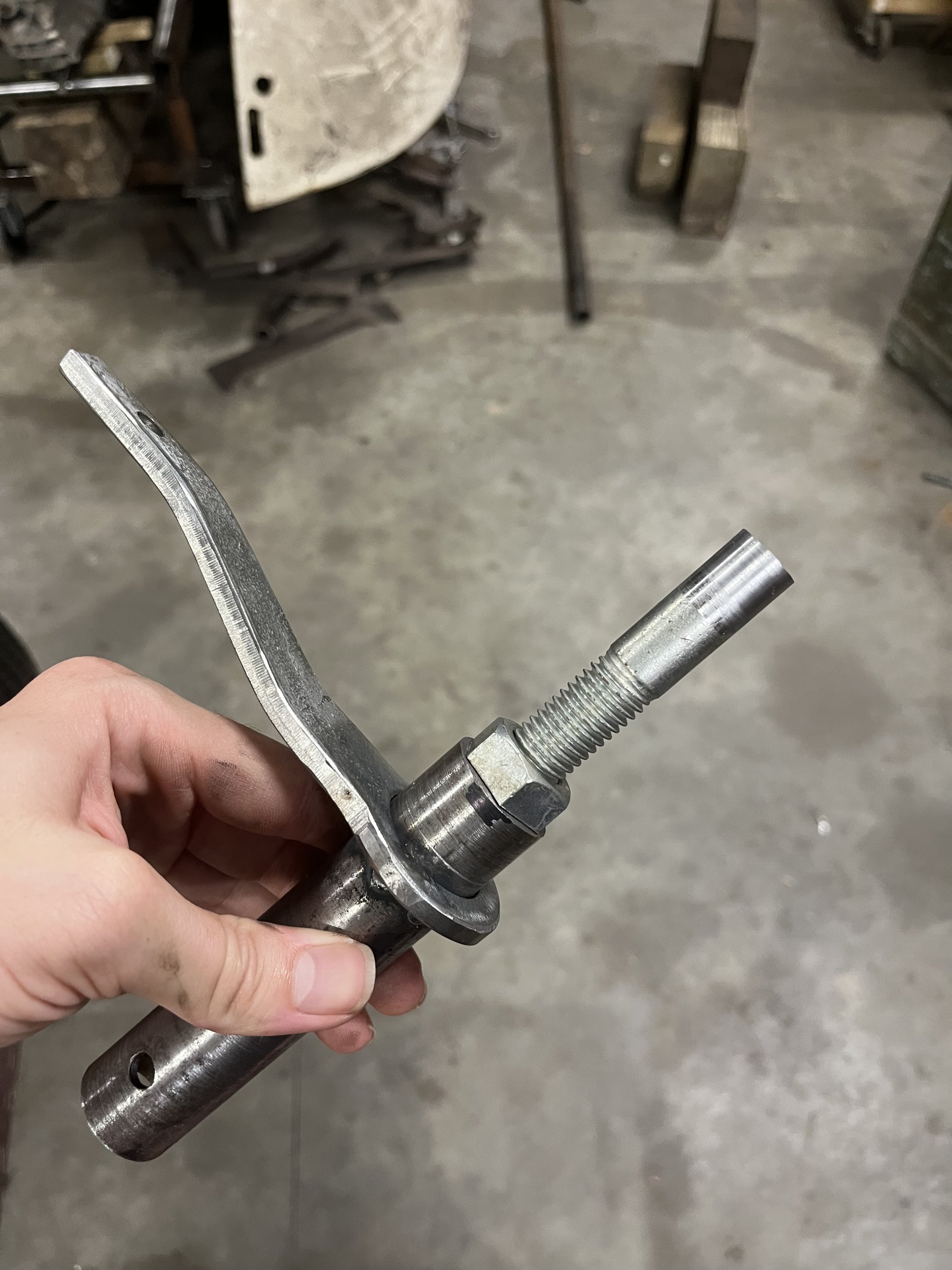

    I jumped the gun on my pedals. I was hoping I could just line them up where they were in my T and call it a day but the model A body is wider and I could really tell how far off they were once we set the body on. I cut the tack welds and slid the pedals over and began on the next hurdle.
    The clutch-throwout-arm whatchamacallit had to be re-done.
    Yet another part to bring to the neighbors to tig weld. I left it open ended (literally) because I may end up extending it over to the frame rail for support if I find it’s too flimsy feeling.

    Yeah I'm starting to lean towards that now. I'm thinking even if it works fine now, it may give me trouble in the future after a few thousand clutch actions... I've got a pretty cool idea on how Ill extend it

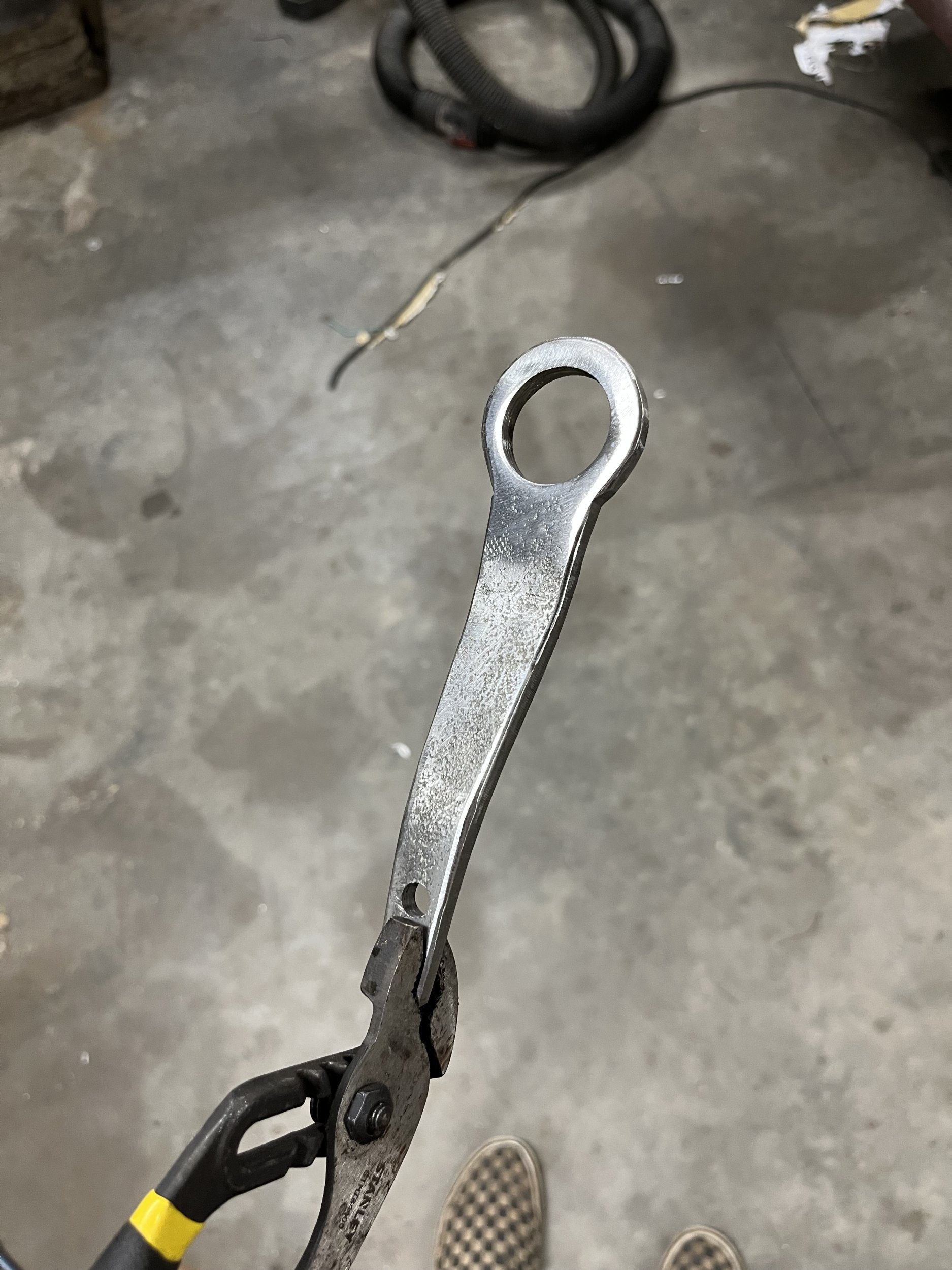

    Ive never claimed to do things the simple way, I AM an engineer after all :p

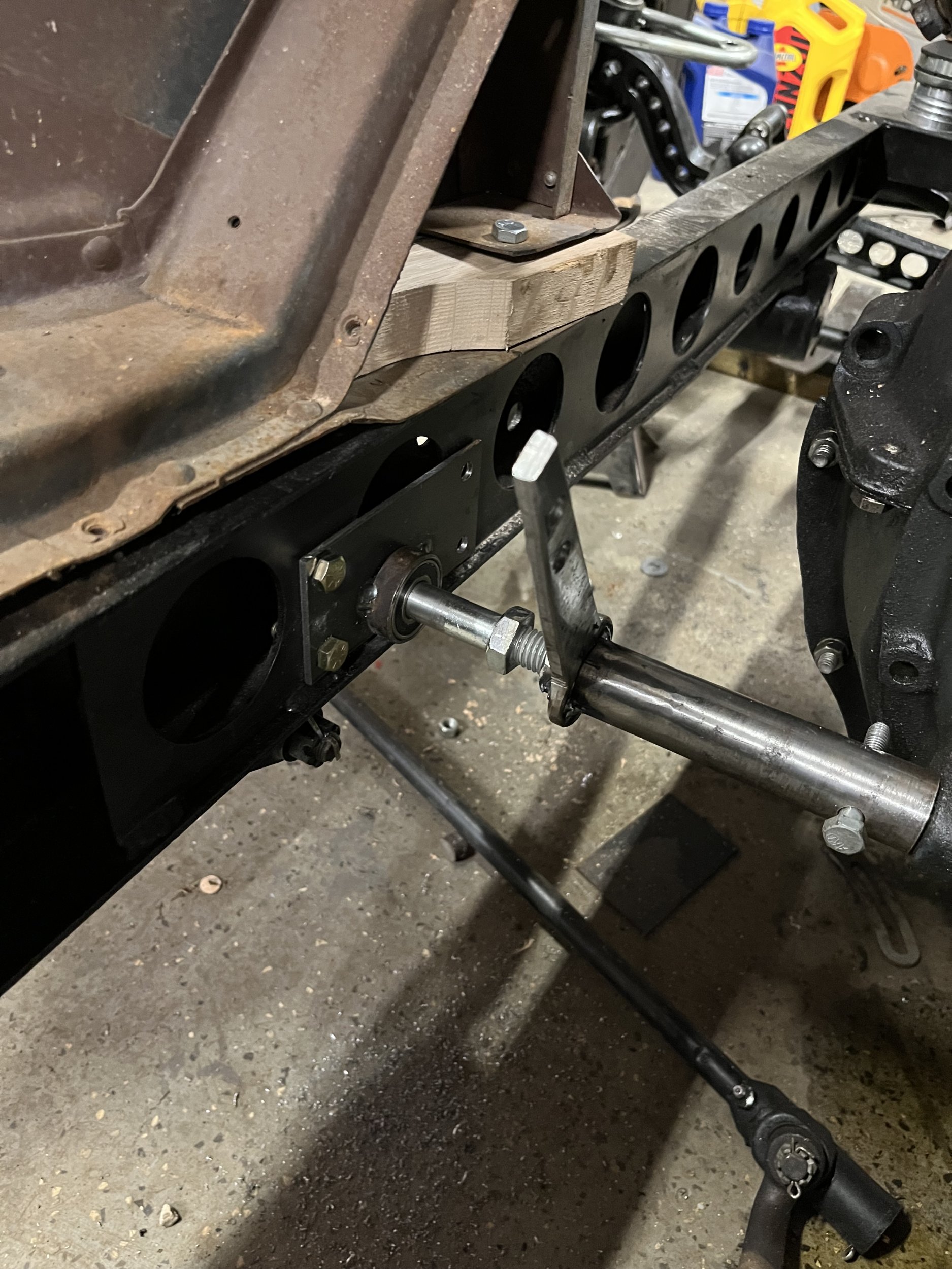

    Clutch linkage finally put together and it seems to work. It kicked my ****. I think I remade it 3 times trying to get it right.

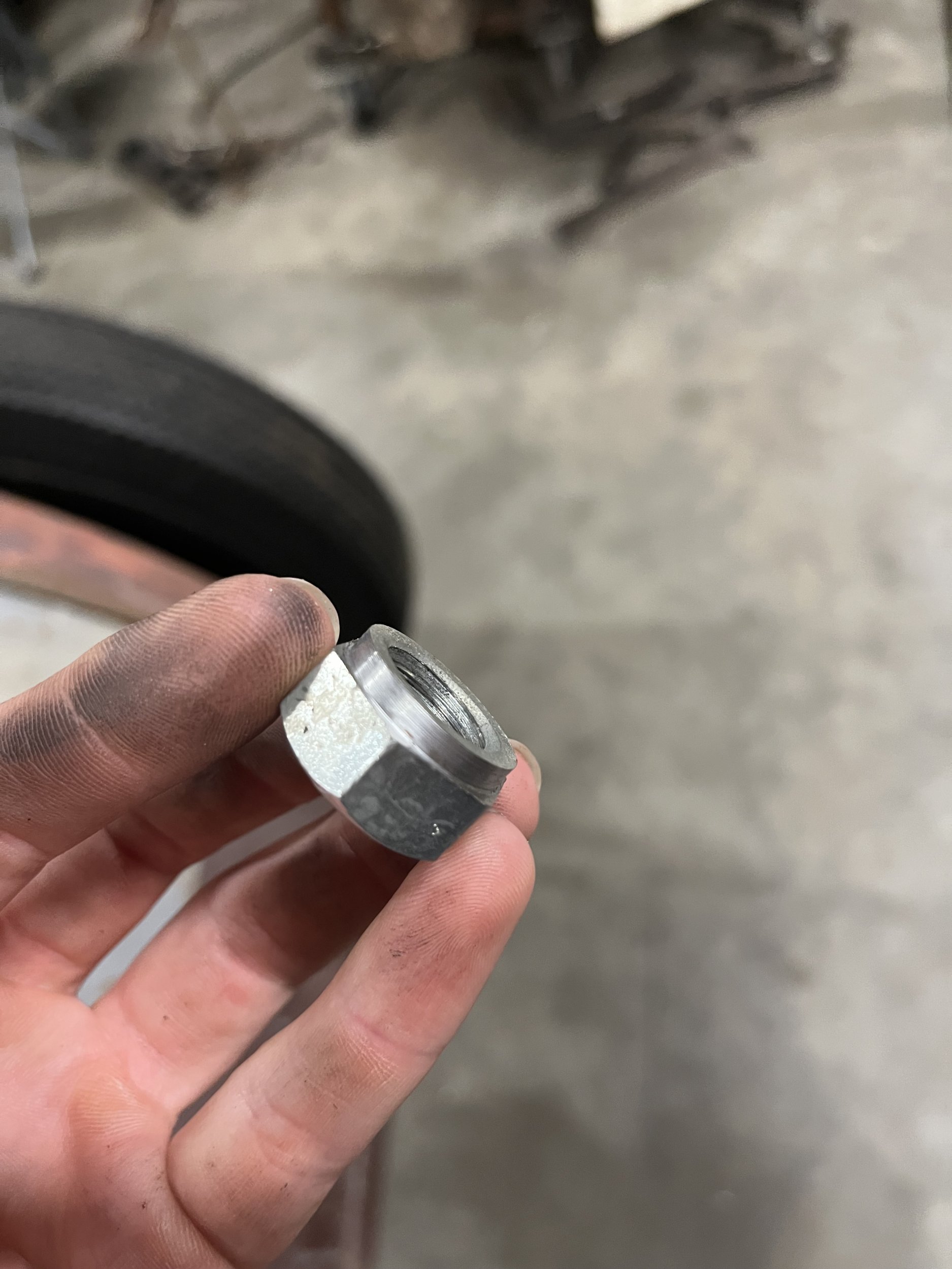

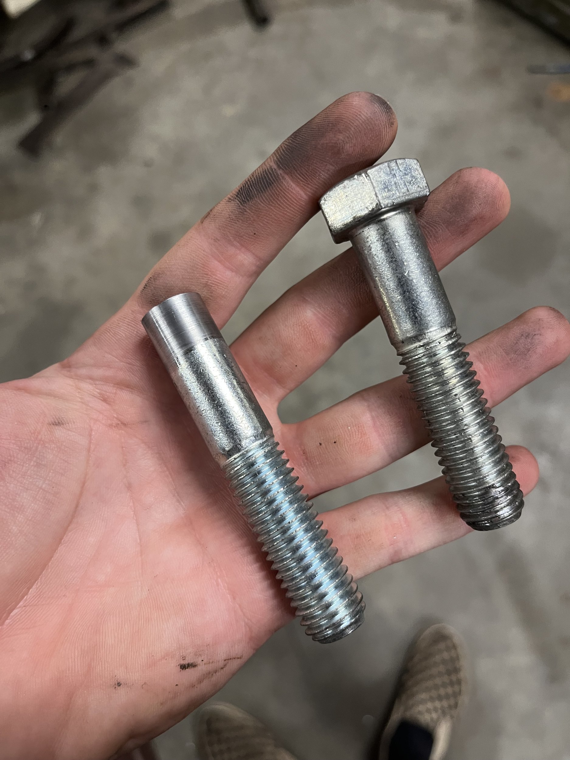

    I decided to extend the clutch arm over to the frame for extra support, but I wanted to make it easy to dis***emble. I started by turning down the end of a big bolt and nut to fit into the end of the shaft I made.
    Next I made a plate with a piece of tubing welded to it and a bearing pressed into the tube. I’ll end up slotting the holes on the plate eventually, that way as the engine goes in and out I can set it perfect each time to prevent binding.
    Like I said, some things I do are convoluted ;)

    hope i'm not niggling,but that doesn't look grade . 8 ...

    In that application it doesn't have to be.

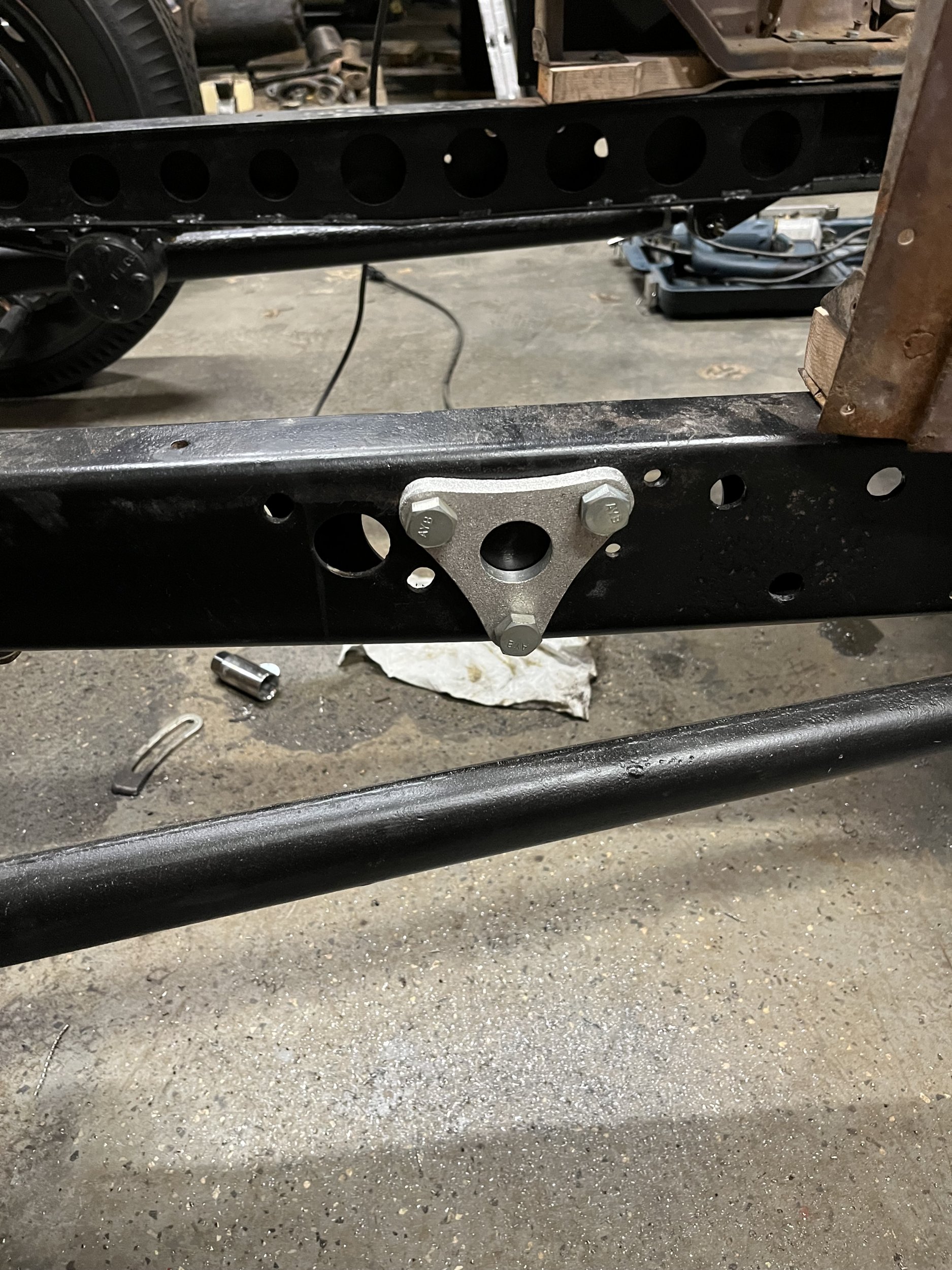

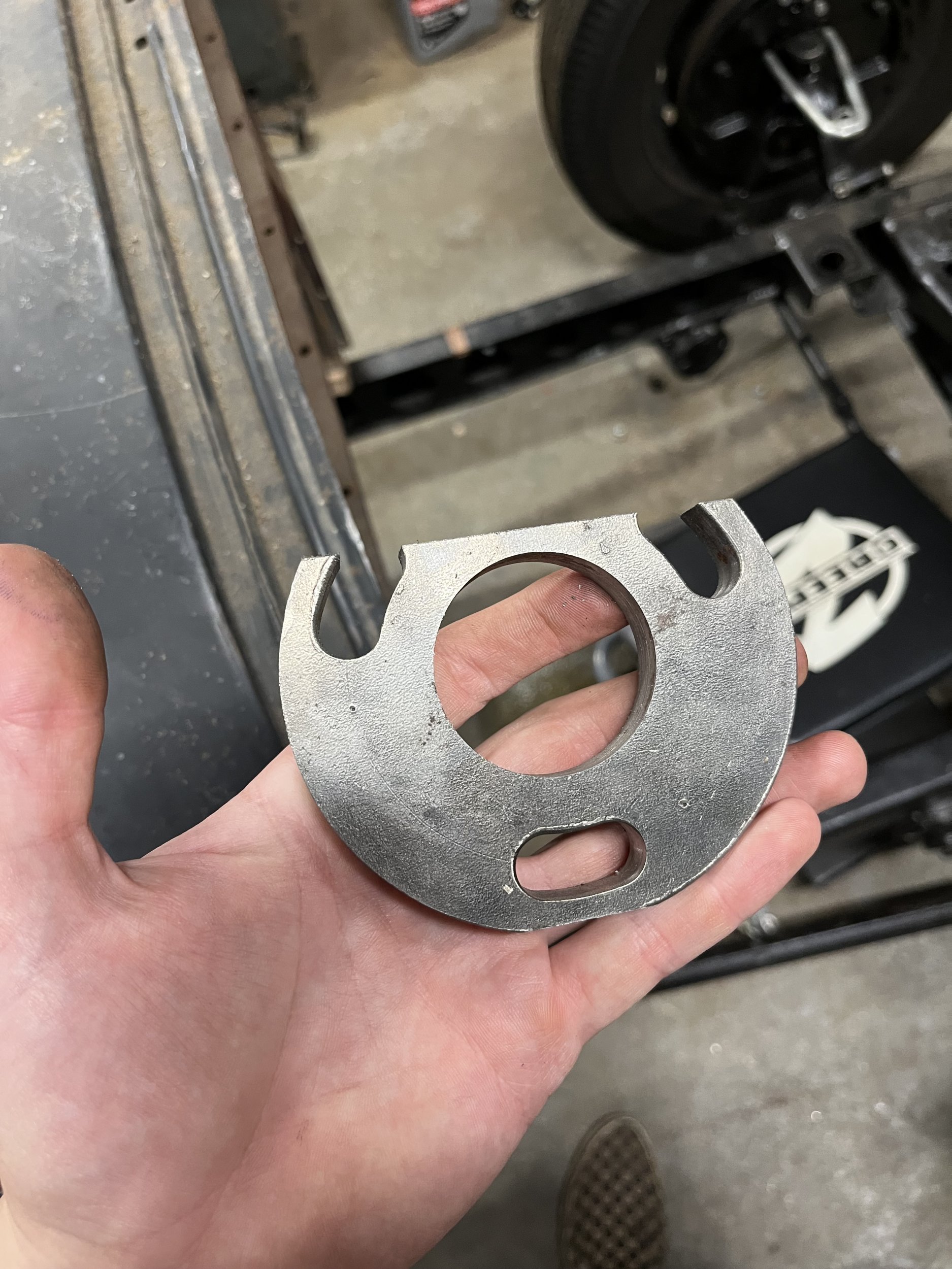

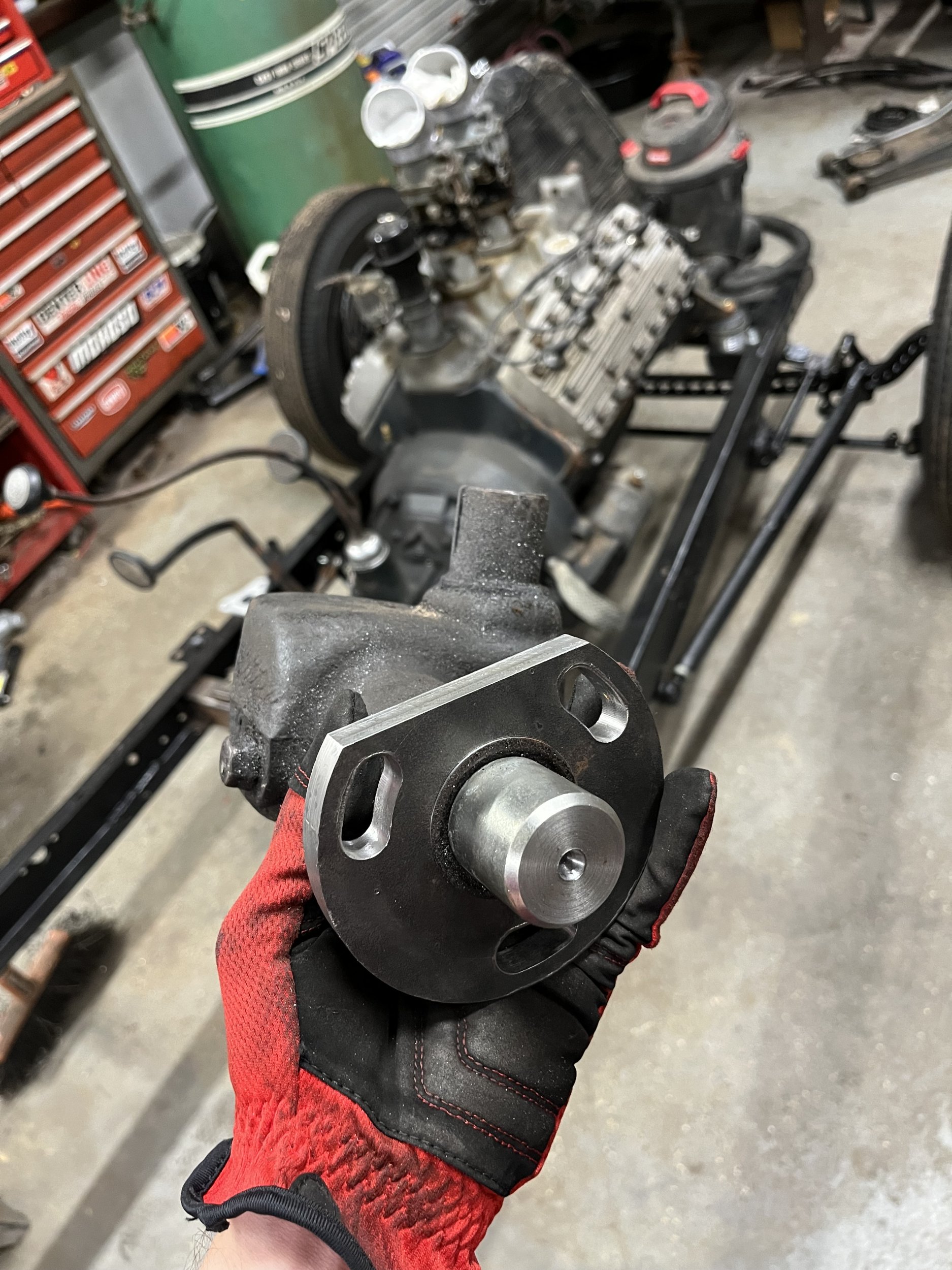

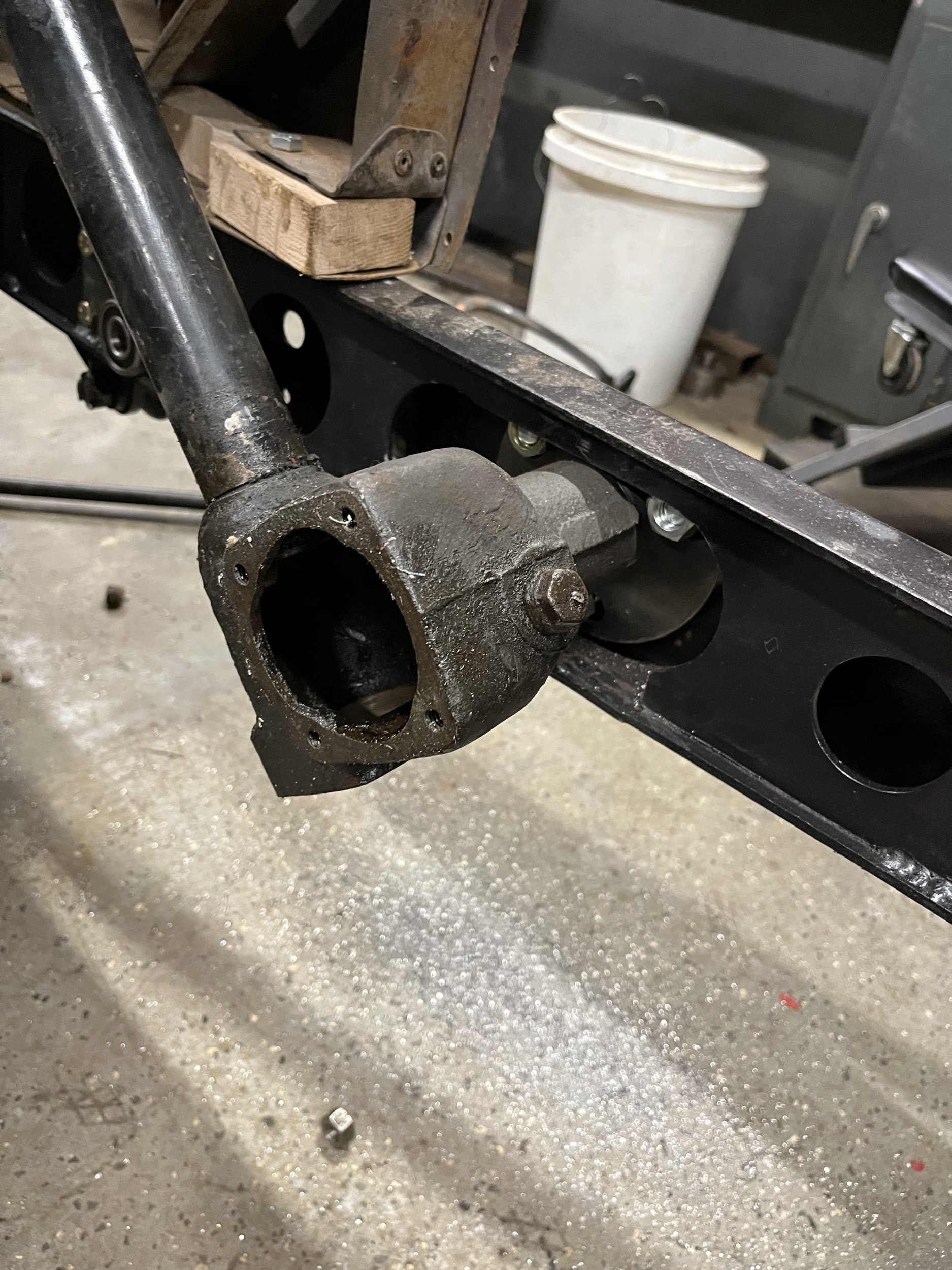

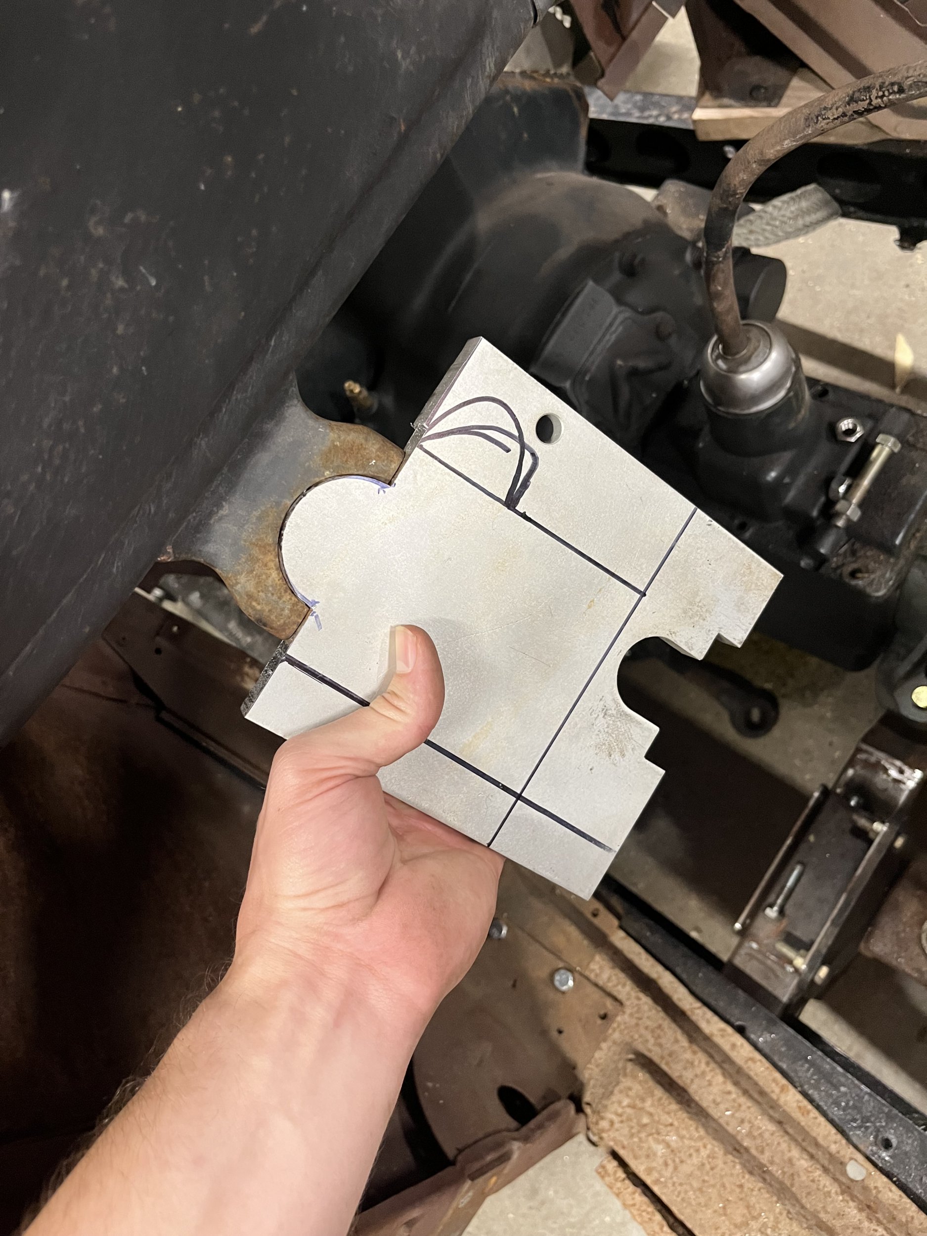

    Time to get the steering finished. I debated whether ide share my big mess up or if Ide brush it under the rug but I ill come clean.. when I designed my steering box flanges, I never had the thought that maybe the hole in the frame wouldn't be perfectly centered. I just ***umed it would be but after laying it out I quickly realized the hole needed to be slightly higher than center making my box flange way too tall… With the amount of time I put into these pieces, I really didnt want to start all over again so I had the idea to give the flange a serious hair cut.
    It looks pretty silly now but its still gonna work fine. Theres plenty of material left for the bolts to bite into and Im using washers so Im not worried. Learned my lesson to make the next ones about 1/2” smaller diameter.
    Jacksmith, Outback and Mikko_ like this.
  16. Texas36
    Joined: Oct 20, 2012
    Posts: 504
    Texas36
    After my screw up and salvage effort I got the hole drilled and the box mocked up where it needs to be.
    The slotted holes work as intended so even after welding, ill still have adjustability if something needs to be tweaked. Im happy!

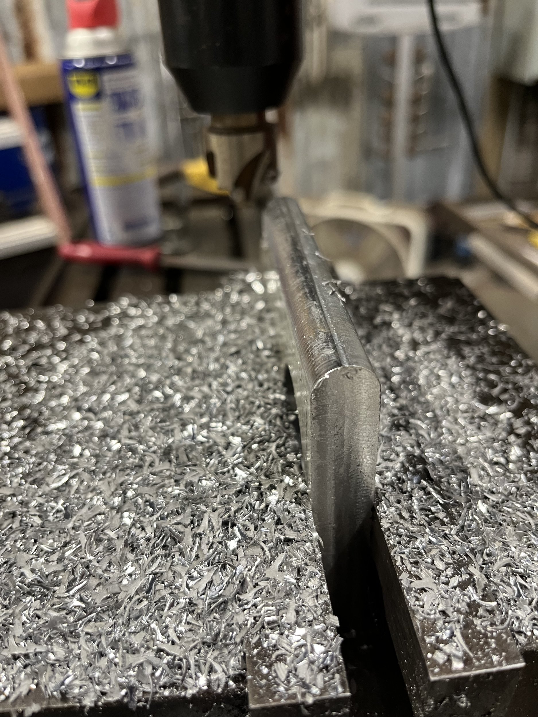

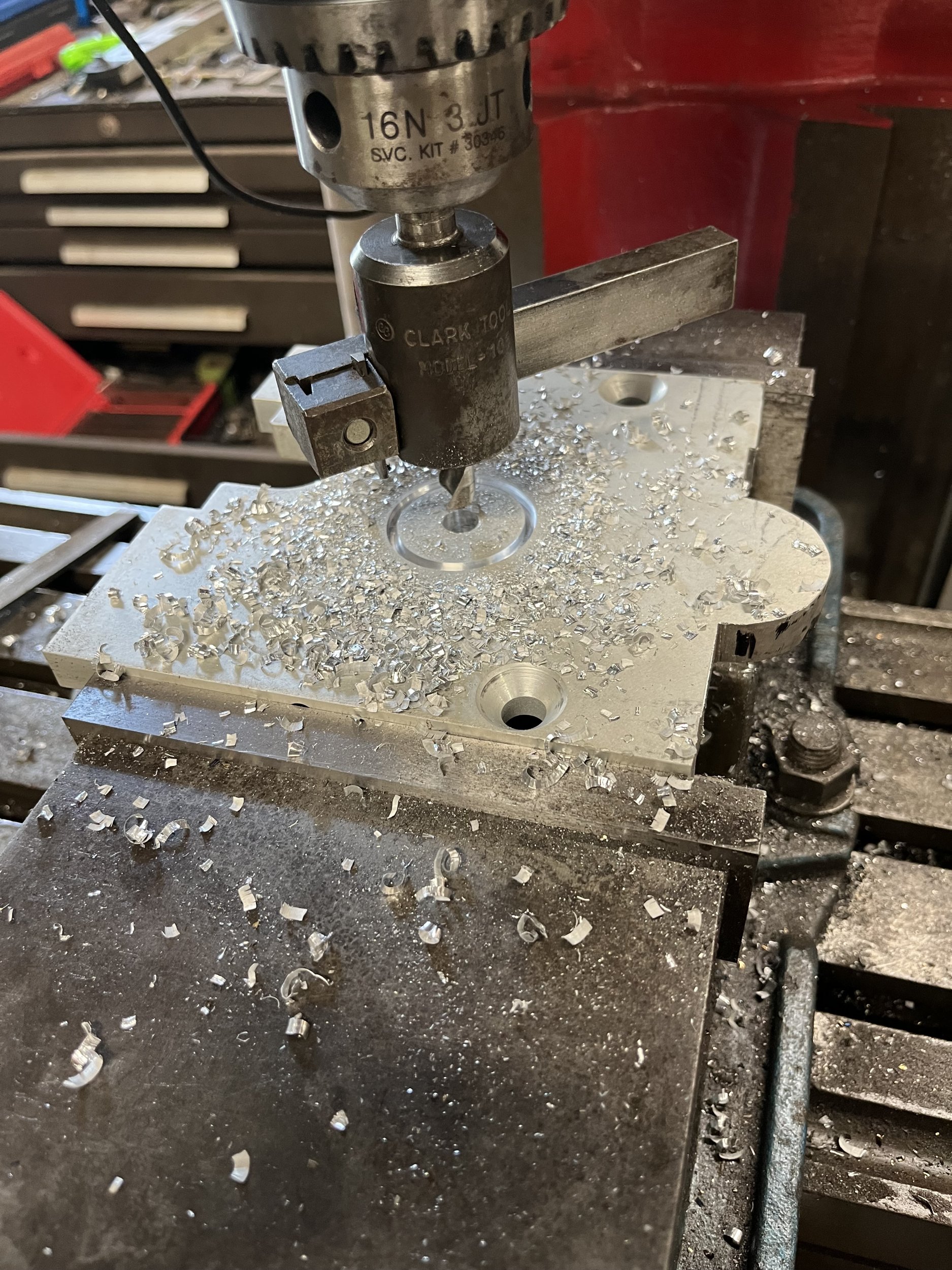

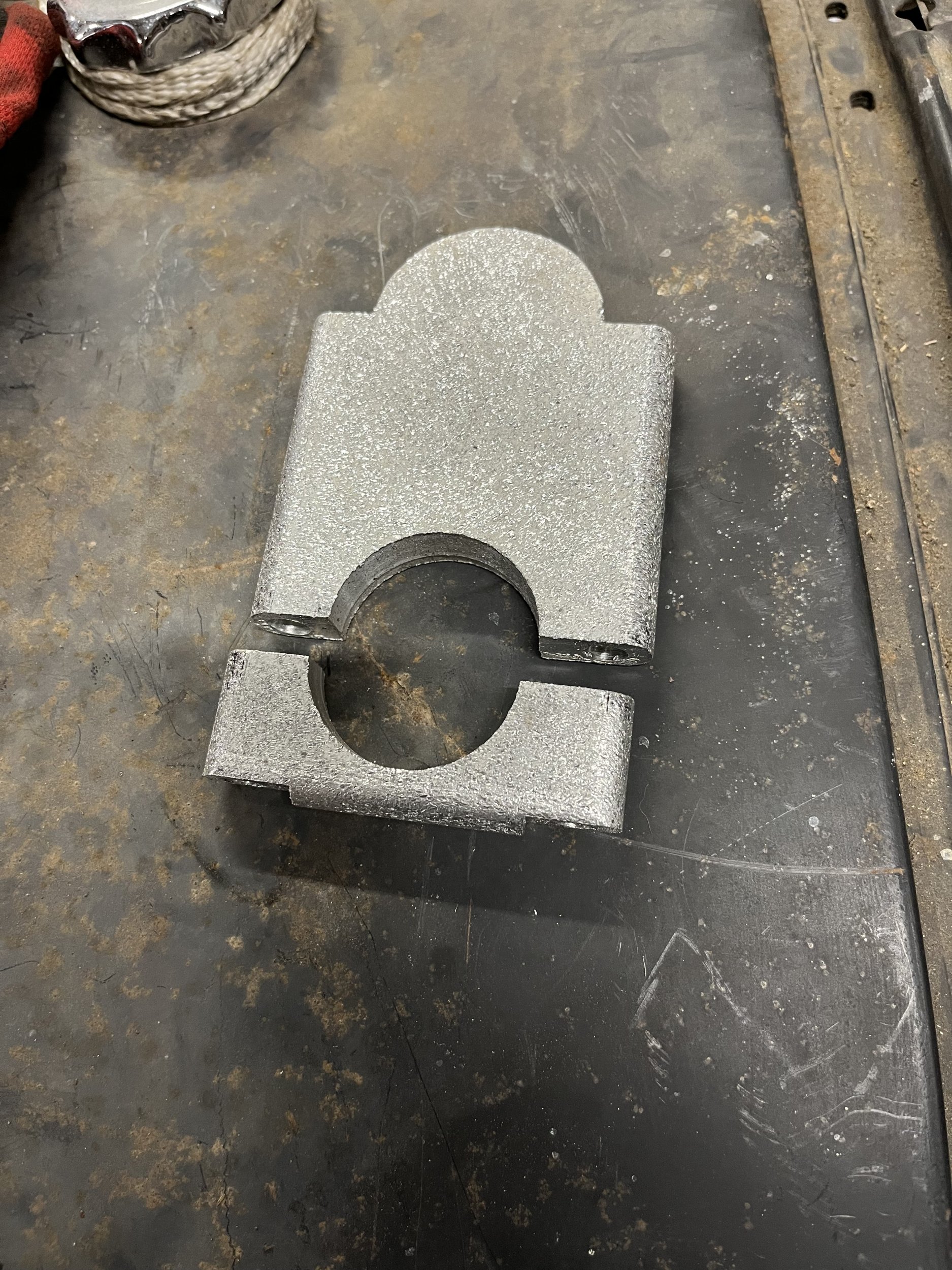

    Before I tack my steering box flange onto the box, I wanted to make my column drop to hold it in place exactly where it needs to be.
    I’ve got tons and tons of 1/2” aluminum plating laying around which worked perfectly for this.
    I gave it the needle gun treatment to look cast. Not sure if I like the squared off look of the clamping piece or not so I may round it but I think it’s gonna work!

    I'm not familiar with the "needle gun treatment", but I dig the result! That column drop is perfection!!

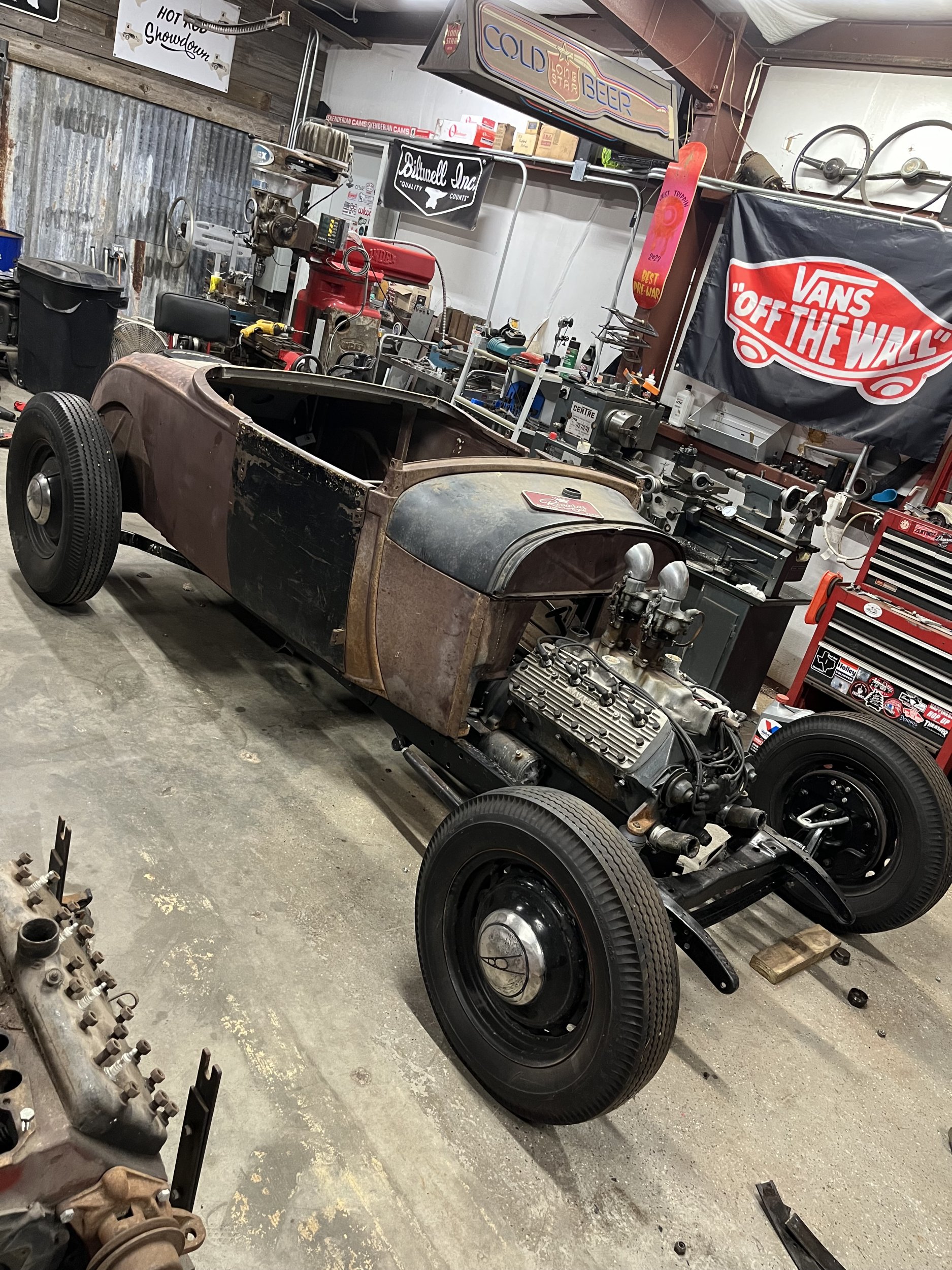

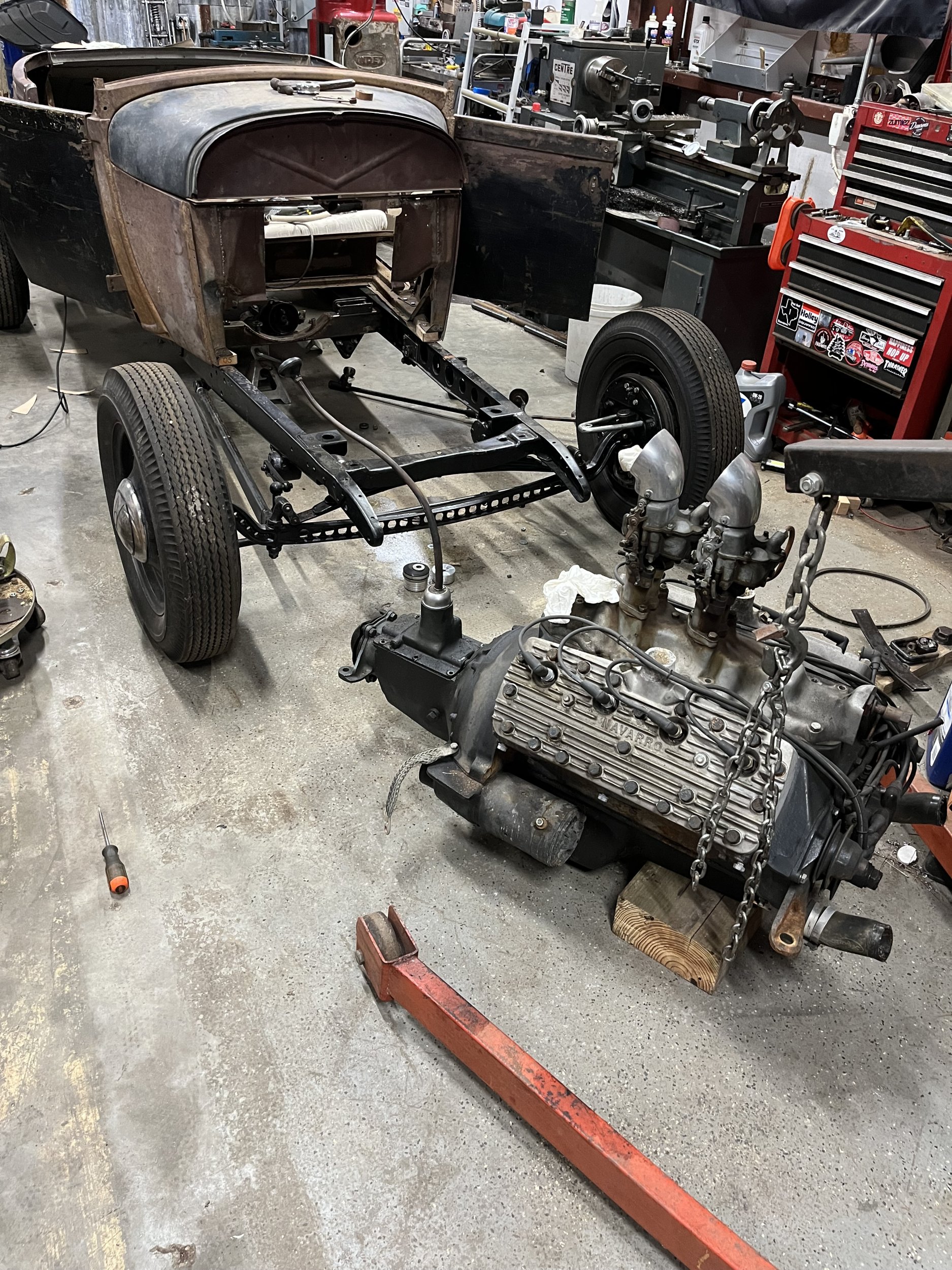

    Wow! 3 months since I posted. Ive been working away each week on the car. Mainly on small tedious things that don’t warrant a post but I have done a few things worth posting.
    I pulled the engine out so I could finish the firewall and transmission crossmember, but while the engine was out I decided the flywheel needed a resurfacing and fresh pilot bearing.
    I dont recommend using a mill for this job BTW LOL took a few carbides to finally get a good surface.
    Next was the firewall. In hindsight I should have never cut this firewall to begin with, but originally I was going OHV and needed all the room I could get. I decided to stick with the plan and finish it the way I intended.
    Sort of hard to see what I did in this pic but thats kind of a good thing.. Im not a sheet metal guy but with the firewall good enough for now and the transmission crossmember finished and painted I was able to stick the engine back in for good.

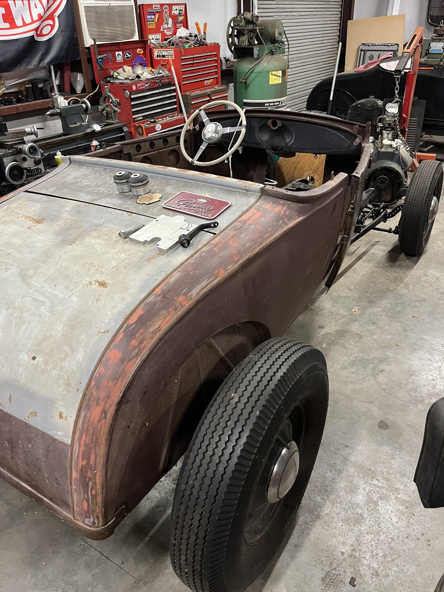

    Texas36
    Thats about where it sits today. My plan was to have it ready for the Hotrod Showdown at the end of February but Im really not confident in that goal. Ide have to cut way too many corners to get it there in a barely driveable car. Not worth it IMO but, nonetheless Ill keep hammering away at it.
