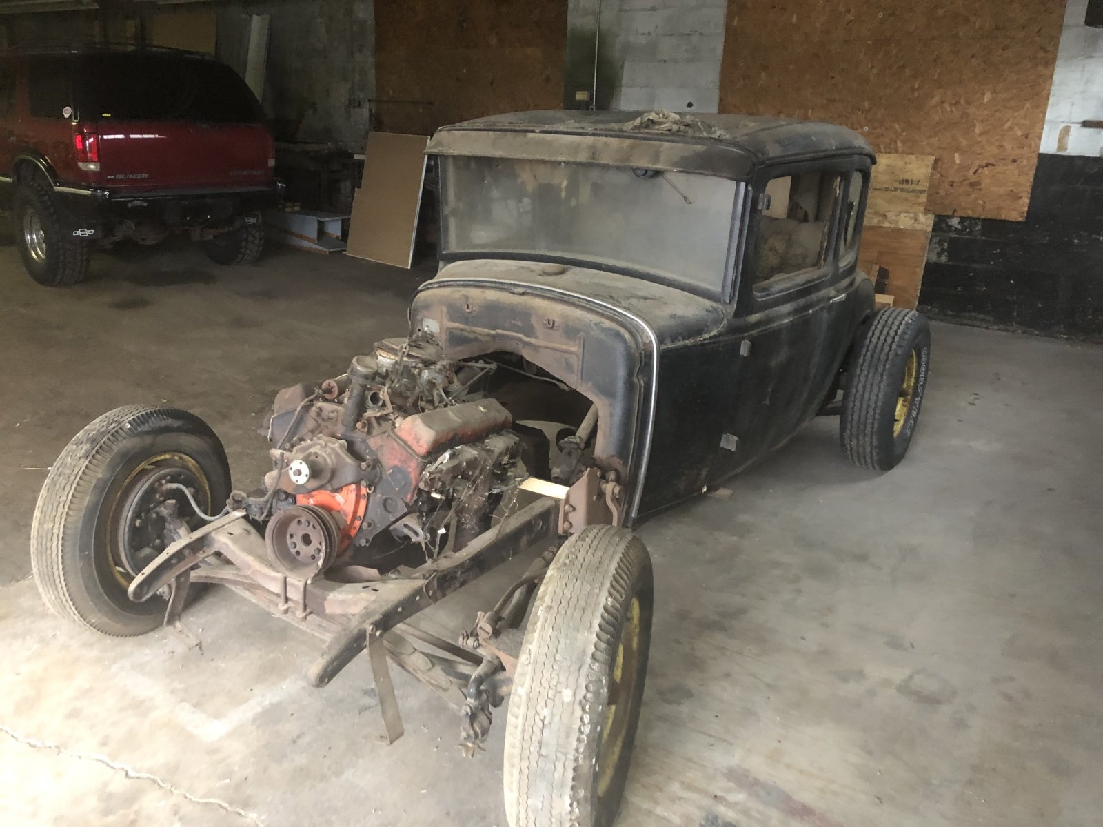

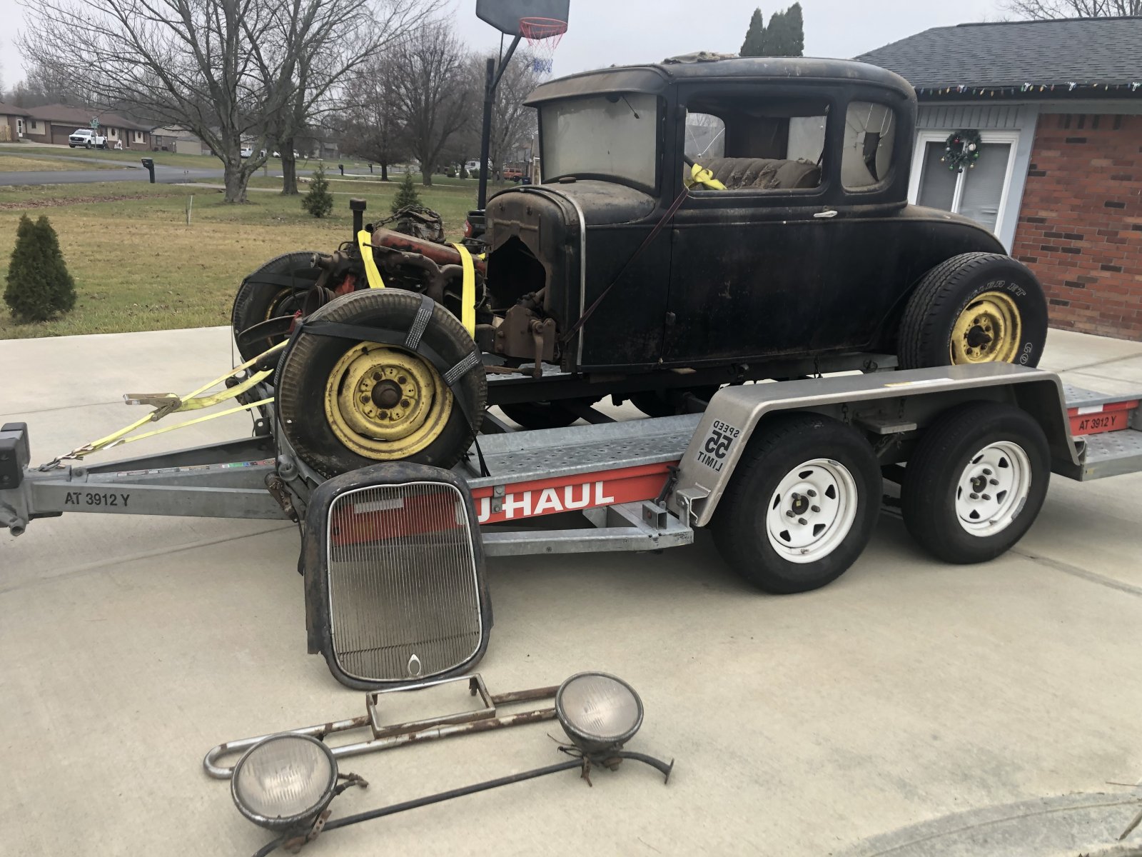

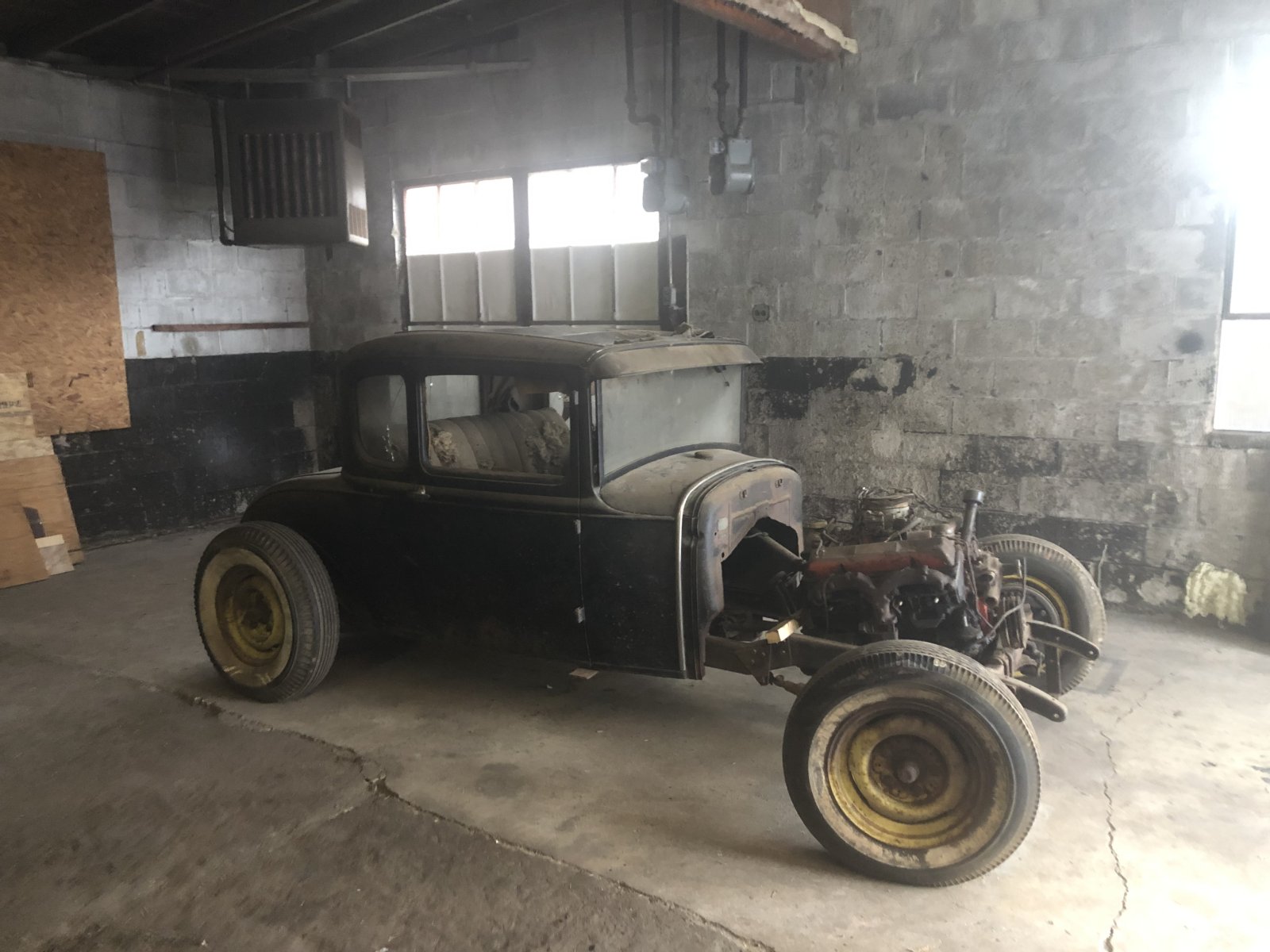

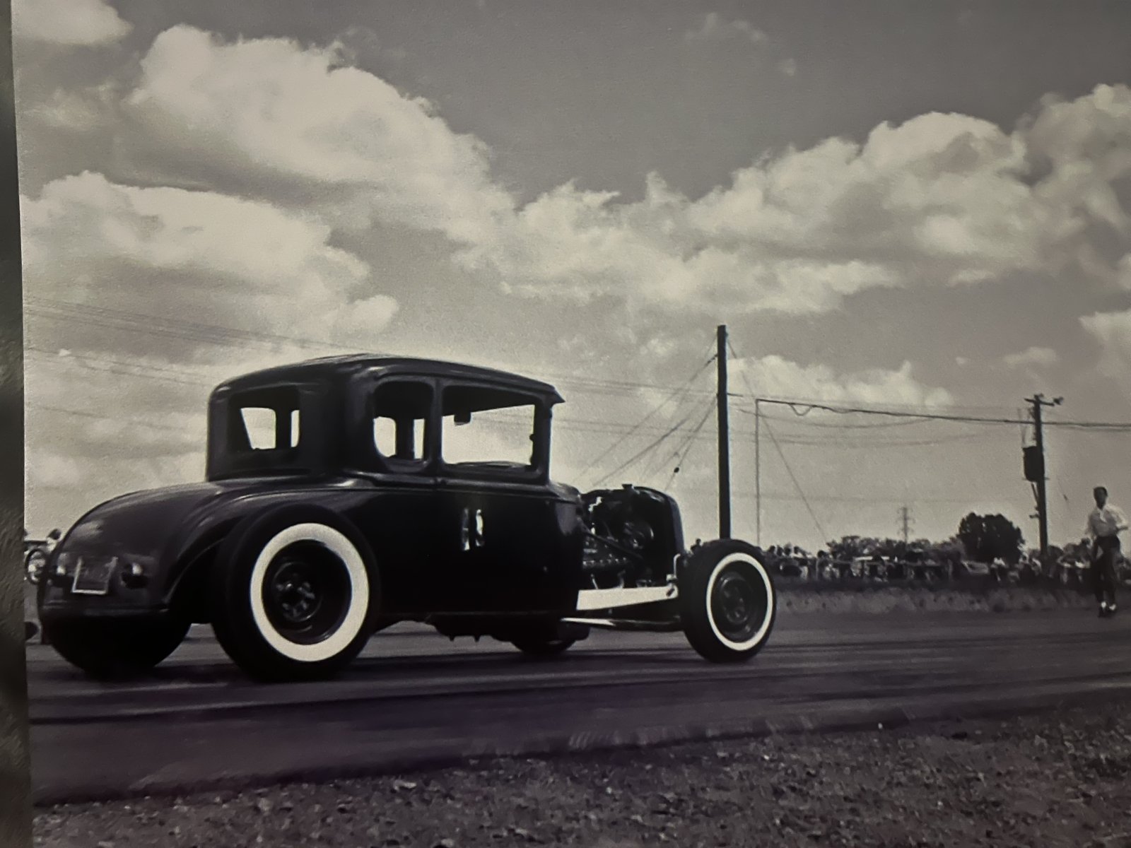

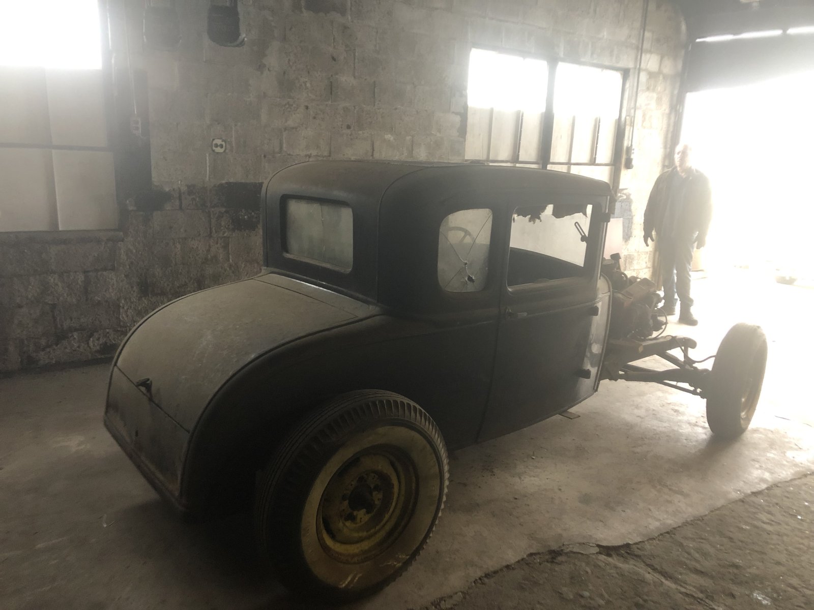

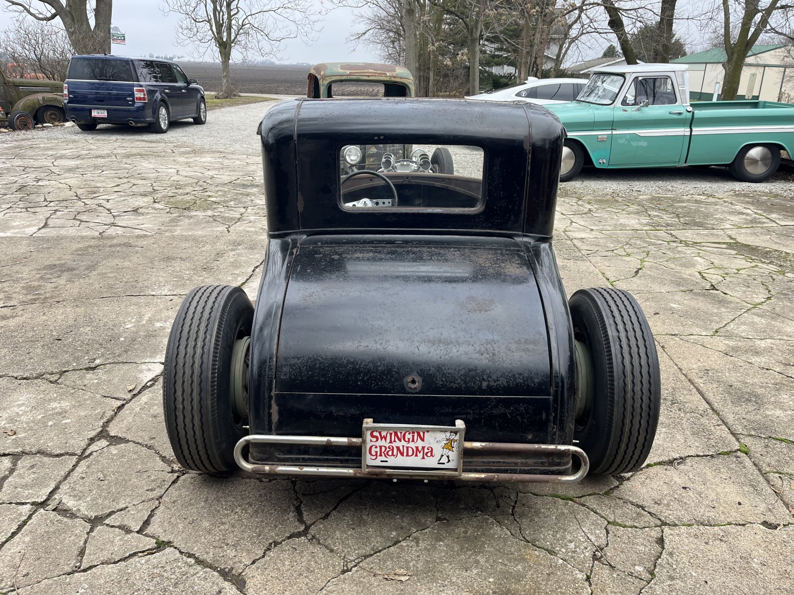

    I got lucky and found an old hot rod hiding in an old defunct Ford dealership in Ohio. The build started in 1955, and tinkering continued until 1962. It never got done.
    But the car is incredible. No rust, no dents, very decent old paint, old chopped and filled 32 grill, and all the right parts (for me anyway) IMG_3899.jpeg IMG_3900.jpeg IMG_3901.jpeg IMG_3915.jpeg IMG_7281.jpeg IMG_0498.jpeg IMG_1586.jpeg IMG_1587.jpeg IMG_1581.jpeg .

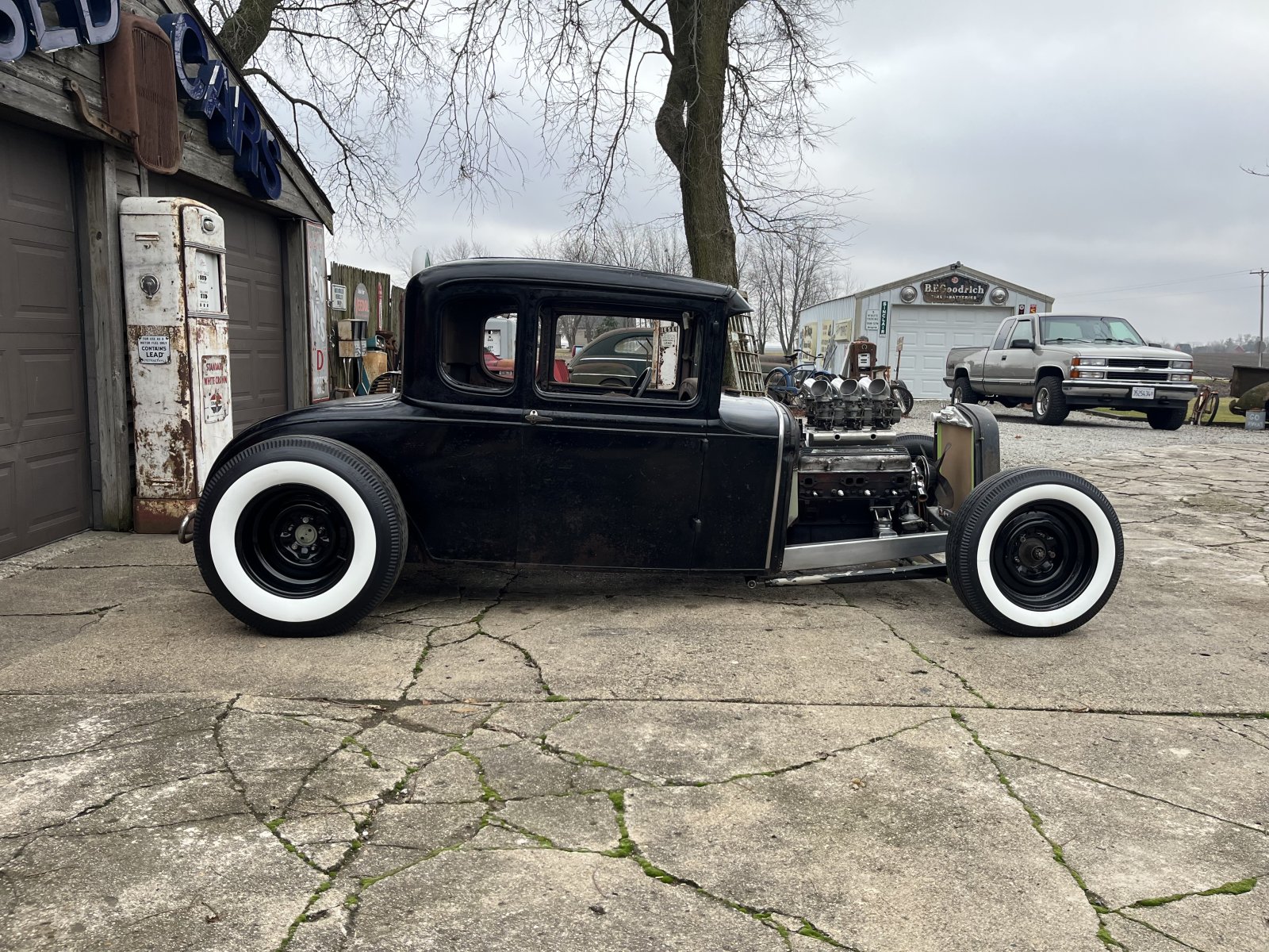

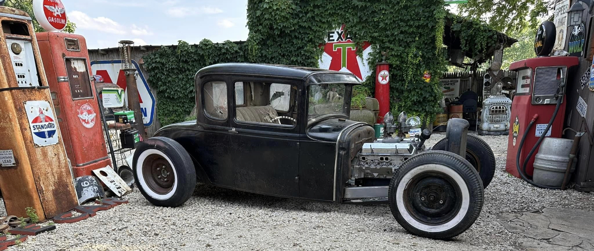

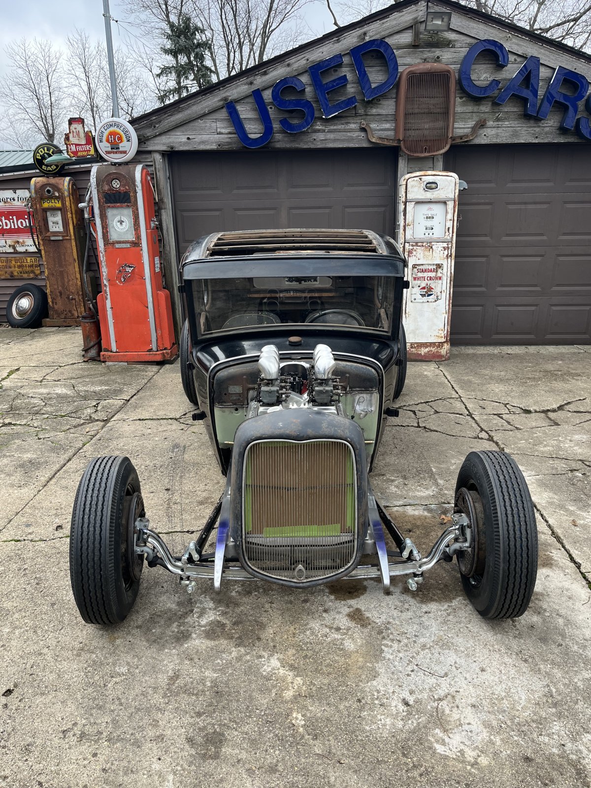

    My buddy, Clay Culbertson in Rantoul, Illinois has taken the lead on breathing life back into it.
    The 50’s ch***is work was a bit sketchy so I cheated with a Boling Brothers 4-10 frame, 57 Ford rearend, and an old chrome MorDrop axle, chrome drilled backing plates on juice brakes, and I’m still DESPERATELY SEARCHING FOR OLD CHROME SPLIT WISHBONES.
    The old SBC that came with it was swapped out for a 327 with an old polished X1 6x2 with Strombergs, old finned Eelco 6x2 fuel rail, original polished Eelco valve covers and oil pan, and backed by a 62 Corvette T-10 and hurst shifter.
    Steel wheels and new WWW’s are the rolling stock.
    Inside is pretty simple with an old Eelco panel and Eelco silver faced gauges, early Austin Healey bucket seats
    Hopefully it will be back on the road this summer.
    Mostly, I’m posting this to find chrome wishbones. Haha
    But I also hope you dig the car.

    Looks like a signature east coast heavy channel - no chop, which was the trend back in the day back east.

    I like the car a lot, but I covet that Swingin' Grandma license plate!

    Coming along great,,I like east coast style a lot;;;Some tips;;I see three things in the last frontend photo that maybe better>;):D The front rims are a bit wrong=off set of those used ,move tire too far out side kingpins= too much scrub. The lower bottom shock mounts are set to mid axle,an should be turned so they are near wheels to work better. The front spring shackles are too low{ not at about 45*were they should be,so you'll need a front panhard bar to keep axle from moving side to side< move side to side makes death wabble/don't want that.:cool:
