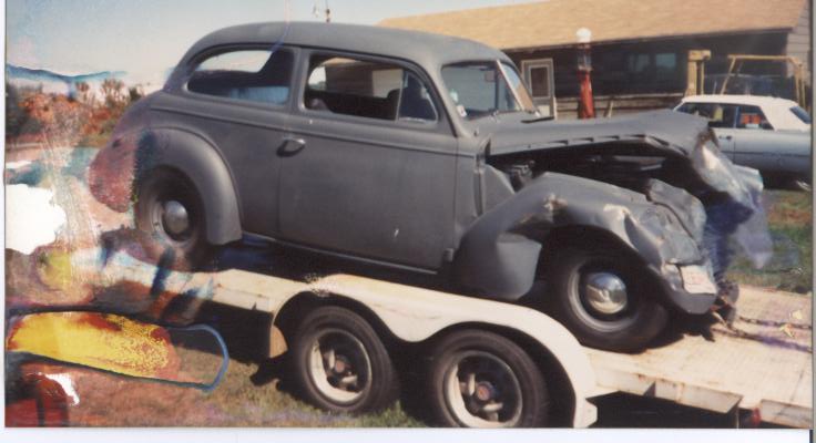

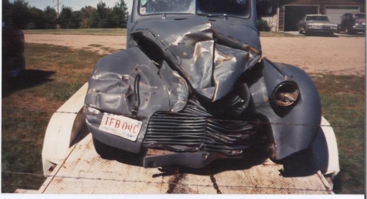

    Originally built back in 1987 this was my first hot rod. It had a 377 with 2 quadrajet carburetors, fenderwell headers, and 4:10 gears. It had a camaro front end at that time. I was 19 and it was a blast!
    Unfortunately in 1990 someone pulled out in front of my wife and I and it got wreck. I parked it and put the engine in a couple of other cars. 33 years went by

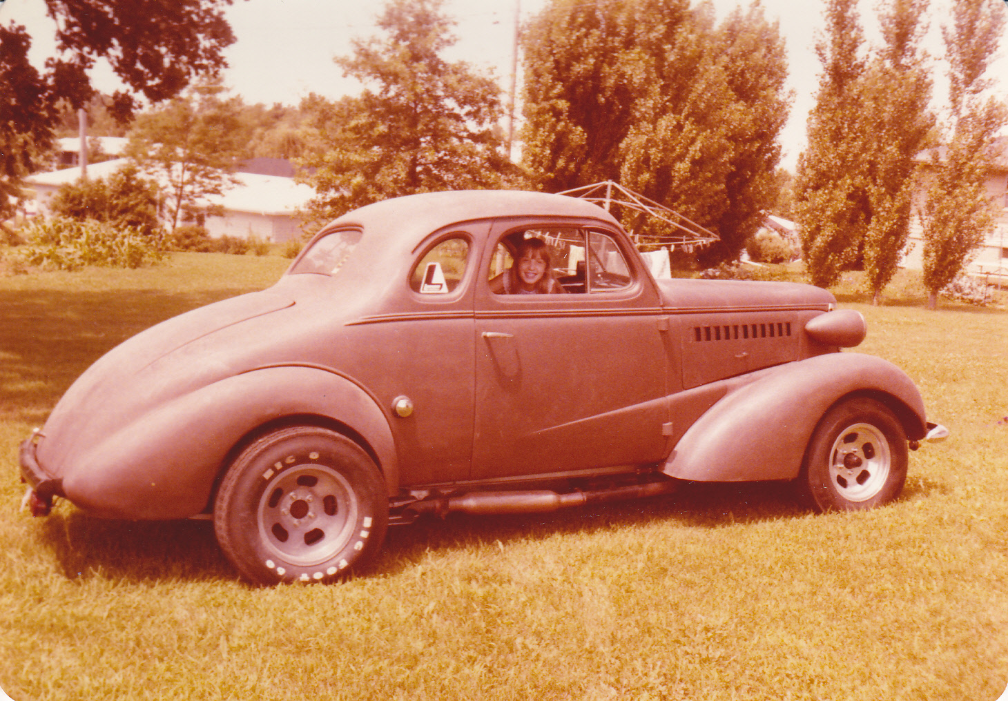

    When I built my 38 Chevy (in the 70's) ******* bars were one of the ways to control wheel hop, I just welded square tube to the shock/spring plates and used rubber bumpers (hey...it was a long time ago and I forgot where I found them...used), they have functioned quite well although I suspect it would ride better with out them. This early 70's 38 x_0001.jpg picture is the only picture I have that shows them...my daughter in the picture is a little older now.

    Your 38 sits nice!! I used stock springs and 4 inch lowering blocks the first time. With 4.10 gears the pinion jumped and the driveshaft would hit the floor. I built ******* bars on top of the springs. The did keep the springs from winding up, but I never could get it to launch without burning the tires off.

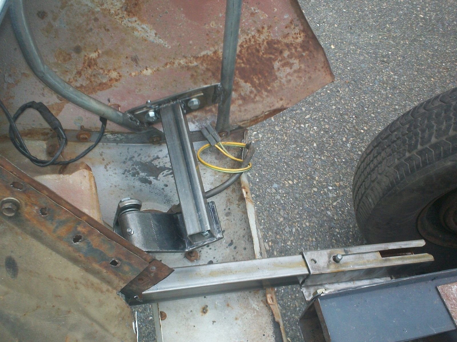

    Did it myself....young and ambitious...kept the front end bolted together, then found some old wheel
    bearings from rear axles off a '57 Chevy, made some "L" shaped brackets that I welded to the inner
    race of the bearing at the little end of the "L", and then bolted the large end of the "L" to each side
    of the radiator brace. This allowed me to remove the entire front end just by undoing 2 bolts on each
    side of the support. When lowering it, you did have to be careful as the bottom of the fenders bend
    slightly inward. Used Jeep hood latches down by the fenders to hold it down.
    I found a much more creative way to do one on the Hamb, that a fellow did on his coupe.. It slides
    the front end out about 4", then you can tilt it forward without it hitting the frame. Pretty sweet.
    48fordnut, Tim and Dyce like this.

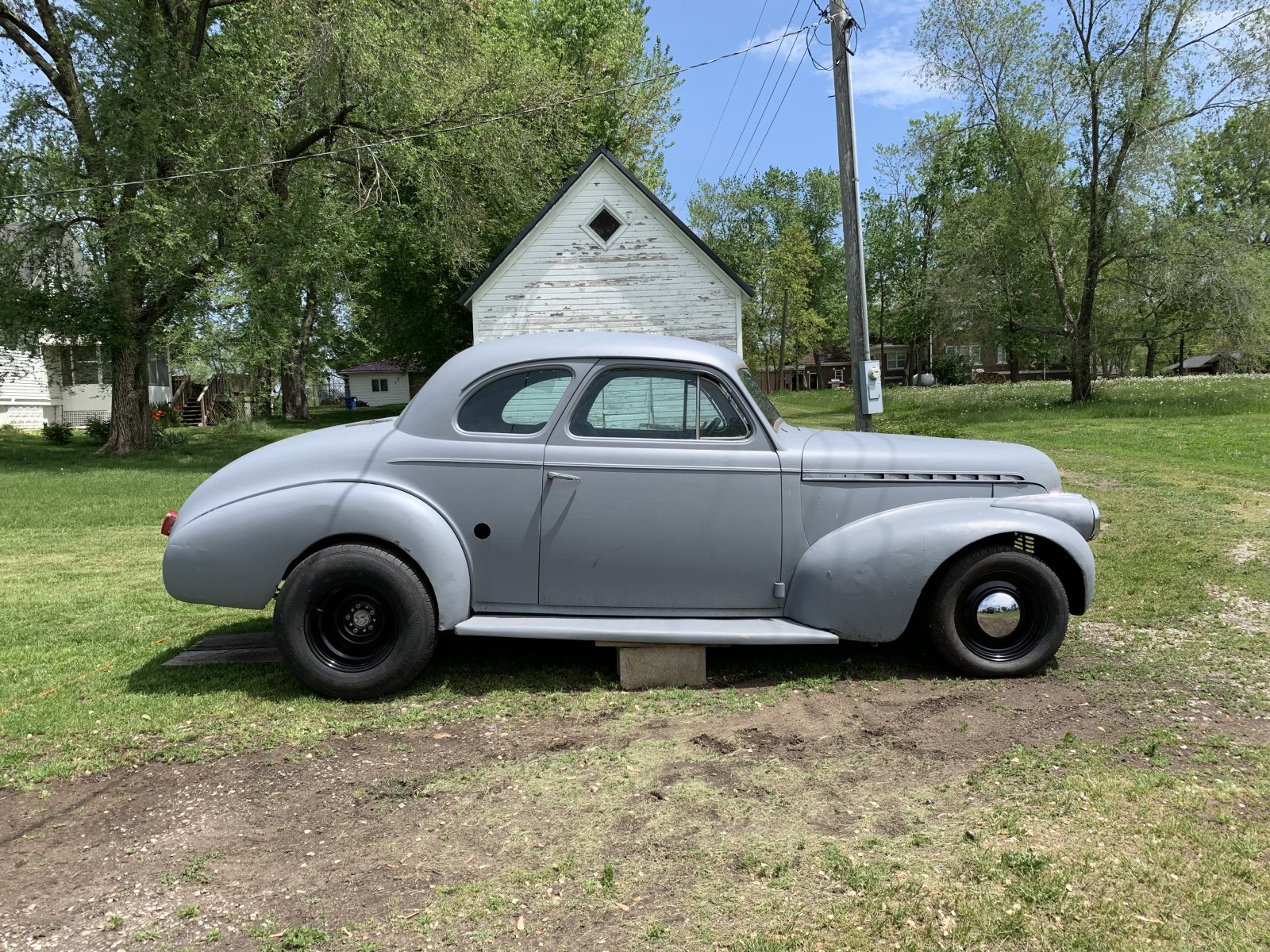

  25. Dyce
    Joined: Sep 12, 2006
    Posts: 1,980
    Dyce
    It's a master 85 frame. They had a straight axle.
    I plan on t******* the rear fenders to fit the rear tires. I had a nova rear end with 15x7 rally wheels on it. I tried255/70r15 under it back when it was still on the road and they rubbed inside and out.
    This is the 40 I drive now. My dad built the car in the early 90s and it was p***ed to me about 20 years ago.
    It's a nice cruiser! This one is going to have a little more al***ude.
