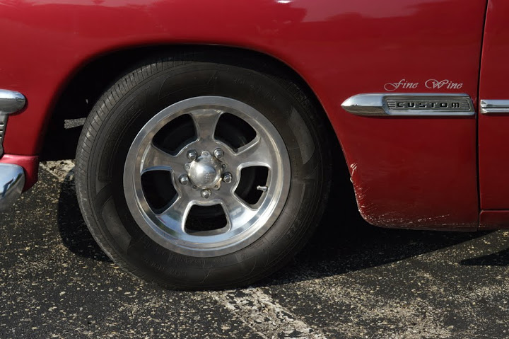

    Im not a big shoebox lover but thats a nice looking ride!!!! what brand are your wheels you have on it?
  25. rusty rocket: Thanks for the compliment, sorry, don't know, they were on it when I bought it. I looked through the paperwork folder, no mention of brand..

    Looks like the cheap chinese halibrand knock off wheels. fairly nice looking though, you should be able to sell them off easily enough.
