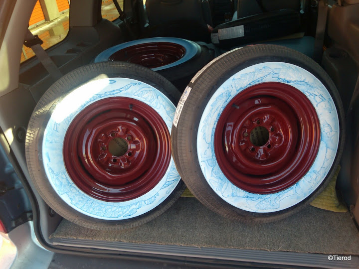

    SCORE: Just bought 5 of these.. 670x15 Coker Cl***ics, with new rims. mounted, balanced and painted.
    I wanted radials, but this deal was too good to p*** up.
    FYI: He has another set (but Ford Green) for sale, he bought them and his customer decided to go another direction, so he put them up for sale.
    http://fortwayne.craigslist.org/wto/5364037529.html
    Squablow likes this.

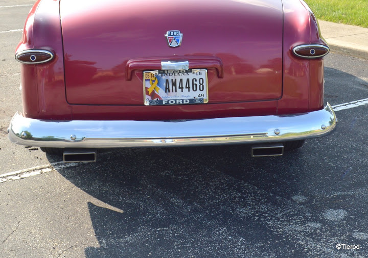

    Next is to remove the rectangular exhaust tips with round turn downs...

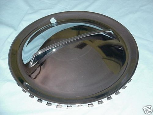

    I also am thinking about these Wheel Covers ...

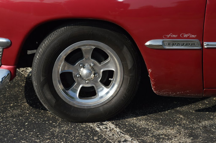

    OK< The "SHOE" has new Shoes.. :)
  15. jimbanner
    Joined: Oct 3, 2009
    Posts: 126
    jimbanner
    I like the new shoes alot!

    So amazing what a new pair of shoes will do...stance actually isn't bad either with the new springs...looks great!

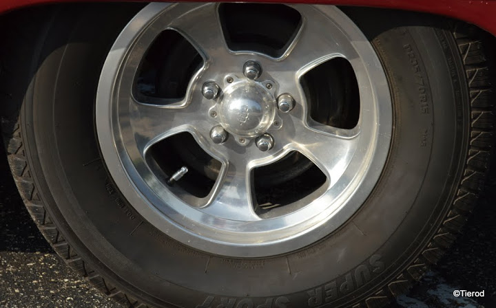

    A close-up of the "Hollywood Spinners" Kool Daddy-O...

    New wheels and tires look great, sits nice too with the new springs.
    Will the "fine wine" stickers come off?

    Squablow: Thanks.. It seems like it is actually up a bit, but the old springs were hearted and compressed together. I'm OK with it, it rides nice. The "Fine Wine" letters are from a craft store, vinyl stick on letters. It refers to the color "Raspberry Wine Red".
