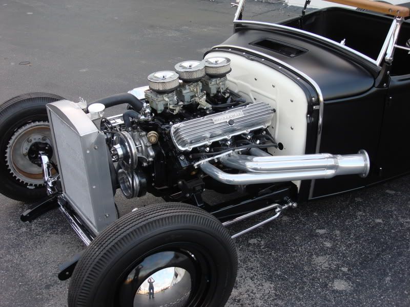

    Bob, that was a little time consuming. Plus I had to mask EVERY inch off really carefully, since any white over spray would really show up on black:eek:
    Plus, I am really picky about the way the seam between the cowl sides(black) & the firewall(white) would look, since a crooked line back in that seam would really show up, since white & black are SO far apart in color. I wanted it to look like the fire wall was painted white off of the car, & then put in.
    To get the inside of the cowl sides masked in a good straight line, and used 3/4" blue tape. I cut it in 2" strips, since the cowl sides curve it would be real tough masking it in 1 piece.
    Then I just slid the tape in between the cowl side & the firewall, sticking it to the cowl side. Went all the way from top to bottom, & ended up with a really good job, even if you really look back into the seam.
    Then I had to mask the rest of the body off-top, underside, & interior:mad:. 5 hours of masking! Less than 1 hour of spraying white sealer & the paint :D.
    Honestly though it is one of my favorite things about the car. Breaks up all the black real nice. And the gloss off-white really jumps off of the satin black. Also kind of highlights the motor a bit, & will tie in my interior & top color I think. I am anxious to see your firewall progress, really glad to see your roadster progress!
    Dan

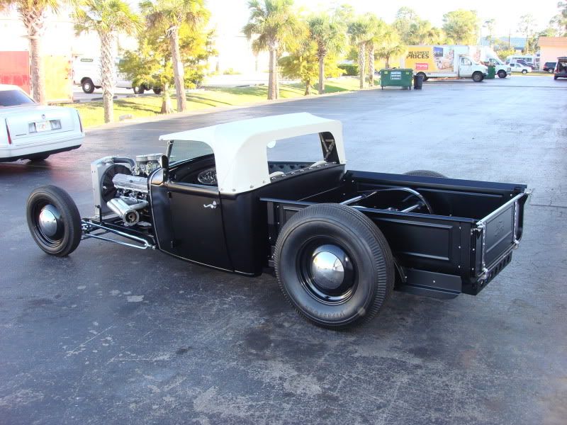

    Well I have some cool progress pics to share. I got the rpu back from the upholstery shop, & I am really happy! Got the top done, as well as the seats & floor mats. What a difference it made to me, I really am happy. The guy did a great job, I really like it!
    The seats are surprisingly comfy! For carpet I chose black German square weave,
    & only did floor mats to cover the front. These will just snap out, easy to care for. They still need to flatten out a bit, they were rolled up in a bag:eek:
    I am excited to see it come together. I also am anxious to get my aluminum interior panels put in, but I'll prolly put those in last, after everything is wired & done.
    The top & seat color was a real good match for the wimbledon white firewall. It all photographs really bright white looking, but is really more of a cream look in real life.
    Here's some pics for now, hope you like! Thanks for looking everybody
    Dan
