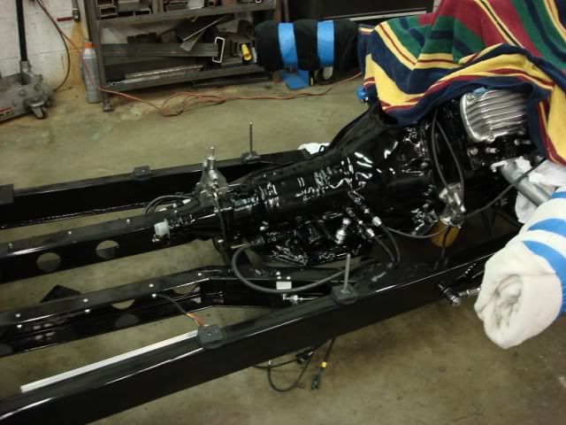

    Hi, I'm Dan's Dad and normally only lurk on the HAMB because this is the only forum Dan is on, and I leave it all to him without me embarr***ing him.:eek: But Dan has been wanting to post an update of where he is on his rpu and has just been too buried between working 60 hour weeks and then staying at the shop until 2 and 3, trying to get his car done in time for Billetproof April the 9th. So I thought I would let you all know where he is on it as of now.
    He mentioned the transmission problems, and the people who built it 4 years ago graciously offered to fix whatever is wrong at no charge. That was very good of them and the reason we have bought 4 transmissions from them in the past 5 or 6 years. But we weighed the time it would take to ship it back to Ohio and decided to just let a local shop fix it right here. I took the transmission in to them today and should have it back tomorrow or Wednesday.
    Getting the transmission out required either pulling the engine and trans as a unit, or, we could remove the body and take the trans out all by itself. We chose door number 2 and pulled the body off. Dan was sweating bullets because he has put so much time and effort into trying to make it nice that he worried about damaging something, so we padded it with lots of towels and moving blankets and hoisted the body off last weekend. Dan was smart enough to install quick disconnects on everything, and that helped a lot. It only took us an hour and a half to get the body off, and one more hour to get the trans out and on the floor.
    I'm posting a few pictures of us doing that. If the trans comes back on schedule we should be able to see it move under it's own power for the first time this coming weekend. I REALLY want that to happen as Dan has overcome a lot of issues with this build and has put so much time and effort into it.
    BTW, as a Dad I would like to thank all of you who have been such good friends of Dan's throughout this build and during his membership time here. Your encouragement and nice compliments meant a lot to him and kept him going when things got tough. That means a lot to me too, thank you.
    Don
    Here it is all wrapped up, ready to pull the body off.
    Body hoisted via our gantry.
    Trans now exposed so we can unbolt it.
    And finally out of the car.

    Thanks guys. Dan is at work and the transmission shop just called. I promised I would let you know what they found, in case someone else ever runs into this problem.
    It was the front pump. There are two tangs in there that engage the torque convertor and one was broken off and jammed up the pump gears. He said everything else looks good, so he just replaced the pump and we are good to go. I suspect that when we installed the torque convertor (B&M Holeshot) we didn't have it seated all the way into the pump. The other night we removed the three bolts holding the convertor to the flexplate and spun the TC until it dropped down into the pump. There was about 3/16 clearance between the TC and flexplate.
    I called Mondello (They are big on Olds engines) and they said the right way to do it is to seat the convertor all the way in, then shim up between the TC and flexplate with grade 8 washers until you only have to pull the TC back out of the pump about 30 thousandths. I questioned them if that would be strong enough and he told me "That is how we do our 1200 HP drag car!" So I guess it is ok. :D He said there are so many different flexplates dimensionally that you have to do it this way to get a good fit. We figured since we had a B&M TC and B&M flexplate they would be matched, but I guess you still have to set the depth.
    So today I'll pick up the transmission for Dan and tonight we can start putting things back together. This downtime gave Dan a chance to do some other stuff that is easier with the body off, so it is not all bad. We plan on running the car through the gears BEFORE the body goes on this time! :D
