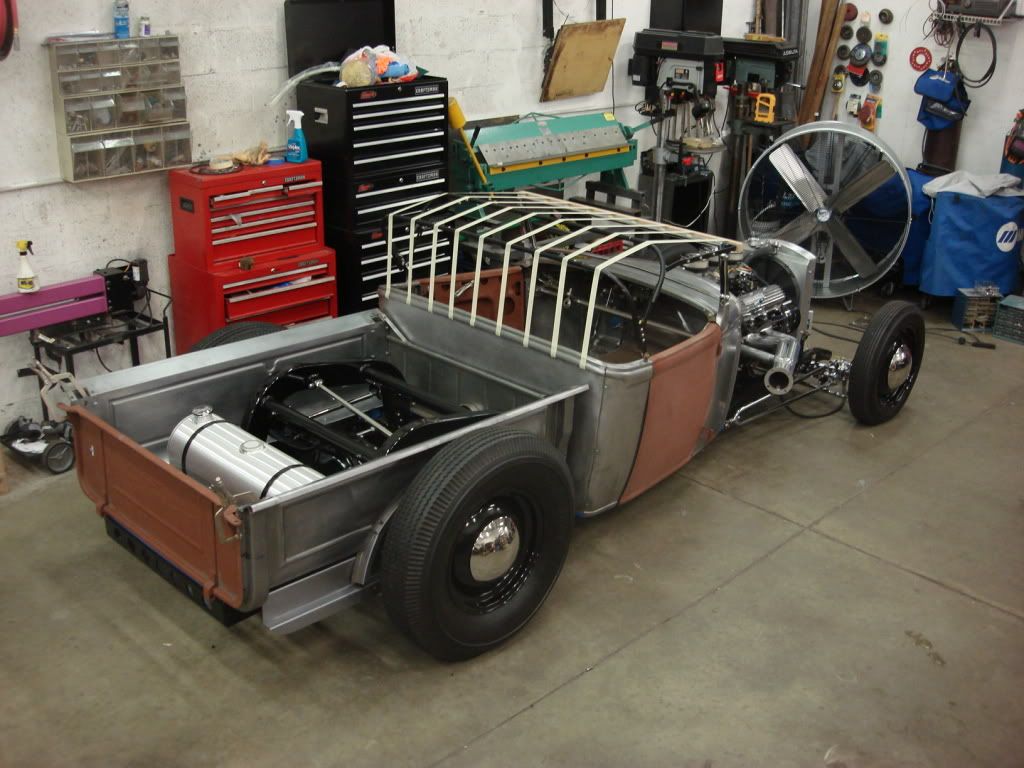

    Well, thinks have been a little slow as far as progress lately, but I did get some things done. In the past couple weeks me & my dad have been cleaning up the shop-it got to be a freaking disaster!! Couldn't find any tools, if you took 1 step in any direction you'd trip over something, etc. It made it no fun to work, so we spent some time reorganizing & cleaning & things are good again!
    I got a few things done too. I made a bracket to mount my fuel pump & regulator, and also mounted the gas tank. I just have to get the bracket powder coated & it'll be done. Not overly exciting, but here's a pic of that:
    Then I finally got my lower windshield mounts fit & mounted to the body, so I could finally mount the windshield frame & fit the top bows.
    Once I fit the top bows, I hated the shape of the side window opening. Hard to explain, cuz I didn't take pictures of it the way that it was, but the side opening tapered lots lower as it got towards the back of the door, & looked horrible. I redid it to make it parallel with the door top, & it looks way better I think. I also played lots with the bow positions til I got it where I like it, then I ran some tape to get an idea of the shape. I think it will work fine.
    I then put the body & bed on the frame to get a look. I like it! Now I can finish up a few details that have to be done with the body on the frame, then I can get the body off for paint. That is after I decide on a color-I change my mind about every day:eek:
    Heres a few pics as it sits-time for bed!
    Thanks for looking
    Dan

  24. I am verrry much loving your roadster pick me up truck.
    Love the lines of the top. Fits the long and low feel.
    I may have missed it in the thread but is it going to be a fold down top?

  27. dodgerodder
    Joined: Feb 15, 2005
    Posts: 1,943
    dodgerodder
    Thanks for all the nice words guys, I really appreciate that
    Well, the car performed well, but it did mess up my perfect hair.........:D
    Thanks man, I appreciate! The top on mine won't fold down. I had to alter it to make it look better (to me), so it will not fold now. In all honesty, I'd probably never fold it down anyways
    FTF, the bows are Kwik-tops, I got them from Speedway. They worked out fine in the end, I am happy with them. The top will be nice I think, it's so freaking hot here it will keep me from getting totally baked. That, & it will again help keep my perfect hair from getting messed up:p
    Thanks a ton! I am glad to see it start to resemble a car. I really appreciate your input on the powder coat issues I had, it really helped me out
