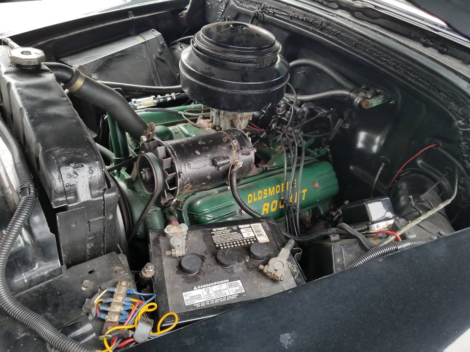

  1. A few weeks ago I picked up this super nice 1951 Oldsmobile Rocket 88 4 door sedan, plans are to turn it into a very mild custom/highway cruiser. It is basically stock with the exception of being lowered by the p.o., front has had a coil and a half cut from the front springs but as far as I can tell nothing has been done to the rear.
    Once I get the carb back from the rebuilders and a few other odds and ends taken care of, I'll start on the slight modifications that I have in mind for it. It already has dual exhaust but I want to get a set of nice sounding mufflers on it, Porters or Smithy's, and some chrome tips out the back. I'm also trying to find a set of Jeffrey Allen headlight visors but so far everybody has them on back order. These are the ones that mount on the headlight rings and resembles the '56 Cadillac rings. 12 volt conversion is something that I will be doing fairly soon so that I can get a/c in it to add to the comfort factor, the summers in the south are a *****!
    I'm not crazy about the green tweed interior but it'll have to do for now. Lake pipes are also planned and perhaps a set of dummy spots. I would like to nose and deck it but the paint job is just too nice to mess with, we'll see.

    Here's some advice, most likely unsolicited. When the 2GC Rottenchester gives up the ghost, find a 324 4bbl manifold and get an Edelbrock 450cfm AFB carb. The engine will love it. My West Coast Bias says to dump the sun visor unless you're going for the Bomba look. Oldsmobiles are great road cars. I sure miss having one, now.

    Please replace the fuel filter with a metal one!
    The one that is on there have been known to be dangerous and have broken or leaked and started fires!
    Awesome Olds, have many happy miles in it!

    ^^ KK is correct. Olds's are notorious for manifold heat.

  13. Actually it's a Rochester BB. I have thought about putting a 4 bbl on it along with a set 1.8 rockers.

    Changing the rockers to 1:8 is a good mod. Finding a set of #10 heads is even better.
