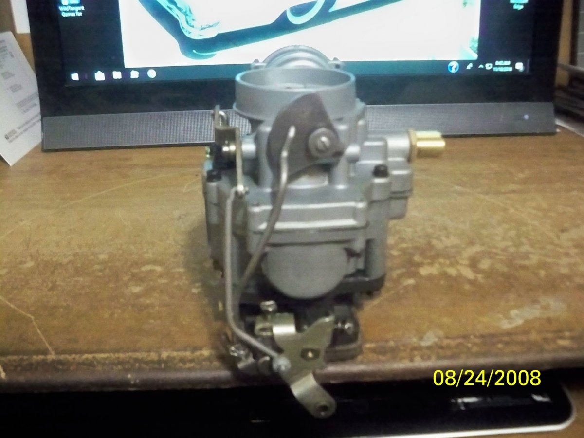

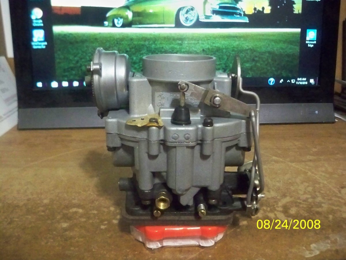

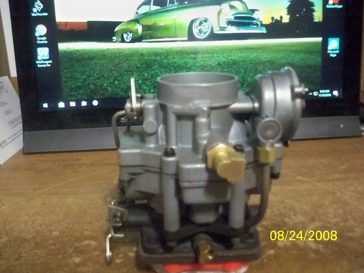

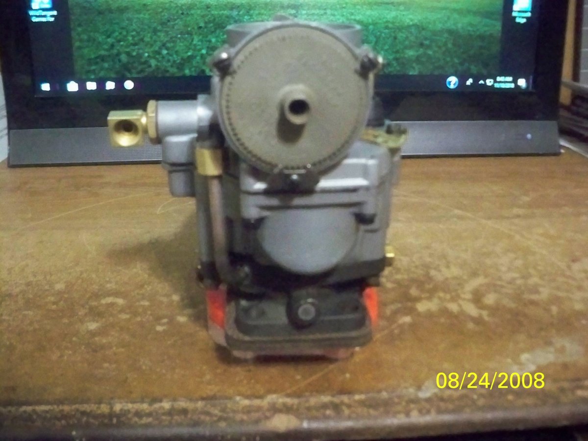

  7. I finally got my carburetor back from "Custom Carburetor" in Alma, AR. yesterday afternoon and the plan is to have it up and running today. I can't say enough good things about them, this the 5th or 6th carburetor that they have done for me and each one has been outstanding. Tim really pays a lot of attention to detail and won't let them go back out the door until he is completely satisfied with the work. I highly recommend them!

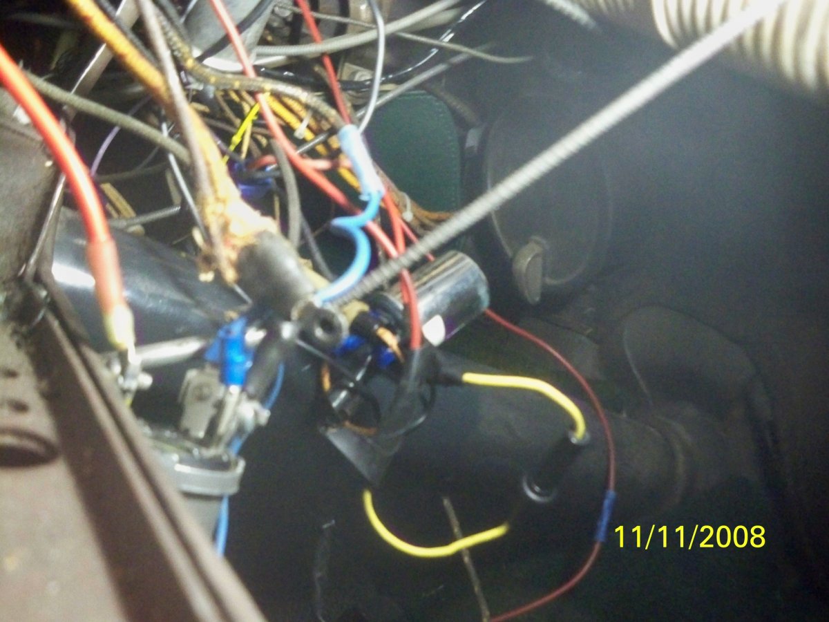

  27. Well, with the carburetor and most of the starting problems behind me it's time to tackle the electrical system. I had found that I was not getting enough voltage to the Pertronix Ignition, according to Pertronix it needed a minimum of 5.2 volts and mine was only getting 5.08 volts. Doesn't sound like much but when your working with 6 volts, it needs all it can get! That in it's self was the cause of the miss at idle, just not getting enough juice. As you can see from the picture's, it needed a lot of help under the dash! Lot's of frayed wire's and poor repairs led to it's down fall. I looked at a couple of 6 volt wiring kit's but ended up deciding to wire it myself. Since the lighting system had been rewired sometime in the past, I made the decision to just tackle the ignition, starting and charging systems.
    I am now at the point of having nearly everything finished under the hood, except for a couple of wire's and am now getting after the dash wiring. It is, by far, the worst...
  28. Fun stuff all upside down on your back trying to get the ol' eyeballs in a place they can focus. One of my favorite jobs! LOL
