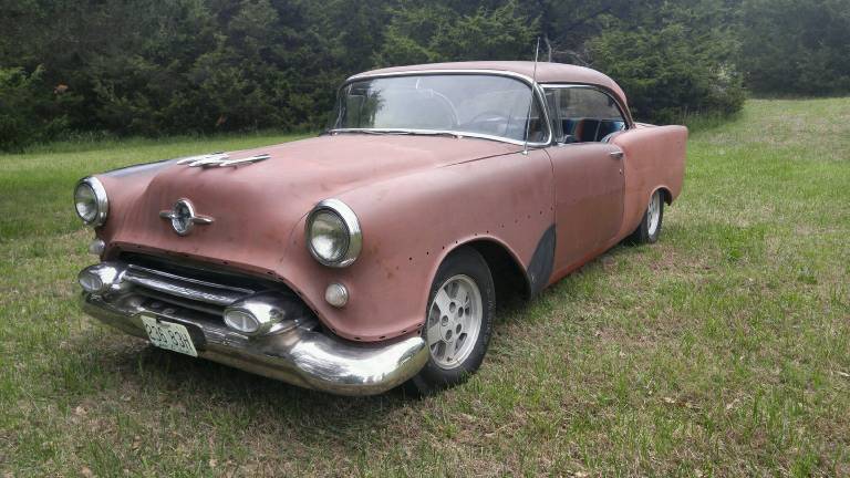

    Still haven't got my Rochester BB back from the rebuilder, yet. He's had it for over a month now but I have decided not to use it anyway because I ran across a smokin' deal, at least I think it is, on a slightly used nos '53 Oldsmobile WCFB 4 bbl carb with the intake manifold and original batwing oil bath air filter for $350.00 shipped from a guy that owns a shop in north Texas a couple of weeks ago.

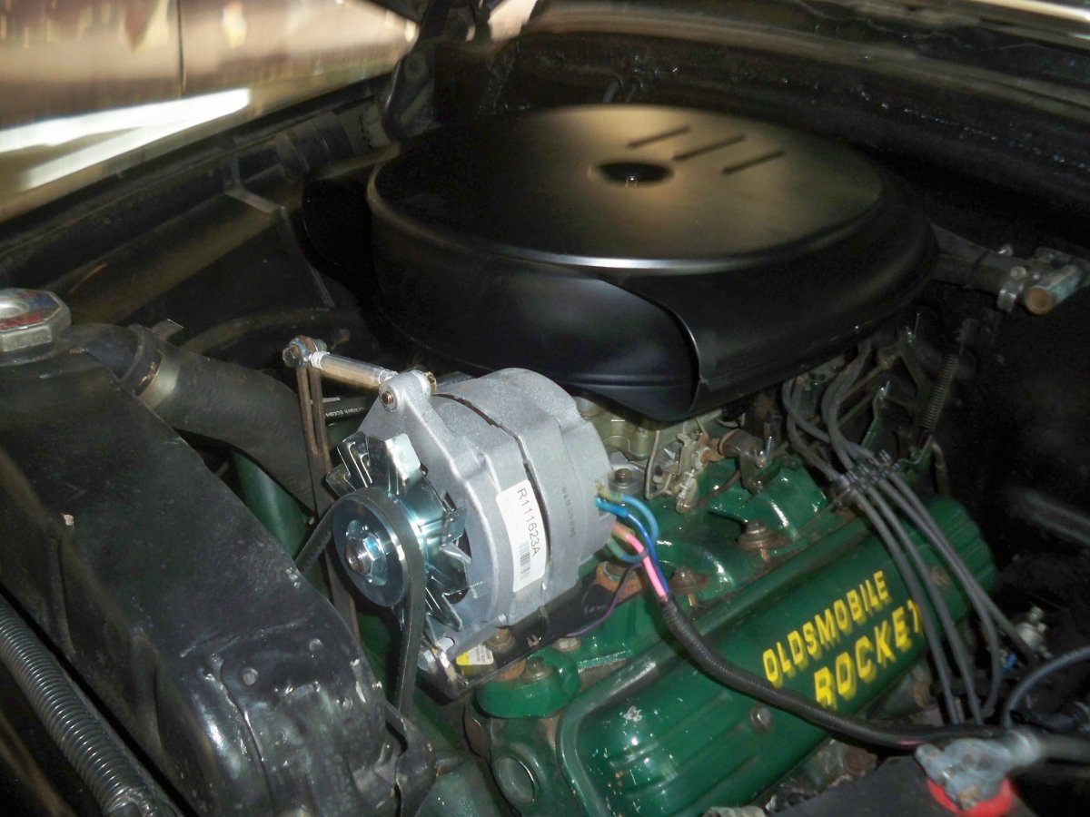

    I swapped out the intake's and got the 4 bbl hooked up, over the last couple of days, and fired her up this afternoon, wow! It's really nice to see it running again and not having it belch out gob's of black smoke and flood out. Although it's idling a little fast and has a bit of a stumble, it runs pretty smooth. Hope to have it ****oned up tomorrow.

    These are the pictures that the guy selling it had sent me. I was going to take a couple pictures of them all cleaned up and painted on my motor but the battery was dead on the camera! I'll get some pic's tomorrow...

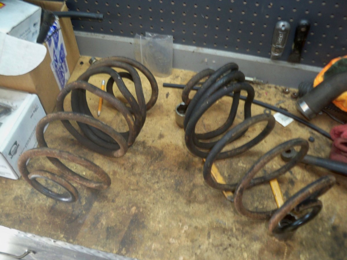

    Decided to tackle the rear suspension, I have been wanting to get the rear end a little lower. Got her up on jack stands and pulled the rear wheels, found a leaking axle seal on the drivers side and of course the brake lining was oil soaked. Right side looked pretty good other than the brake shoes were pretty thin. Both of the rear knee action shocks have been leaking so they'll need rebuilding, cheapest that I have found were $185.00 ea. plus $100.00 deposit if mine weren't rebuildable not to mention the shipping costs! Both of the rear shock links snapped in half while trying to remove them so there's another $65.00 plus the shipping charges! Differential pinon seal has a slight leak so I might as well replace that while I'm at it.
    Seals, brake shoes, shocks, shock links and springs, this is starting to add up. I did manage to get a deal on the rear springs, during my research on how to lower the rear I discovered that the 1960 - '72 Chevy C10 pick up springs would bolt up and give a decent drop. I found a pair of 6" drop springs on eBay for $90.00 shipped, they're giving me about a 3 1/2" drop.
    It has always amazed me what some people are willing to do to their automobiles, this is what I found when I started taking the springs out...
    ... heating the springs is the "old school" way of lowering a car but we didn't heat the coils in the middle like these, we would heat the lower portion of the spring until we received the desired amount of drop.

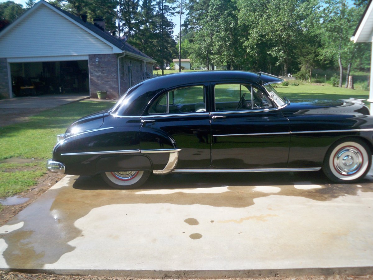

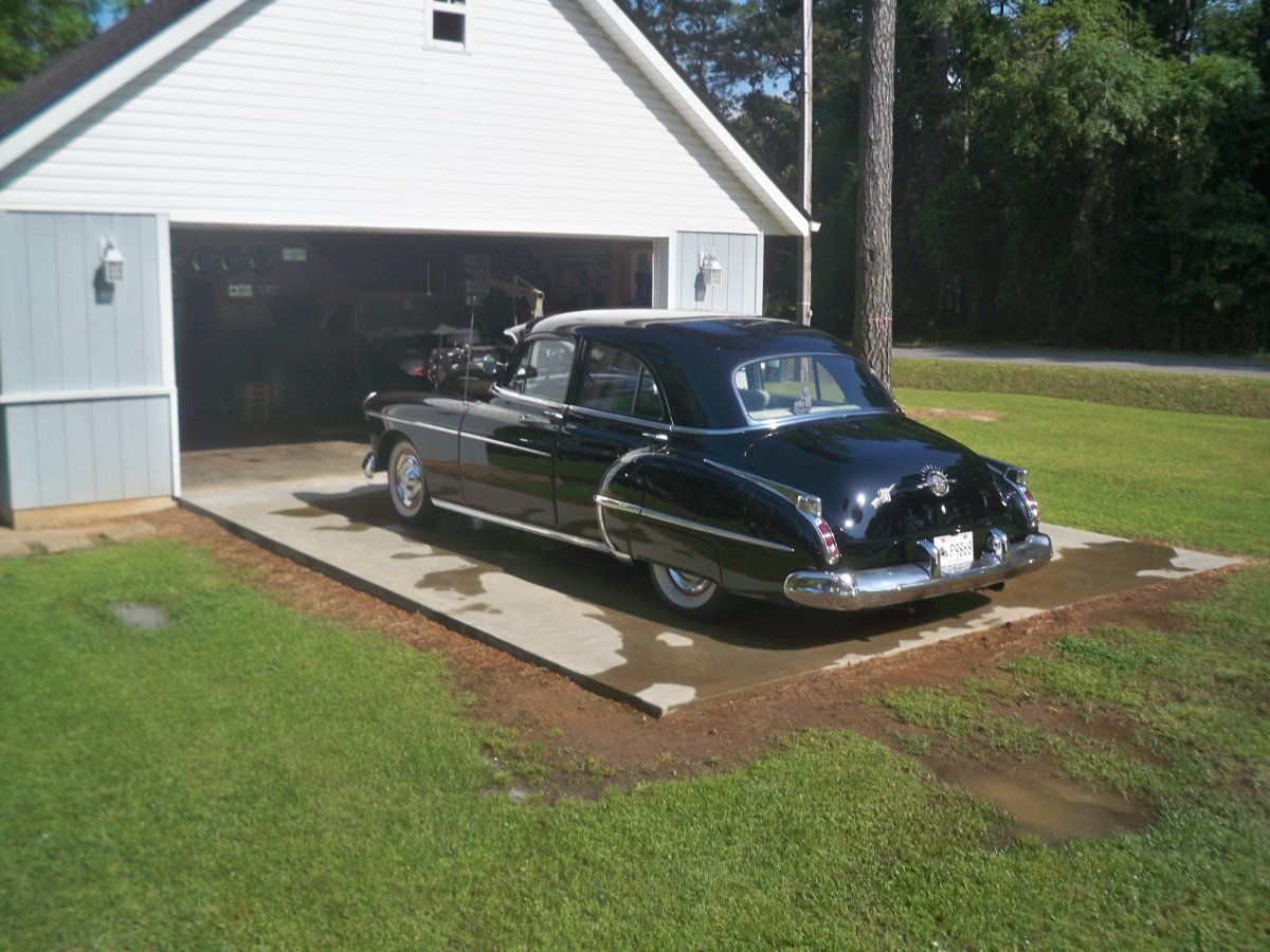

  21. She's finally back on all fours and cleaned up! I'm happy with the new stance and the better suspension makes for a much better ride. 39.JPG
    ****! Now you see why I was a truck driver and not a photographer!!

    Looking Real Fine.. Love the stance is perfect... Fine Cruiser ...

    Your car looks great and sits just right. My old man bought a new '51 Olds 88 and I remember it looking quite different from yours, which closely resembles a '50 to me. I did a little research, and it seems that he had a Super 88, which was new for 1951 and had a completely different grille, rear quarters and taillights. I did not know that and was quite confused by this thread for a while.
