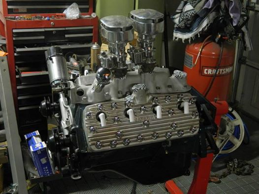

    Been a while since I updated this thread. I had a bad experience with the Flatty I built for this car. I ended putting it in the car getting it ready for the premier of the Kustoms by the Sea in Wildwood at the race of gentleman. The motor ended up having a crack in one of the exhaust ports and was spewing water out the right bank. The crack was undetectable when it was magnafluxed. I ended up having to scramble to get the original 21 stud back in there. A few sleepless nights and the car was ready for the trip down to Wildwood. Had to replace a few wheel cylinders from sitting close to a year. I ended getting the car down the day before the show. I decided to go for the adventure and drive the 150 miles to Wildwood. A few minor roads issues with a sticky valve but we made it in one piece. It was a fantastic show and I am glad I rolled the dice.
    Here is a pic of the 8ba motor that I built but ended up having a cracked block
    Here is the original 21 stud flatty going back in once I realized I had a cracked block

    I stumbled apon this thread looking for tire size ideas for my 40 vert. Thanks for the tire details earlier, the 6.00-16's look perfect on your car, I think that's where I'll end up too.
    Great story, best thread I've read in a long time.
    So what's the plan with this engine? Is it salvageable at all?

    Tom, thanks for the compliments. Actually there is a crack deep in one of the exhaust ports and it just can't be reached. I ended up s****ping that motor but I have a couple of other flattys I am choosing between. One is a 48 Truck block and the other is a 51 Merc runner. Liked to throw that Merc in there for the extra Oomph but the 59ab style is killer and would look just as cool. Still up in the air. I picked up an original Edelbrock slingshot that I am going to put on the 21 stud to give it a little extra. I also picked up an NOS Lucas distributor from Chris Swenson for a flathead that was a standard on the old Allards that ran the flatheads. Its adjustable for the initial timing so that will give me a little more to play with.
