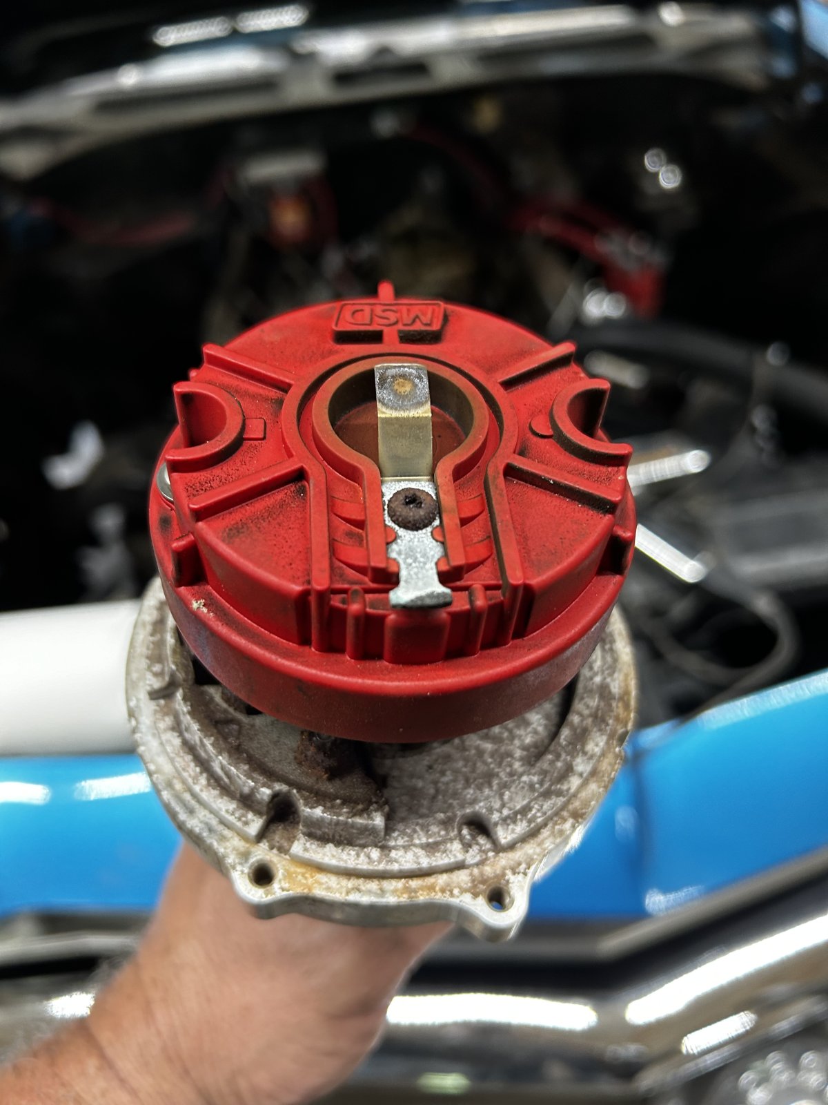

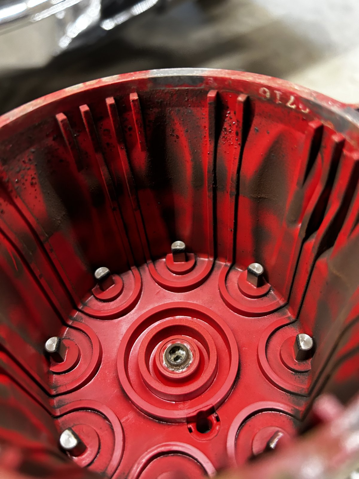

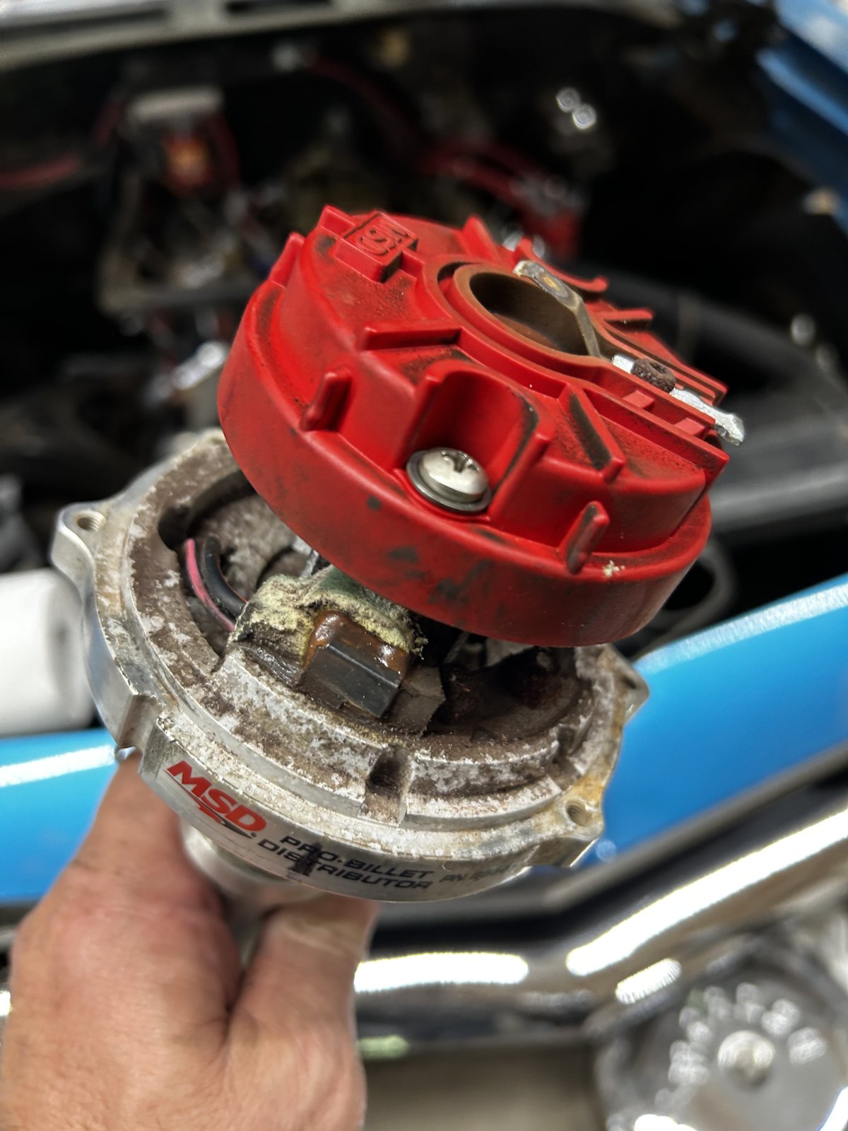

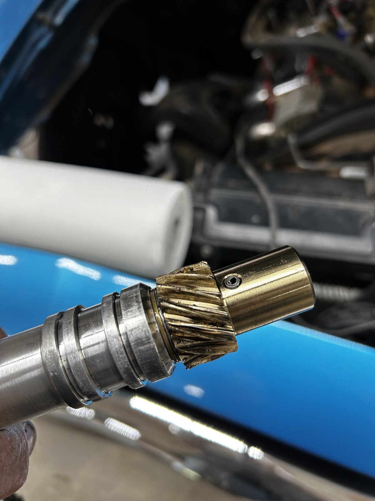

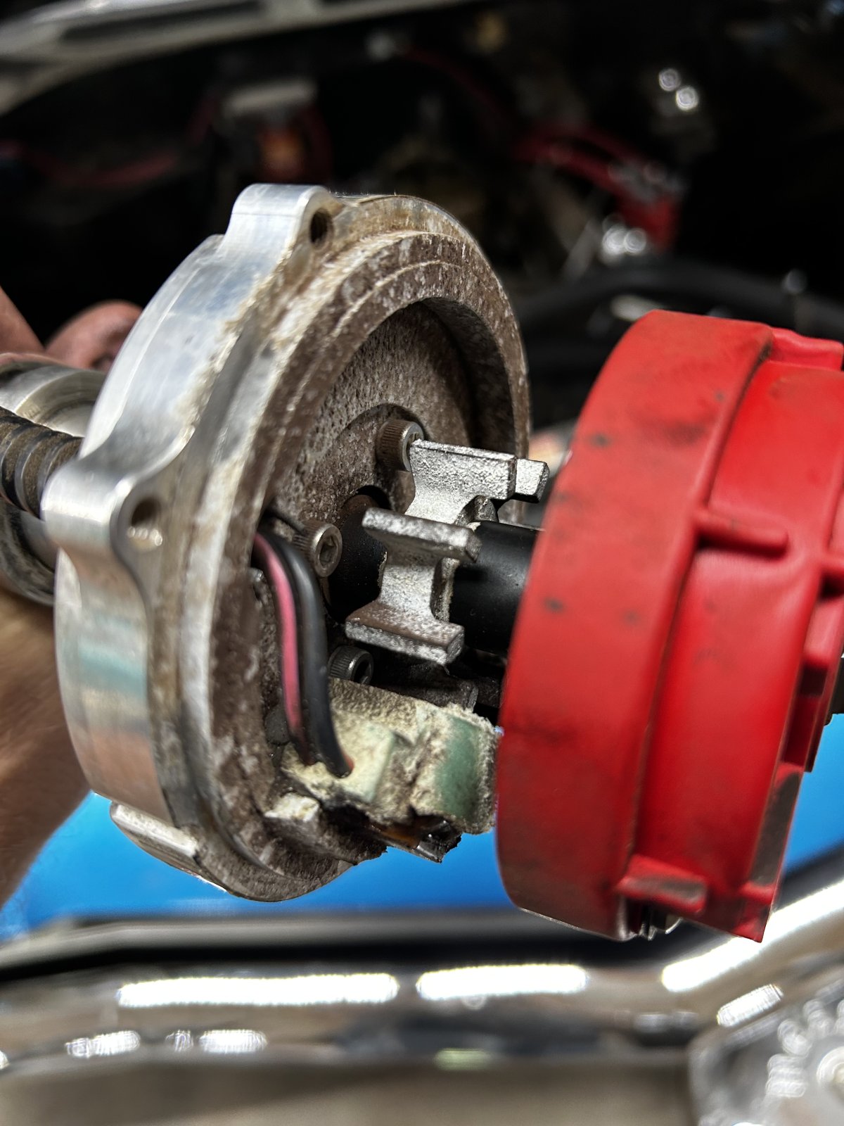

    Well, pretty sure I found why it started running like **** recently. Not sure I have ever seen a distributor look this bad when I took the cap off. And, I have never run a br*** gear before, but this one is pretty much done…
    Looking forward to how it runs when I get this all freshened up.

    Does it have a roller cam? The roller 350 in my 2000 GMC had a dist gear that looked like that. Seems to be a common wear item with rollers.

    Yes, it's a roller Dan. I have a new bronze gear to replace it and have also read that sometimes the first bronze gear wears the quickest. Then, the wear rate slows down on the next ones. We will see. I would have ordered a composite gear but everyone was out of stock on those.

    I put a melonized gear on my dist for the roller in my coupe. They're supposed to last longer. We'll see.

    Why not a steel gear like Ford did with it's roller cam??? We never had that problem with the 5.0s....

    I ***ume it is just something to do with what the cam blank is made of and how it wears as compared to the gear on the distributor. I have run hydraulic roller cams in engines and just run the steel gear with no issues. Anyway, I figure it is safer to run what the cam manufacturer recommends. I would rather wipe out a distributor gear than a cam. :D

    I can't believe the condition your distributor was in. It looked like it'd been driven down dirt roads all the time.
    Sure sounds great now!

    I always run a safety wire through the roll pin holding the gear on . Just me

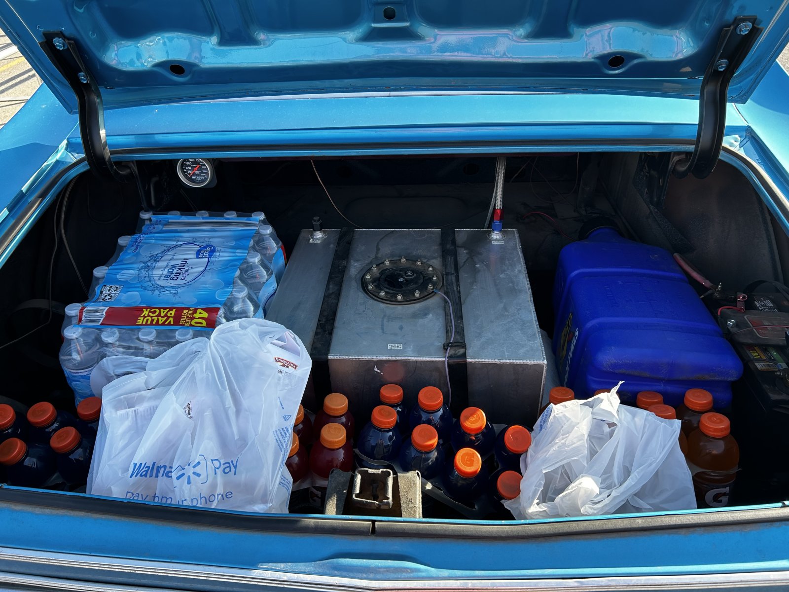

    Really need to do something about the fuel cell. Between only 10 gallons, no gauge, and no room for groceries, I am about done with it.

    A buddy of mine bought the steel sump from Summit and welded it to a new stock tank.

    Lol! Stocking up the shop fridge. :D
    Some of the structure for ladder bars is in the way of the stock tank. I’ll just have to build one.
