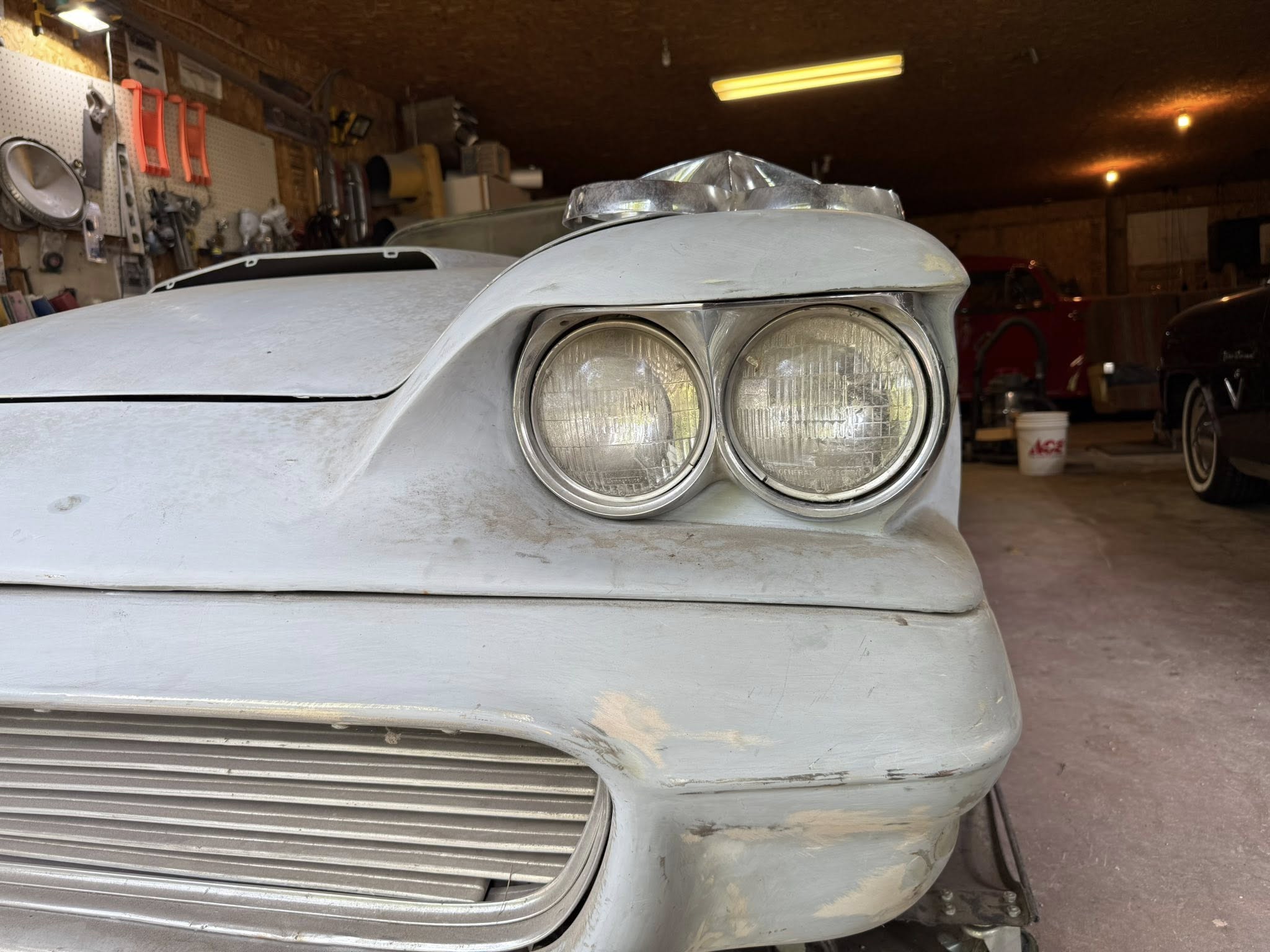

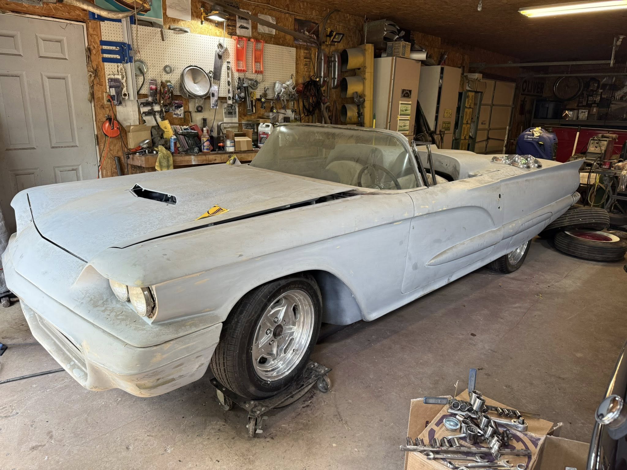

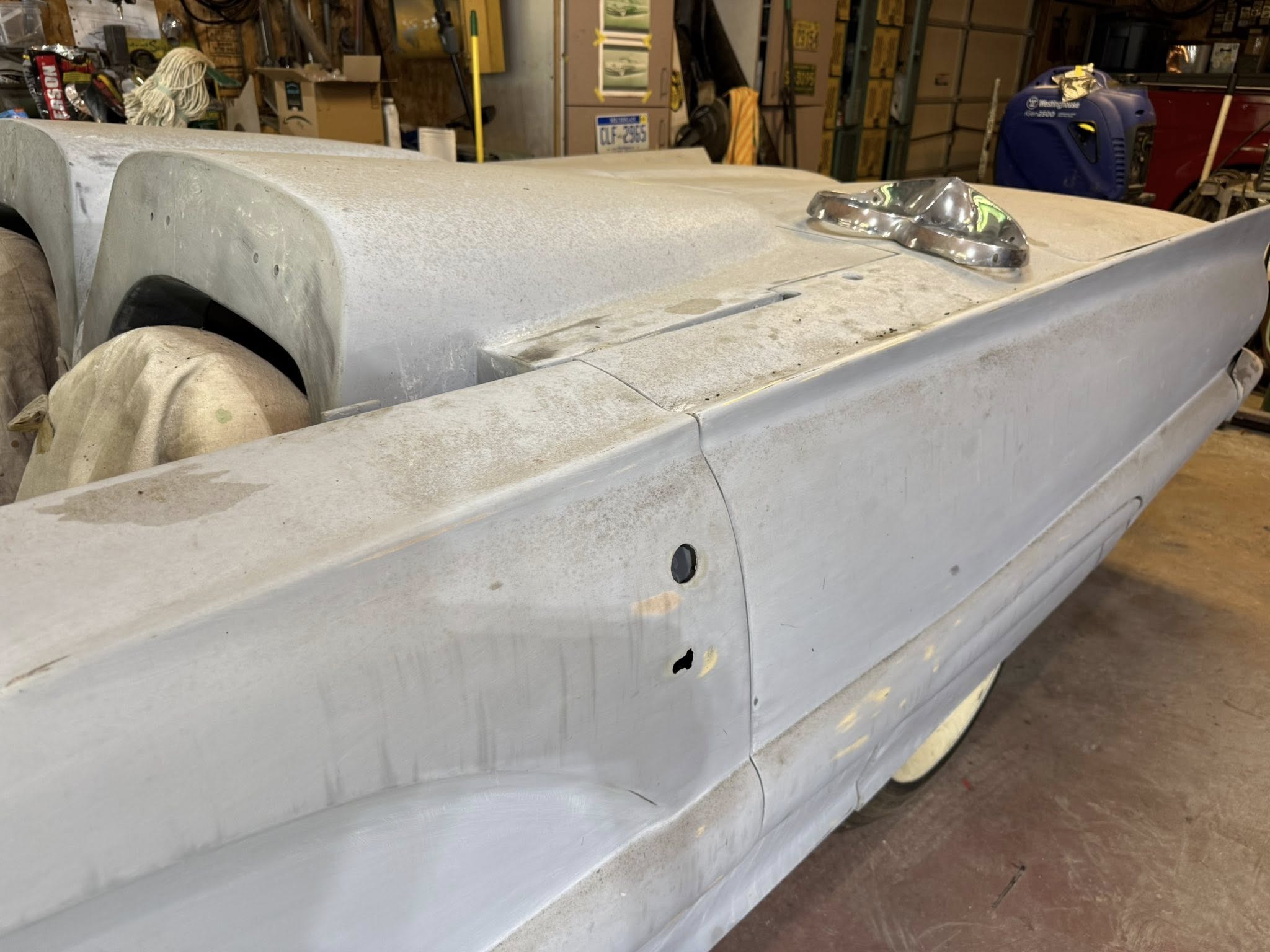

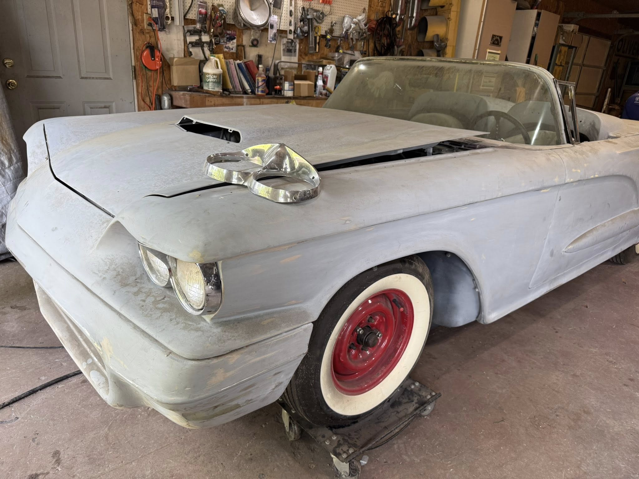

    I mentioned to my wife that I'd decided to get rid of the T'bird, said I was going to sell it or give it away if somebody would finish it. She said, "I wish you'd work on it, you did so much work on it already, and it's not that far from finished. I'd like to see you do it."
    With approval like that, how could I get rid of it? So, today I spend most of the day cleaning and re-arranging the shop, pulled it out of the back of the garage with my little 4WD tractor, swung it around into the "work bay", shoved the lift under it and even ordered up $1,000 worth of stuff to make it a car again.
    In the 17 years it's been apart I changed my mind about the Hirohata paint scheme (the stumbling block that stalled me on the project) that Eric Black used in the inspiration artwork. I've seen several squarebirds tu-toned following the body lines like his rendering (different colors, but same paint line break), and honestly, they don't look good this way. In the back of my mind has always been Candy Lime Gold, like the A Brothers used on several early 60's customs, and I think I'm gonna try it. It'll certainly be the period correct, and my wife approves (although she balked at an all white pearl interior idea) I think it's a go.

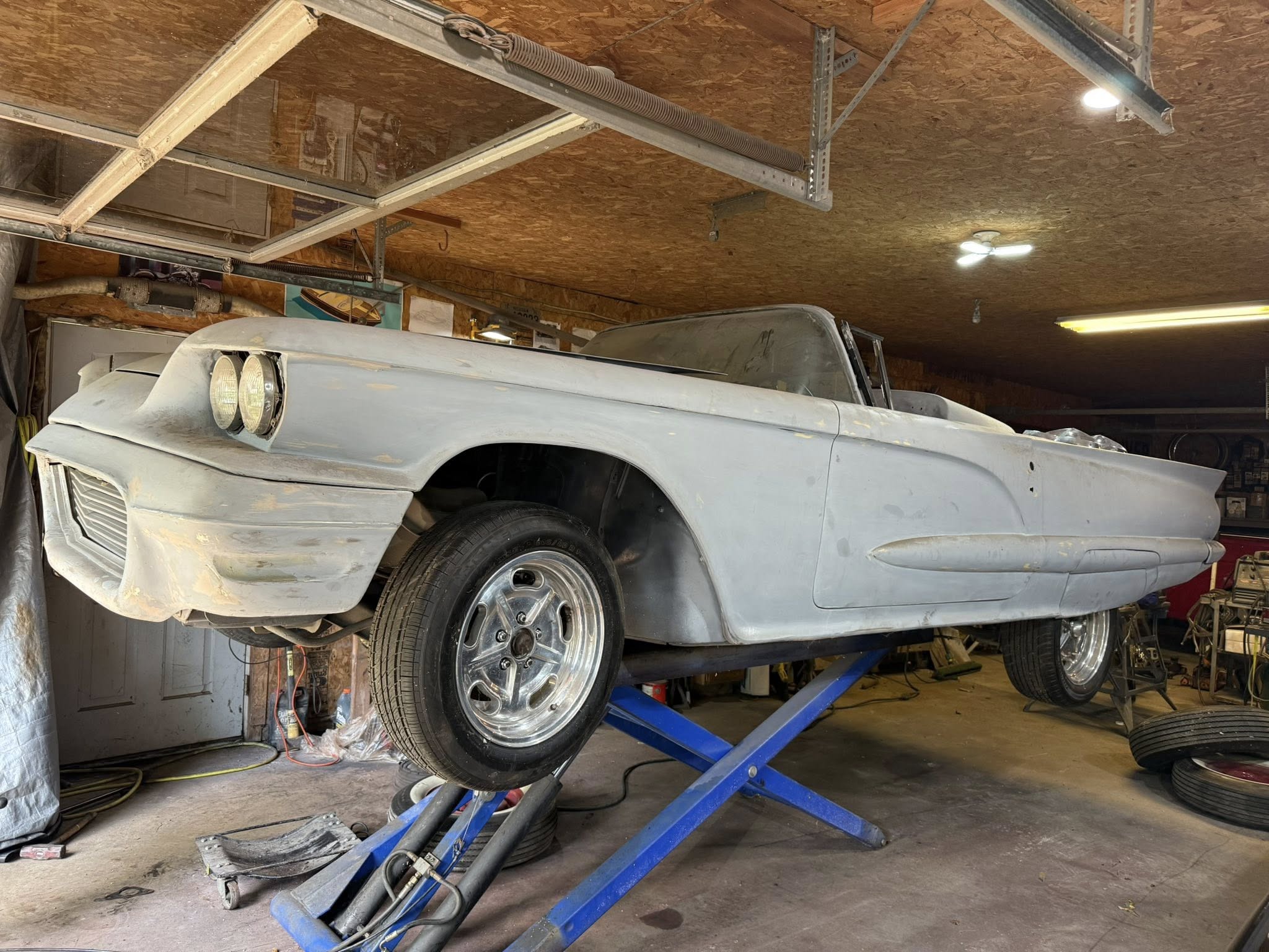

    Here's how it looks tonight... 7E116C45-AA96-426C-8A02-1816BC9DC544.jpeg 22FCBD37-3507-4950-A581-84951E1DEBF7.jpeg 0D3F381E-87A1-447B-A178-B153054ED6DC.jpeg 46709AFB-1F9C-4618-BE23-C053A7B99C66.jpeg 884E20A4-8E60-4F1F-B161-51002A6FEF8A.jpeg 36DB32C9-F032-40F3-A5A1-460B9863BCE1.jpeg

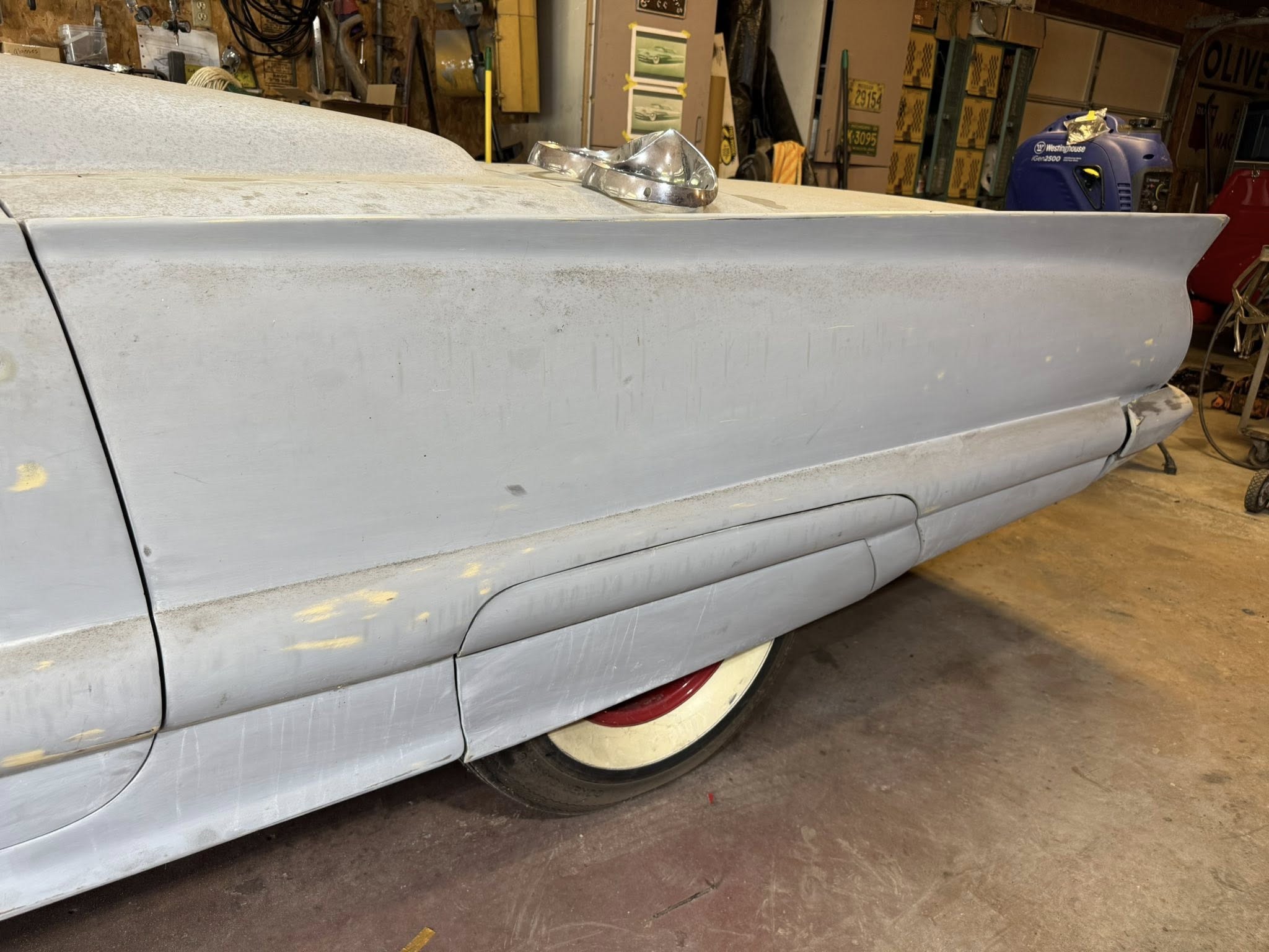

    Good looking car. Drivers side rear skirt appears a little low, body lines lines mismatch

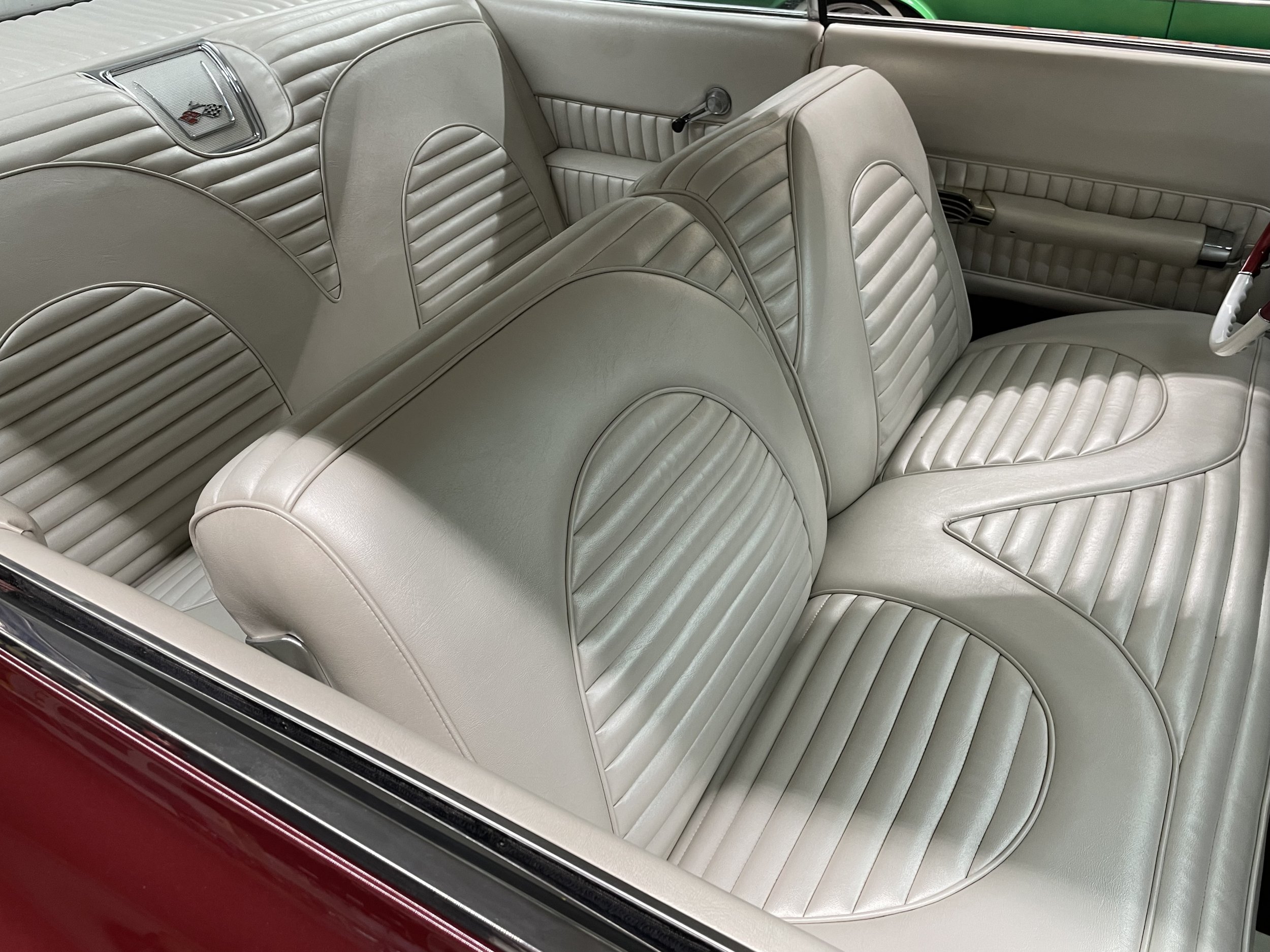

  23. Moriarity
    Joined: Apr 11, 2001
    Posts: 41,110
    Moriarity
    SUPER MODERATOR
    I’ll vote for the all pearl white interior….

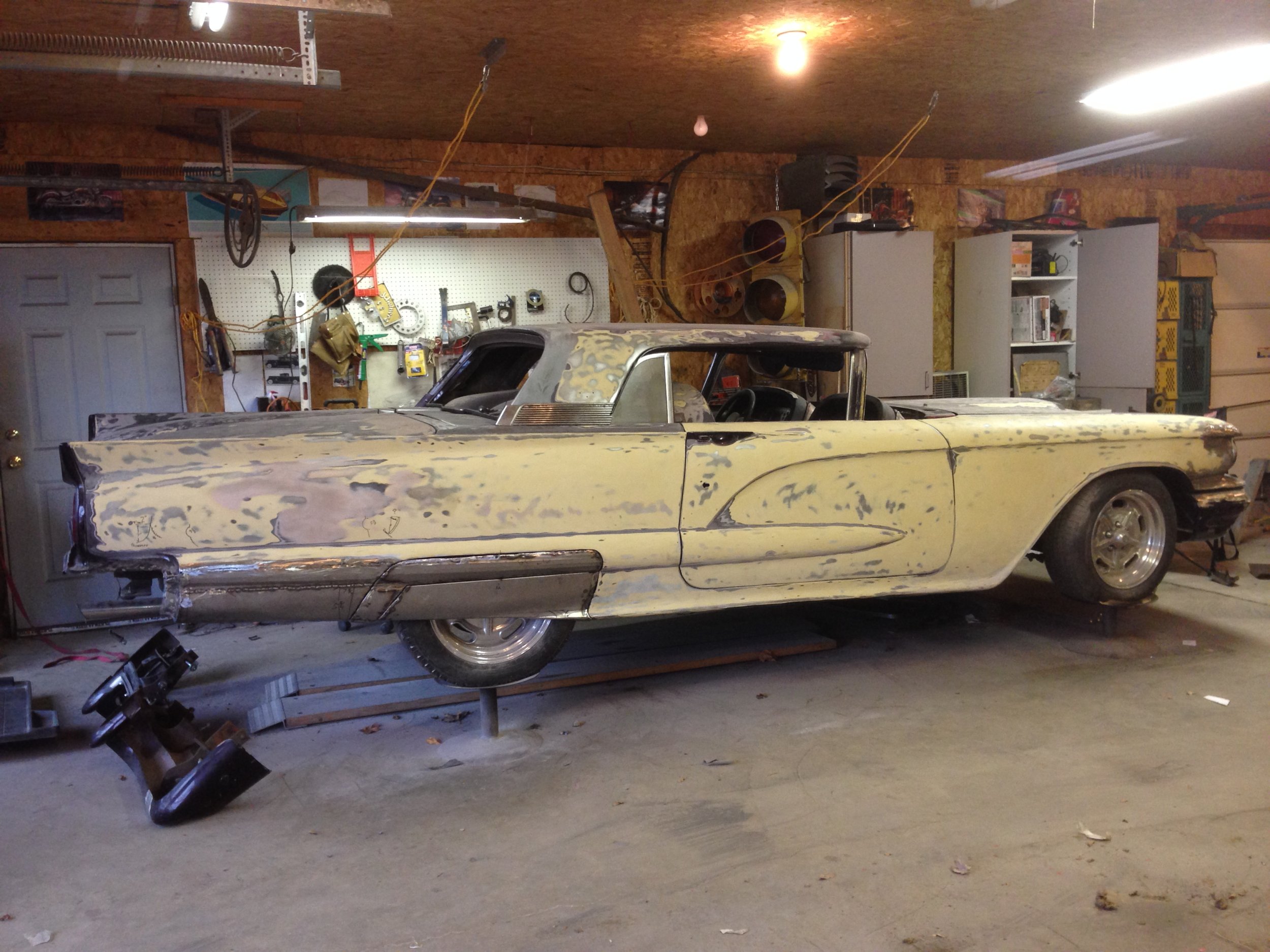

  26. flynbrian48
    Joined: Mar 10, 2008
    Posts: 8,790
    flynbrian48

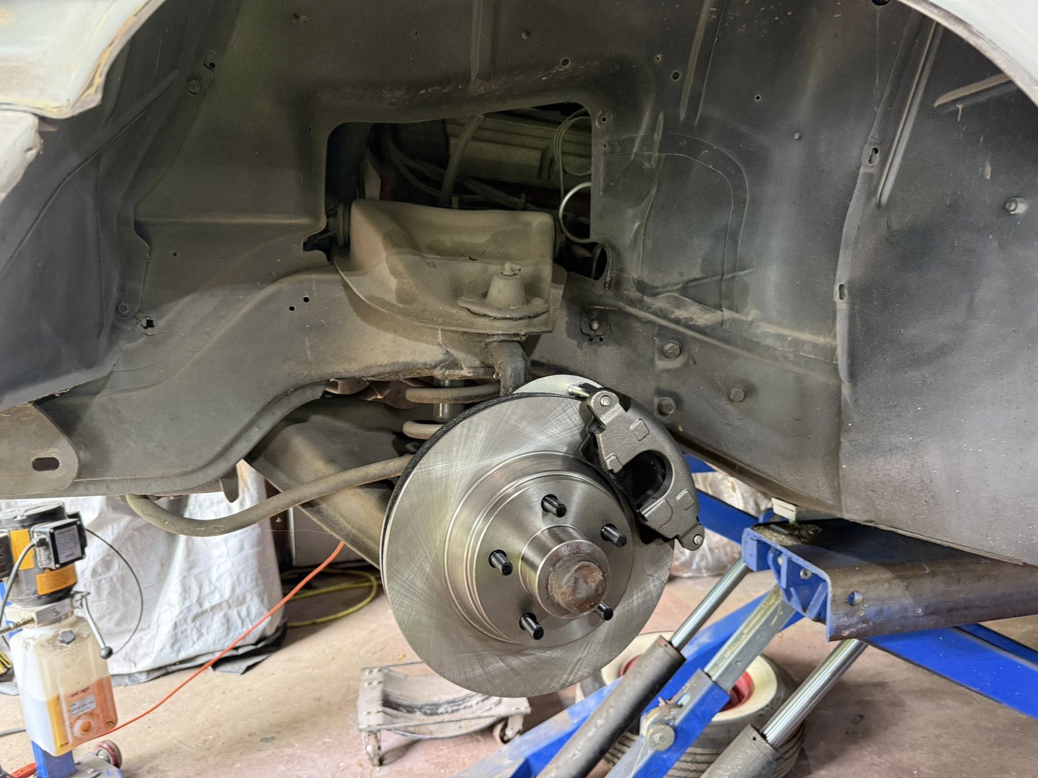

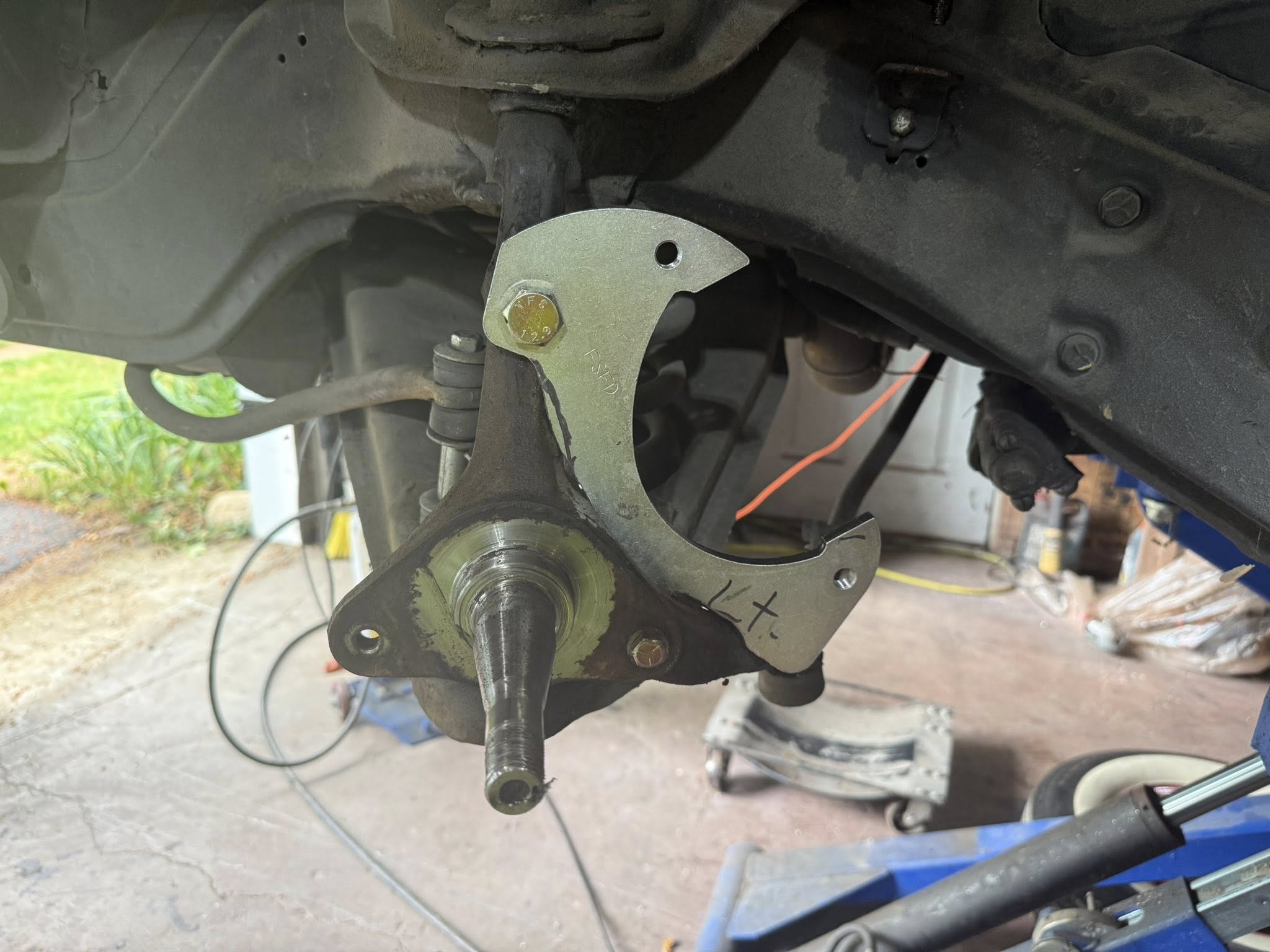

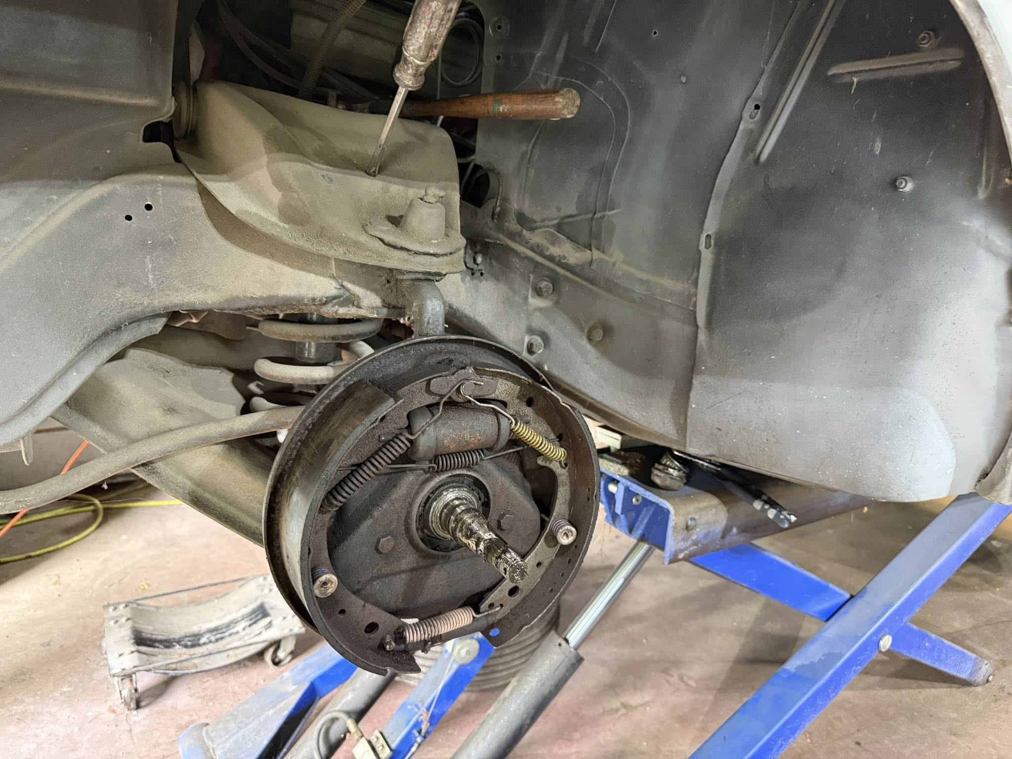

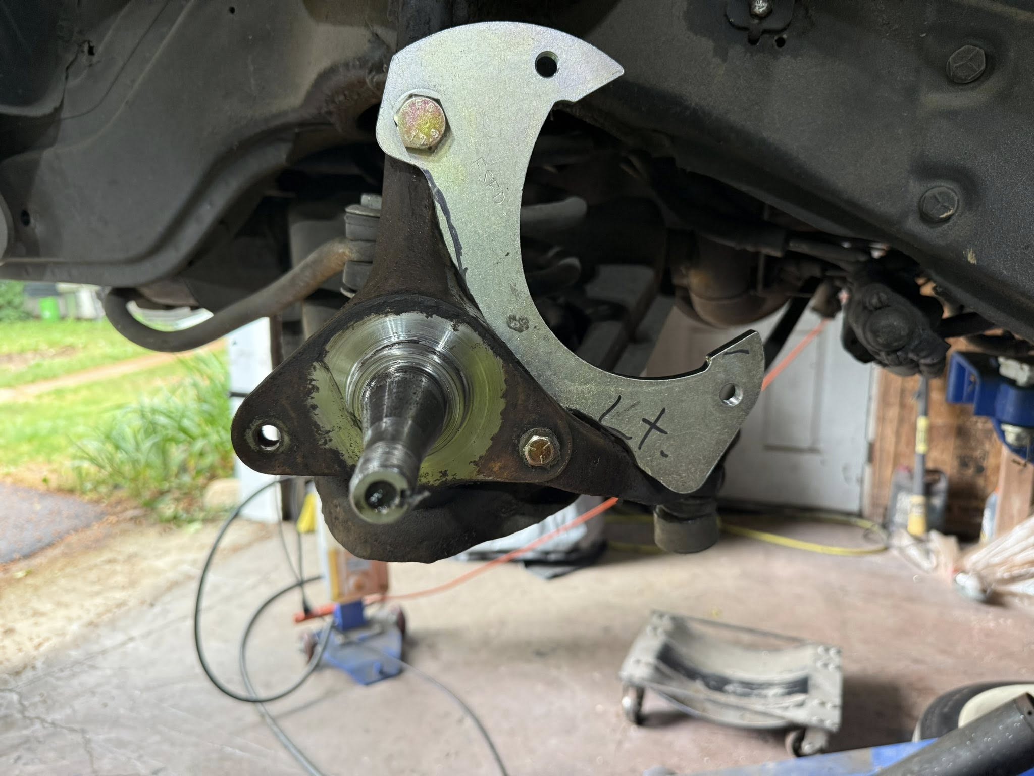

    2DA01DC7-3AD2-473C-A7E8-427679489153.jpeg 5613A44E-D70E-44DF-AB2B-E37E13F1D39D.jpeg 8A6F15CD-A475-405C-9FC7-56A8C556E853.jpeg 4B3C8F69-AB35-4871-B738-0996BEC38058.jpeg 47E2CB6B-E7BC-4479-89DE-74EDBD0BACE4.jpeg 2D0F7C5B-1295-459C-B1B9-4796EF00347E.jpeg 7CDCD180-95A4-43DE-B810-0F2D5F61D6D1.jpeg Put a big "DONE" stamp on the front brakes. I ordered a kit from Speedway Tuesday night, on the doorstep at 0800 this morning. Straightforward install, as the instructions noted I had to grind a relief on the caliper brackets to clear the spindle and steering arm, and the left rotor kissed the steering arm with the spindle nut torqued. Clearanced the arm with the grinder, all good. Now I have run brake lines and bleed them.
    The 14" wheels didn't clear the calipers, so the Salt Flats are back on.
    Sharpone, rockable, ffr1222k and 14 others like this.
  27. flynbrian48
    Posts: 8,790
    flynbrian48
    Oh Man! I'm gonna have to have a talk with the guy that made those damned things! He's a complete hack! Maybe I'll just have to sell it now since you noticed that, I can't live with it now. :rolleyes: On second thought, it looks OK from this angle, so maybe I'll just have to keep it off the lift so you can't see it from below...
