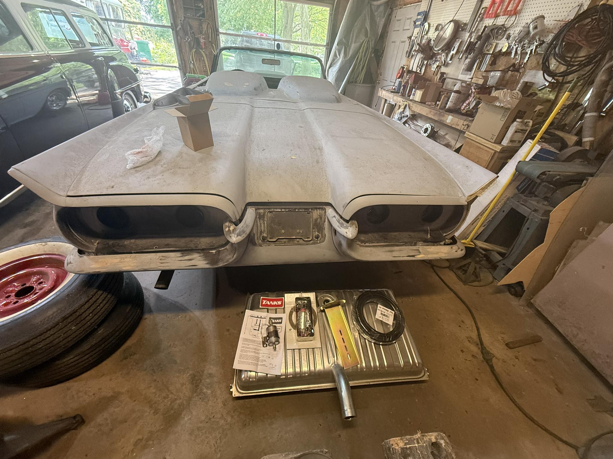

    The windshield gasket finally arrived, so I can get the w/s back in. May seem like a small step, but one that will be a big inspiration to continue. Tomorrow I hope to get the gas tank in and plumbed, and we'll see if the 302 will still run...
  14. flynbrian48
    Joined: Mar 10, 2008
    Posts: 8,785
    flynbrian48

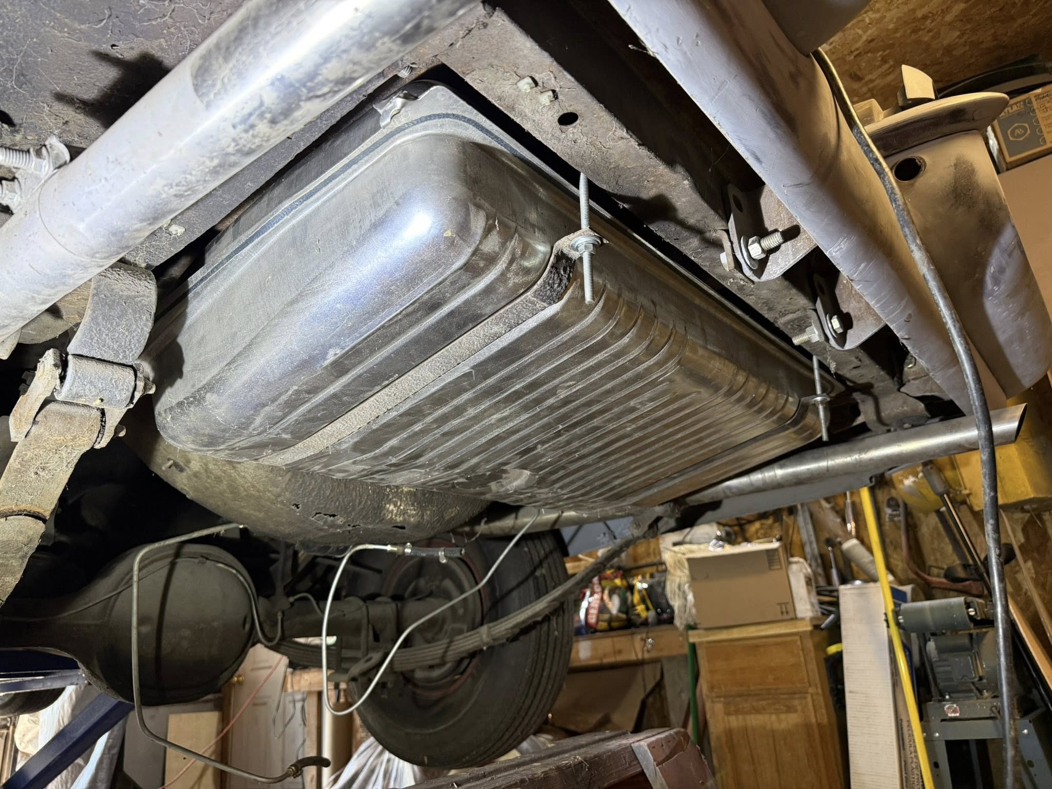

    Got lots done today. The new gas tank is back in, lines plumbed and pump replaced. I had put the "J" bolts that hold the tanks straps somewhere safe. So safe I couldn't find them so I made some from a stick of All-thread. I also had some new straps somewhere, but those too were AWOL, the old ones weren't rusted so they went back on. I did a quick clean up of the trunk, swept up the cherry pits and walnuts mice had dragged and wiped the dust off the trim panels just for some inspiration. When I (finally) got the trunk lid to open (the contacts for the release switch must have been corroded 'cause it took about a dozen tries for the lid to pop open), I discovered the 80's era Mustang stereo and booster, with a Chris Issac tape still in it! Just for fun, I plugged it in to the wiring harness, and, like the trunk release, after a few times pushing the tape in, hitting the "Reverse" and "Forward" ****ons, it still works. I'm going to replace it with a hidden Bluetooth unit, but that c***ette (and a ZZ Top one) were what I listened to while building it 30 years ago. AEB4D340-3952-4712-AC87-7476D7ABE167.jpeg 156C4FDE-DD36-40BC-BE5F-9DFCD23EE20D.jpeg

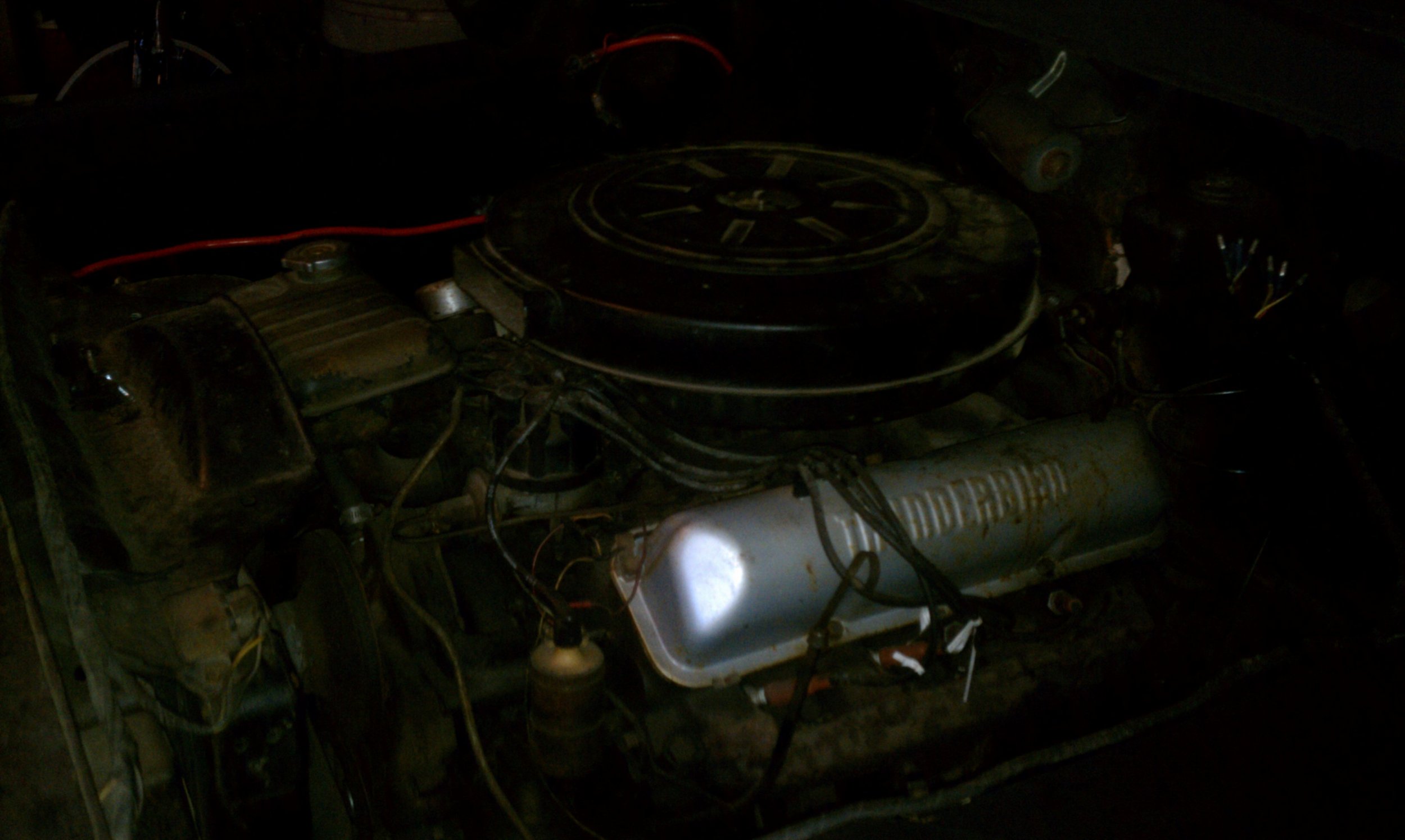

    Perish the thought. Although, I admit to thinking about it. I like the idea of having cars with engines from the parent company, although I stray from that pretty often. I'm not averse to modern engines and fuel delivery, but I didn't want to reinvent the wheel with this, and I didn't want to further complicate the (re)build. It's been long enough.
    It's funny you ask about the engine, some guy on that Face-Page spent 3 paragraphs chastising me for not putting an FE back in it, and lectured me on the power to weight ratio. He was cranked up about the small block Ford, which, in truth is rather shy on bottom end torque for the car, but it's a comfortable cruiser. I have fast cars, this isn't one but it didn't hold up traffic either. I pointed out that Ford put 289's in Galaxies and 240 sixes in base model full size cars, so they weren't all stop light terrors.

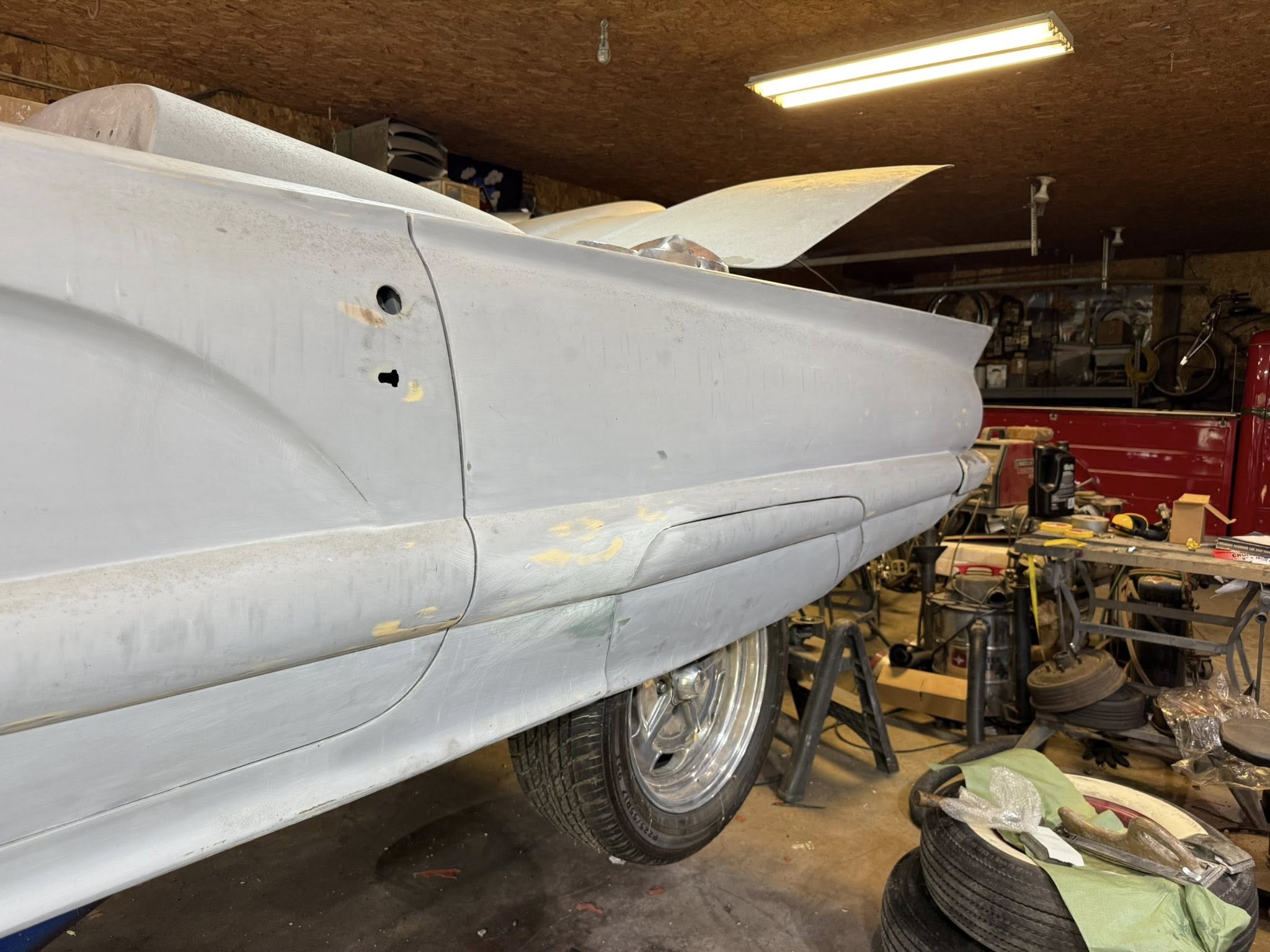

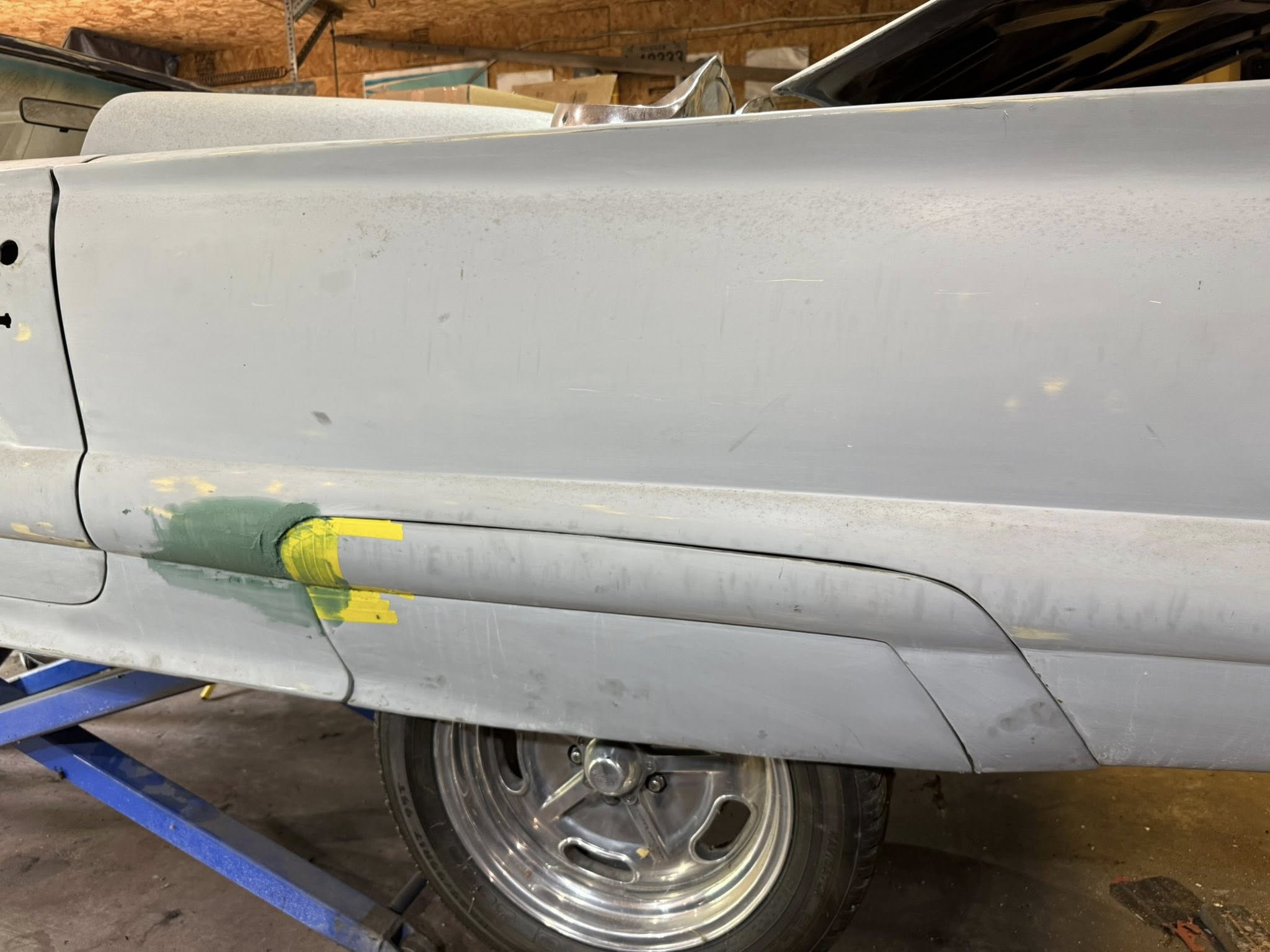

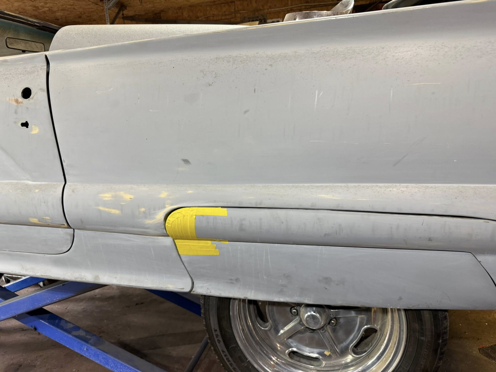

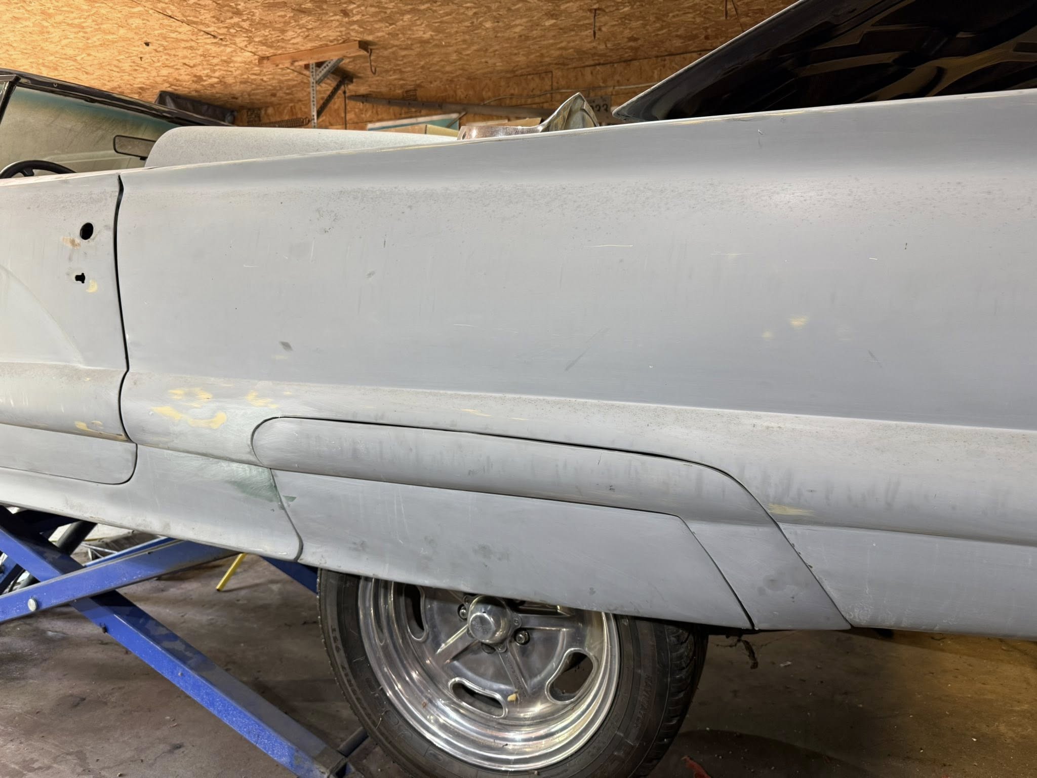

    Someone pointed out (Amishmike?) that the left skirt looked too low, the body lines didn't match. I don't react well to unsolicited criticism, but looking at it on the lift, in the harsh light of day, he wasn't wrong. I was a bit *****ish in my overly sarcastic reply to him. So, I fixed the fit, and I hope I can fix the rudeness..
    First, the lower half of the skirt (they're in 2 pieces) wasn't fastened tightly to the upper, which made it drop about 1/4" below the character line. Secondly, the shape of the skirt at the top, didn't quite fit the wheel opening. I tightened 967A38E1-088F-4136-88B2-CE5ED371488D.jpeg 2144B22C-78BB-43CC-8BE7-910B36F4B476.jpeg 4E445B53-F742-4576-9D38-28BC8EFA6F32.jpeg 21328EB5-15C9-4F6E-93CB-7F2A4E4519BD.jpeg up the two halves, which helped, but made the fit at the top look even worse.
    I used a tiny bit of gl*** reinforced filler to tighten up the gap, using the (masked off skirt) as a mold.
    Much better, and, I'm sorry I was such a **** in my response to Mike...

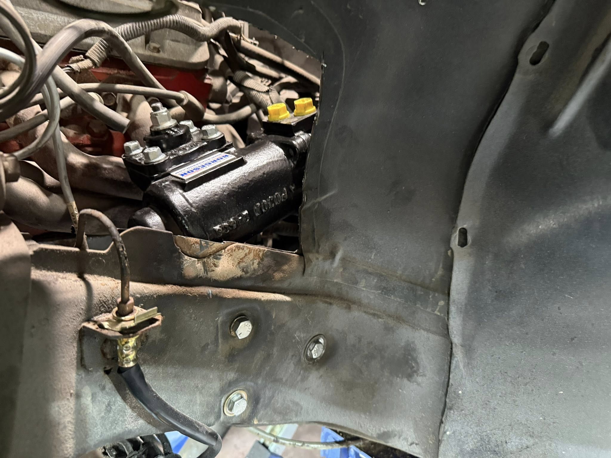

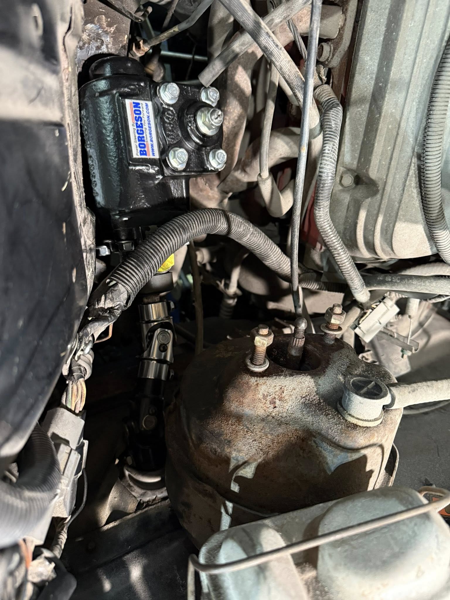

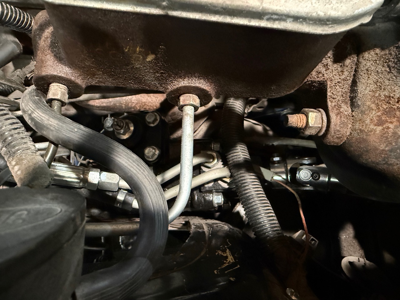

    I finished up (well, almost finished, the hoses sent with the Borgeson box were for a Chevy ps pump, so the correct ones are on the way) the Borgeson power steering box in the T'bird. It was a difficult job, as the forward end of the box hit the frame, not letting it drop down enough to get the bolts through. I ended up heating the top of the frame and dimpling it (tough when there's no room to swing hammer) and clearanced the end of the box a tiny bit.
    Having the lift was a lifesaver for this job, I had the thing up and down at least a couple dozen times. I swiped the U-joint I'd ordered for the DeSoto steering column swap, which isn't here yet so it's OK. I'd forgotten the steering column in the 'bird is a double D, not splined, end, so it's all together.
    Once I get the hoses I can get a battery in it and get the car started with it's new fuel tank, pump and lines. It's been a long time... 68374F17-E646-4994-88FD-B076C9DA3B6F.jpeg D993FA06-CD57-4364-91FC-987C010D2101.jpeg

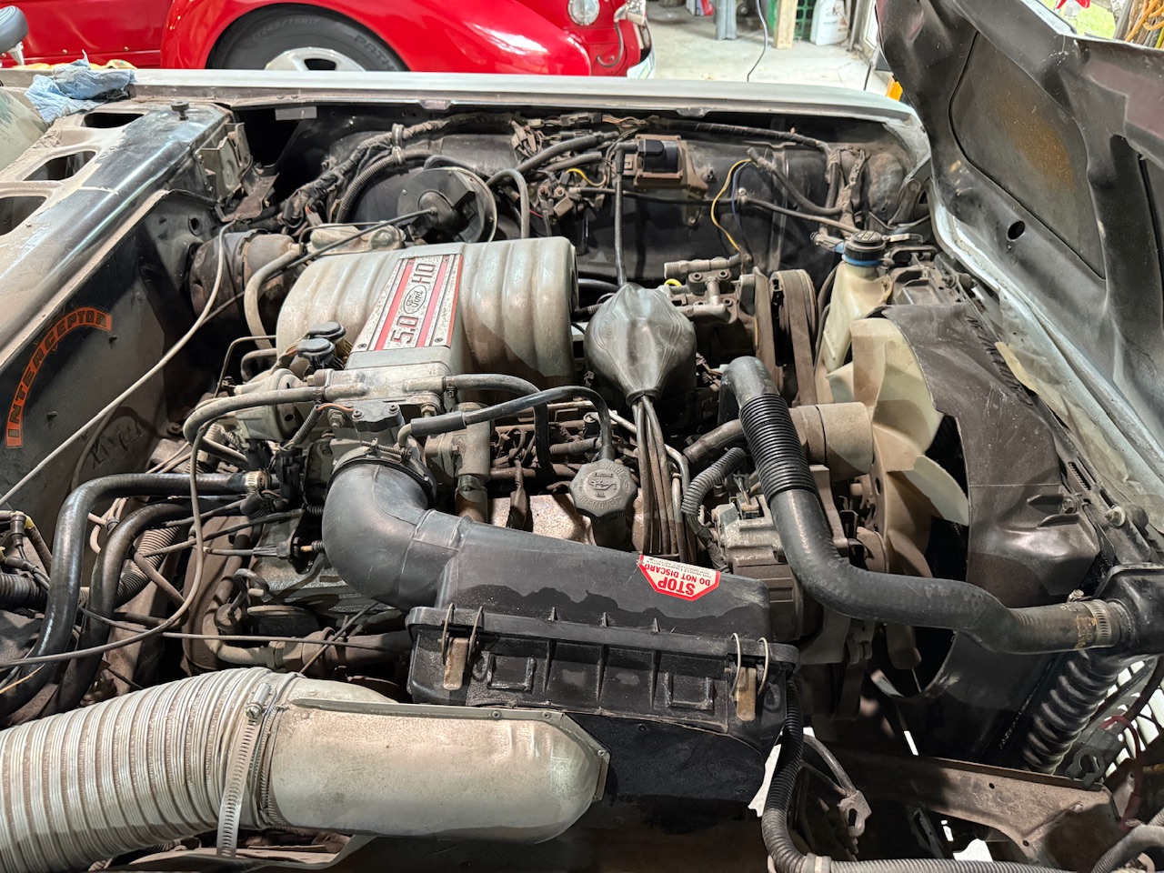

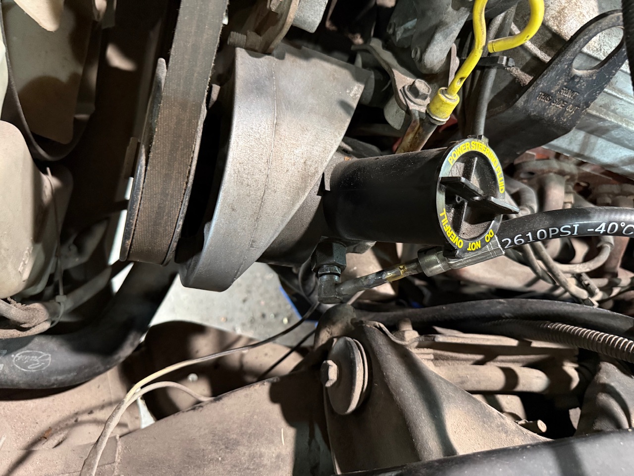

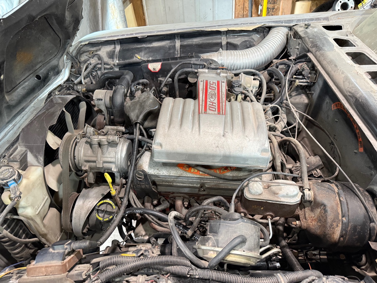

    After a couple weeks hiatus, I tackled the power steering hose dilemma. I had called Borgeson to get the proper hoses for the ‘87 Ford HO 5.0, but the high pressure hose fitting onto the pump is an odd looking male with an O ring, not flare fittings as on the hoses they sent. so today I cut the end off the new hose, cut the fitting off the OG Mustang hose, used a little piece of 1/4” brake line for a union and brazed them together.
    Perfect.
    Next project is setting the windshield and then seeing if the thing still runs. I’m thinking it may need a new set of injectors, but I’ll try it first. IMG_3998.jpeg IMG_3997.jpeg IMG_3999.jpeg IMG_4001.jpeg
