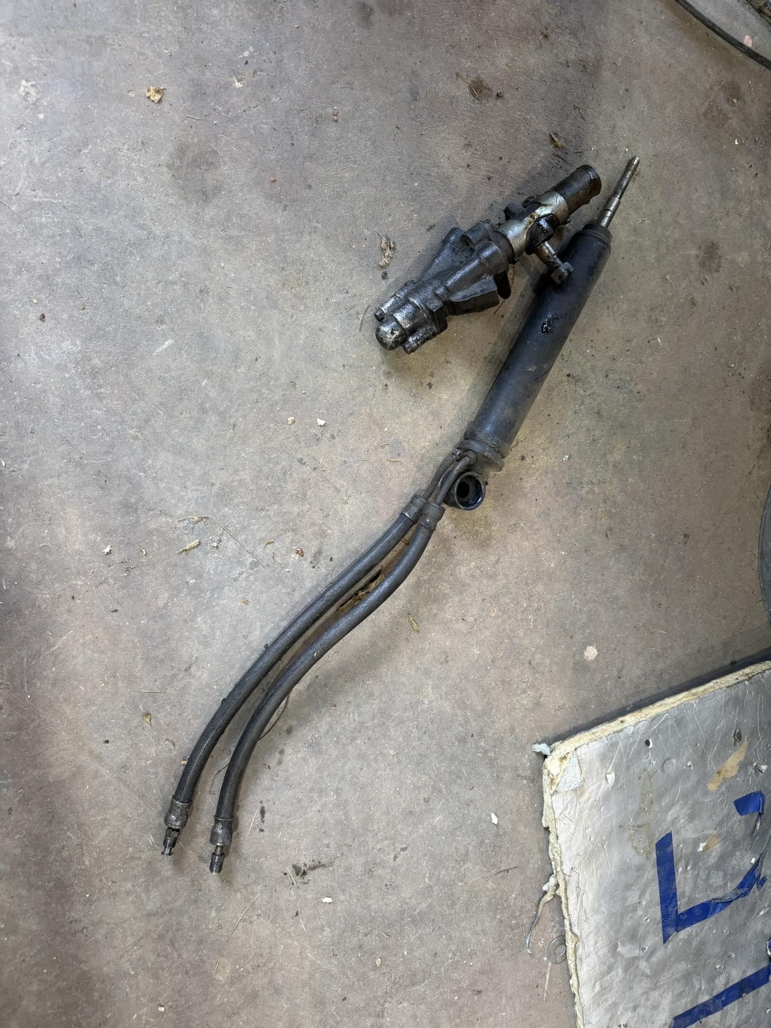

    Here's the last of the stock steering junk headed for the s**** pile. I'm happy to be rid of this, have a non-power steering link for the center link coming from Ekler's. E84CDE5C-431F-4B3A-B8D5-97568BB080BC.jpeg

    Check for a rebuilder. That may be gold to them. I'm no fan, but they aren't making them any more!

    The valve is a rebuilder I installed years ago, with very little use as I quit driving the car shortly after. I could offer it to someone, but I’d rather not deal with people.

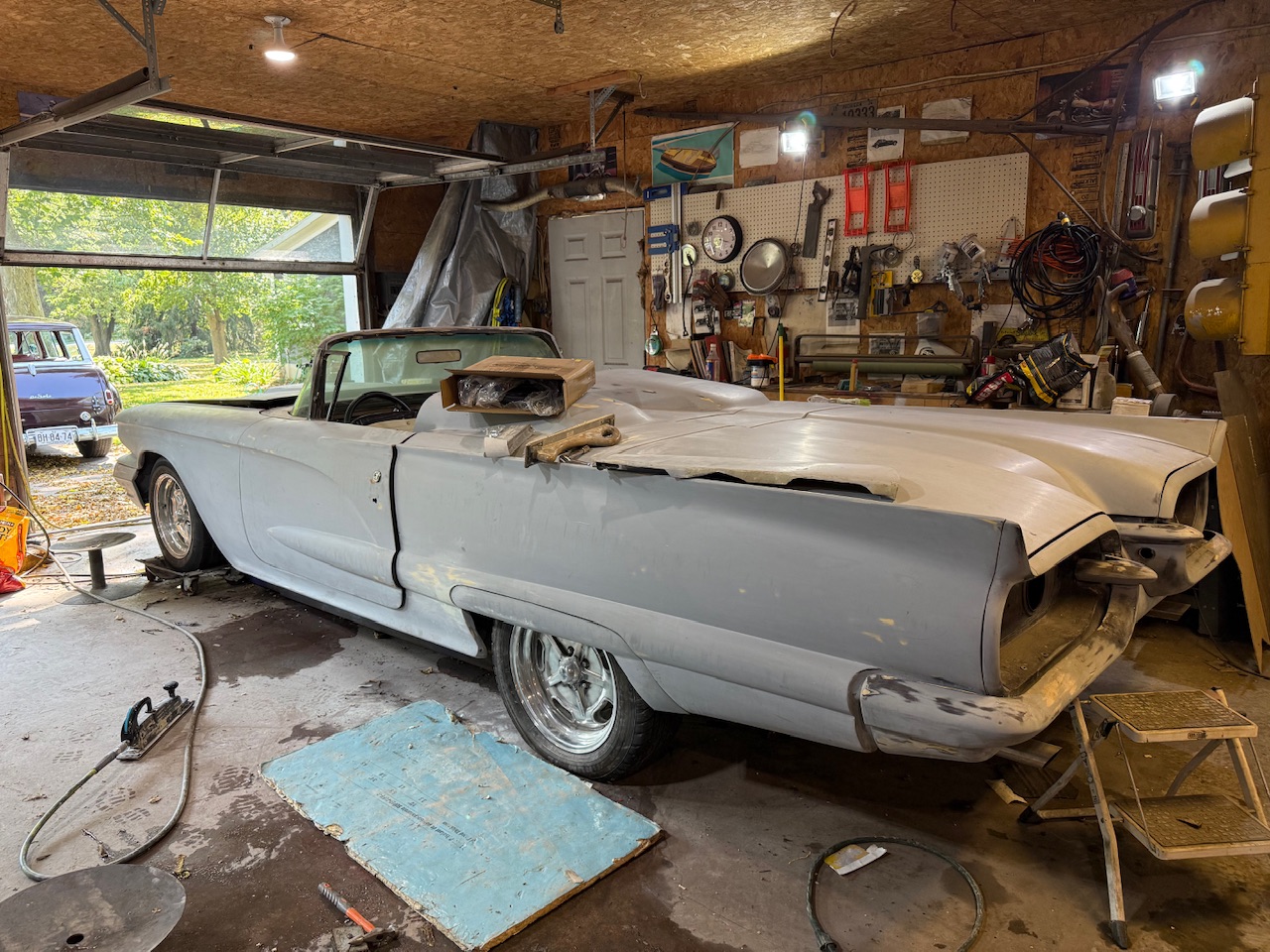

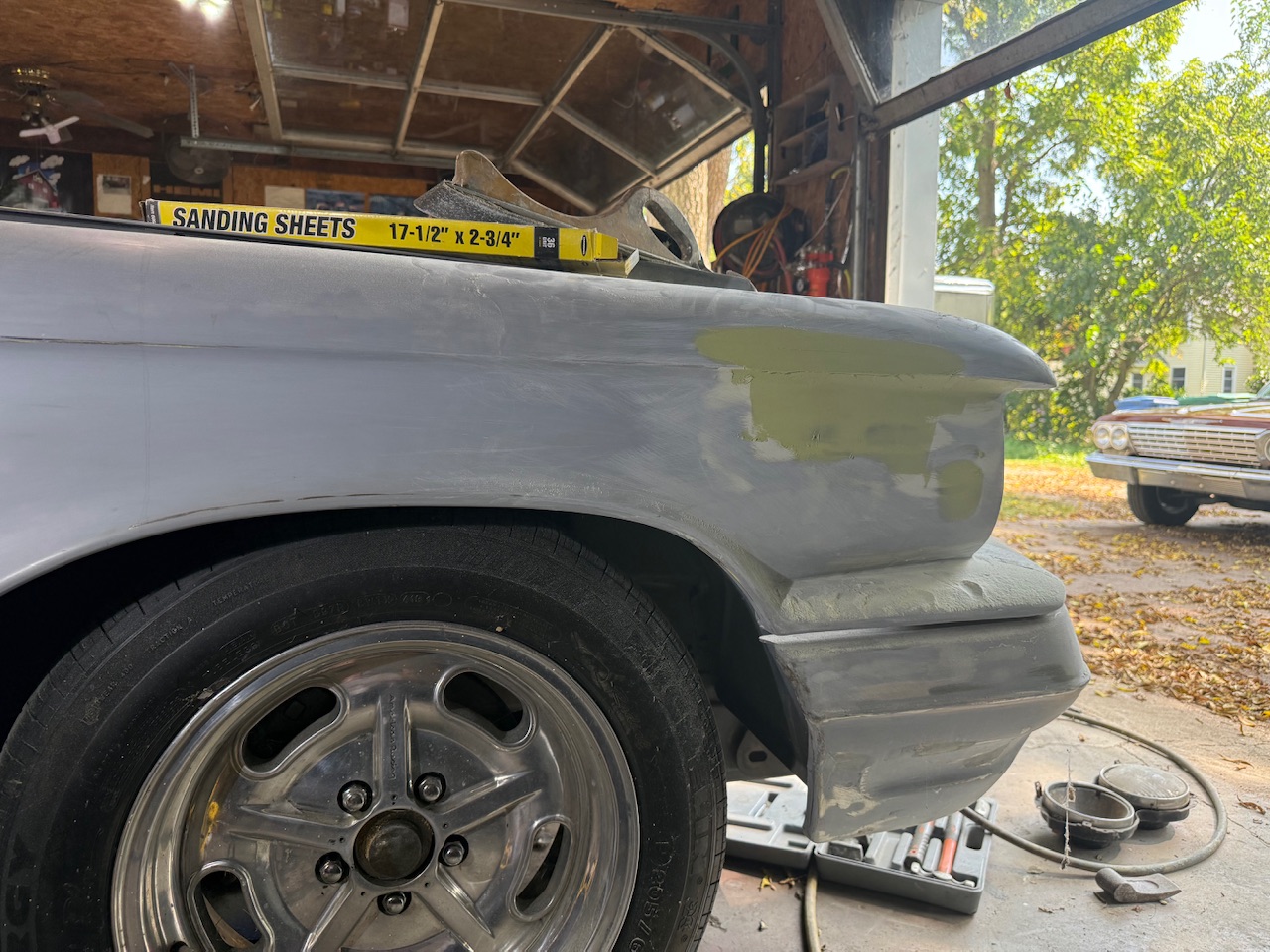

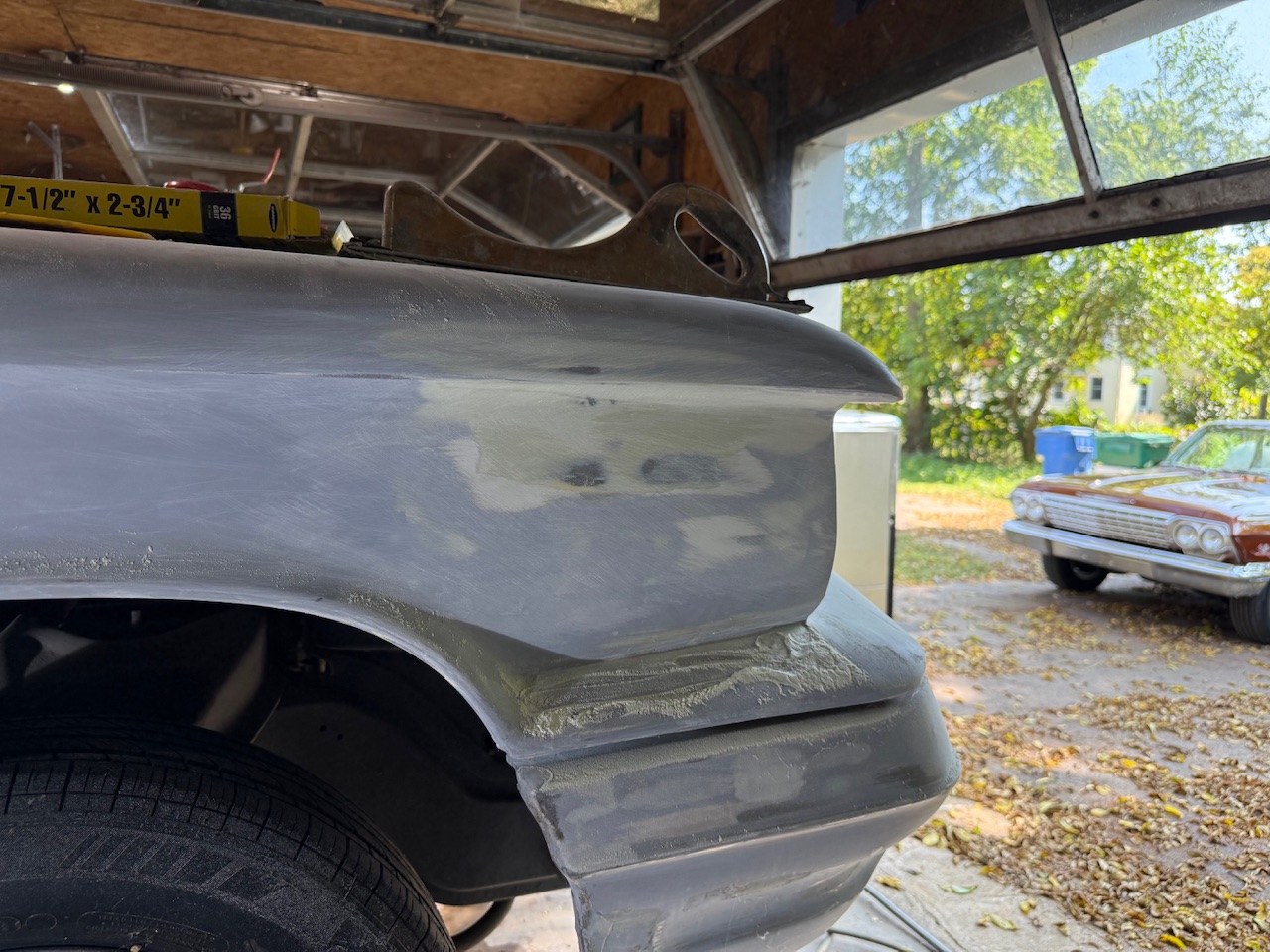

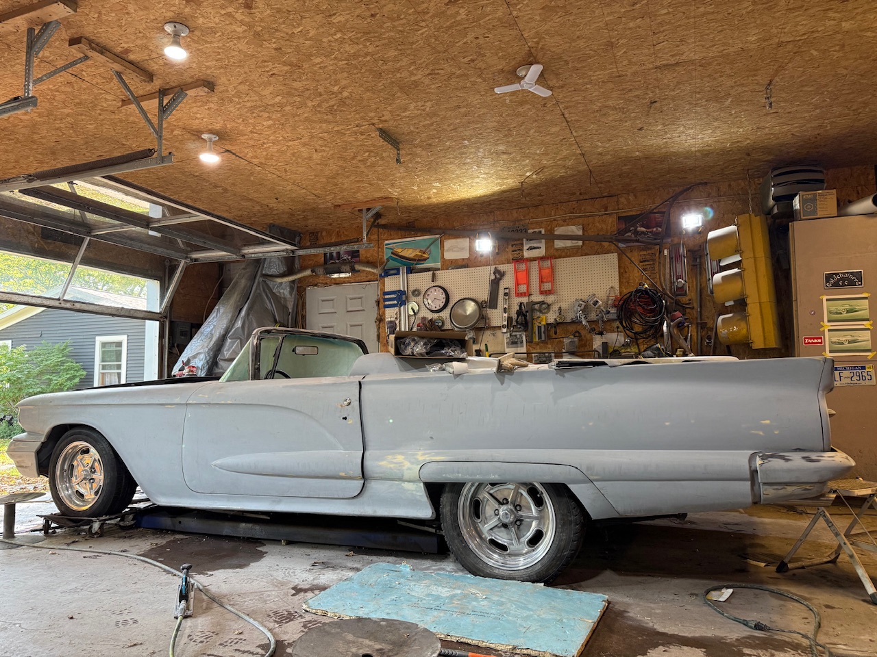

    I worked on the left front fender where it had a knot from welding the new section in to fit the ‘63 Caddy headlight bezels, and then finished up the (roughed in) work on the driver’s wheel opening. I won’t be able to drive it the full skirts with the Salt Flats wheels, and I’d never had just the upper section of the skirts on, so I tried thiss one on .

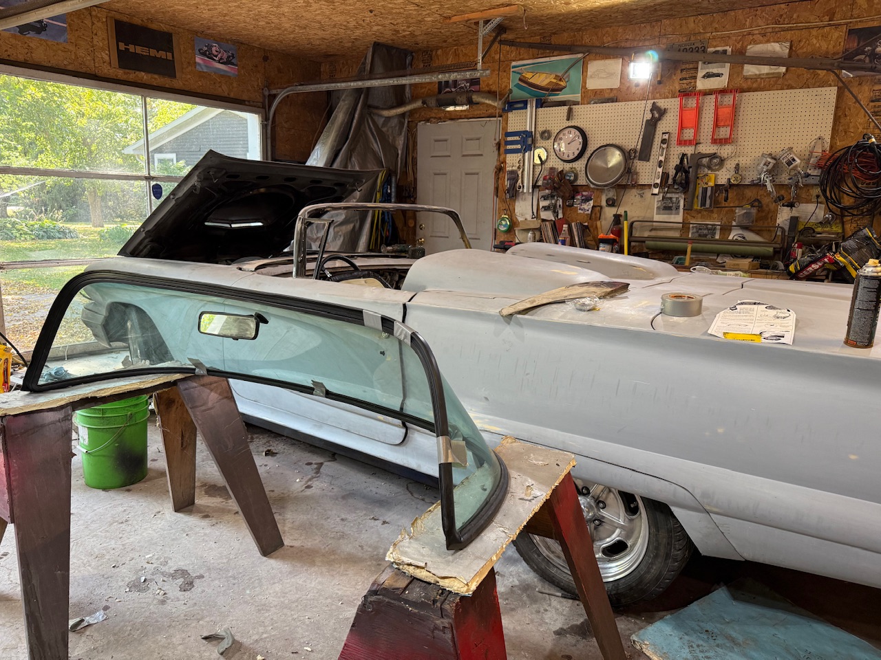

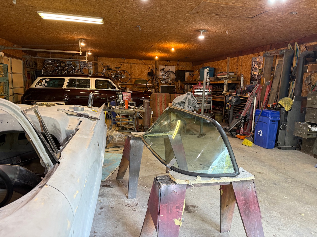

    Brakes bled, windshield ready to go in. I’m going to need hand with that… IMG_4116.jpeg IMG_4117.jpeg

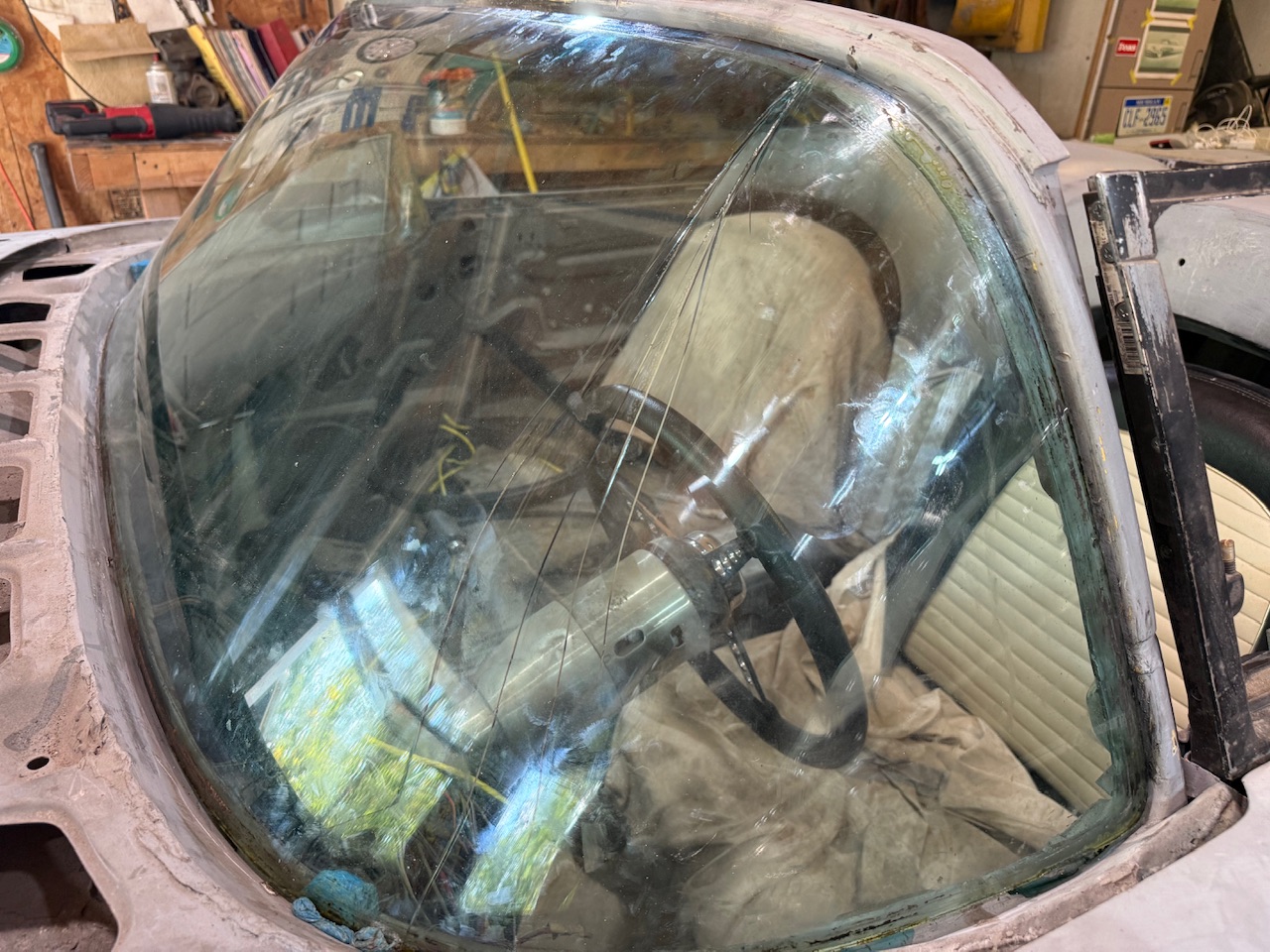

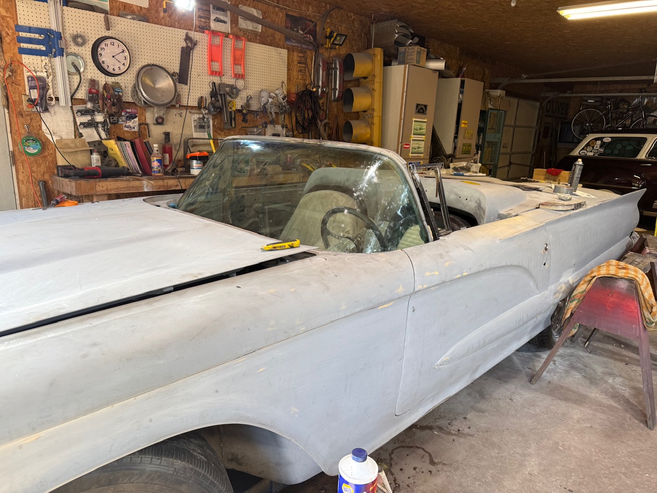

    Well, ****. I was going to set windshield today, my wife helped me set the gl*** in the body with the rubber on. The fly in the ointment is that with the w/s frame sunk into the body like I did it, I have a trough that is too narrow at the bottom to accommodate the very bulky gasket. I tried t******* some of the (cosmetic) lip off the bottom and tried setting it again. I thought it was going to slide in, but with putting a tiny bit of pressure on the gl*** at the top it cracked in the corner.
    So, plan B is getting a new w/s which I’m going to glue in. Not the way I want to do it, but it’ll work.
