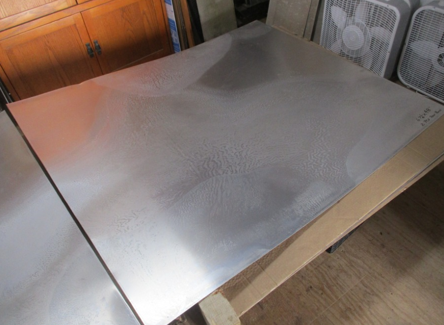

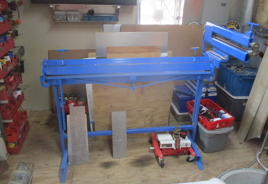

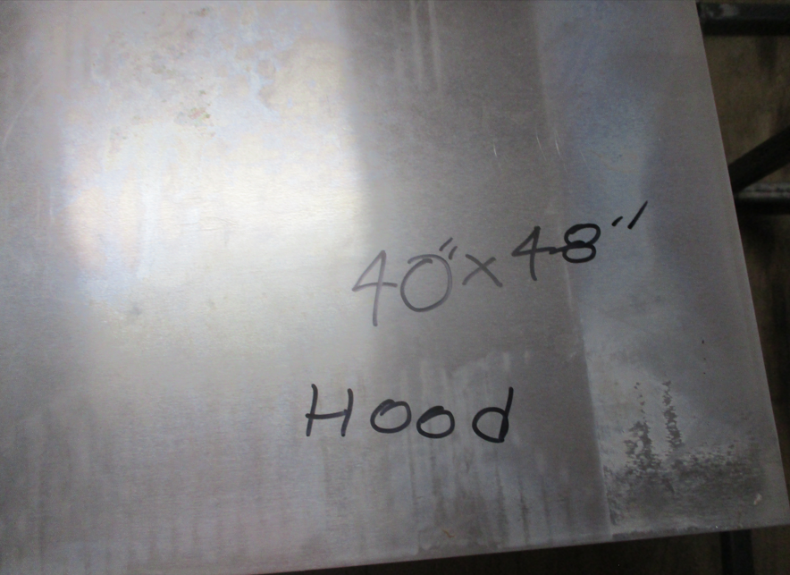

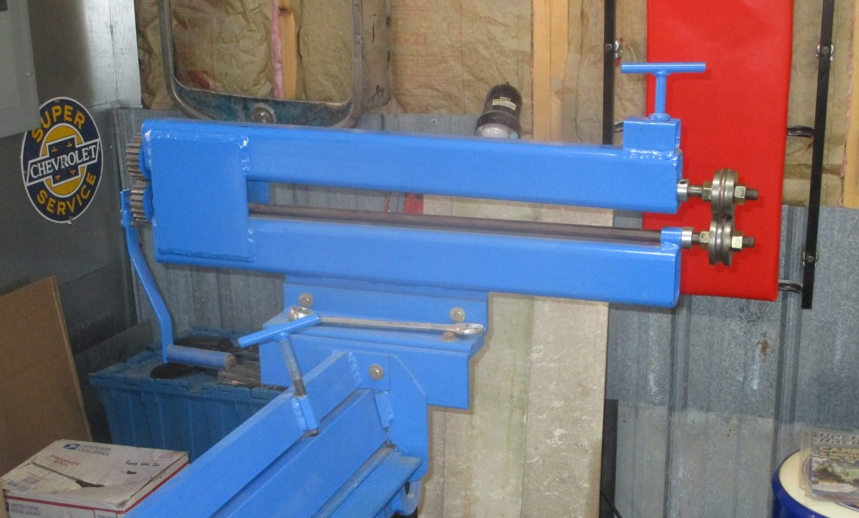

  2. I started cutting the aluminum for the racecar interior today, it looks like my brake and bead roller are going to get a workout!

  11. Building a racecar hood was on the agenda today.
    I was thinking light weight cardboard...
    ..but decided against it.
    Started by hemming the edges
    Front view, still needs a little work
    Left plenty of room on the sides for all those win stickers!
