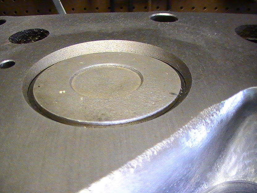

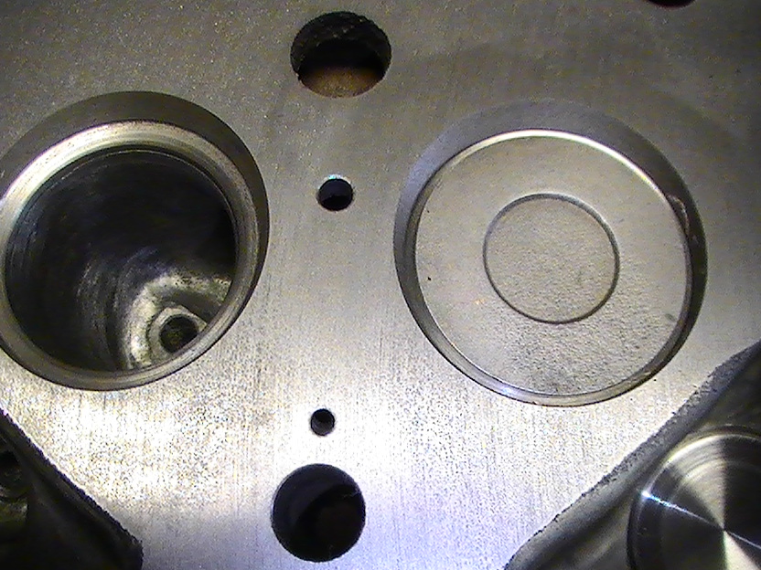

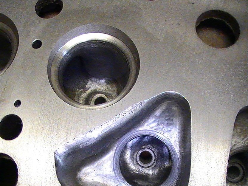

    Thought I would join and post some pictures if you don't mind. I do tend to take more than a few pictures though. I cc'd the chamber and it ended up being 74.7cc after the .052 surface. I will officially call 75cc's. PIC_2461.JPG PIC_2462.JPG
  4. Looks good Tom.
    Everyone on the H.A.M.B. knew the cc before I did.:D

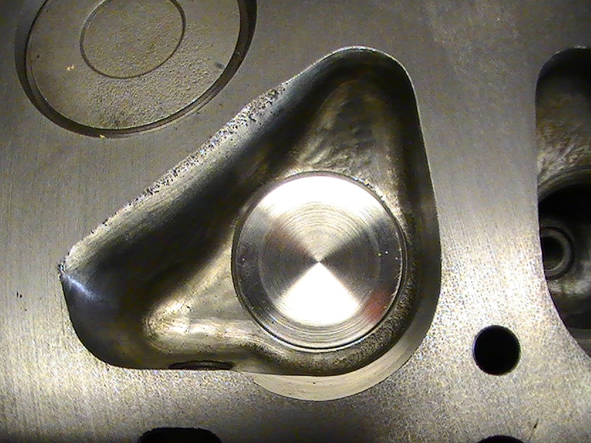

    Yeah the cc around the intake valve was 4.3 and the exhaust was 70.4.

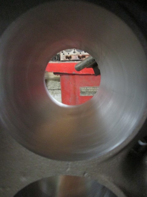

  6. The block punched .040-
    IMG_0887 (Small).JPG IMG_0888 (Small).JPG IMG_0890 (Small).JPG IMG_0889 (Small).JPG
    Next up dumby it up with cam to check deck height.
  7. Less than .0001" taper in the cylinder after bore and hone.

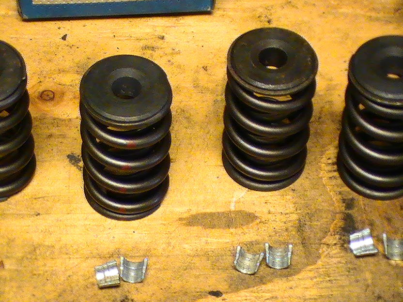

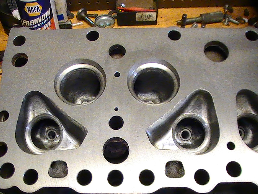

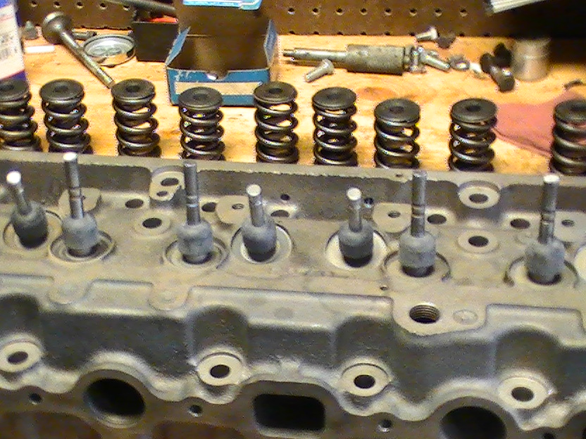

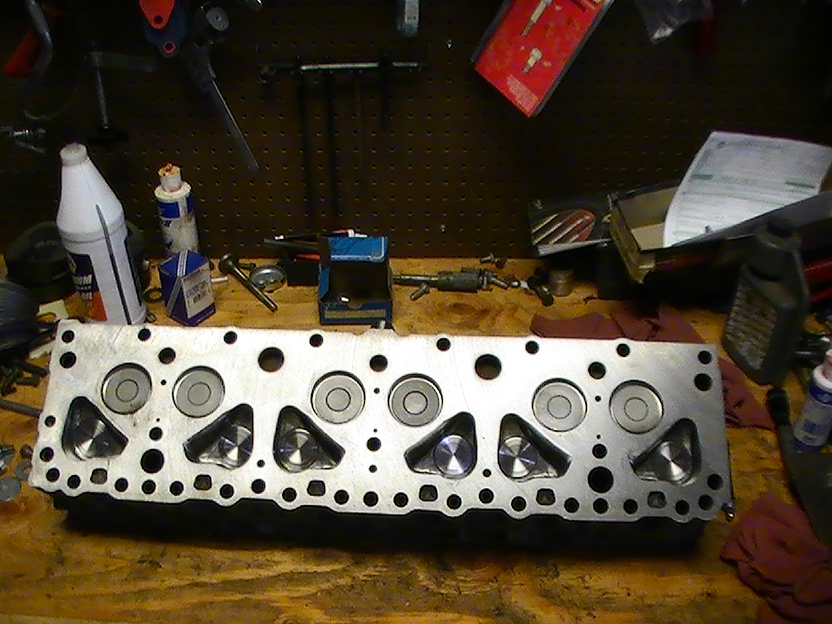

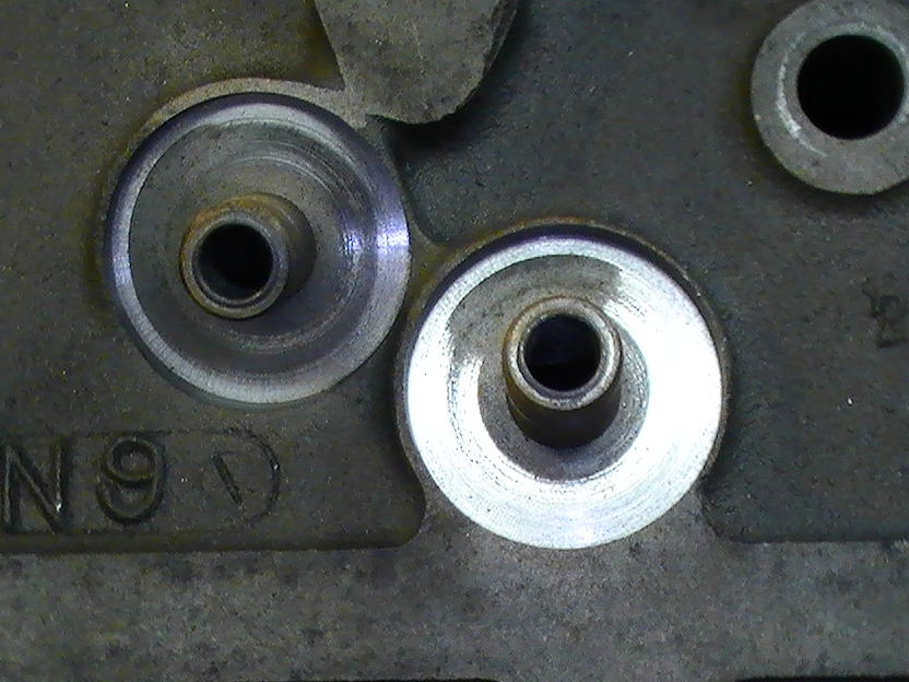

    Here are some more pictures of the head. Slightly larger O.D. springs at a taller ***embled height to get rid of the rotators or excessive shimming. You could possibly use the big block chevy rotator eliminators to get a shorter installed height spring which would open up the use of common sbc springs.

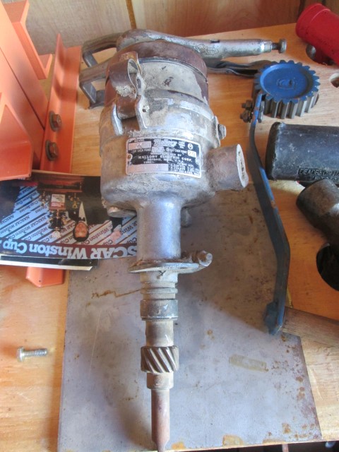

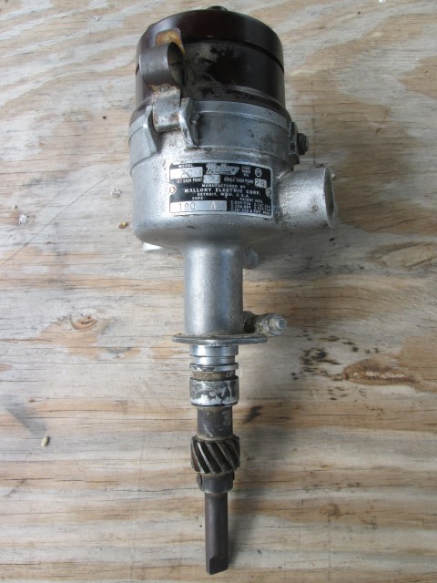

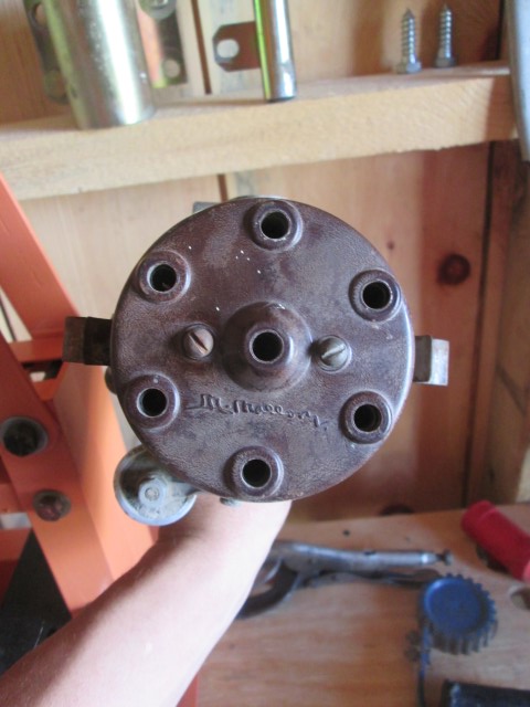

    I just picked this up from Joel Davis at Pikes Pike Motor Co.
    Mallory ZCM 180 for a Chevrolet six
    After a little cleaning, still needs more.
    I already had an N.O.S. cap in stock
