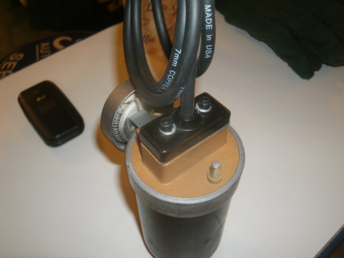

  4. I just found an old memory card with some photos I forgot about.
    Mallory Best coil-

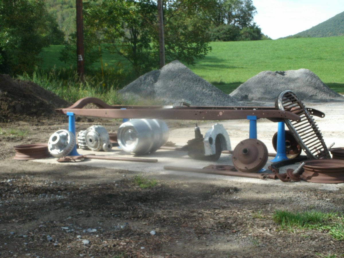

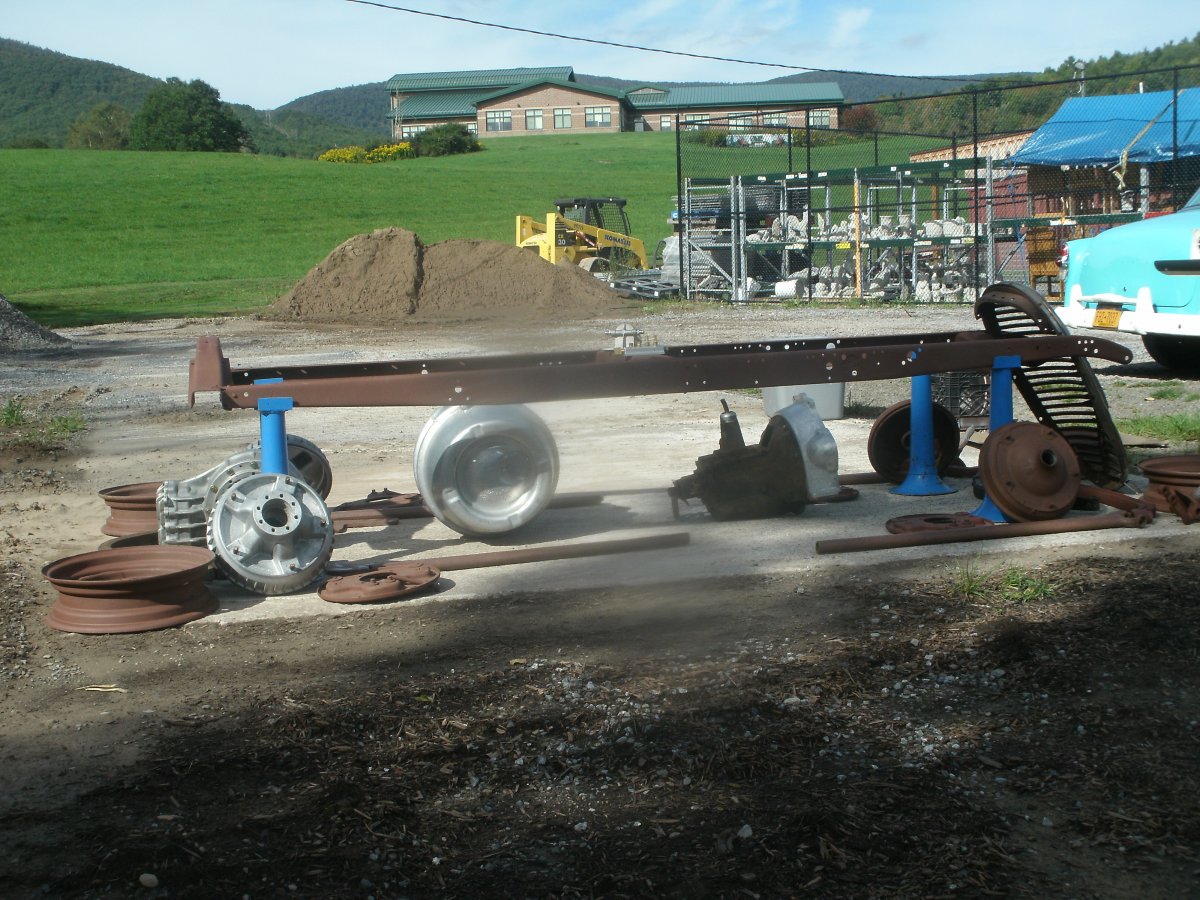

  15. I am still looking for shop space to do my frame.

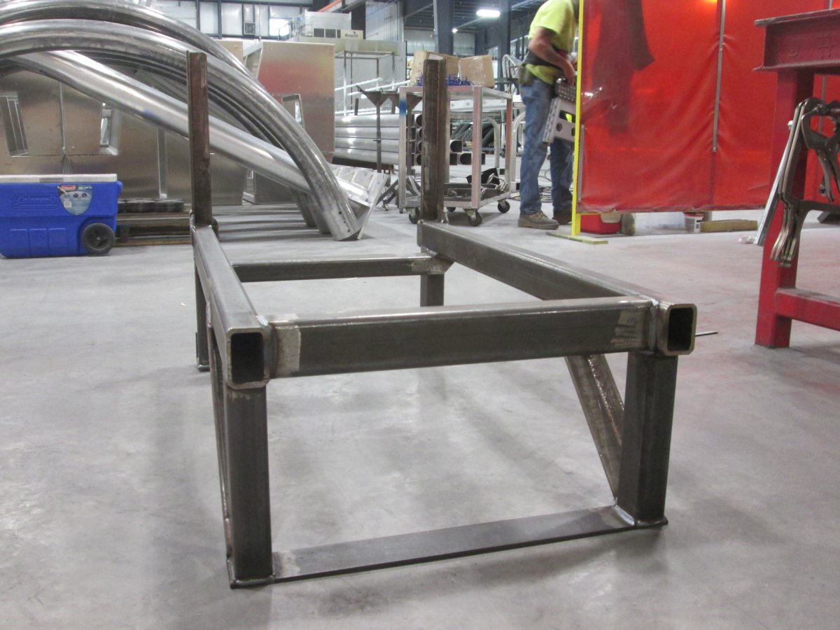

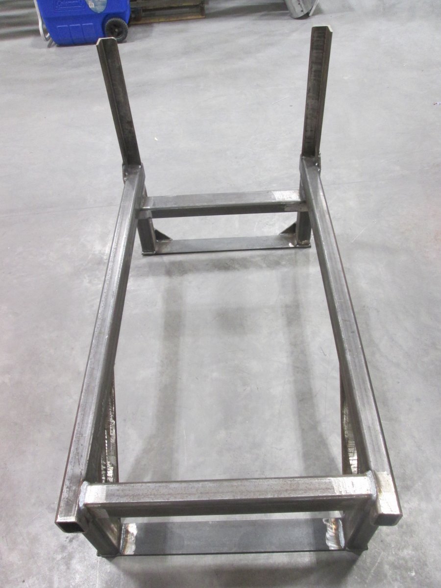

    My father and I fabricated a engine run in stand, for Chev. 6's.
    He cut the steel and I welded it at work.
    Engine mounts will be built soon.

    Looks great! Will it double as a frame jig? Sure looks strong enough.
  18. I am planing on it when I get a little further on it.
    I always say "Over build it once, and you never have to rebuild it."

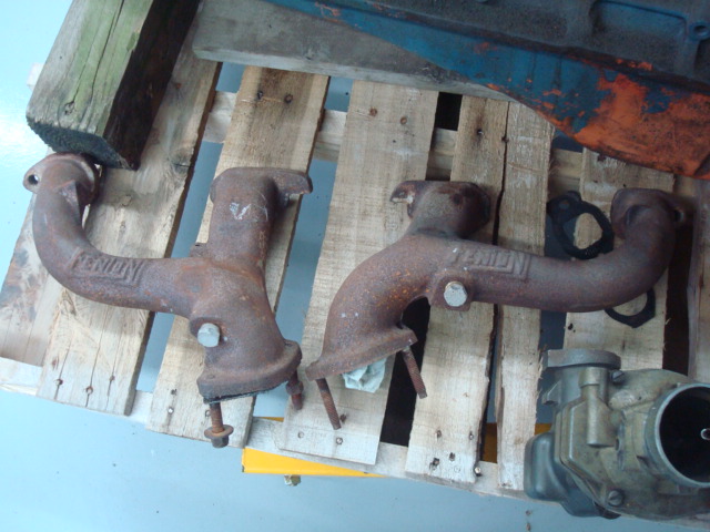

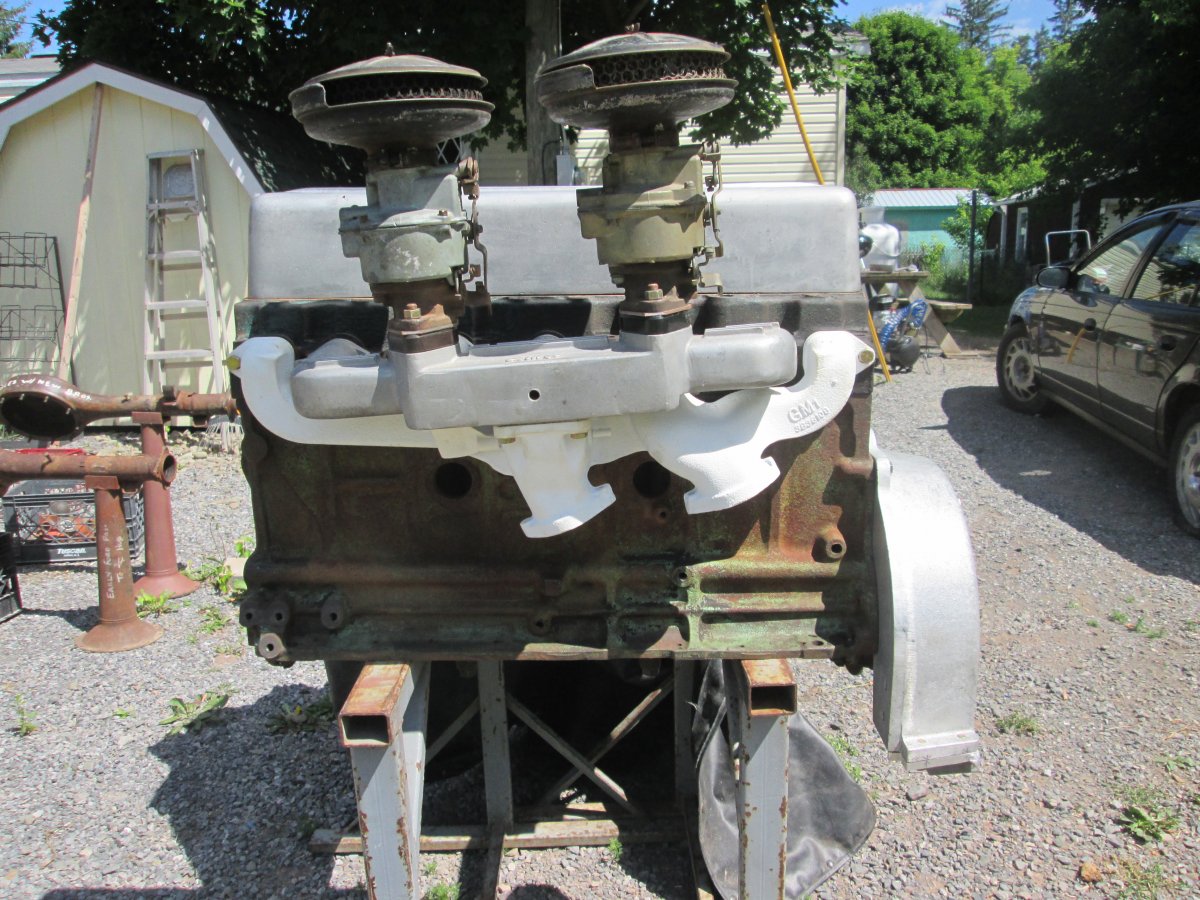

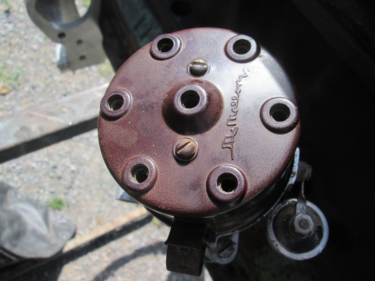

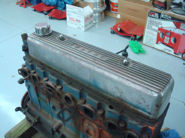

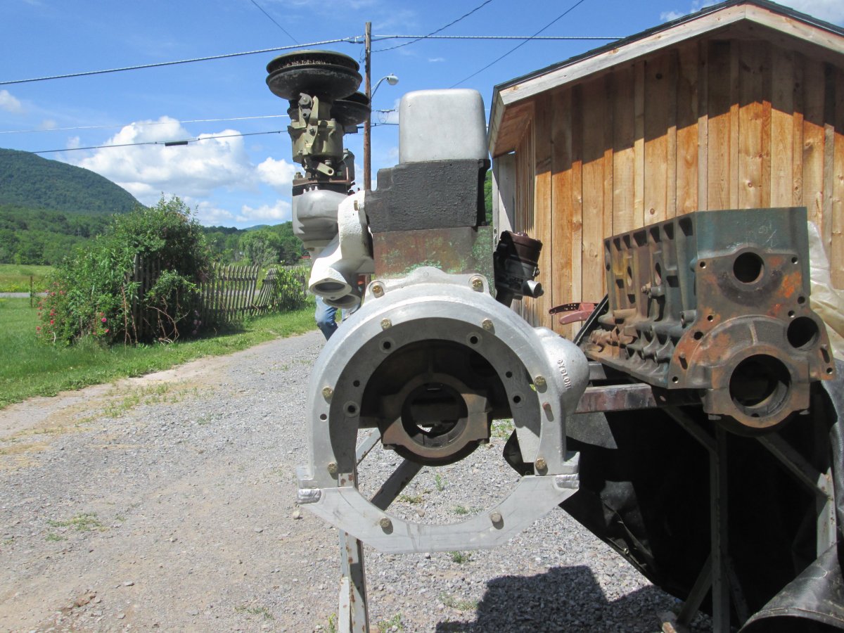

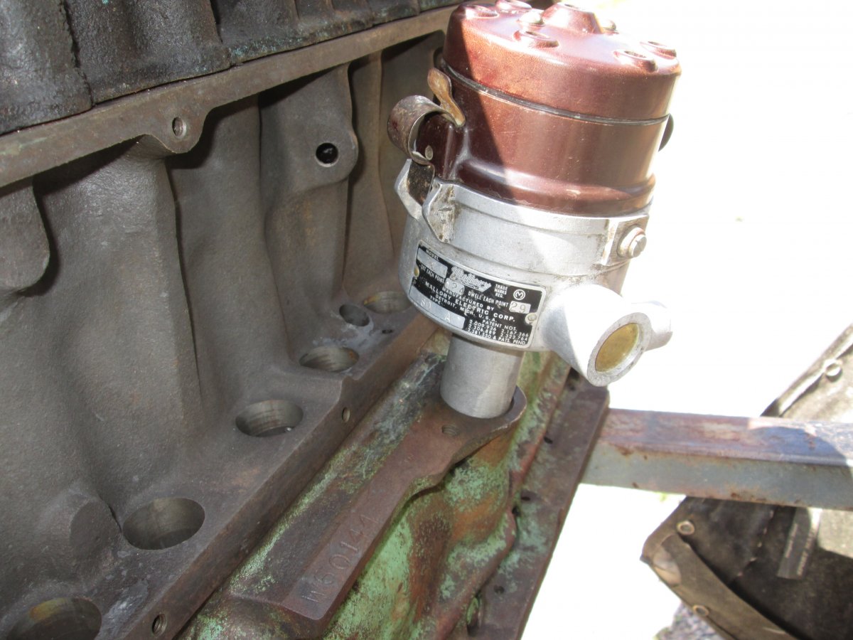

  19. I am sorting out my shed and realized I never had all my parts on an engine at the same time.
    This is not the 261 block or 848 head I will be running-
    IMG_0064.JPG IMG_0065.JPG IMG_0068.JPG IMG_0072.JPG IMG_0070.JPG IMG_0071.JPG IMG_0066.JPG IMG_0073.JPG
    I have an N.O.S. Mallory 6 brown cap and rotor.
