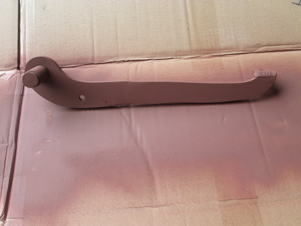

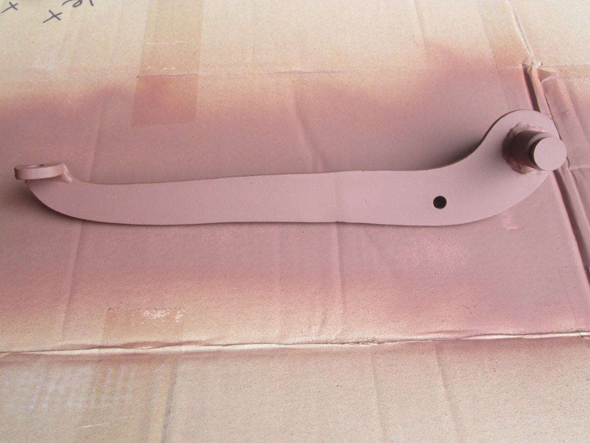

    I need to repair the brake pedal.

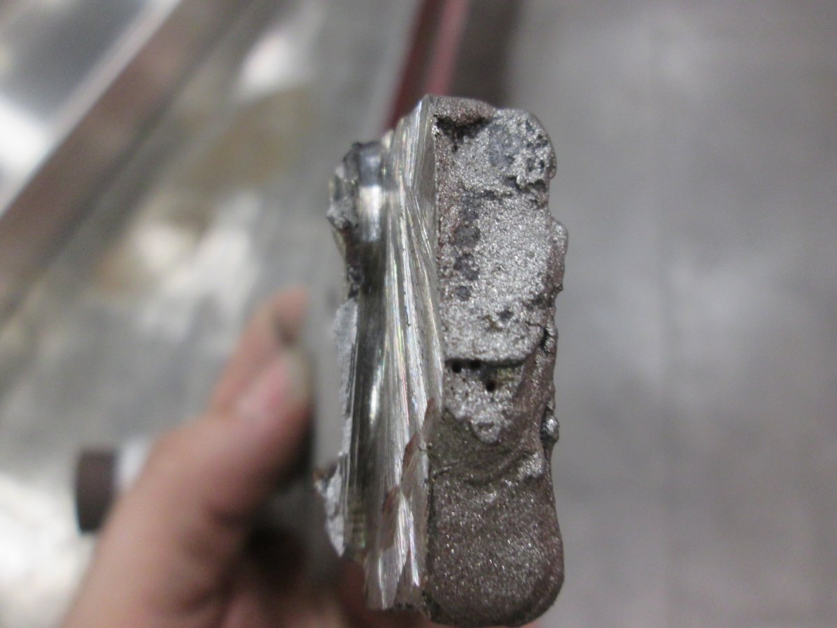

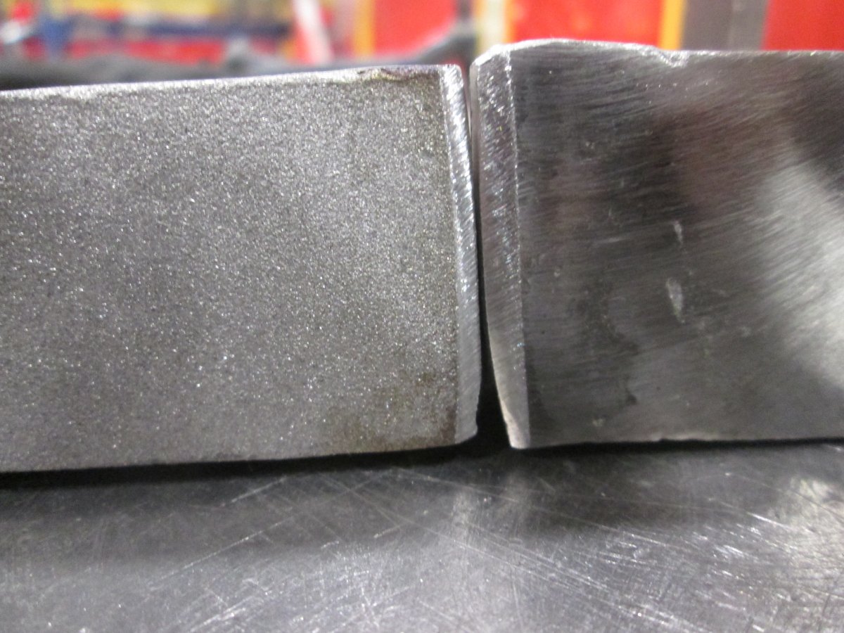

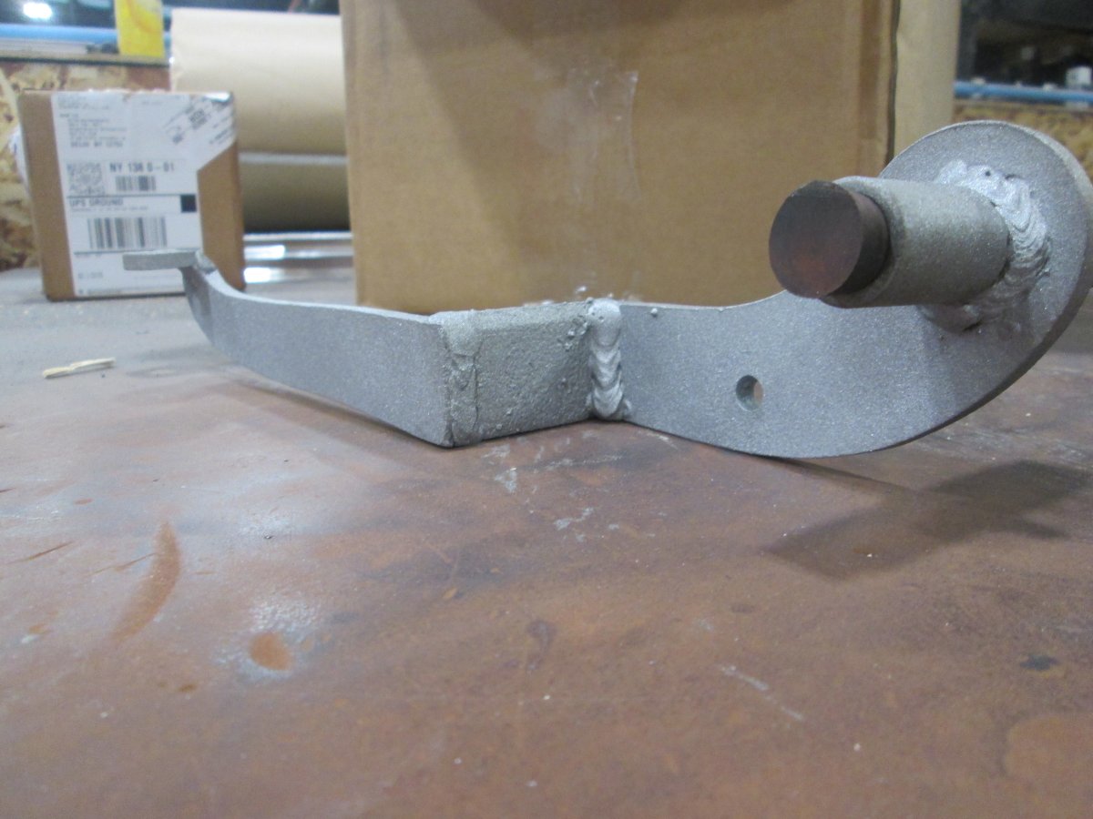

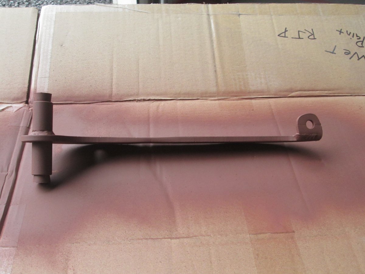

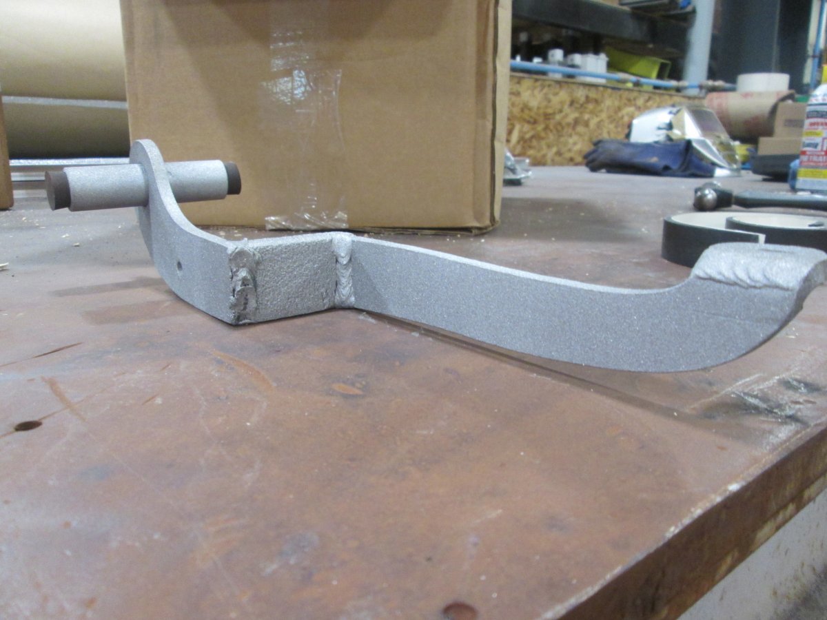

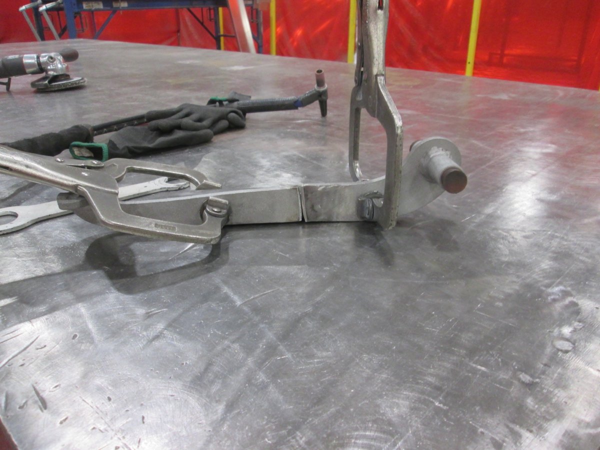

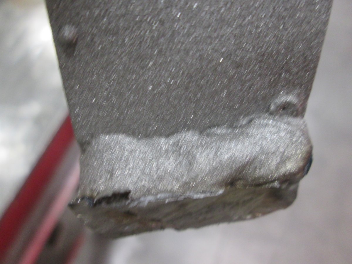

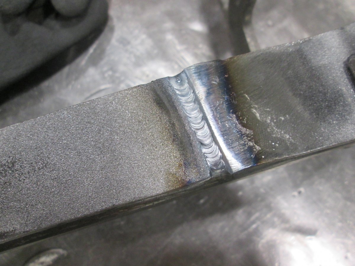

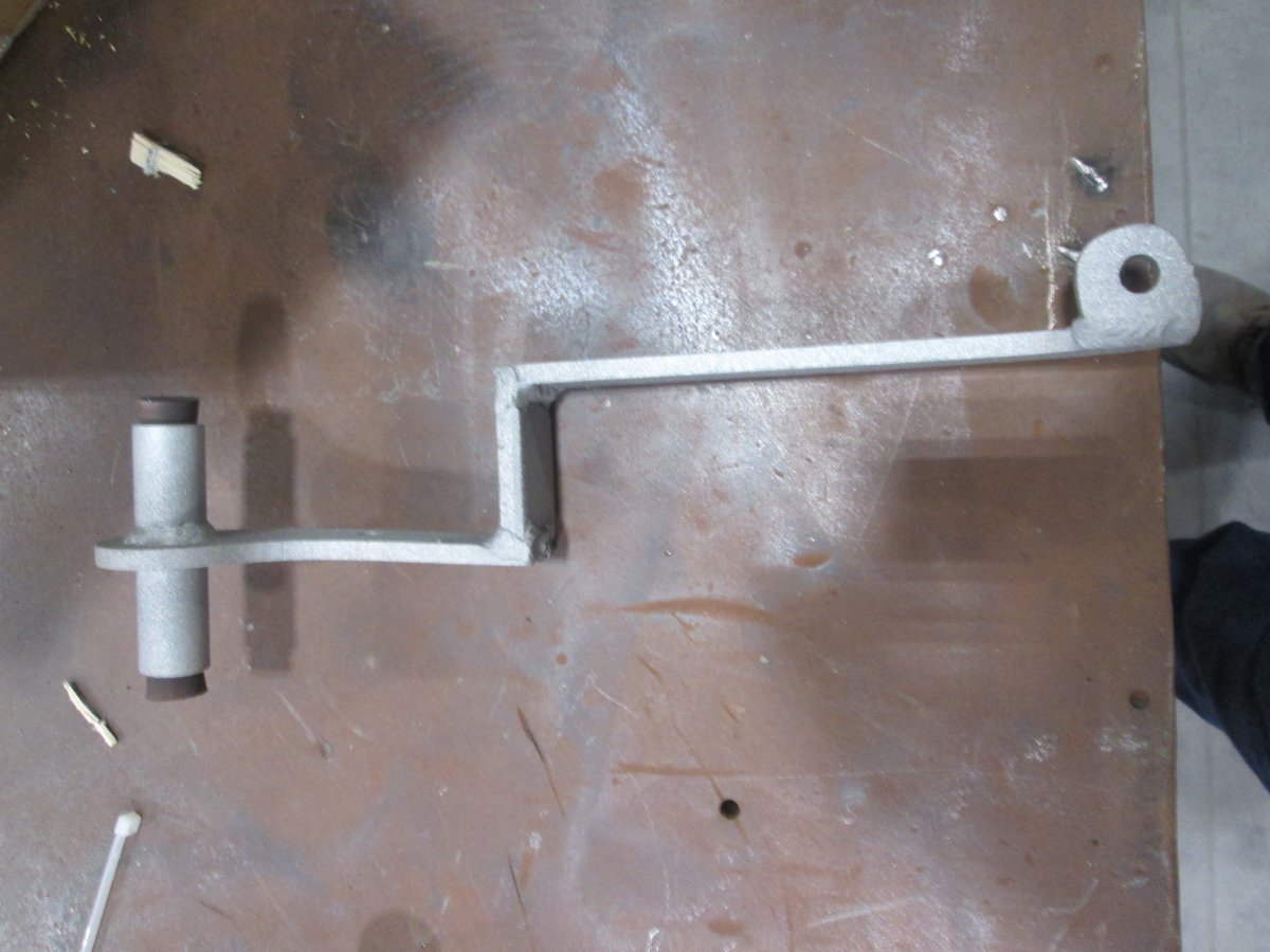

  8. Repair complete-
    ^^^^^Just because you have access to a welder does not mean you should use it!!!!!^^^^
    IMG_0800.JPG IMG_0801.JPG IMG_0803.JPG IMG_0821.JPG IMG_0822.JPG IMG_0823.JPG
    I already had two 52 and up style master cylinders, the next project is to build an adopter to the Ansen bracket (set up for 39-48 style master cylinders)

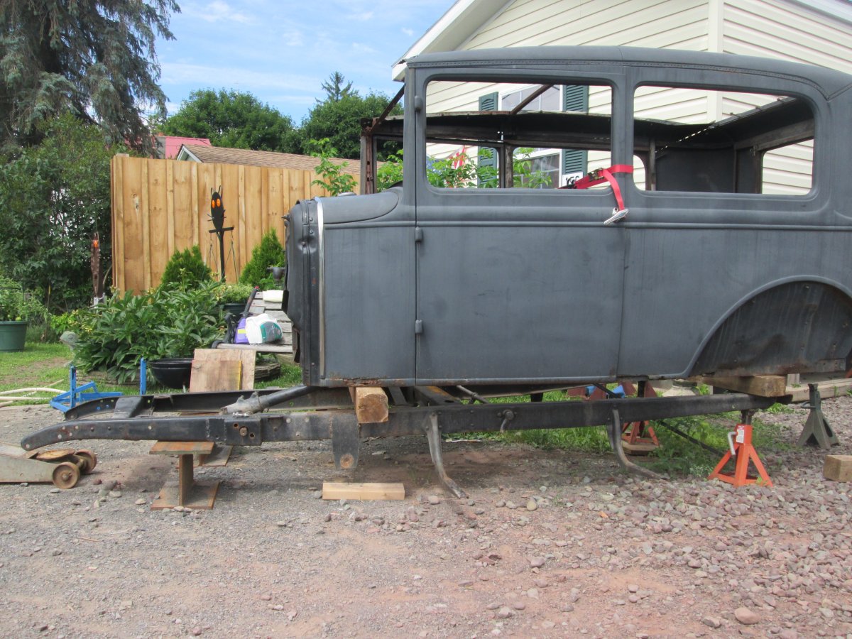

  9. A big thank you to my dad Willard who took the front and rear out of the chassis for me. I am working 50 hours week not much time for race car building.
    I always joked he and mom had me just so he had someone to help him with his work.
    I guess the shoe is on the other hand!:D
    Next to get the body in the shop next to the chassis I will be building.

    After reading the "Just because you have access to a welder does not mean you should use it!!!!!" line and seeing your first TIG pass, I'd like to offer a suggestion. Tack a small tab of steel at both ends of your weld joint to start your weld and for run off. Your weld will be solid and you can use a cut off wheel to remove the tabs. A weld crater at the end of a joint can easily cause a crack.

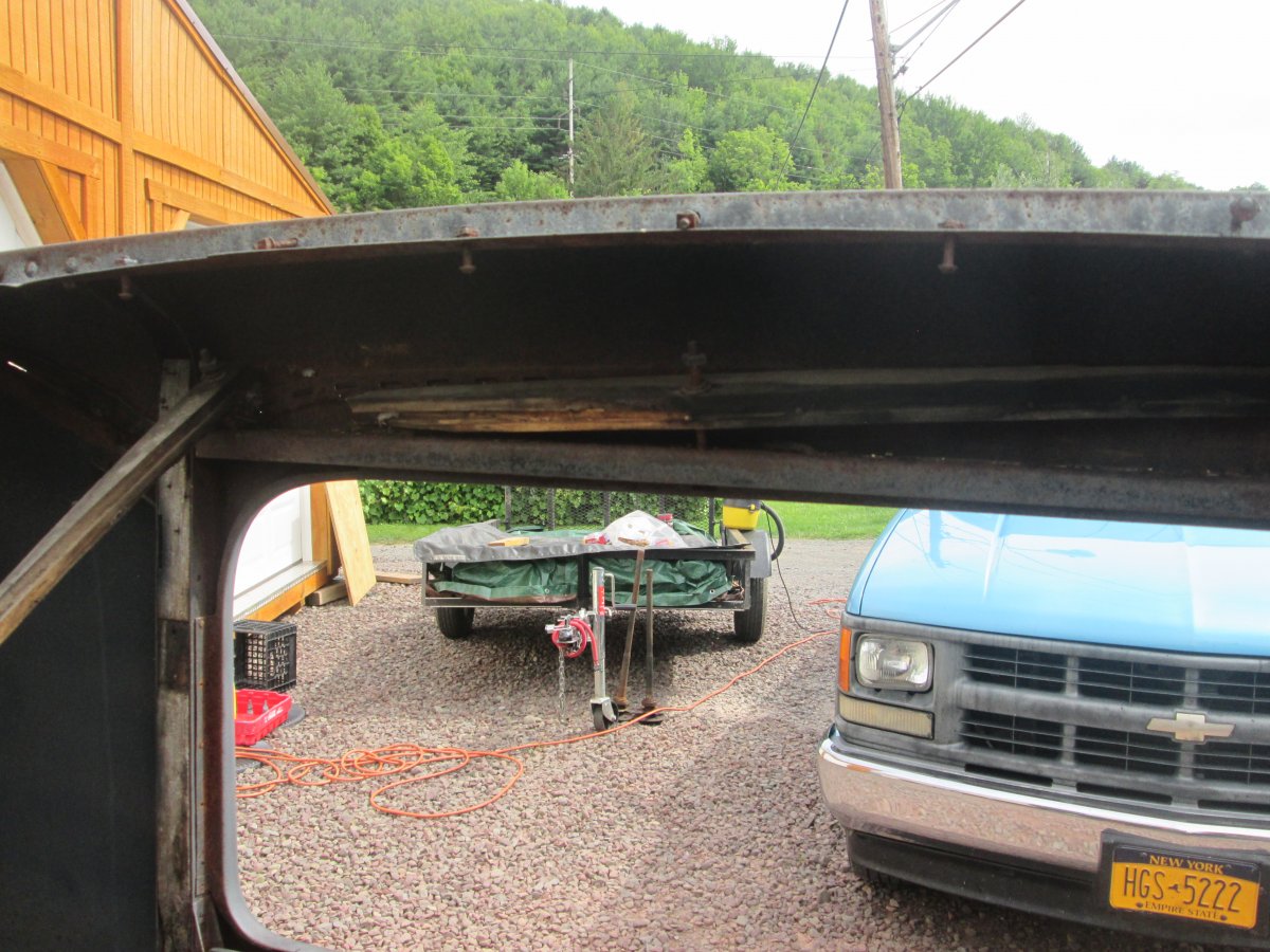

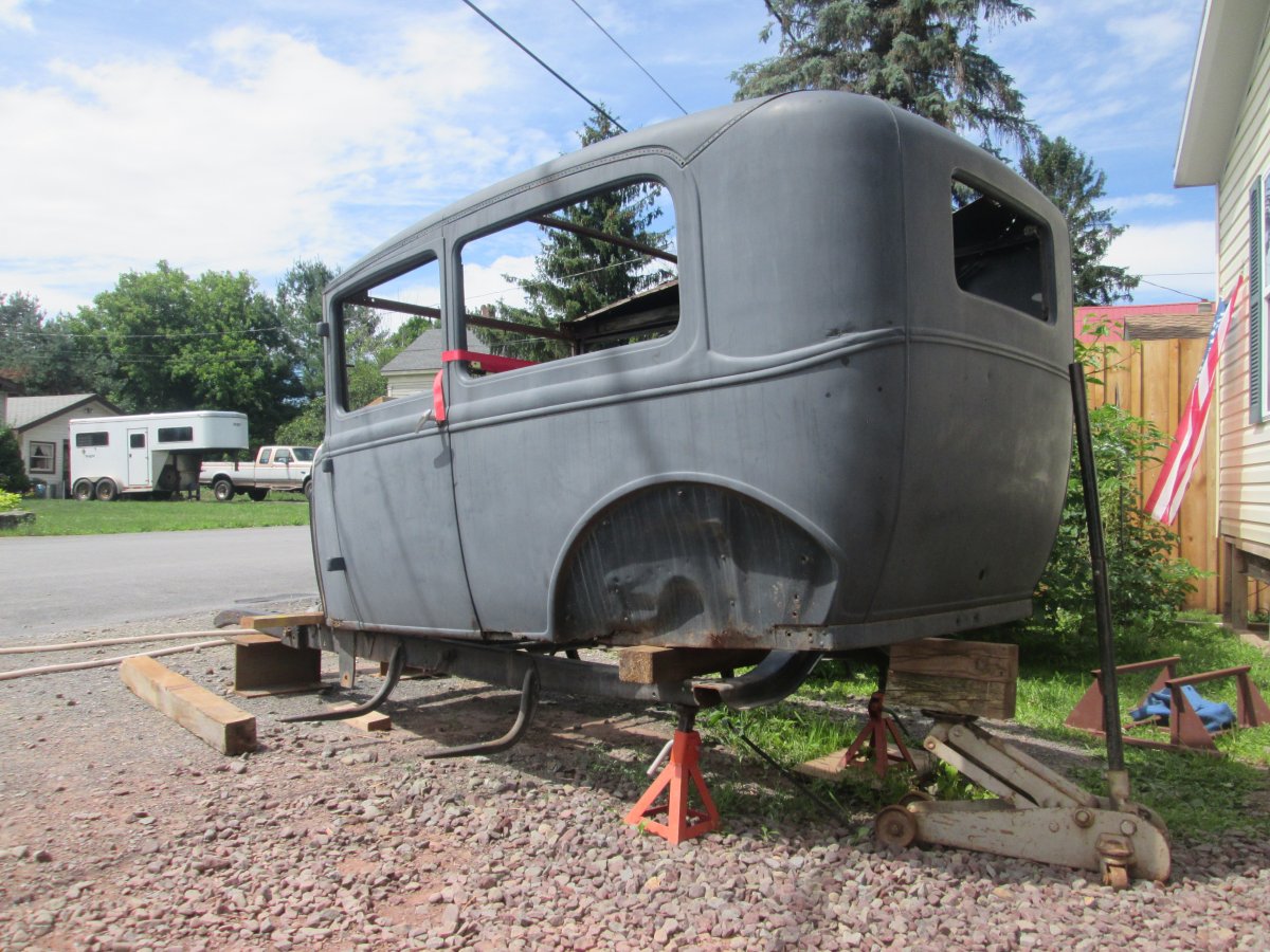

  13. A little update I am getting the body ready to move the body in the shop. Removed all the wood.
    IMG_1063.JPG IMG_1064.JPG IMG_1067.JPG IMG_1066.JPG IMG_1061.JPG IMG_1062.JPG
