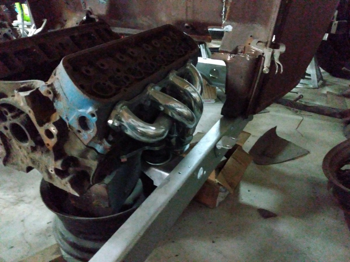

    Preface : 1930 Model A Pickup. I would rather have side steer. I have a Toyota box that would do side steer, a Vega box for cross steering and getting a Mustang box for side steer would be very, very easy :) I have a 289 engine, stock front crossmember, flipped the firewall twice (it is still just tacked). As I position the engine . I'm trying to figure steering box and exhaust. Pics show some hugger headers I had hoped to use, and also some 289 Hipo manifolds. The original location for the side steering box is exactly where my frame mounts for the engine want to be located. So even a F1 box would not mount there. Have I just pushed the engine back too far? Once I remove the huggers, the Hipo manifolds give me much more room for steering linkage. If you can see well enough in the pics, what are your thoughts?

    That I am afraid of doing. Once the engine is planted, it's planted ( sure anything can move, but I don't want to move it ). So I just want to make sure I haven't chosen a bad locating for the engine mounts. Anyone else have theirs right where the original box mounted? Seems weird . .but?

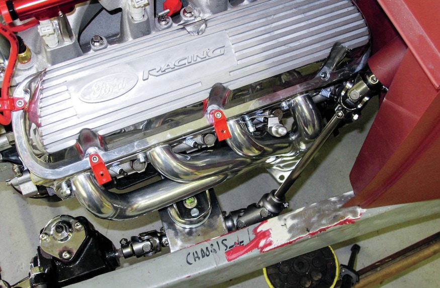

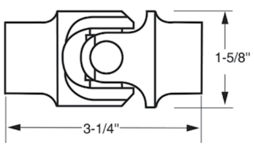

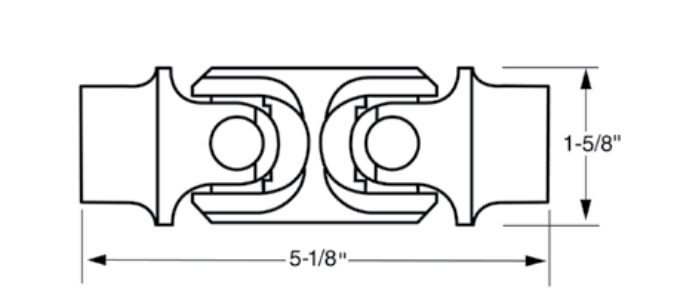

    Single U-joints operate up to 35 degrees, doubles U-joints operate up to 70 degrees, all you require is a support bearing. They can solve clearance and steering issues.

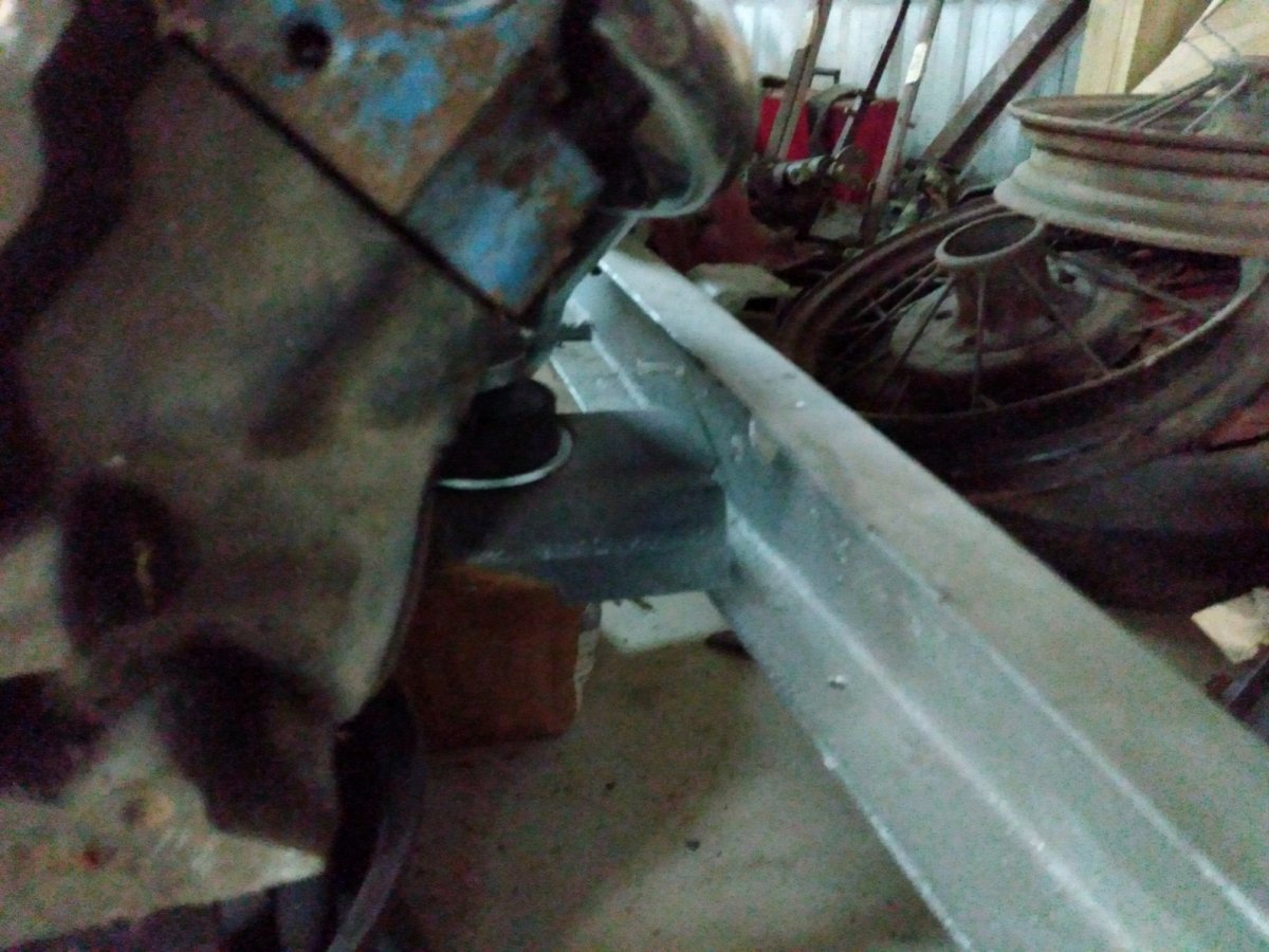

    Well, I have held it at different locations . like I'm doing in the pic with the Vega box. I "think" it would be best mounted up top, as was mentioned with the Corvair . .but the Toyota needs nothing done to it. It's a manual box, 72- FJ or such. When I place it up on the frame, it's a sharp angle to get the steering wheel right . . it seems. No experience . so maybe it's not that bad. I've seen 2 joints in columns . .would rather just have one.

    That's a good picture of what I'm trying to figure . . for sure. They have filled the holes in teh frame, so can't tell exactly where they planted it . .but I think it's close to where I am. But damn . .how many joints in the shaft?? yikes

    I have the engine mocked so it can slide as it is right now. The height is where the mounts would be sitting once welded. The crossmember I mentioned is stock. The axle is stock. I don't want a dropped axle. The axle is built, painted and ready :) So with the stock crossmember and axle, I need the engine back. That is why I took the time to double flip the firewall. There's no way a steering box is going in the stock location . I just can't see it.

    Well the Hipo manifold I posted a picture of definitely opens up clearance. Issue I see with your engine mount is it is levering all the force off the end . . like a diving board . . unless you came from the other direction with a brace . . no?

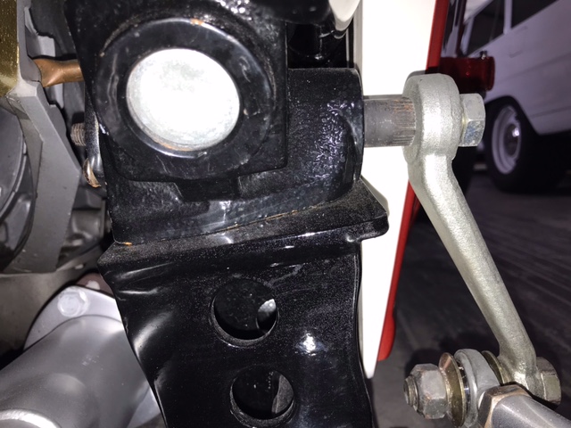

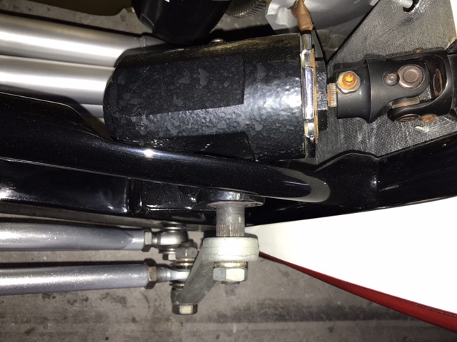

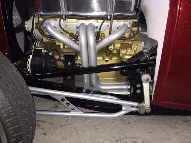

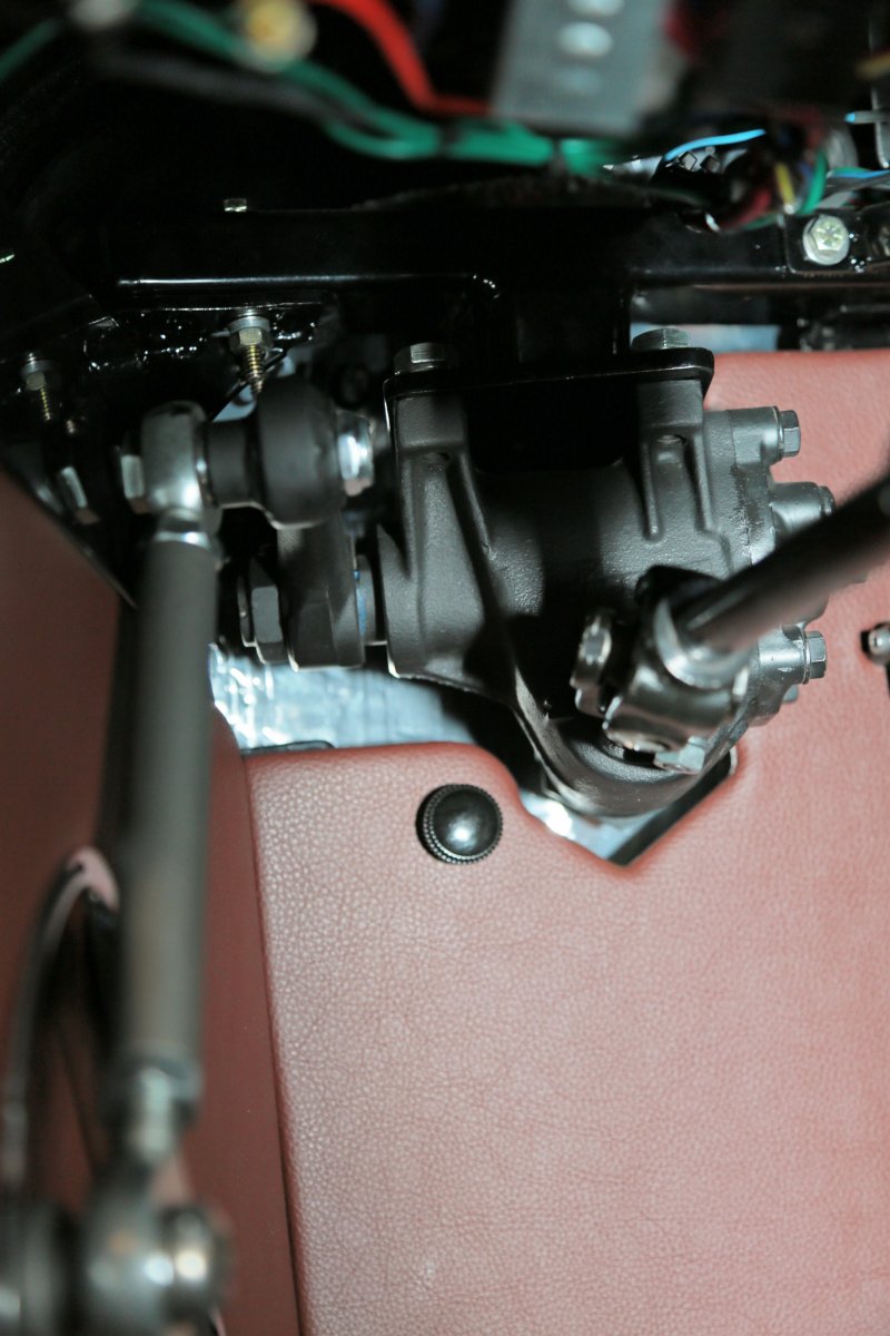

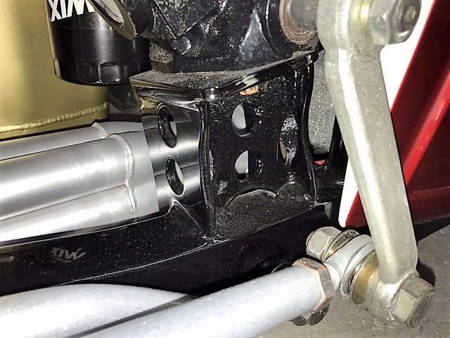

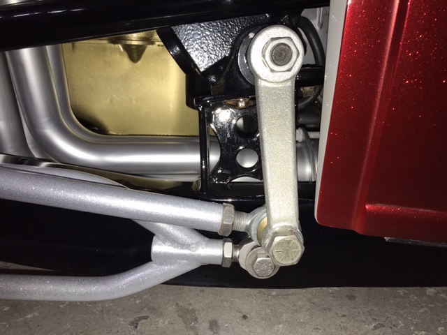

    I have used Reversed Corvair and Reversed early mustang steering boxes on my fenderless Model A's.... the choice is all based on where everything else ends up at. The pitman arm needs to be at the intersection point of the radius arm attachment point. In most cases there is not allot of front suspension travel in a straight axle Hot Rod, so not being perfect "can be ok", but you must be sure.
    This is how I did the steering on my Coupe. My ch***is design is allot different that what your doing, but the principals apply: I used a reversed Corvair steering box and a pitman arm I got from speedway motors.
    I designed and fabricated a mount to position it in the correct area and location to meet all my needs. This design also allows for more foot room inside around the pedals as I go through the firewall much higher than with a mustang under ch***is mount.
    Here are some pictures I took this morning for you:
    Here is a picture of the custom mount I designed for my application:
