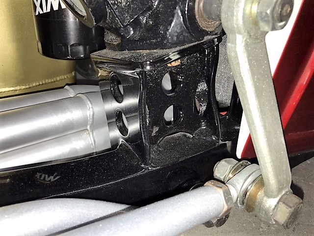

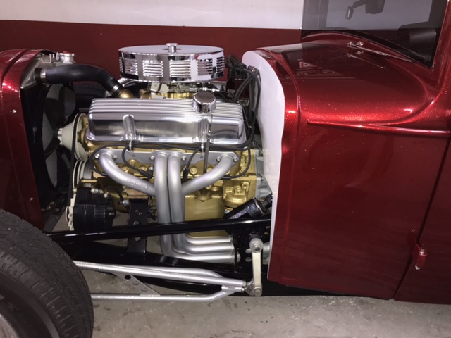

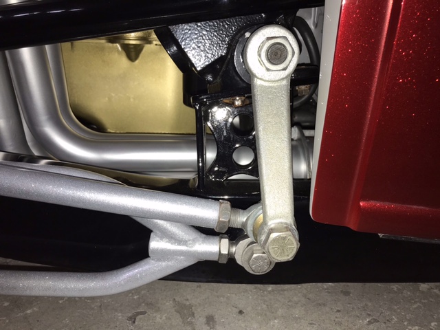

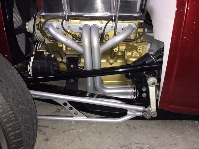

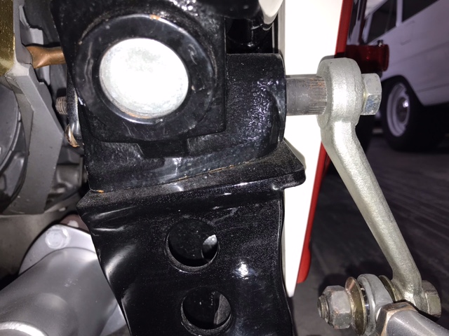

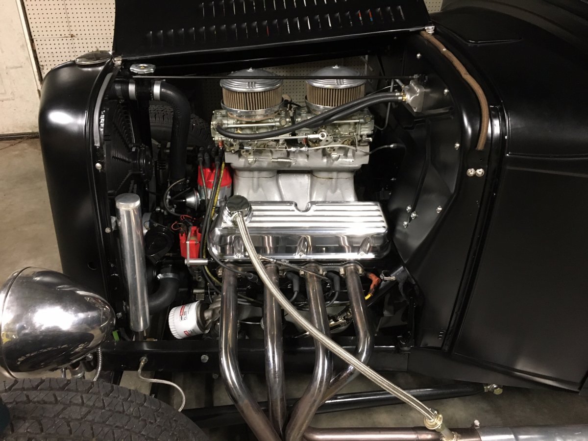

    Yours is certainly a clean install. The SBF just sits so differently, mount wise, than a SBC. But sitting the steering box on top of the frame seems to be where I'm leaning, as yours is. The length of the setback, for the fan position has been figured and why the engine is sitting where it is in the pictures. But nothing is welded yet, so easily moved. Do you have a radiator suggestion? I'm thinking that should be next, then I can finalize the engine position.

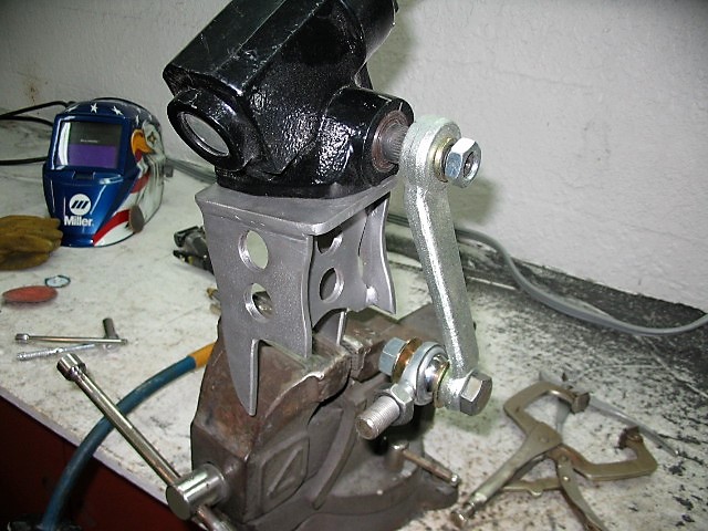

    Building a hot rod is just a giant flowchart. You have an engine, so where does it fit? First you need the radiator for front to back and up down clearances of the fan. Then you can worry about all the rest of the flowchart.
    You can't move the radiator forward for fan clearance (too ugly), but you can move the firewall back. Seems you've done that already. Do you know where'd the fan will fit up/down, and make sure it will clear the bottom hose bib? Might make a big difference if the fan seems to be cutting through the hose.
    The motor mounts can be built a million different ways, so don't let that be the deciding factor. I recommend looking at Ch***is Engineering motor mounts for options, and understand you can cut your own plates to scoot them forward or back to clear a steering box.
    Last, the exhaust can be modified as well to fit around steering if need be. I'd do the steering before the exhaust every time.
    My little bro has an A coupe (full fendered with all the stock dimension frame and sheetmetal) with Vega steering and a SBF. His firewall is recessed, he uses stock Ford exhaust manifolds, and has a mechanical fan. It has a U joint or two, but it can be done.

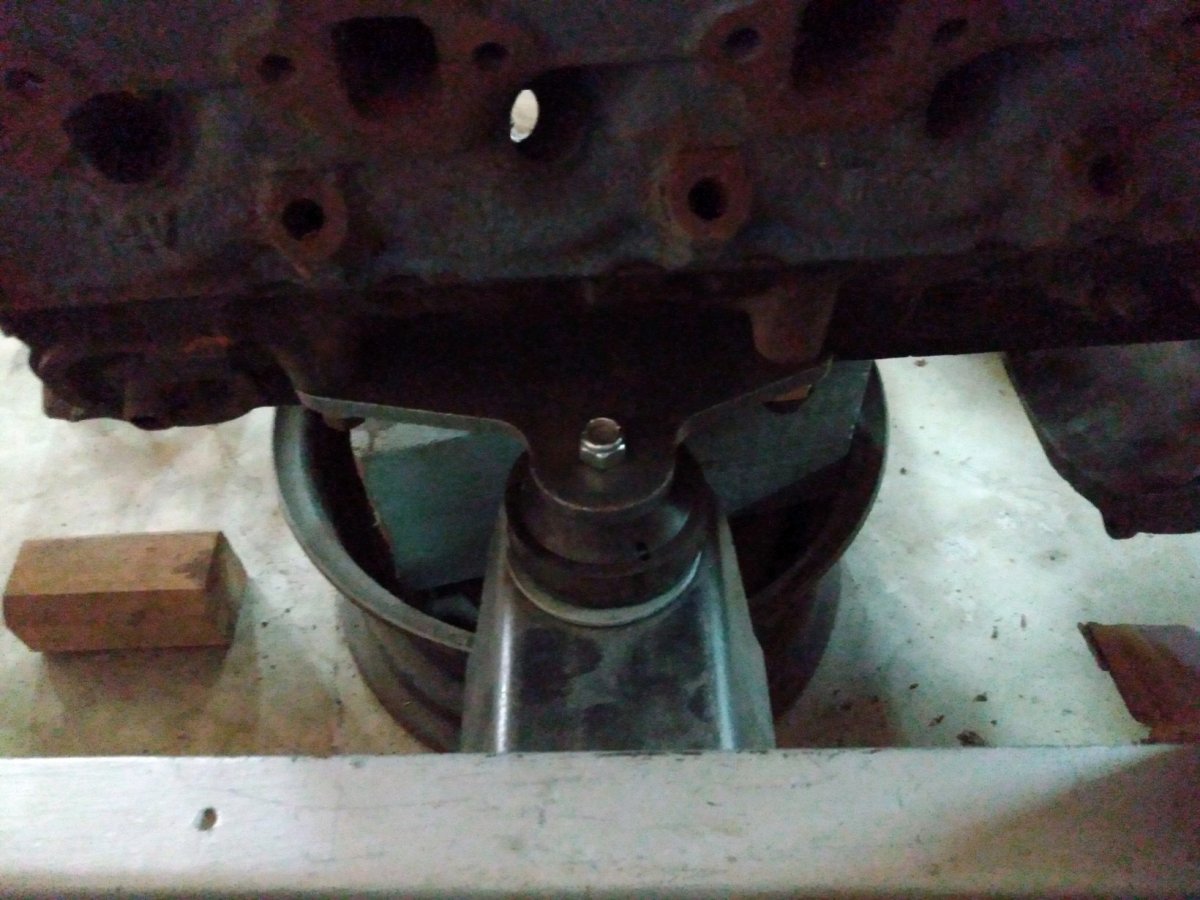

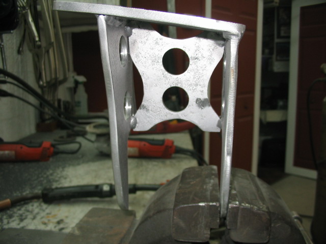

    Here's some pics from today. I can flip the engine mount and get the mounting point to change by 1" . .front or back. Not a huge change, but could be enough to make a difference. I showed a pic. I then sat a steering column in and put the Toyota box on top of the frame, with the Hipo Manifolds. I scan see how that could work. But the Toyota box is kinda fat . . keep hearing the Corvair is thinner. However, looking at where the pitman would hang . still looks like it would work with the stock front axle.

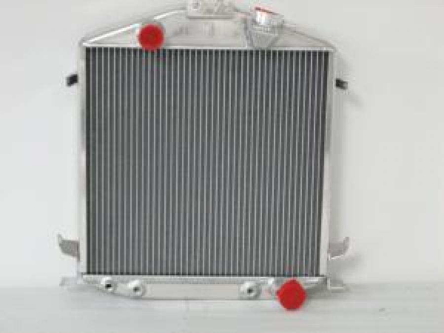

  11. alchemy
    Joined: Sep 27, 2002
    Posts: 23,078
    alchemy
    I only have experience with Walker radiators, but they aren't available anymore. Br***works has very high recommendations. I hate the looks of aluminum radiators on a traditional car.

    from Maryland
    I understand that , , but the shell covers a lot and they cam be painted black.
  13. alchemy
    Posts: 23,078
    alchemy
    Then you understand the difference between your priorities and mine. I have been known to be obsessive on things. Opening a hood and seeing an aluminum radiator would be just as bad to me as seeing an HEI on the engine. Or some Dolphin gauges in the dash. Or heartbeat graphics on the paint. I ain't gonna do it.

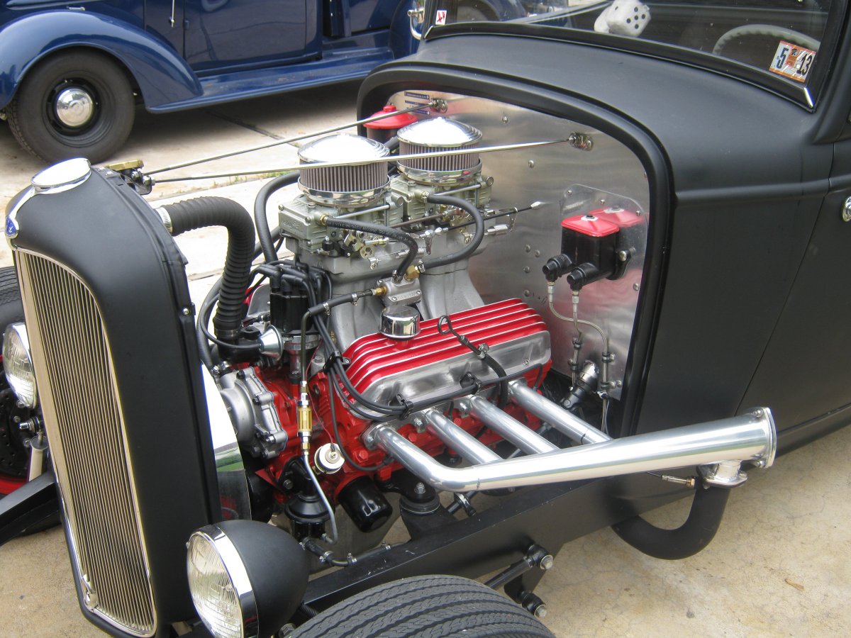

    " AHotRod " Must say that is a neat solution.

    irishsteve mentioned modifying the driver's side motor mount plate to clear the steering box, in post #36 (that's right, your picture) you can see if you simply flip that motor mount plate over you can move the engine mount forward around two inches, if you need to move it more you can modify the plate or make a replacement.

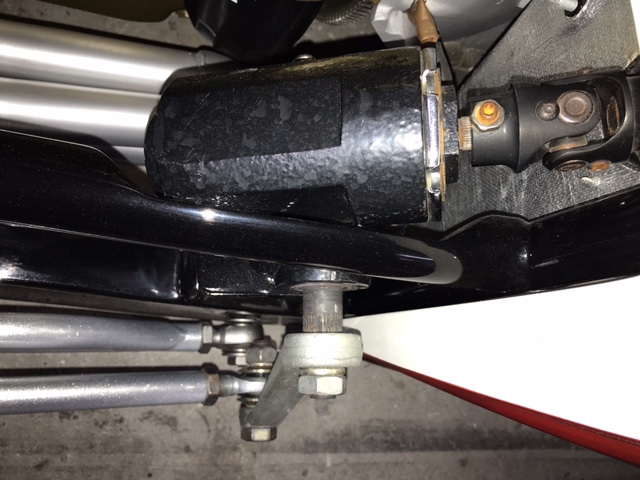

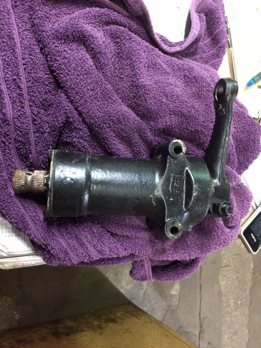

    Here's some new pics. This is the Toyota box . and I agree one a bit smaller would look better and offer even more clearance. But the point of this is to show that it looks like this would work. It's clamped in place and tilted somewhat how I would mount it, if I were to do so. Pitman arm placement seems good. With the Hipo manifold, there's clearance ( and this is where more could be with a smaller box ). I have a steering column sitting in there just for giggles, to see how it would set. I may use a universal plain column you can buy for $100 or an old truck column. But , to me, seems to work. Thoughts? Corvair is the one mentioned most hard to find it seems. Any other smaller ones? I have a '64 pickup , which was the last year of solid axles. They have side steer and the box isn't too, too, wide. But looking at it on my truck and seeing it in the A is different.

    Just to complicate things for you , consider fitting a Series 2 or series 3 RHD land rover steering box .
    Dont panic, the way the land rover steering box is configured in a land rover the pitman arm is on the left, therefore fitting th RHD box on the left side ch***is rail provides you with what you need .
    you can mount the either on top of the rail or as near a s damit in the stock A location with very minor tweaks to the ch***is .
    The boxes are reasonably small, about the size of an F1 but a lot prettier if you need to mount it on show as they are aluminium . The columns are pretty short but that's easy fixed .
