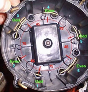

    Yes. These symptoms suggest a Mustang V6 distributor is being used here. Allegedly made for Mustang's first foray into V6s simply by lopping off two back cyls on V8s just like Buick did. So the V6 distributor has the same look, feel, fit but not function as a V8 distributor with 2 dummy plugwire holes. This no doubt makes a Mustang 289 seem to run even ****pier than usual. Jack E/NJ

    What? A v8 distributor with 2 dead holes? I'm quite sure there is no such thing. All the big 3 chopped 2 cyl off their v8. (90 degree v6) And none that I know used a v8 dizzy.

    Ford never cut the back cylinders off of a V8 to build a V6..... Ever. The first V6 was the German built motor used in Capri, MII, some Pintos. Later came the 3.8L in the mid size cars and 83 pickups and Taurus. None of these share anything with any of the V8 motors.

    GM did. Here is the inside of an odd fire V6 distributor cap. It’s clearly a modified V8 cap, as was the distributor itself.
    And relax anyhow, Jack E NJ was kidding.
