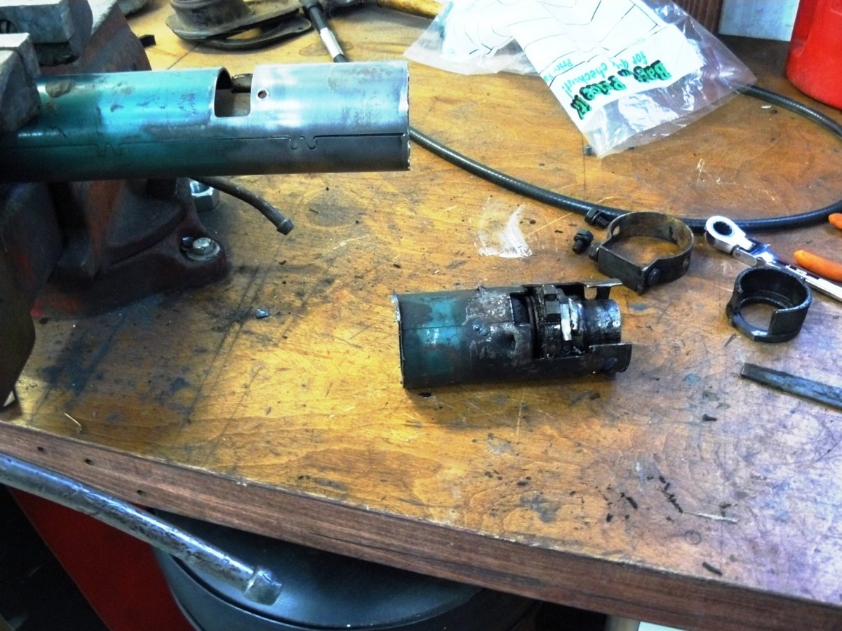

    now that the cab is mounted I can get the steering column in.had a column from a 70 chevy truck ,shortened it 6" then another 4". put the dash in and fabbed a solid mount off of a piece of angle I welded in across the cab behind the dash. made an upper mount from a con. rod and a lower mount using the original clamp that was at the bottom of the column.and got some shaft connected to the rack. it all works surprisingly smooth and easy to turn .even with the small wheel.

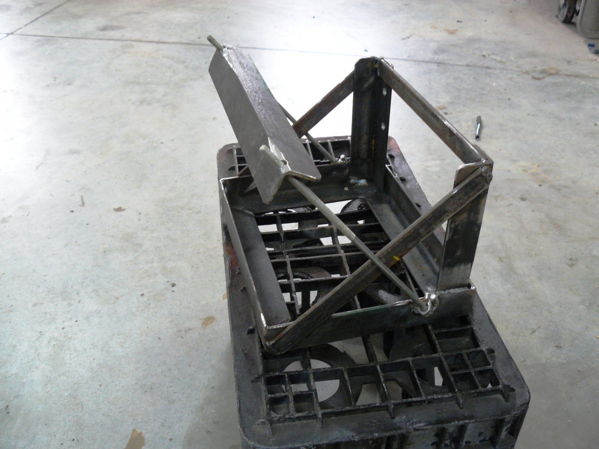

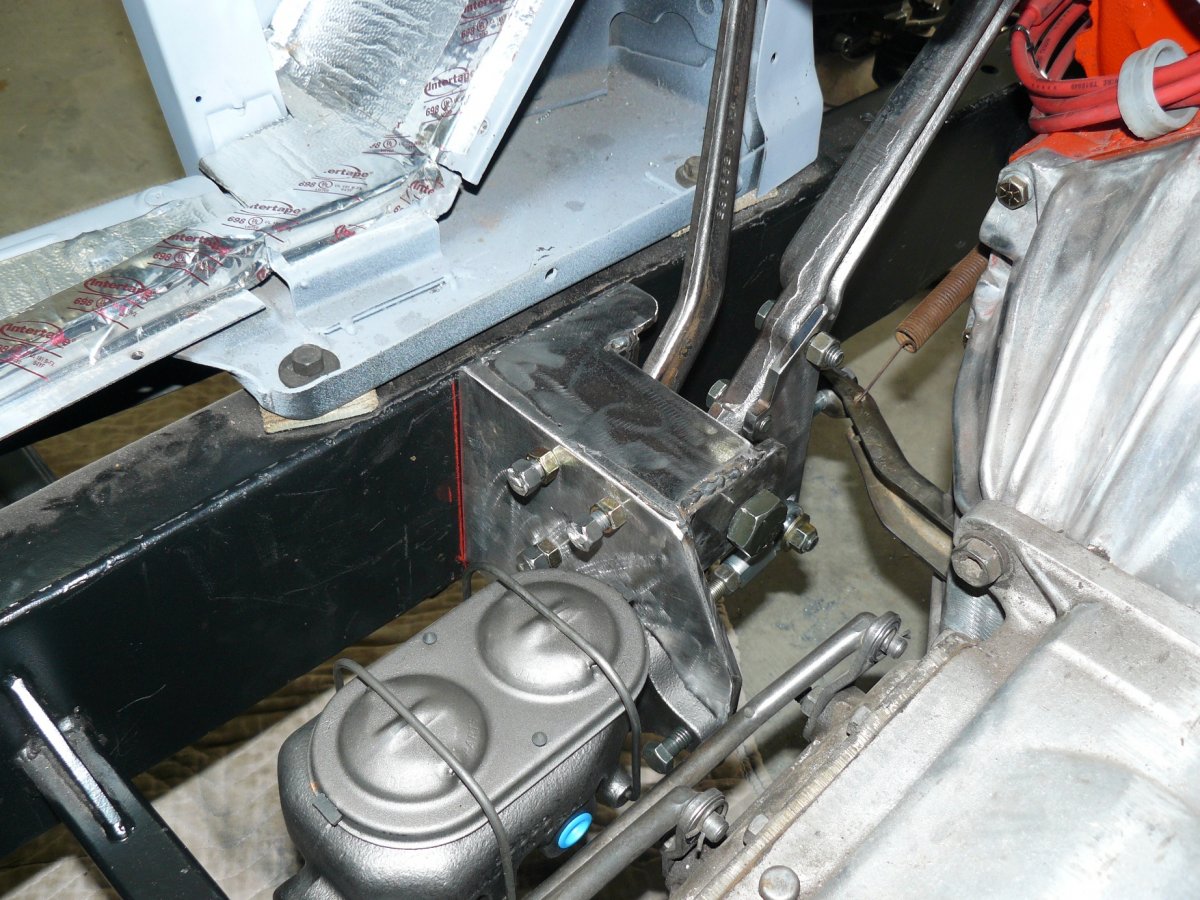

    I've been putting this off waiting to buy an under floor pedal and master cylinder setup. I still have the original pedals and decided to see what I could do with them.after some mock up ,I realized I could make make the clutch linkage mechanical instead of hydraulic. (I never have liked the idea of a hyd. clutch). so after some measuring and making some crude drawings. this is what I came up with so far. still need to make an arm to operate the master cylinder. will clamp it to the frame today and see if it will actually works before adding some bracing and gussets and weldin it up and bolting to the frame.

    finished my pedals. it all seams to work well . the bolts with jam nuts are stops. two for the clutch to help adjust throwout bearing free play and to keep from over engaging .and one for the top of the brake pedal.
