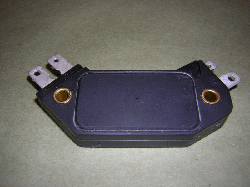

    Hey 31Vicky. I have a 1957 GMC w/ a 350 in it. I was having a lot of the same issues as you are. I'm not sure if someone else has recommended this, but if you do have an HEI distributor try replacing the ignition module/some people refer to it as the ignitor. I replaced mine and my truck fired right back up & has run great since. I was initially having intermittent problems. Here's a pic of what mine looked like. Good luck.
    Josh
