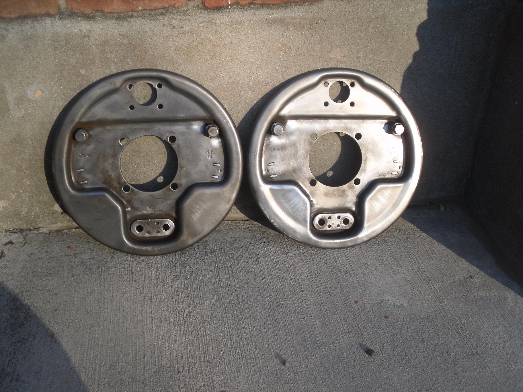

  7. Wyatt: If your not restoring something, put what you want you like on it. My fronts were so nice that I cleaned them up and put clear on them. Didn't want to cover them up. Tim
  8. Here's a pic
      515.6 KB
