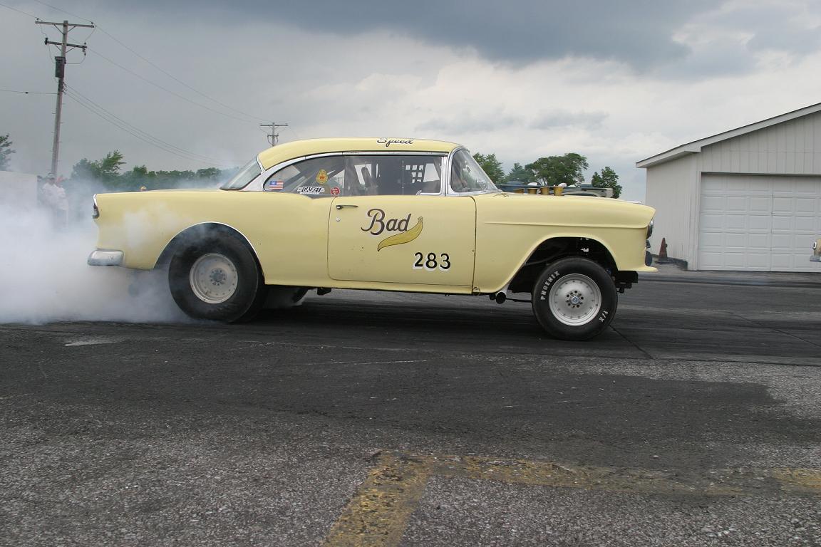

    Here are some photos that I took that you might like.
    This photo was pulled off my dads video.

    Awesome pics!! We forgot the cameras yesterday so we don't have any footage. I would like to watch the video as well. It wants to launch left on occ***ion and then it will launch straight the next run. I need to try to figure out why it is so inconsistant on the launch. I think the rear suspension may be binding at times and other times not. It is still the crude homemade deal from the 60s and there aren't any heim joints in it..LOL I plan on looking it over pretty hard before we head to Byron.

    This is the second run of the day. I was real late on the tree as I thought they were going to stagger the start since the other car was 11.00 and I was 10.00 index. I was not expecting a heads up start. The video is cool as it looks like an old 4 speed car shifting 1-2 and 2-3 ...LOL Maybe I just need to run it that way all the time.. :D
    Watching it and looking at you still pics, It looks like the rear suspension is in a bind. I need to get it into the shop and check it out. It will be fixed before the Meltdown.. I promise.. ;)
    This is the first time run and it really jumped left and even crossed the center line. I took it back and made some minor changes but honestly they s****ed the track right after this run and I somewhat blamed that at first. After the second run above, I am sure there is something going on.
