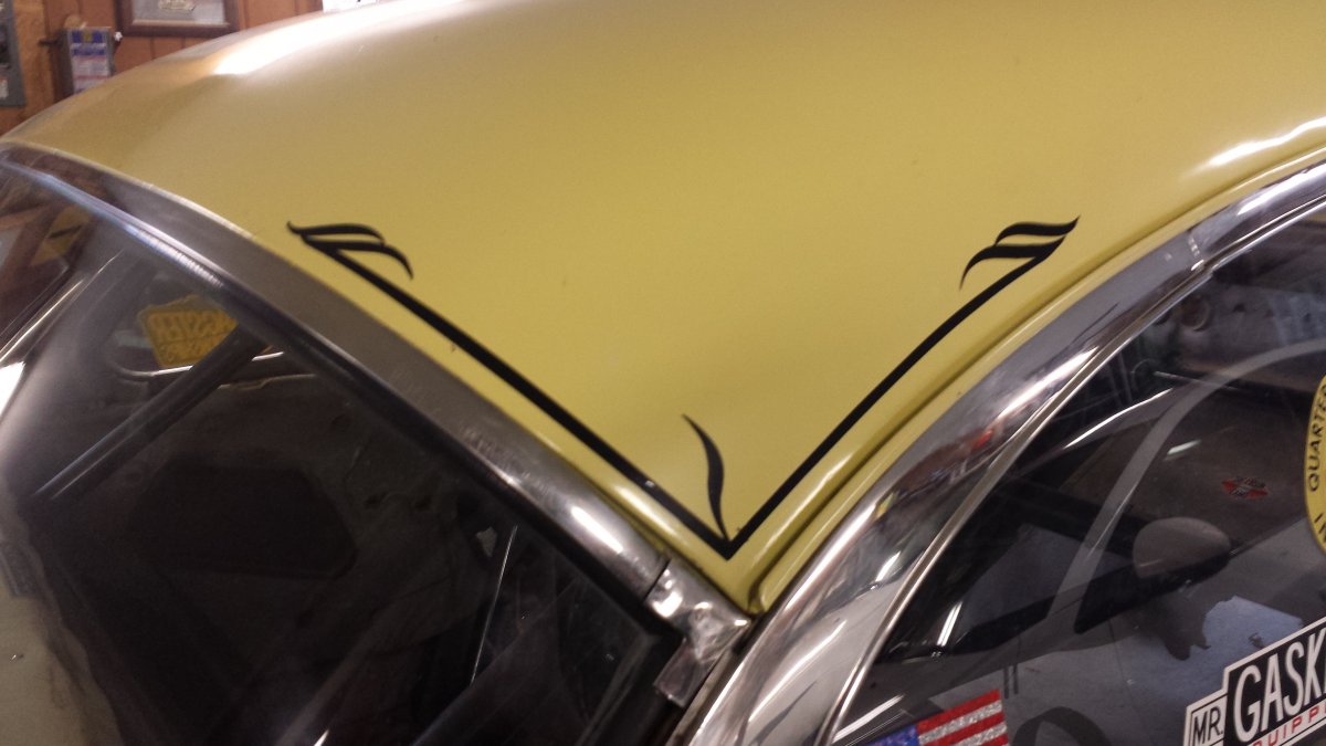

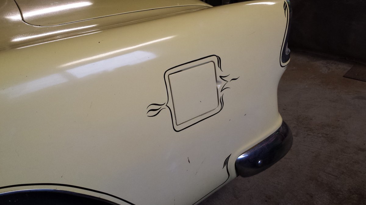

    So... I have been wanting to bring the Bad Banana back to the way it used to look in the 60s. One of the things that was missing was the original lettering and pinstriping. I was lucky enough to find a guy here in Michigan who could duplicate what was on the car from the old pictures. I think he captured the style and I am very pleased with the results. He also donated a vintage beer can to replace the "late model" one I have been using for a radiator overflow. Stay tuned. More to come.

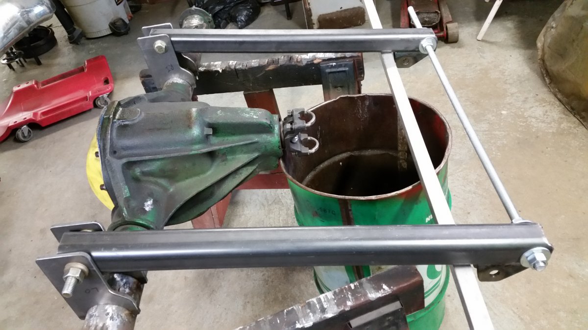

    Some progress being made. Below are the original traction bars that were made out of 1/8" plate and thin walled square tubing that was welded to the axle tube. It started to tear off the tube and folded the plates which in turn allowed the pinion of the axle to jam forward in the car. That bound the transmission and broke 3rd gear and created other damage. 20151128_165748.jpg 20151128_165827.jpg
    So I removed everything from the axle tubes but the spring perches and built all new from scratch. Everything is now .250" wall and hand drilled and cut in my little modest shop. Here is what I started with.
    A few days later I had this.
    The adjustable bars are long at this point but it is way easier to shorten them than it is to lengthen them. I mocked everything up under the car and spent a lot of time making sure all was level and square. I left a lot of steps out but you get the idea.
    Once I got it all roughed in I cut the adjuster bars to final length.
    Below is where it is at today. The nuts that are welded to the adjustment bar I added so I can make adjustments without using a pair of channel locks if I am in a hurry. Pretty much ready to go back under the car for final fitment. Gotta cut the bolts to proper length and I am going to make a minor change to my spring floaters then take it all back out and blow on some paint. I don't spend much time on "prettiness" on this car. I ain't building it for a beauty pageant.. ;)

    Those bars work good like that Rusty, I did Gene Cromers that way and several have copied them since then and they all do good.

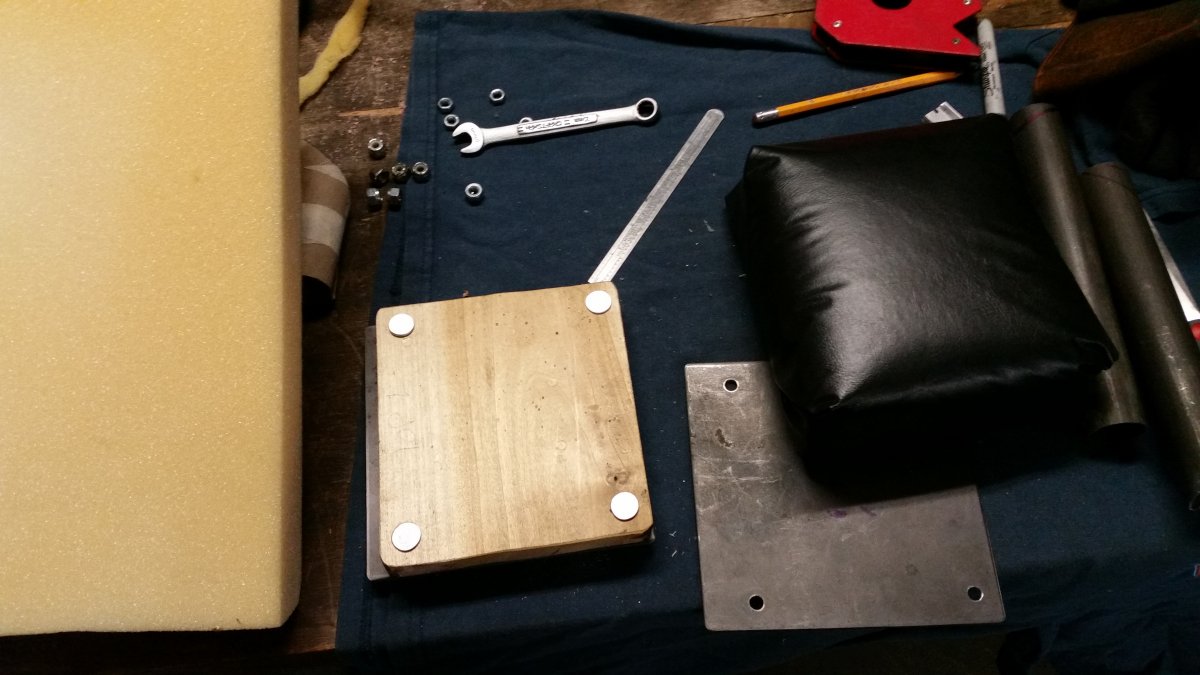

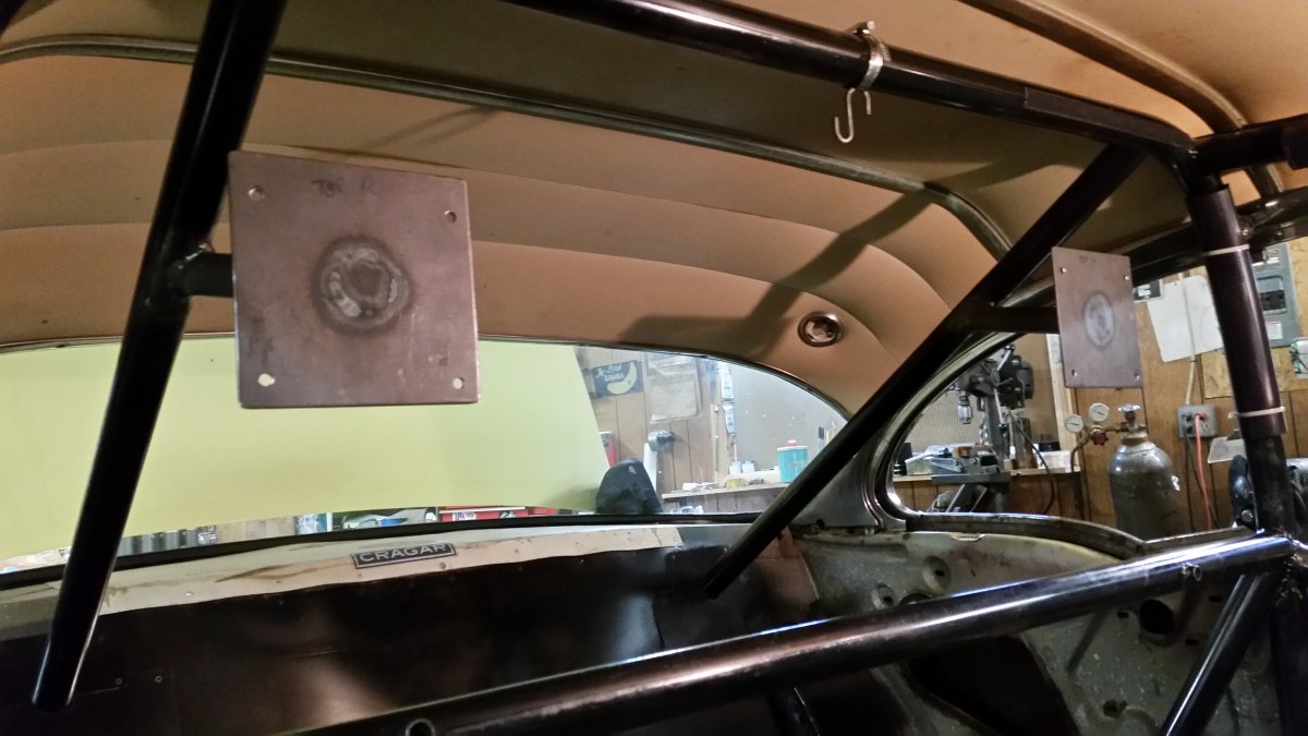

    I talked the wife into modifying the existing seat covers to fit the cut down seats. She is working on them and will probably have them done in a few days. Below are some of the highlights of the headrest build.
    Above are the basic components I used. Finished part on the right and the other one in pieces on the left.
    This pic shows a hard wrinkle but I had a clamp on it and just took it off. It expanded back out after a few minutes.
    Mounting these was harder than it looked. The tubing from the down bar to the plate is a compound angle on each end to put the headrest where I wanted it. It took me a while to figure out how to get them where I wanted them, hold them while I welded, and make sure they were even side to side so they looked right.
    I think they came out pretty good. I got the thumbs up from Quain so that is one more item off the list.
