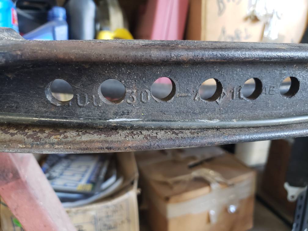

    Post pictures of what we should be looking for (axle). I know of some, but need help identifying specifically. What makes a ‘61 a ‘61? You work on the car, we will surf the net.;)

    http://www.econoline.org/axle_front.php
    Sent from my SM-G960U using The H.A.M.B. mobile app

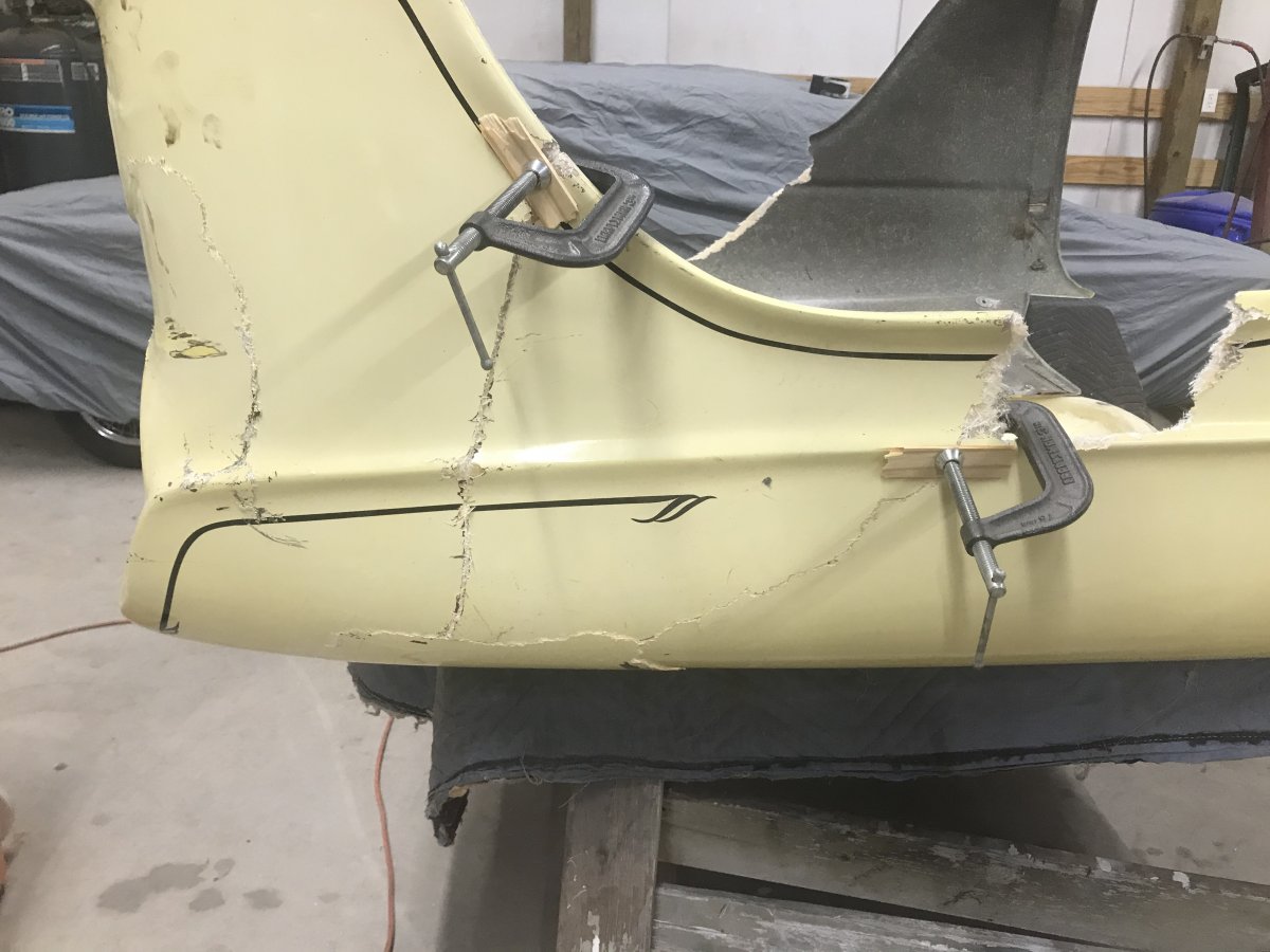

    Also, not sure if you are considering fixing the fibergl*** front end, but that should be fixable too if you wanted to save it. I might be able to help with that unless you wanted to do it yourself. Strangely enough, I enjoy working on fibergl*** and would love to see this go back together with as many of the same parts as possible.
    Edit: added pic of why I likely enjoy working on broken fibergl***. I have been around it most of my life and learned it from my dad. Even watched him fix a couple mid-year roadsters that had been through fires back when they probably shouldn’t have been fixed since they weren’t worth anything...

    The fibergl*** front is the part that worries me the most. I do NOT have much body work experience and not really much desire to learn. I did evaluate the pieces and I do have probably 95% of the front in probably 10-12 pieces. I would love to have someone help save it.

    I understand your thoughts on the axle. And, sounds like you have plenty of the front clip to make it fairly easy to put back together. From looking at the pics, I ***umed you had most of it. I’m serious about the offer to put it back together for you if you want to save it. As long as you aren’t in a big hurry, I should be able to help while also maybe trying to teach my kids how to do fibergl*** repair. I don’t do bodywork full time anymore, but like doing stuff like this.

    You can't beat a deal like that . I had a big truck bodyman show me how to fix a 41 Willys front end after I smacked the guard rail . It was in 8 pieces and much worse than yours . You could not tell it after he got it done and I learned a new thing to add to my bank of knowledge.

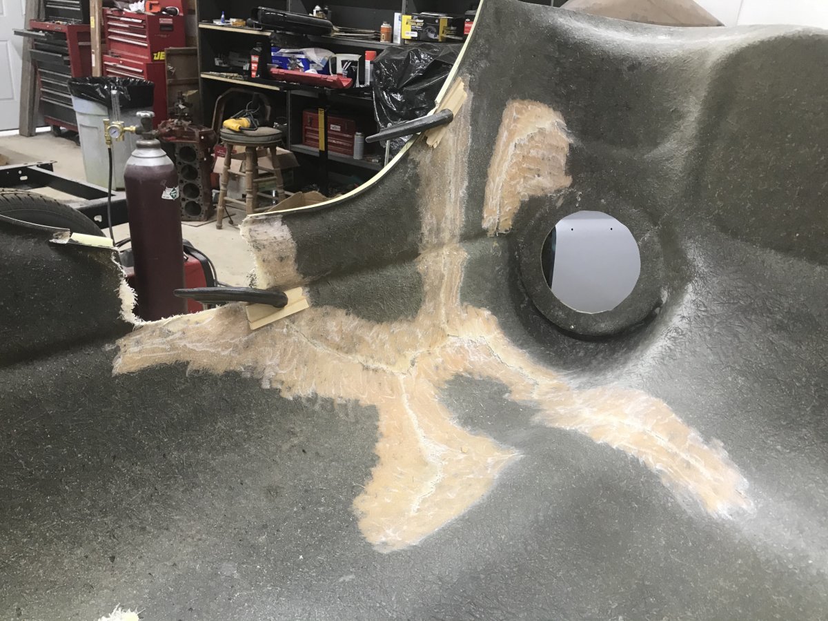

    Like putting a puzzle back together... Hoping to turn it back into one piece fairly soon now that I found time to get started.
