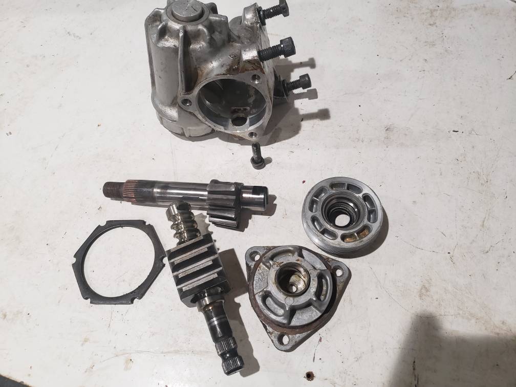

    I am waiting on a few things and the heat is still brutal here. I did go thru the steering box. I was worried it may have internal damage but all seems good. If the heat backs off I hope to make some headway this weekend.

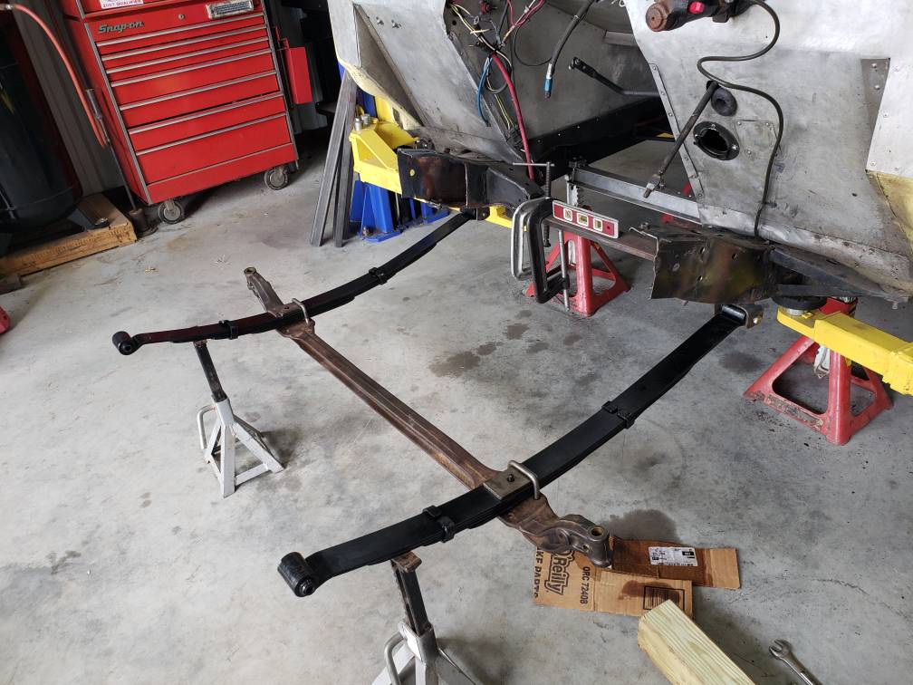

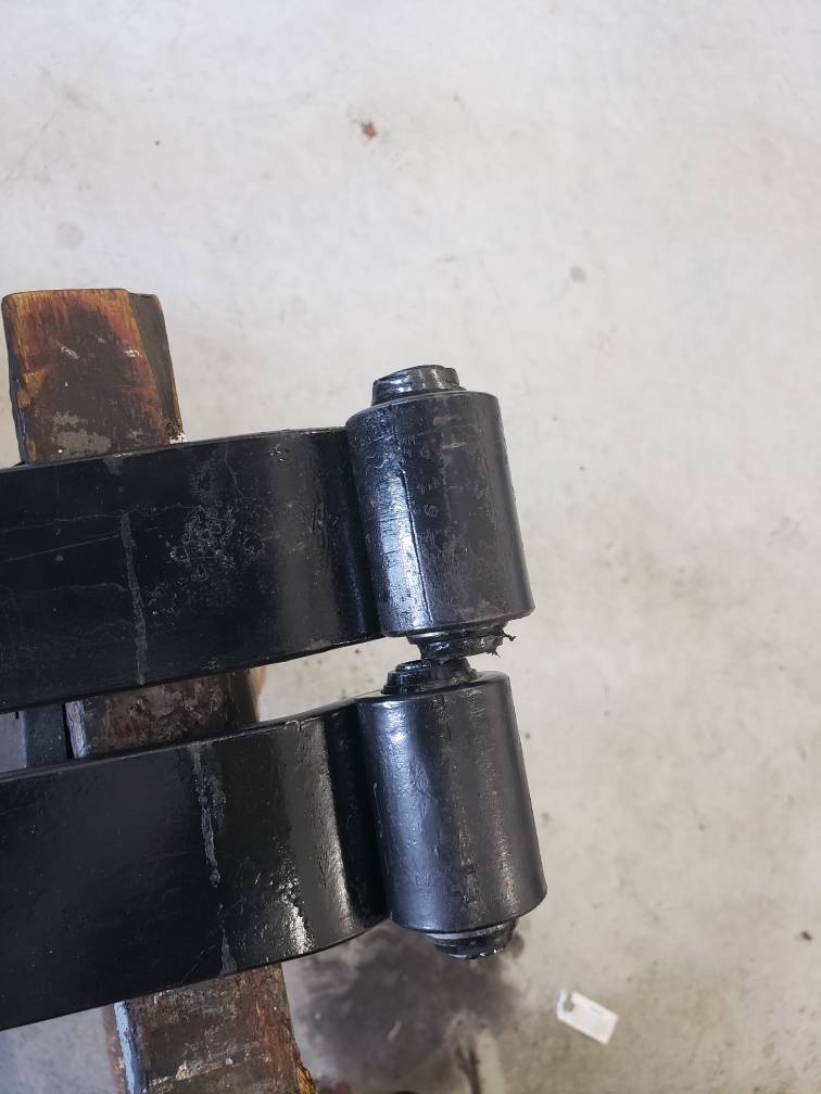

    My experience with Ray's Champion Spring was not good. The guy is condescending and has an attitude. When I went to talk to him, he didn't even want to walk out onto the parking lot to look at what I wanted. I gave him the option of modifying a used set I had or making new main leaves and using my old shorter leaves. He wouldn't consider shortening the used ones ( I understand that). I left my old bent main to copy and I gave instructions on the u- bolts but he didn't write anything down. I should have walked away then. A week an a half later I get a call my " spring" is done. I said it should be two springs. Guy puts me on hold and comes back and says it is two springs. I ask how much and it's over $400!!! I ask if they built all new springs and it was no, just new mains and we used your other leaves. I asked about the u bolts and was put on hold again. Mike gets on the phone and insisted I never got back to him on the ubolts (wrong.. we finalized the dimensions before I left but he was too busy lighting a cigar to remember.)
    I told him forget the ubolts I'll get them elsewhere and he said no he will make them. We went over the dimensions AGAIN and I said I would be there to pick them up before the end of the week. I went today and brought a tape measure and the mains are 2 different lengths! One is a 1/4"+ longer than the other. I pointed that out and he wanted to argue. He measured them himself and when stacked on top of each other its obvious. I was pissed off and just paid the $467 bill and carried them out. This is why shit is made off shore now. Nobody cares about quality. If they were perfect, it's hard to complain about price. But charging premium money and getting shit really pisses me off. $467 for 2 main leaves and 4 ubolts with nuts is pretty damn expensive if you ask me. I only paid about $270 for the two complete springs a few years ago and they were identical to each other... sad...
    It ain't a show car and maybe I'm expecting too much. If it would have been cheap, I wouldn't care. But to pay that kind of money and see torched off center bolts and the straps not clamped right, different arches and lengths between them, I just shake my head.. I'll fix them myself and move on. 20200723_192921.jpeg 20200723_192934.jpeg 20200723_192937.jpeg 20200723_192953.jpeg 20200723_193042.jpeg 20200723_193243.jpeg

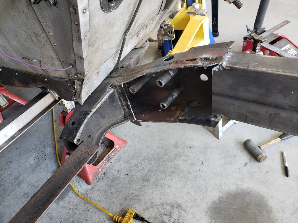

    Here's a quick update. Starting to come around but still a long way to go. 20200721_194752.jpeg 20200721_202532.jpeg 20200725_123225.jpeg 20200725_183233.jpeg

    Almost all one piece again. Hoping to get it all stuck back together this week then start making it look like it wasn’t pieced back together. ;)

    My experiences with two local spring shops have been less than stellar also. Maybe spring guys all have attitude? One gave me attitude because I tried to show him my drawing of the spring eye to eye measurement, and arc from center up to level with those eyes. He proceeded to talk to me like a 5 year old in a condescending way, and instructed me to measure the springs from spring center bolt to eye, each direction. Since I had no springs to measure, he basically told me he couldn't help me. I told him I thought that might be a good thing that he couldn't. Then told him that I'd have thought someone with "40 years experience" would be able to help figure it out.
    Second shop was less condescending, but still not really helpful. But we did get the springs built, and their work was perfect. Took two trips, as I found a friend with springs that were like what I needed, but 2" too long. Took them over and told him to copy them, but make them 2" shorter.
    The last two builds I found a main leaf that worked, and used my collection of junk springs to just build up my own sets. Easy, cheap, and no BS from spring shops.

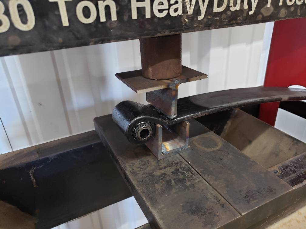

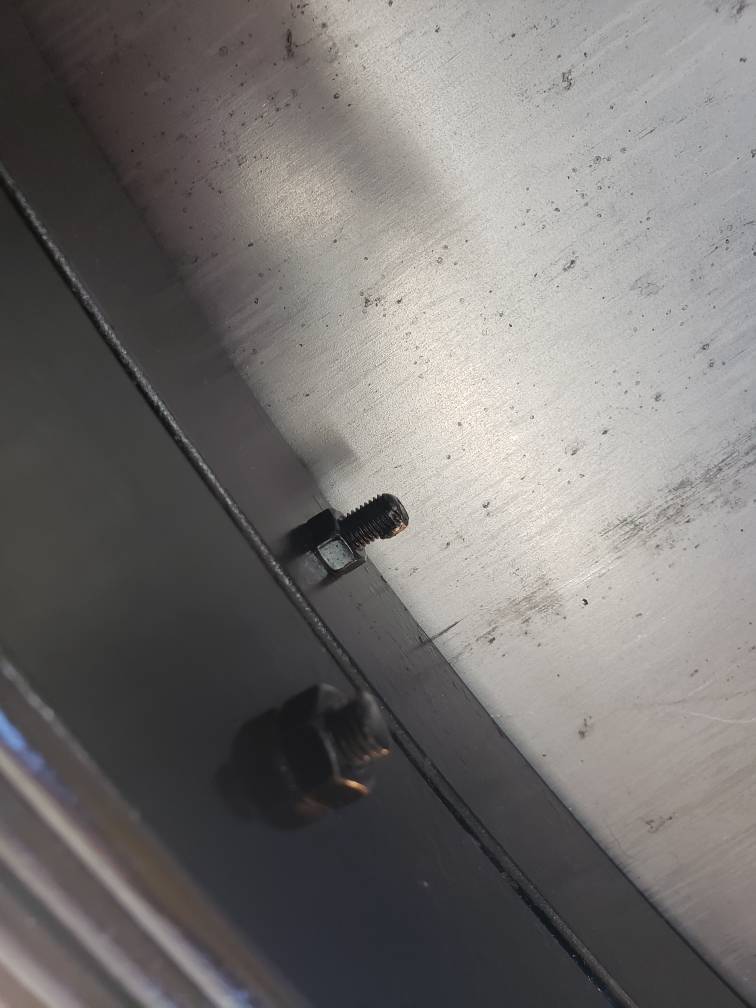

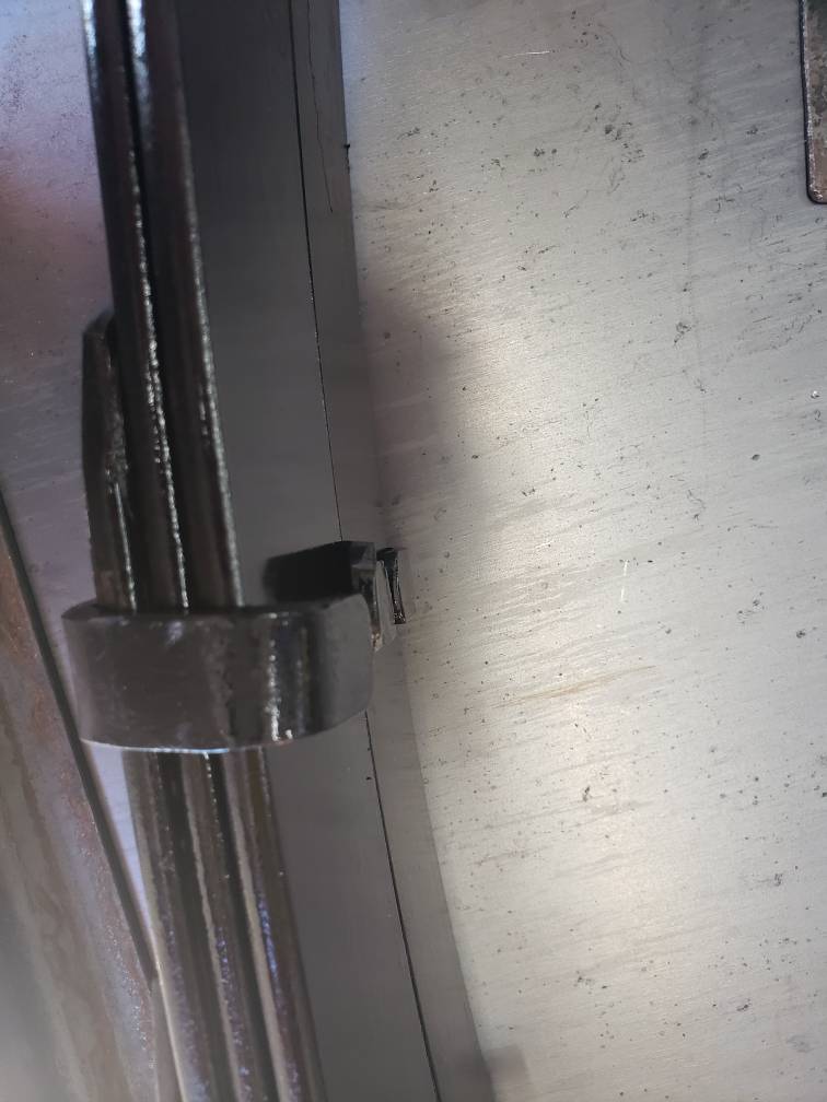

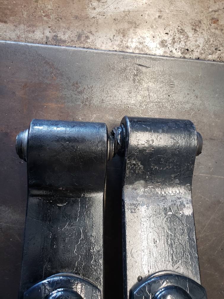

    Spent 4 hours today fixing the junk overpriced springs. Took them apart and decided to work on one to make it match best I could to the other. I had to re-arch the main and bend the eye (had to make a fixture)and I also swapped the leaves around to make them as close as possible. Took them from over 1/4" different in length down to less than an 1/8" all on the shackle end. Good enough I guess. They at least have the same arch now. 20200808_095040.jpeg 20200808_095635.jpeg 20200808_095650.jpeg 20200808_100637.jpeg 20200808_112615.jpeg 20200808_133438.jpeg 20200808_133453.jpeg

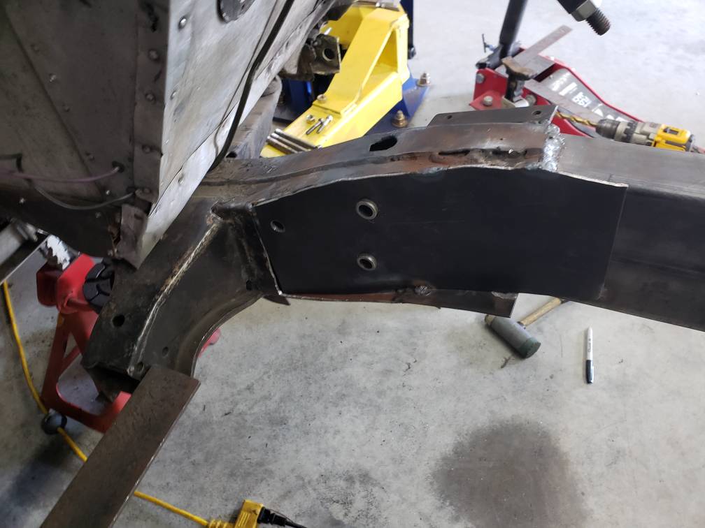

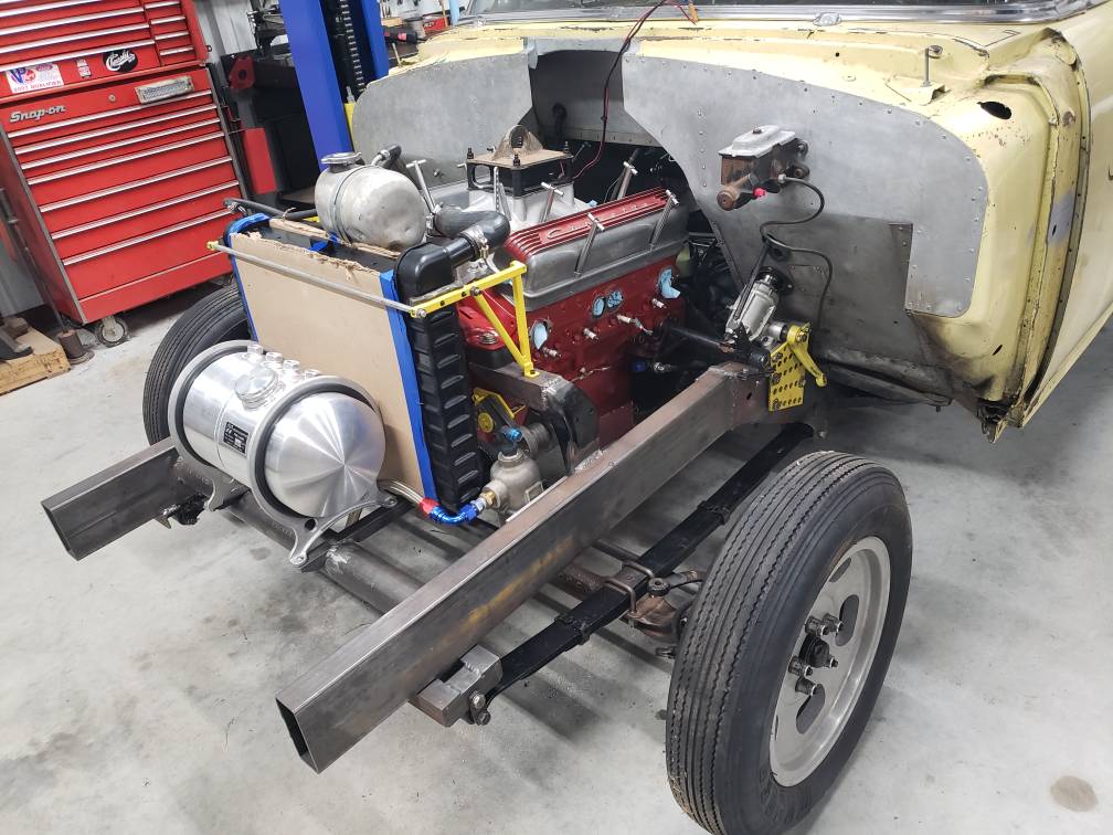

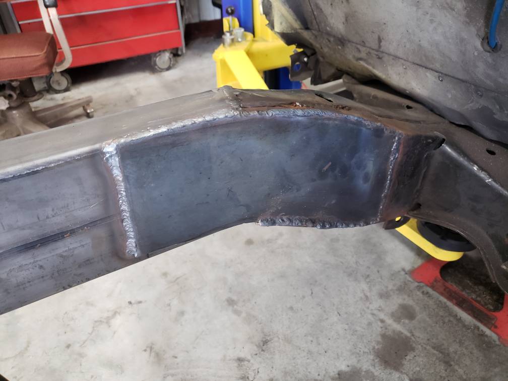

    Had to go to a funeral in Michigan this week so not much got done on the ol' Bad Banana. It cooled down a little the last two days so I did some fab and welding.
    The steering box mount was a huge challenge because I wanted to use the original mount so I had to make the twisted frame line up to where I needed it. It would have been way easier to just start with all new stuff. The original 55 frame has compound angles and I had to mock everything to make sure everything will land where I need it. I spend an enormous amount of time just standing there staring at things and measuring. I'm pretty satisfied where it is now. Still lots of welding but I am glad this part is pretty much behind me now. Should start to go a bit faster now. Next is getting the engine back in place and building the mounts. 20200823_145205.jpeg 20200823_151441.jpeg 20200823_155232.jpeg 20200823_155342.jpeg

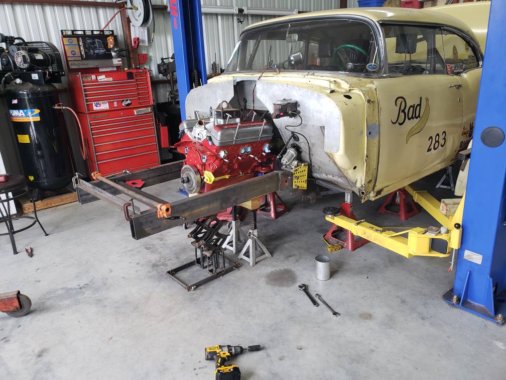

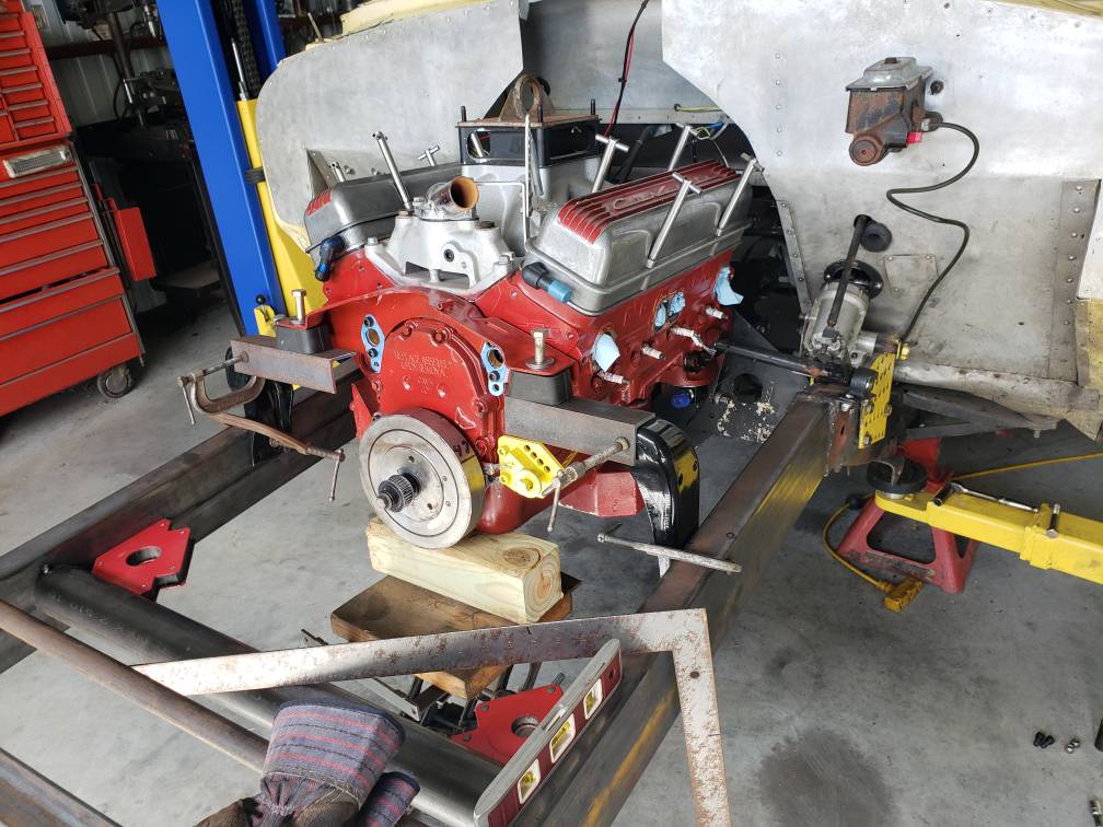

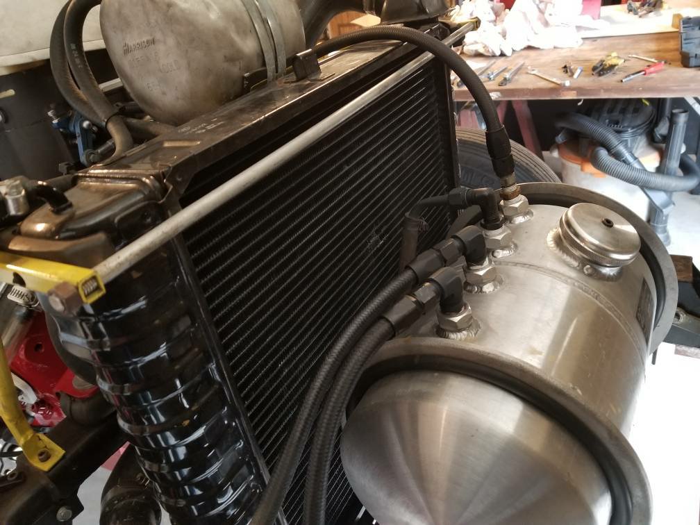

    Took a day off work today. Weather finally broke and it was only in the high 80s today so I set the powertrain back in. Things lined up better than I expected.
    The old man helped me some today as I used a transmission jack he made out of 4 screw jacks many years ago. I haven't used it for quite a few years and honestly thought about getting rid of it during a couple of the recent moves but just couldn't bring myself to part with it. Luckily I kept it because it is perfect for moving the engine in small increments. I got the front mounts roughly made and will probably get back on it this weekend. 20200902_091111.jpeg 20200902_092340.jpeg 20200902_095340.jpeg 20200902_095401.jpeg 20200902_160651.jpeg

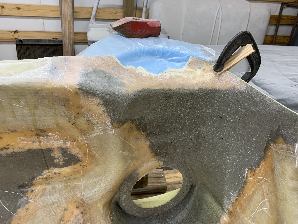

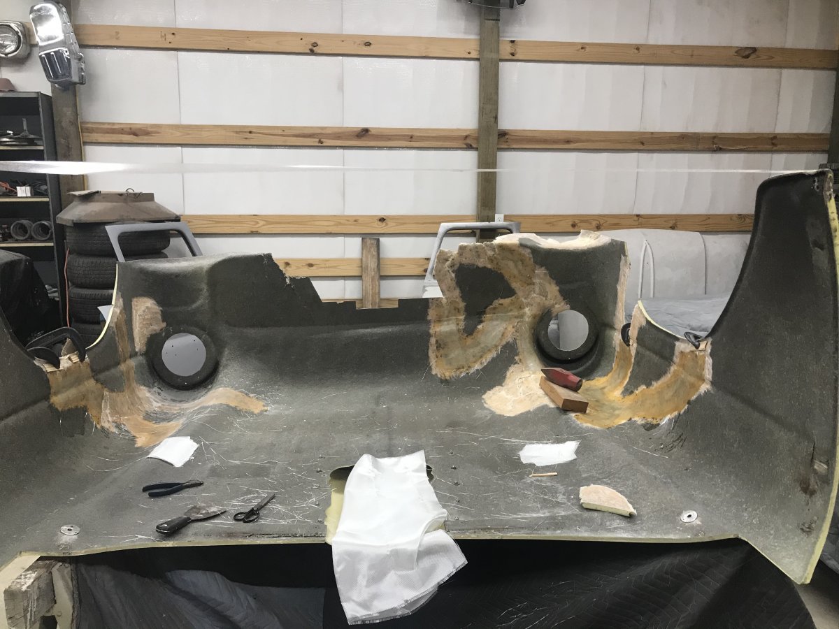

    Speaking of coming back together... :D Front end is all one piece again with all the missing pieces filled in. Hoping to finish up the fiberglass repair on the outside today, then start finish bodywork. I have been dragging my feet on this deal too long and appears the progress mechanically is outpacing me. :oops:
    078BD4AA-9CC6-4B39-88DB-1A243395BE0F.jpeg 2299A796-3FCF-4AA2-85FD-95C1FF7FBB91.jpeg 4125A0B3-DA98-4F9E-B2F9-ED30B0EBBA63.jpeg BE3E4D46-53E9-40B9-936E-CF64269C4AA1.jpeg EA4E882C-83F1-4BF9-80C4-ED9196DB0544.jpeg

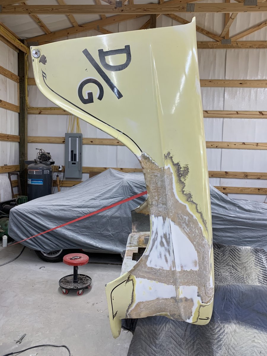

    Big milestone for me today. I finally set it down on 4 wheels and rolled it outside. Mostly to clean up the shop and reorganize for the next phase. Still some more fab work but the to do list is definitely getting shorter.
    Also Jeff sent some pics of the fiberglass front today. Wont be long until we will be burning fuel again.

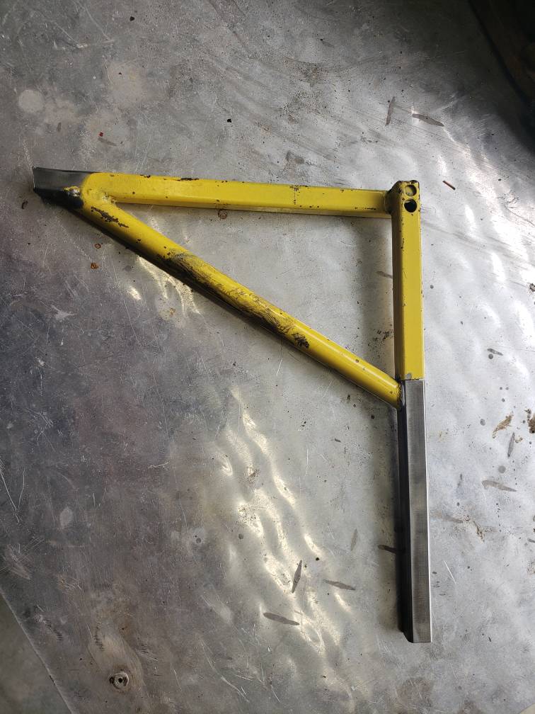

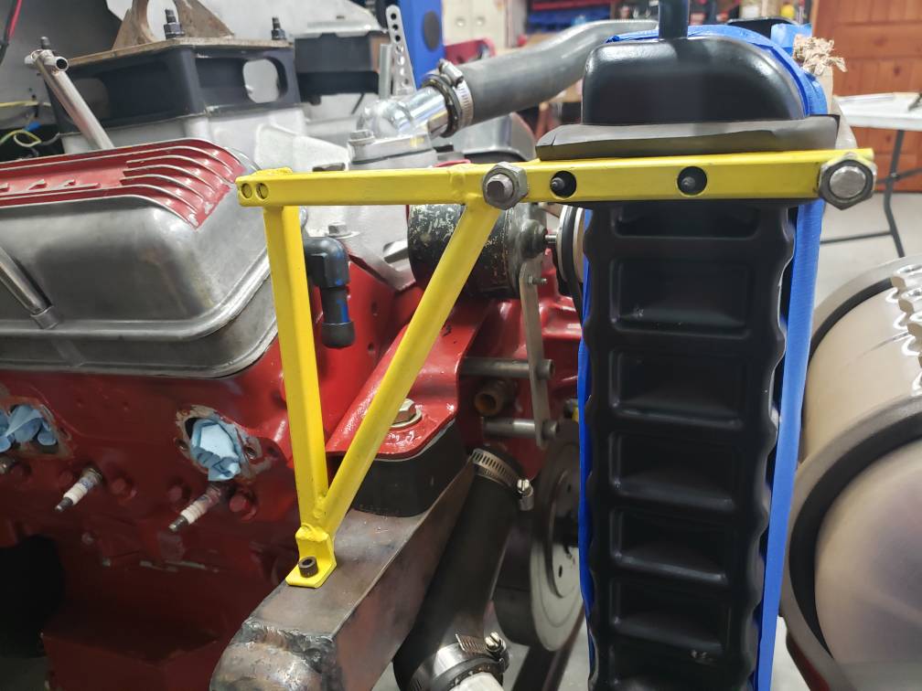

    One of the reasons this repair has been so time consuming is that I am really trying to save as much of the original stuff I can. I still have not thrown anything away but obviously some of it doesn't make sense to save to put back on the car. The stuff I am saving I really try to hide the previous damage. Here is one example.
    This is the right radiator bracket. It is a combination of a piece my dad made and I modified it 10 years ago. Now, I need to straighten it and modify it again. The part I had to cut off, is actually part of the original piece my dad made. My dad was king of making stuff from what was laying around. I actually had that piece of rod that fit inside that square tube and reinforced it so i could just butt weld a new piece back on.
    The old man is still around in my mind. I was looking thru my bolt bin the other day and I needed 4 bolts all the same size. I found 3 but was digging thru and didn't see another one. I stopped and actually stepped away but something told me to look one more time. I went back and magically the last one I needed was right on top. I know I just missed it the first time but when it happened it literally took my breath away for a second.
    I have always referred to this as my Dad's car, but after this repair, maybe its time to say its Rusty's Bad Banana that my dad used to own... 20200923_150139.jpeg 20200923_150153.jpeg 20200923_150212.jpeg 20200923_150236.jpeg 20200923_151530.jpeg 20200924_193631.jpeg
