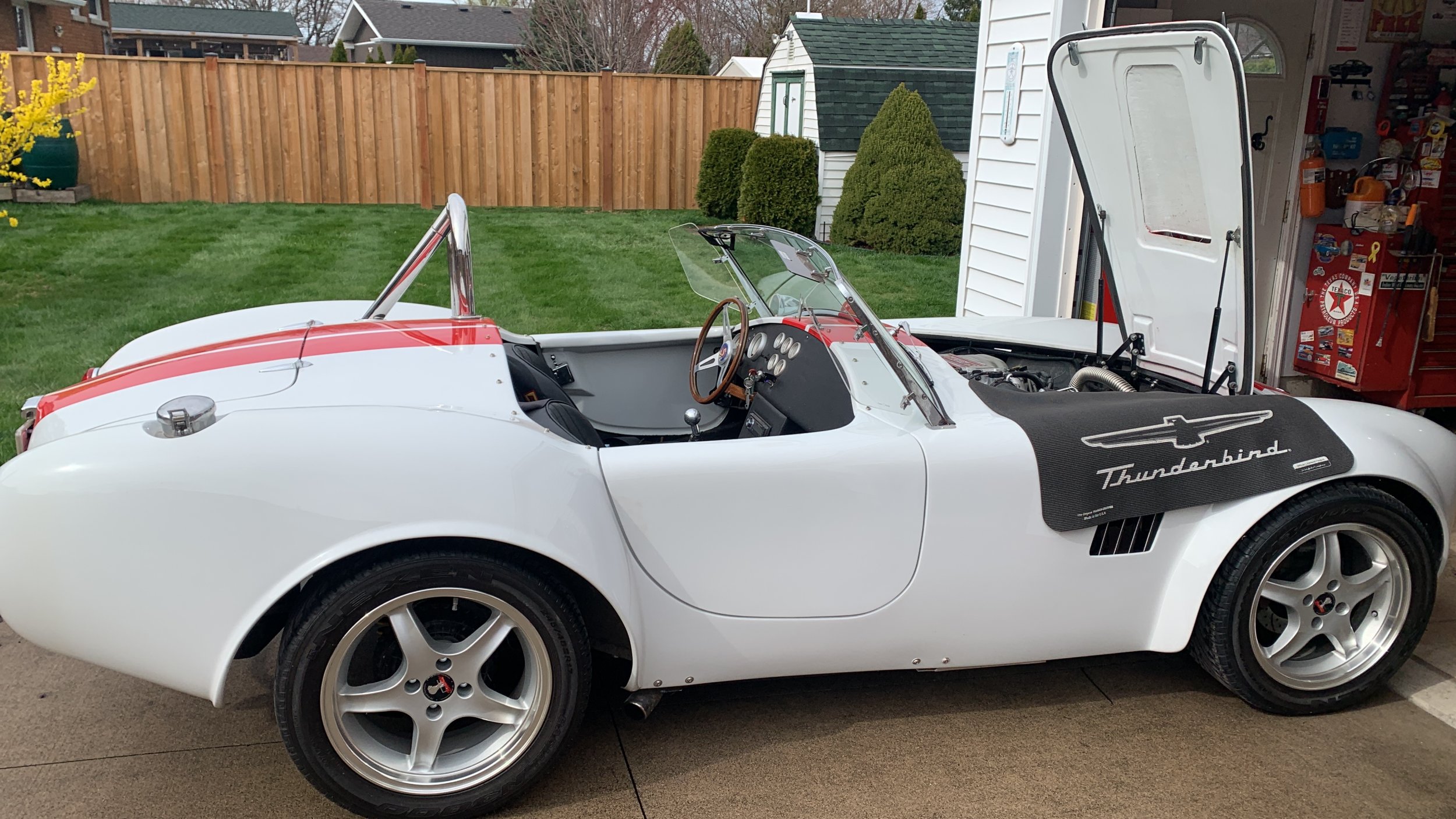

    I spent the afternoon draining the tank, flushing the fuel system and changing the fuel filter on my dad’s Cobra.
    It ran poorly the few times he drove it last year and this spring it didn’t want to start and when it finally started it wouldn’t idle.
    after thinking about it he realized he hasn’t put gas in it in at least 2 years!
    He’s not up for crawling around under cars anymore so I spent the afternoon working on it with him.
    The fuel in the filter looked like coffee.
    All gas sold in our area has ethanol in it now.
    Once we got the nasty out and some fresh gas in it runs better than ever!
    Unfortunately Thats when it started to rain, so we had a beer and Dad retold some stories about the good old days when gas didn’t go bad and beers were 10c.
