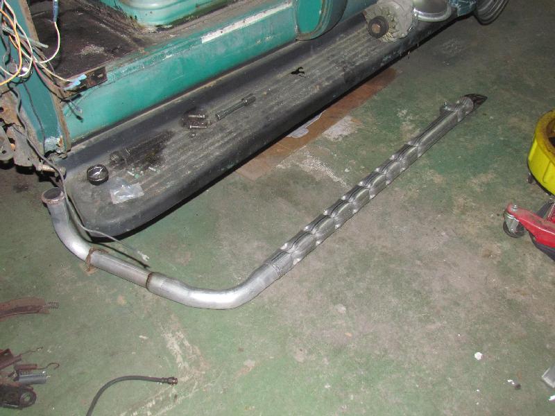

    also they idled them down for a few minutes which help take the heat off the valves , by grandfather who was USAAF told me the guys when they came back from a sortie those pipes would often glow red and be shooting flames but a few minutes idling from the runway to the pad they would cool off as they richened the mixture up ( they ran lean home to save on fuel or to get home ) .
    and also if you look closely on some of the Merlin equipped motors they flattened the pipes down or fishtailed them on some planes which also helped with pushing them this is a Spitfire Merlin [​IMG] ..and also merlins dumped 2 ports ( 1 cylinder ) into a y shaped pipe which constricted at the opening on a mustang[​IMG]
    as for running a 6' section of straight pipe isn't gonna hurt a thing other than someones ear drums , but on the lincoln welders at the shipyard we ran them with 18" of 2" straight pipe off the manifolds but they ran at a constant speed and had a rain cap on them and them ford straight sixes were music under load ..
