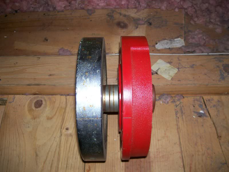

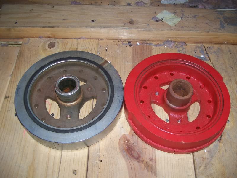

    400 balancer on the right in both photos. Check that yours has the depressed area around the cir***ference like the one on the right. 400bal1.jpg 400bal2.jpg

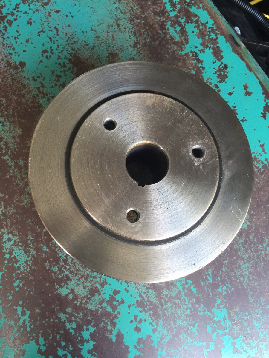

    Mine looks like this.
  8. prewarcars4me
    Joined: Mar 22, 2010
    Posts: 4,077
    prewarcars4me
    from Bhc, AZ
    Flip it over and take another picture.

    take a picture of the other side of that balancer

    My 383 balancer looks like the one he posted. It has weight added to the back.
